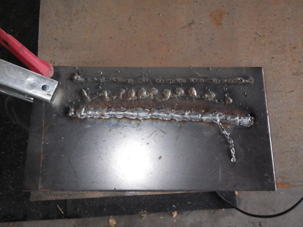

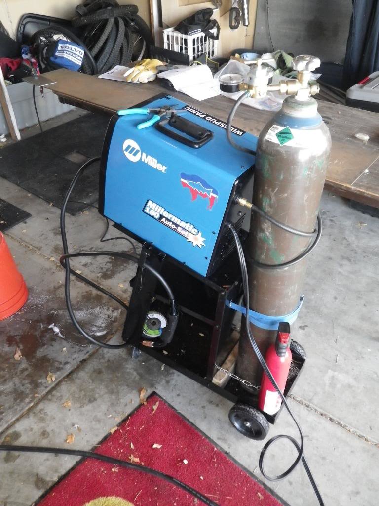

    Finally got a chance to break in the new machine, Miller 180. A few snafus along the way (welding supply shop sold me an empty tank, lesson learned, check the pressure before leaving), but spent the morning learning the machine. Please provide any feedback.

    LOL, nope, these were my first beads ever. Here are the very first ones, the top row I forgot to turn the gas on :eek:

    Looks good!
    That sucks about the empty gas bottle.. I've never checked the pressure at the LWS.. there's a pretty considerable weight difference between an empty/full bottle. Hope you didn't have to drive too far to return it.
    I'd say maybe slow down your travel speed a little bit, and focus on tying in the top and bottom edges of your welds.
    Pushing or pulling?

    Thanks! Yeah, I was pissed, but the shop was not too far away. They cylinders I have worked with before (not welding) were AL, so I was not too sure on the weight.
    Not sure in those pics, I was swapping around quite a bit trying to figure out what worked best.
    What do you mean by tying in top/bottom?

    Make sure the puddle is washing up to the top and bottom. So the weld lays flat and not just high in the middle
