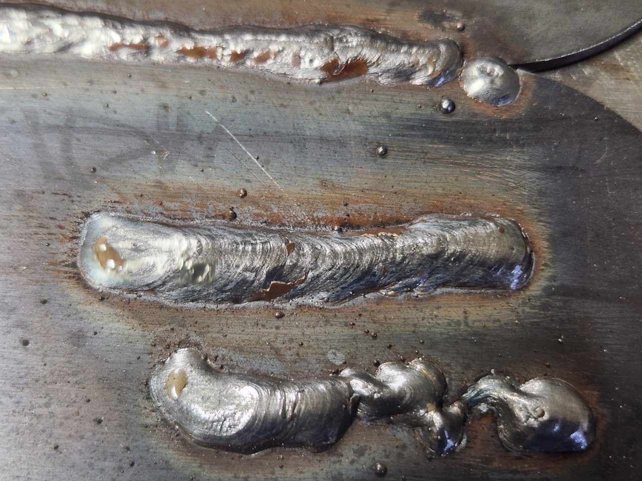

    Badass. Nice job. Cool to see your welding and fabrication skills come so far in a short time
    Vmax88 and Kwikvette[QUOTED] like this.
  6. Feb 5, 2023 at 9:18 PM
    Kwikvette
    Feb 27, 2019
    #284735
    82,933
    Fresno County
    4 run, 2 don't
    Thanks!
    I'm my biggest critic and I was telling myself it could've been better; still strong as heck though!

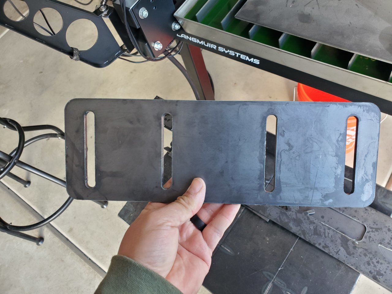

    Awesome! Damn shame it's gonna be covered by a spare. Maybe it will be visible through the rim.
    You need to have some decals made up to give with the parts you produce.

    Kwikvette
    Feb 27, 2019
    #284735
    82,933
    Fresno County
    4 run, 2 don't
    Dude, decals are a great idea!

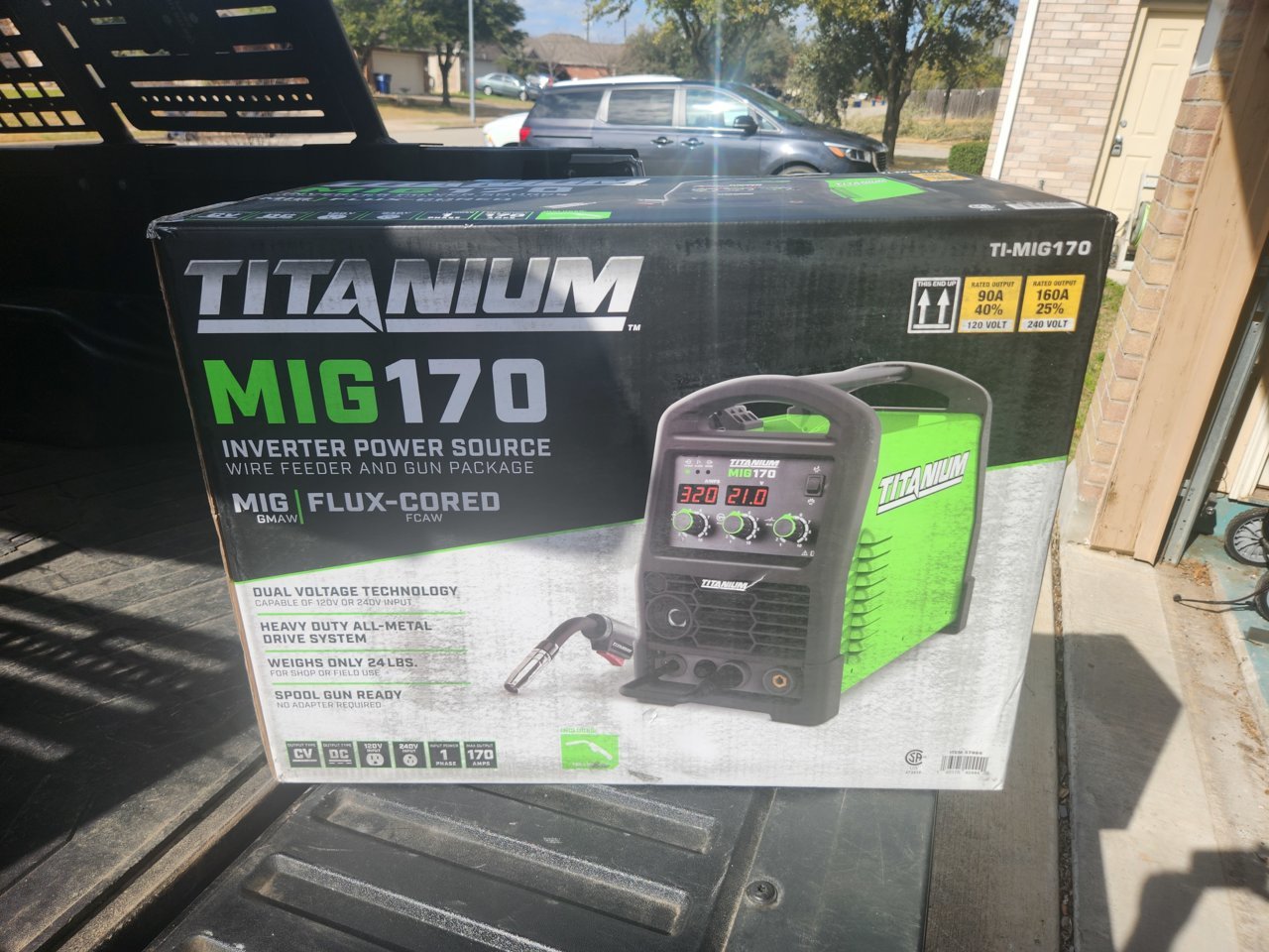

    Broke down and picked up this little unit today.
    going to have to jump through hoops to get my cylinder swapped out. local welding shop would not touch it, falsely claiming the company on the neck ring was still in business and was based in oregon, Nice to see there google skills are good.. the company was based in rockford Illinois, and was bought by airgas 8 years ago. the tank is customer owned an has been since I was born.
    So I had to drive halfway across town, to airgas, an try to swap it out for a tank of C25, nope they no longer swap gases so I had to get a tank of Oxygen. ok so swap it out and make sure the neck is slick. So now I have a 250cf of oxygen which I hardly ever use. but, local welding shop I first stopped by will swap gasses long as it is customer owned tank.
    But I am kinda thinking of swapping out my 125cf oxygen instead, and get the acetylene filled at the same time.

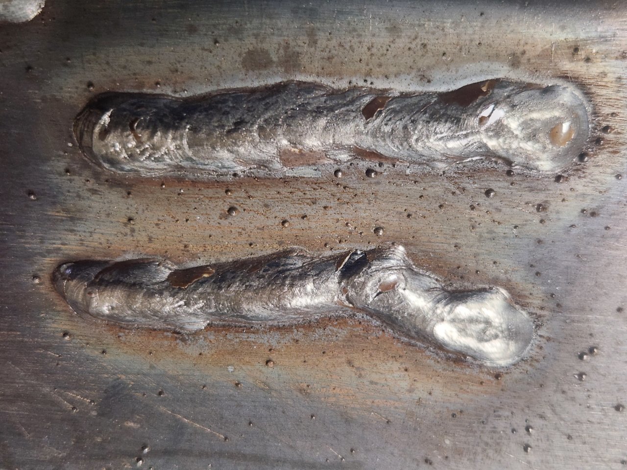

    Couple practice beads with the new welder in 1/8" mild steel.
    bottom was the first one , started off badly on the right , and started smoothing out to the left. above that is the second bead and above that is a butt joint.
    tweaking the wire speed just a a touch, and relearning how to lay a straight bead. bottom one got a bit wonky
    A little better view of the butt joint, after I started I just pushed the nozzle in a straight line, mainl;y wanted to just follow the gap between the two pieces

    Kwikvette
    Feb 27, 2019
    #284735
    82,933
    Fresno County
    4 run, 2 don't
  18. Feb 7, 2023 at 5:12 PM
    Kwikvette
    Feb 27, 2019
    #284735
    82,933
    Fresno County
    4 run, 2 don't
    Take a piece of metal.
    Take a ruler, straight edge, whatever and with a permanent marker, draw a line across it. Then another above or below it.
    Draw lines that parallel each other on the entire face of your steel between about 1" apart (all evenly spaced).
    Follow these lines as you run a stringer.
    This is how I've taught several first-timers to 1. Get used to running the gun and 2. Learning how to watch and guide their arc

    What kind of marker I tried using one and the ink burns off.
    In the olden days we center punches holes to follow or soap stone.
