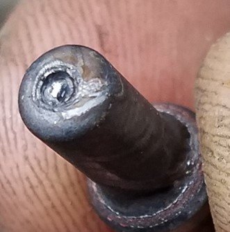

    First electrode I replaced was after running 1/4".
    A tip I know when to replace, but was mainly curious if others replaced their electrode at the same time or not.
    I'll dig my electrode out later today and post a pic. What prompted me to replace it was the arc wasn't firing exactly as how it was when brand new. Pulled it off and you can see how messed up the end was.

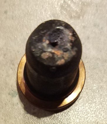

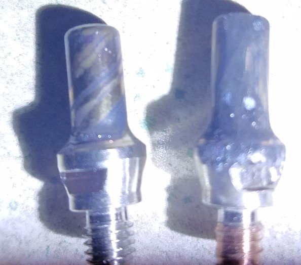

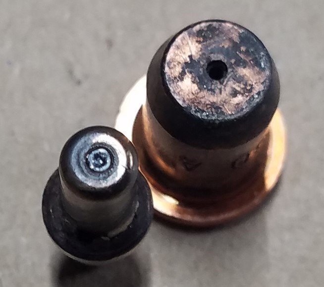

    Here are bad and good images from before and after I added additional air drying. See the nice swirl pattern produced by swirl ring on the left, but the damage and lack of swirl on the right. I believe water droplets were causing arcing between the tip and electrode up inside the tip.

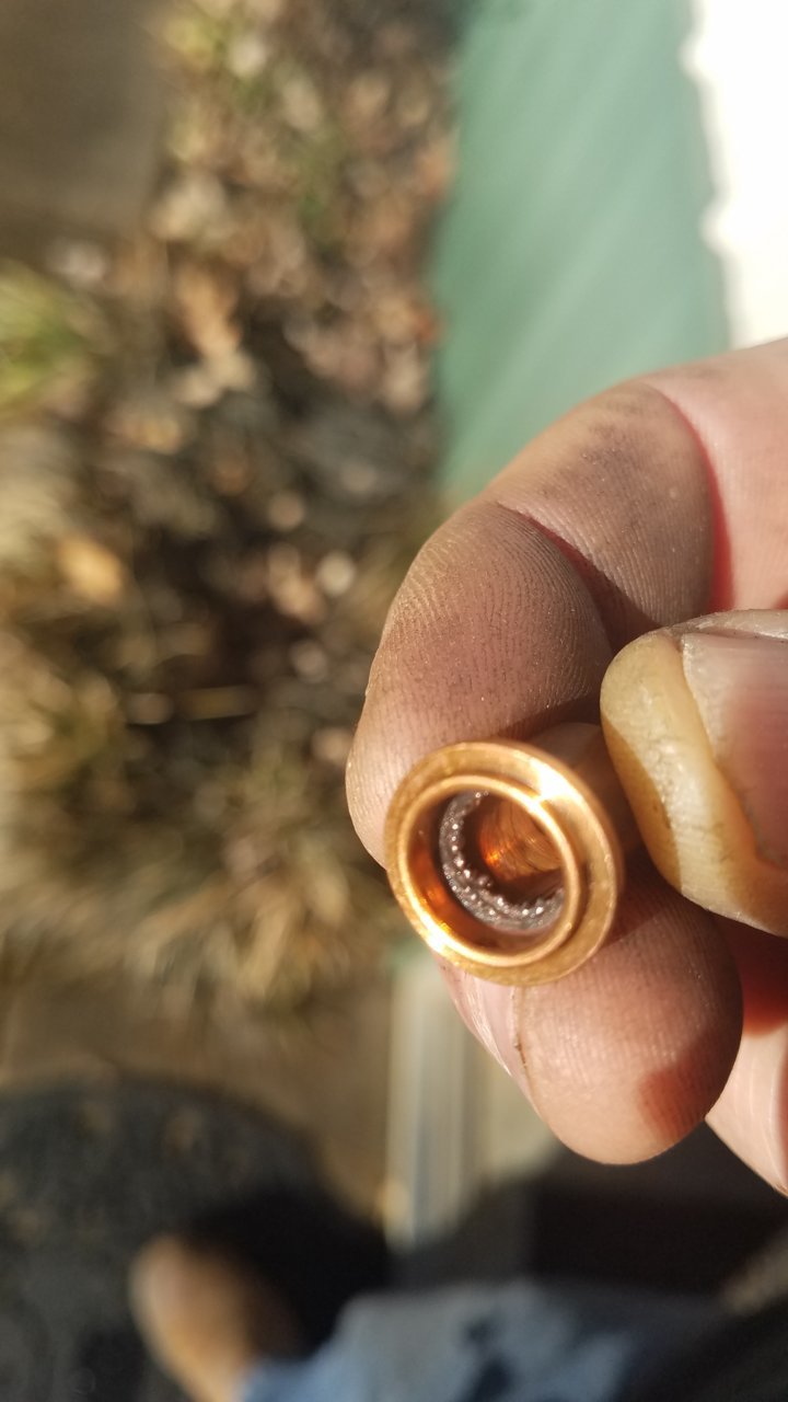

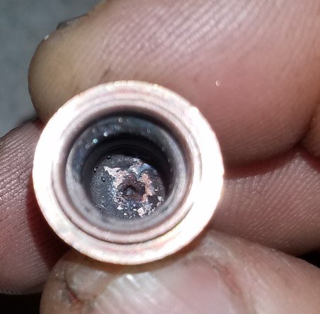

    Here is what the inside of the tip looked like with arcing:
    That arcing can cause erratic and poor cut quality and torch mis-fires.
    Here is a tip I replaced that had enough wear to cause a pretty big divot but was still performing well and the inside showed minimal signs of arcing after getting moisture content down. I just felt it was getting risky pushing it any further. Electrode also showed no signs of damage.

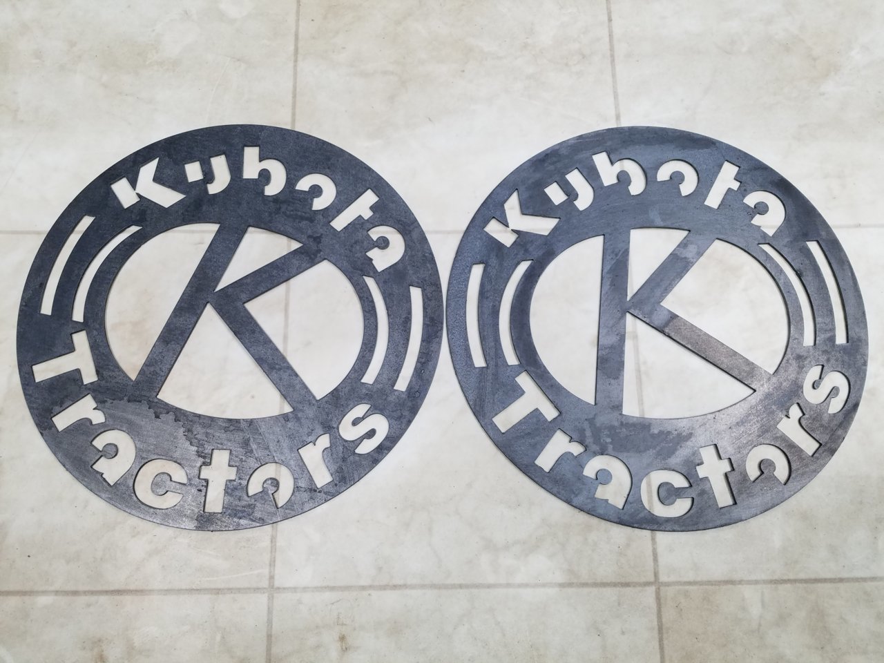

    Here is a tip(40 amp)/electrode pair I have cut about five or six fairly detailed signs. They are showing signs of wear, but it's normal looking and they are still cutting very cleanly on 16-18 gauge.
    I know you were asking more about electrodes and from what I have read and seen 1/16" deep divot in the hafnium is about when it should be changed. That's half of it's total depth 1/8" depth, so I guess one could be pushed a bit more if still firing in the center (like my pic above) and producing good quality. Maybe short runs, but long runs and/or expensive metals would be risky.
    If I was going to cut the same thickness metal day after day, I'd probably use the counter in FCtrl and just start changing them based on usage. Basically, like the commercial guys do. But as an amateur who changes tips/metal gauges/ demands on the consumables pretty regular, I just feel like I am better off learning to watch, judge, and replace as needed.
    Again, just my novice $0.02.

    That electrode shown above got me two more low complexity signs and now it's toast and going in the recycle. Signs cut perfect though.
    BTW the missing sections of letter are Kubota font.

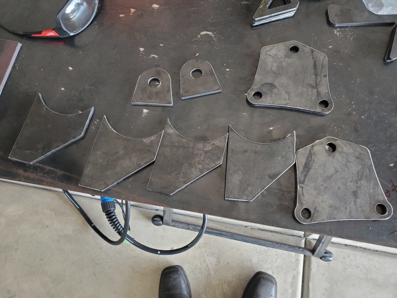

    Just got home and making those mounts for said customer. He wanted another set of motor mounts too so knocking those out real quick.
