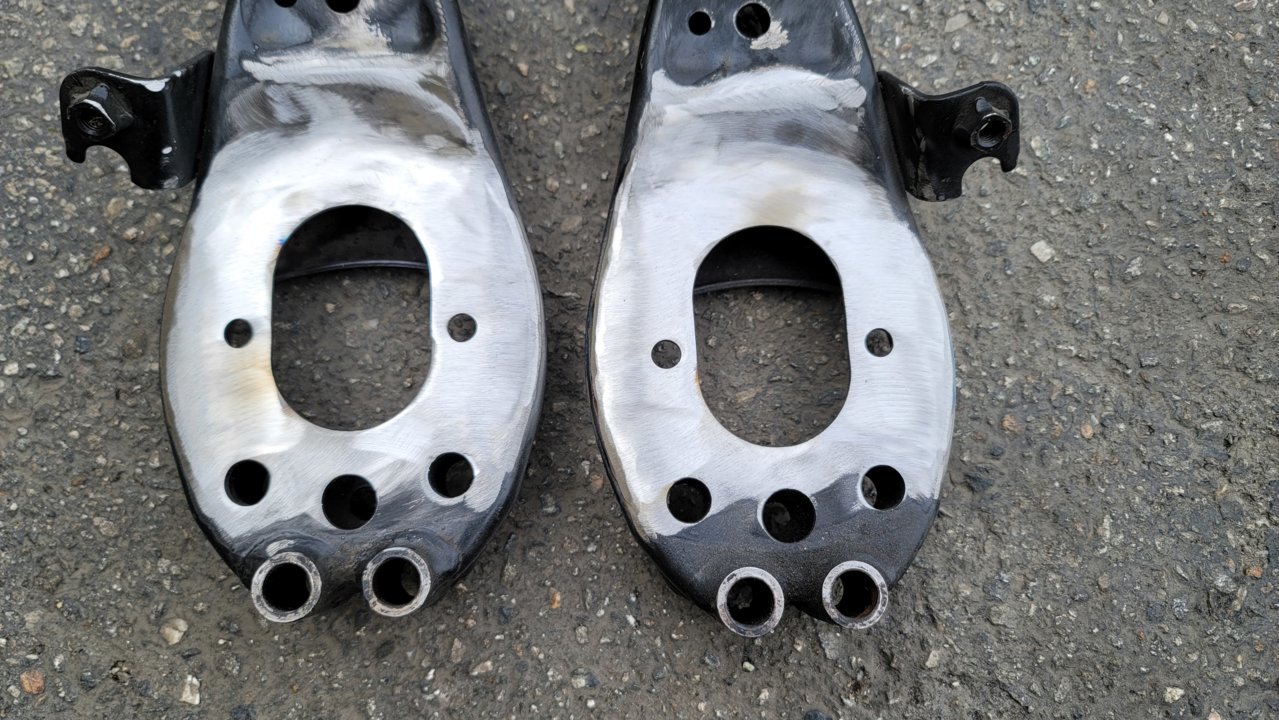

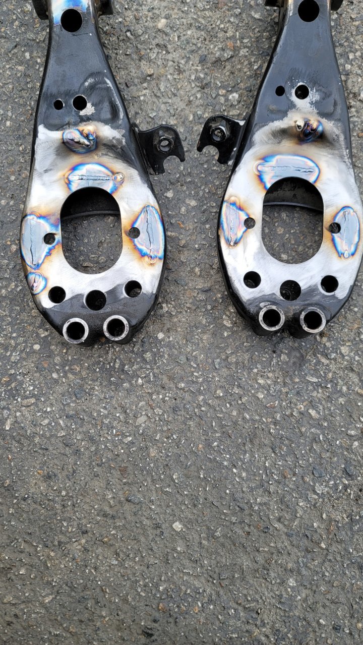

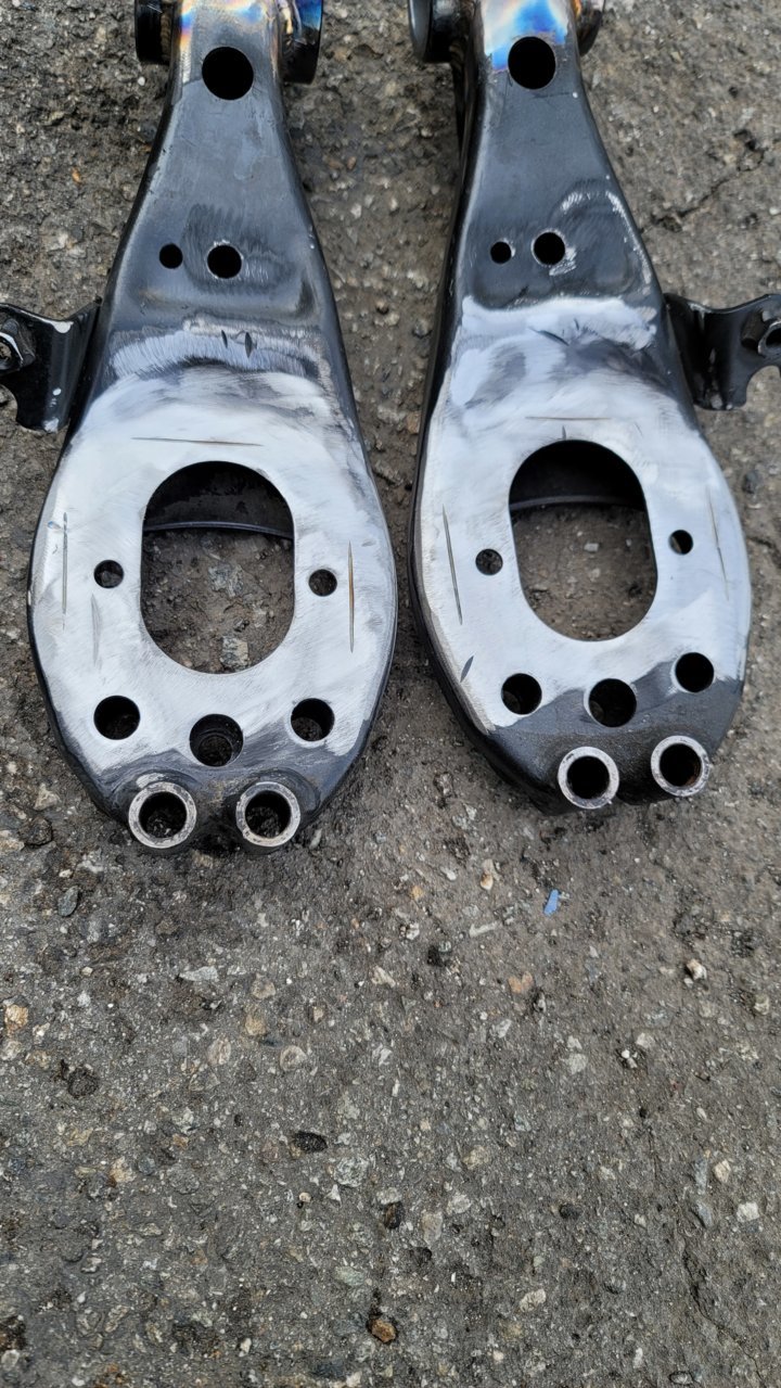

    Filled up some cuts that went a little too deep to have some clean metal.
    Then smoothed em out.

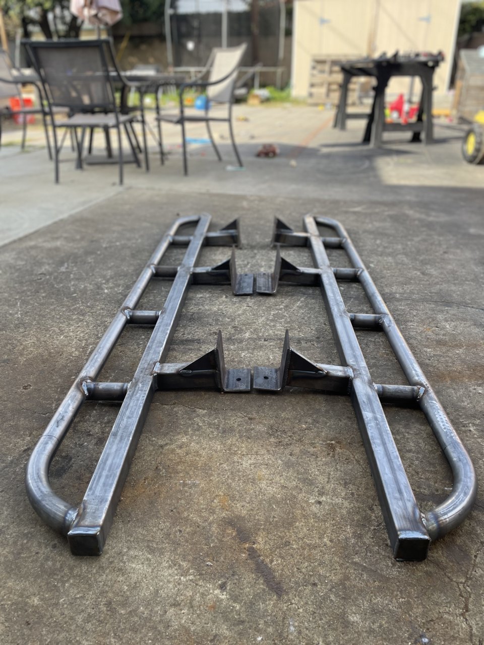

    First set of sliders without kickouts in a while

    Gonna need some close ups of your earlier sets welds so we can compare them to current welds.
    I come across some of my trailers I built 20+ years ago on occasion. I look at the welds and think "fuck! Someone bought this shit from me and is happy?". I sucked back then or was having a bad day.

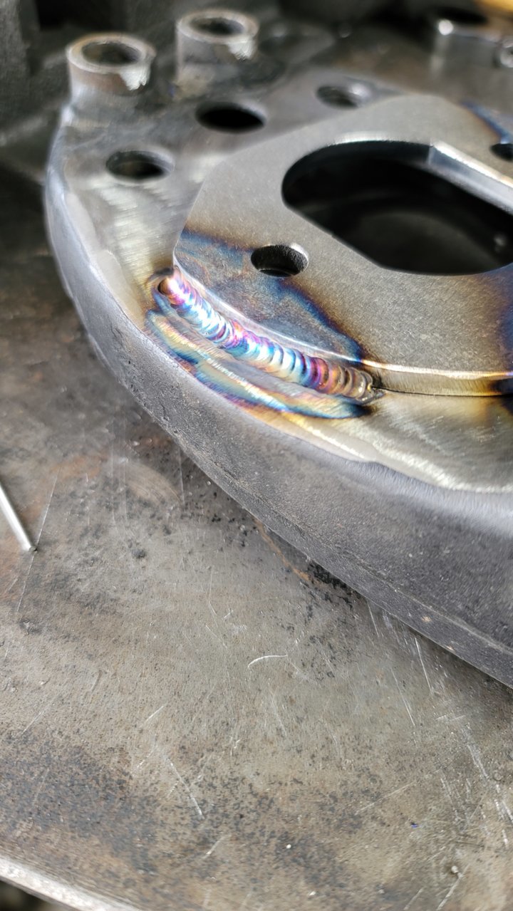

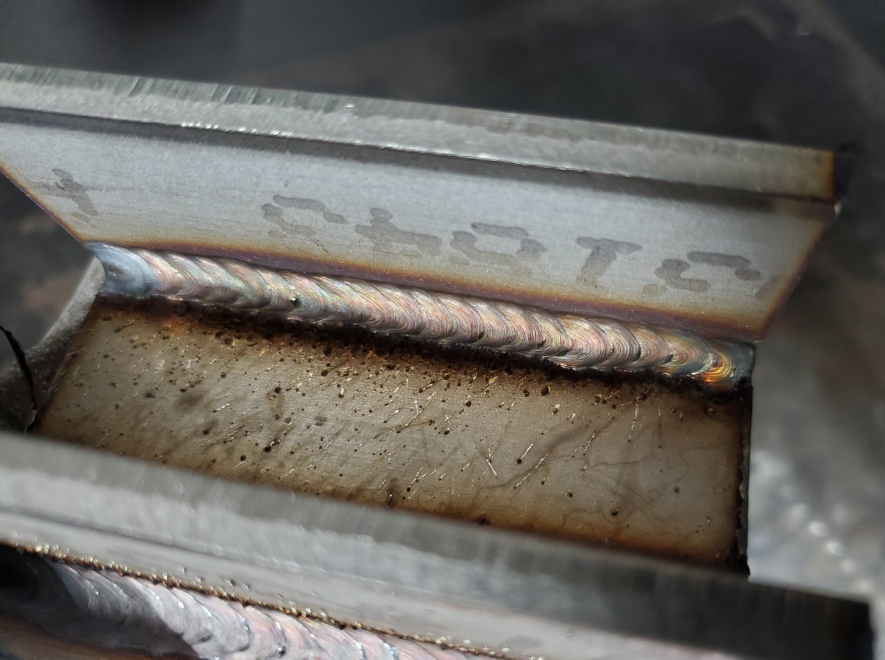

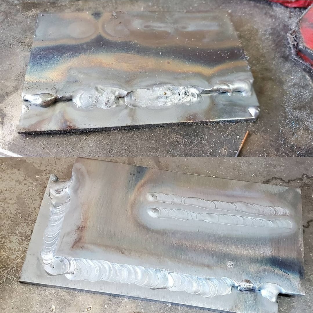

    My first and second ever tig welds. February 2021
    And my latest. Today

    Get some more Arc time you should be good!!:thumbsup::thumbsup::thumbsup:

    It's a hobby I weld like once a month these days lol. But I know I have a long way to go.

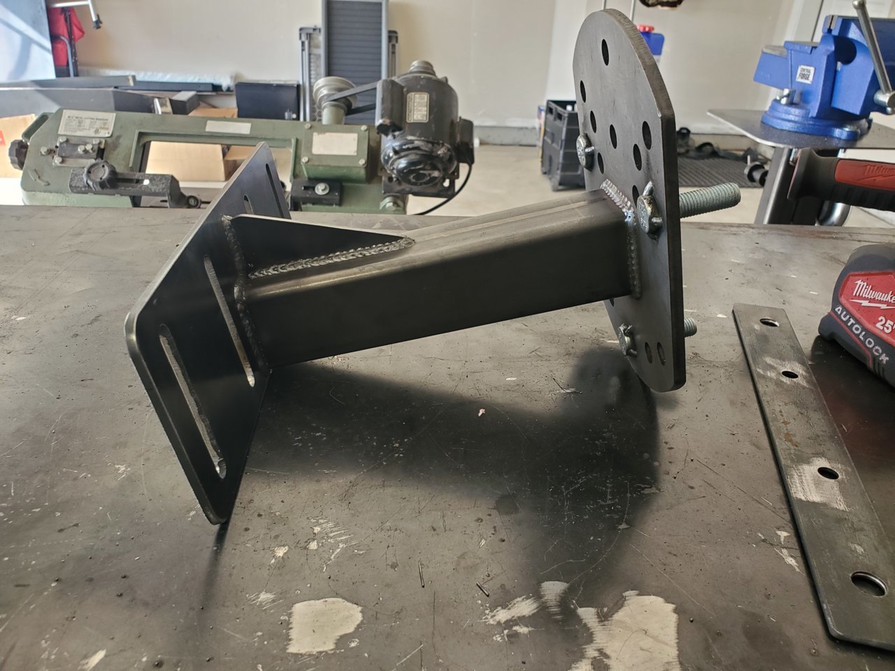

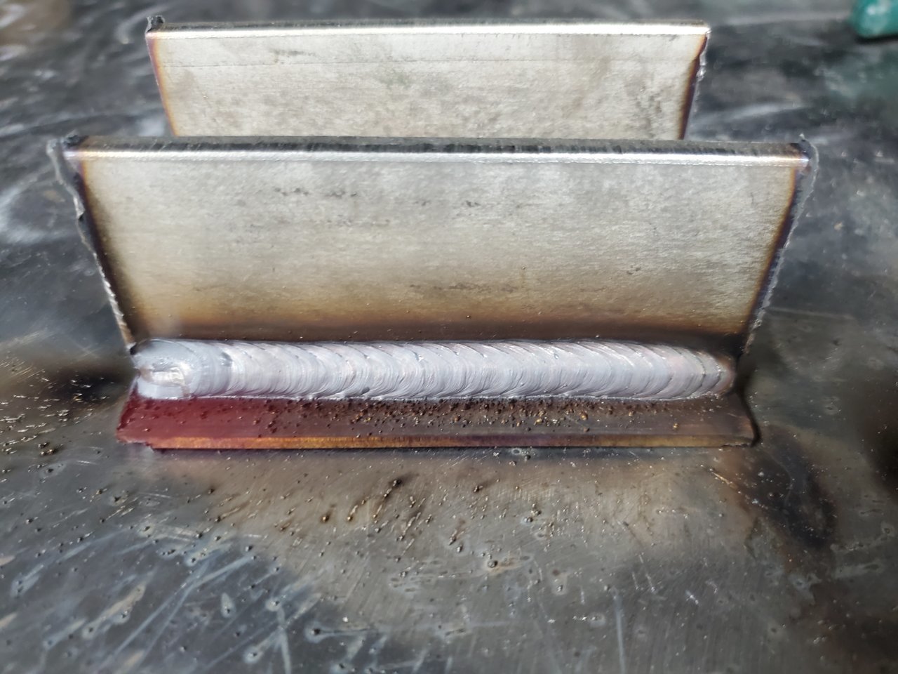

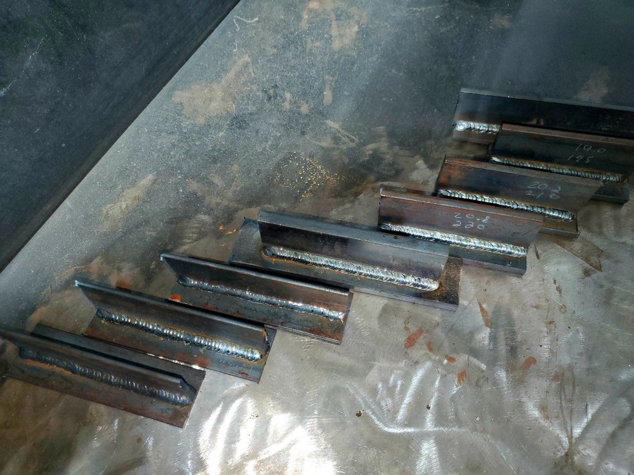

    Speaking of firsts, these are my first ever MIG welds on mild and stainless steel Oct 2021 -
    And my most recent, which was that tire holder I made recently. So that one isn't just welding but also fabricating the whole setup and getting it done on CNC -

    Those are some damn good firsts

    Thanks!
    You'll notice all those Ts have writing on them; I was turning up heat, then hotter, then hotter, and then hotter again.
    On the other side of each one I messed with wirespeed.
    This is why I tell people to run the same bead over and over again (what I was taught in school actually). Only way to see instantly how settings affect one's welding. And if there were any other "flaws", hopefully it would be noticed by the welder since every bead technically should be run the same way.

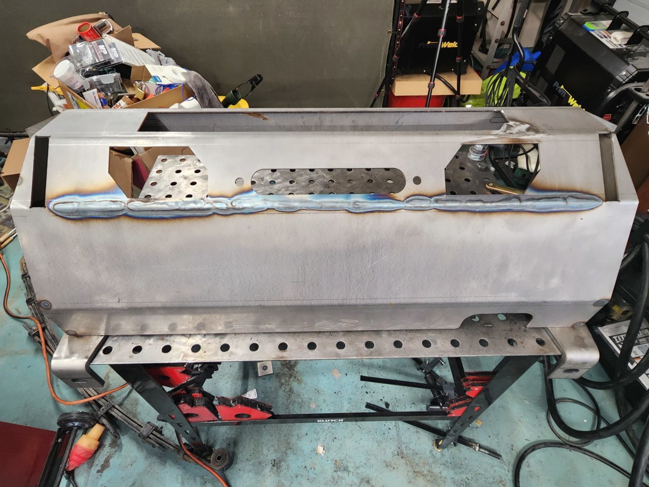

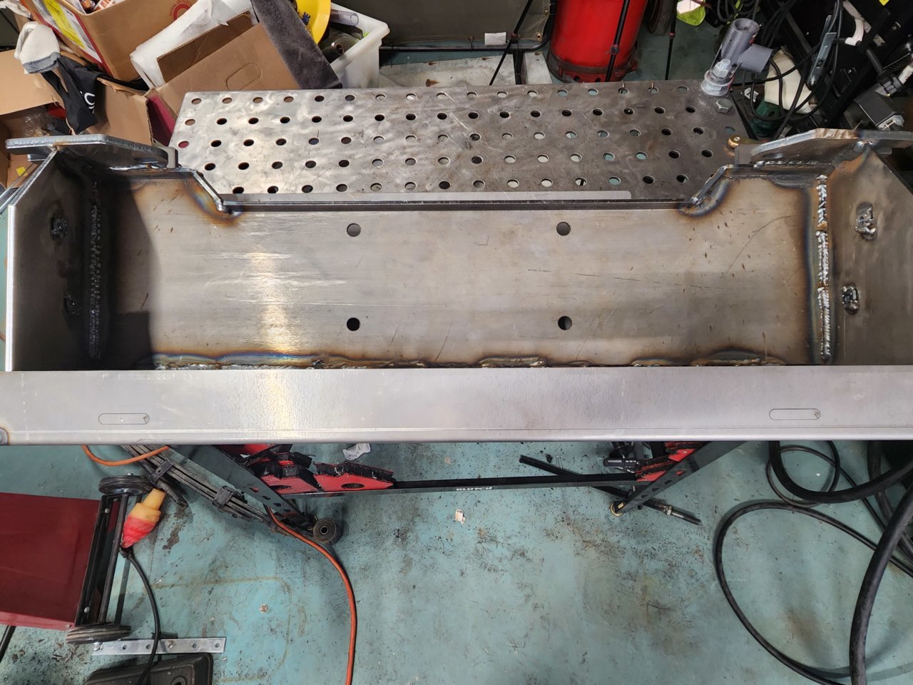

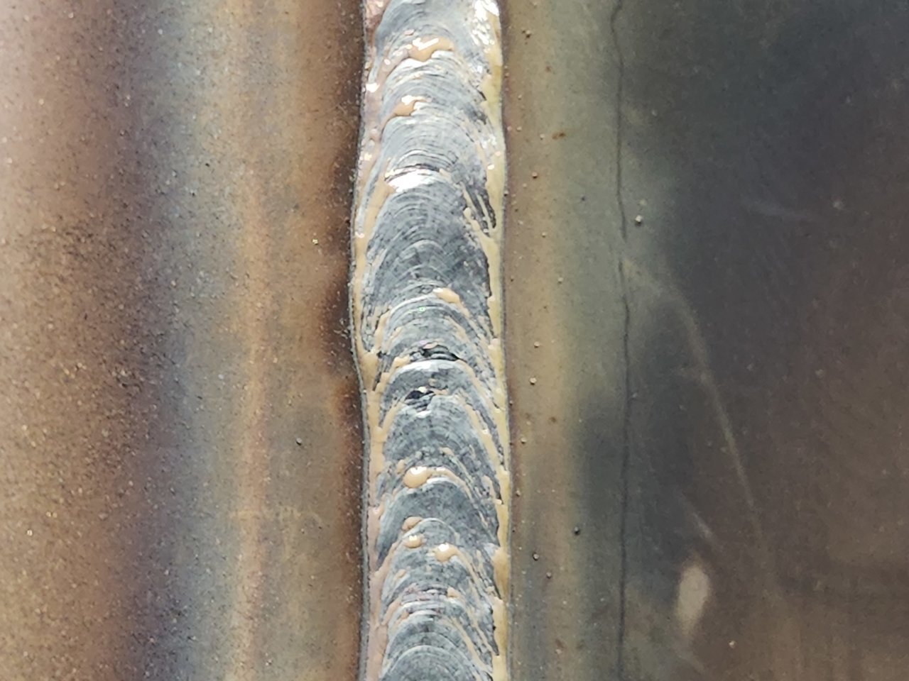

    Made up some more clamps for the welding table today.
    I also ended up having to gouge out both sides of the winch plate on the bumper. BUT I was able to get everything cut apart, and cleaned up. and the new clamps helped keep everything aligned. properly
    Been A very long time since I have done a vertical T joint in any process, But I am pretty happy with this one..
    gotta say today is the first time I have been excited about this project since the kit arrived a couple months back.
    Zebinator, Drainbung, Bivouac and 2 others like this.
