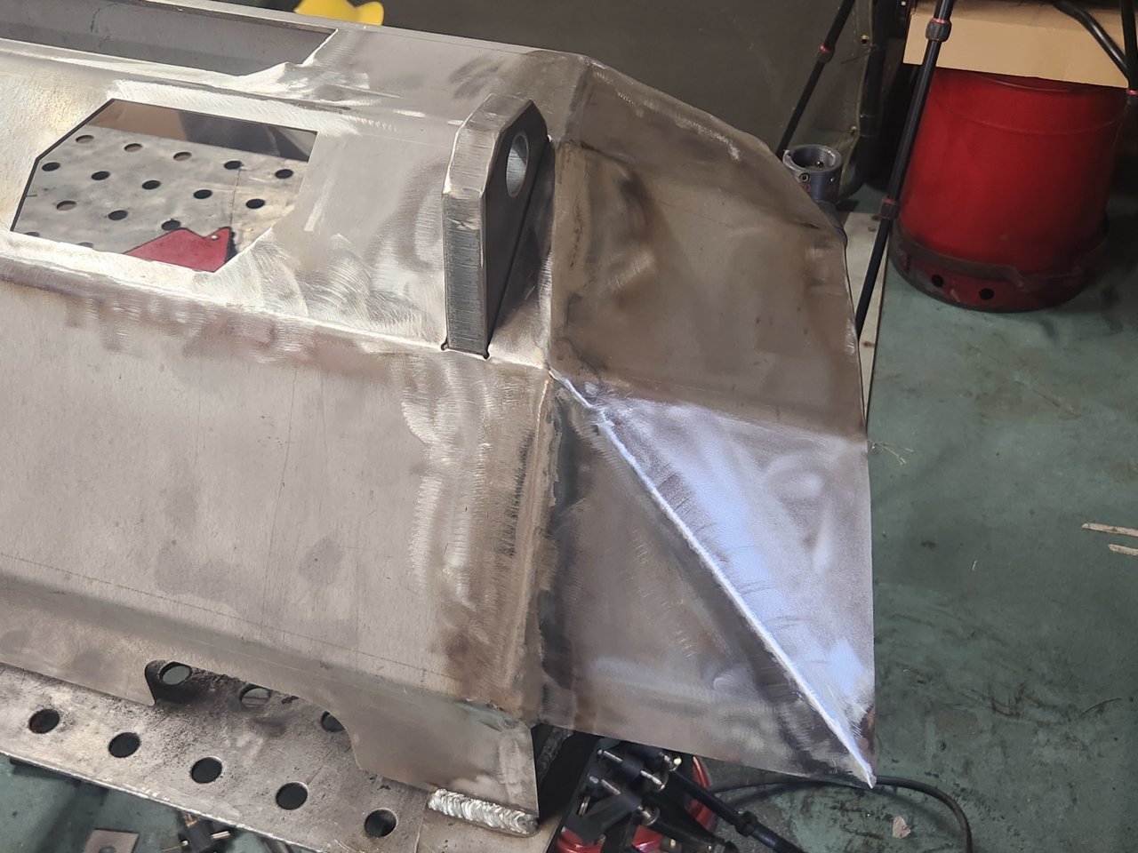

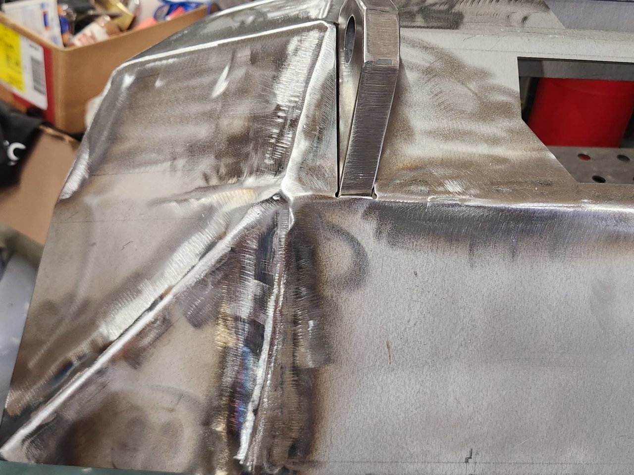

    Today, I was able to get the bumper mostly done.
    I still need weld the shackle tabs in place. I decided to stop for now, an not rush this part.
    Also need to go over everything make sure nothing was missed, and finish blending the front and the rest of the surface prep, before final paint.
