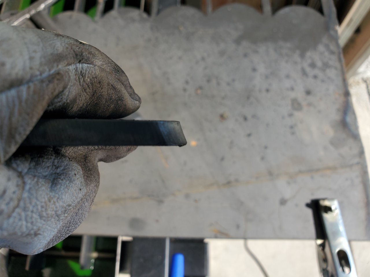

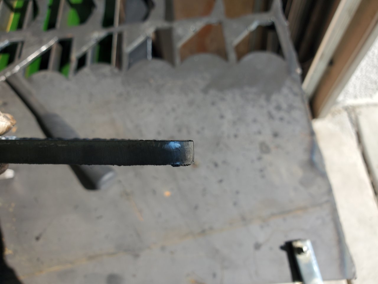

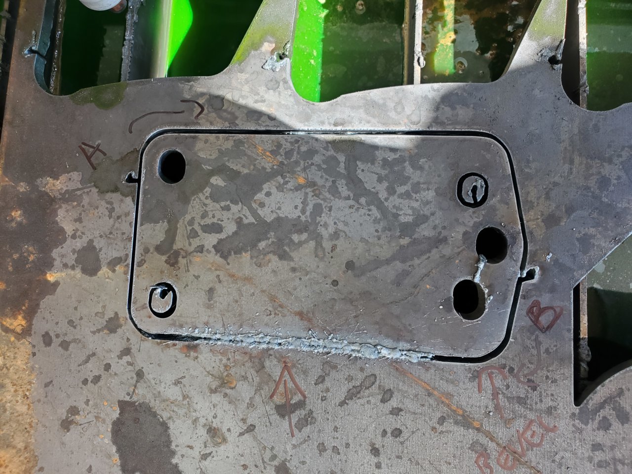

    Torch hasn't moved, but based on my assessment the bevels are largely due to the torch height moving unevenly.
    My gantry tube must not be as square as I thought, even though I squared it as much as possible upon initial assembly.
    Also, there's a discrepancy between my actual measured torch height versus what is programmed in my CAM software.
    I'm supposed to be at .065 but actual measurement is .0565; I got this figure when I paused the torch at mid-cut. This was only on one end so that paired with anything being slightly off square would cause a huge difference in torch height across my piece.
    This is the assumption anyway.

    Coming from the 3d printing world.. bevel sounds like out of square x or y axis or a bend in one of the rods, combined with your stepper motors possibly not being calibrated right (z axis height discrepancy)

    I dont know the specifics of your machine, but here are some things I would suggest checking based on your results:
    Table zero
    Gantry to table squareness
    Gantry level
    Torch / z axis mounts
    Motor mounts / gear mesh / belt tension
    The partial cuts make me suspect whether the gantry and table are level and level with eachother. A degree out can cause acceleration issues. The other suspect to me would be some time of binding causing drag and release on the gantry, especially since the lost cuts are along the same axis is the same spot, just different directions. Something is out of alignment causing some drag, and then releasing cause the speed to increase or a parameter to exceed limits (perhaps torch height, as you stated) go back and check alignement, especially any gear mesh or drive belt tensions. I had similar results when I first installed my arclight dynamics and my multicam units ... but were solved by adjusting the drive belt tension (arclight) or drive motor gear mesh (multicam).

    You just discovered what the IHS Springback feature can do to you. Most people find it causes torch hght to be more than programmed, but ...this is a good explanation. You just need to acct for it when post processing.
    Cut height calibration (IHS Springback) - CrossFire ® PRO - Langmuir Systems Forum

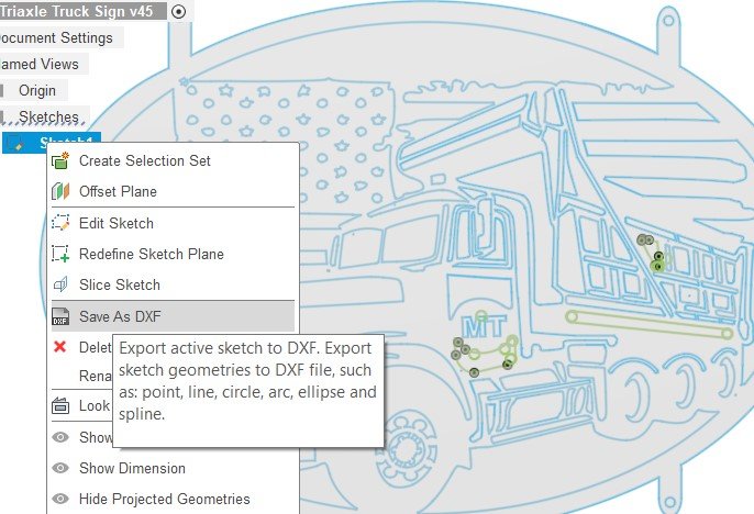

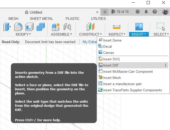

    Also, I was glancing at LT thread last night and saw you were thinking you can't export dxf. You can:
    Next time you need it, just start a new sketch and Insert it again:
    Also, here is a good explanation of file mgmt in F360:
    How to save a local archive (backup) file in Fusion 360 | Fusion 360 | Autodesk Knowledge Network

    So in short just change my springback distance as specified by another user there? Seems like that'd be the ticket. This is of course based off initial height setting, and measured distance versus requested distance from torch to piece.
    As for the files, I don't know if you caught it but I'm on the free version of Fusion360; you have to pay to export to dxf and many of the other popular file types.

    I'm on the free version and I export dxf all the time.

    Same.

    I'll try again but yesterday when I tried to export, all the file types I wanted were greyed out (not able to select). There was a link before that with a note and asterik stating if I wanted to export to other file types like SVG, DXF, etc I need to subscribe.

    Can you export the file before you extrude. Your image is not a dfx.
    Dfx files have no dimensions. You have to scale a dfx then extrude...I think.
    Kwikvette likes this.
  16. Feb 20, 2023 at 1:26 PM
    Kwikvette
    Feb 27, 2019
    #284735
    81,415
    Fresno County
    4 run, 2 don't
    I just saw I need to get rid of the extrude, disregard!
