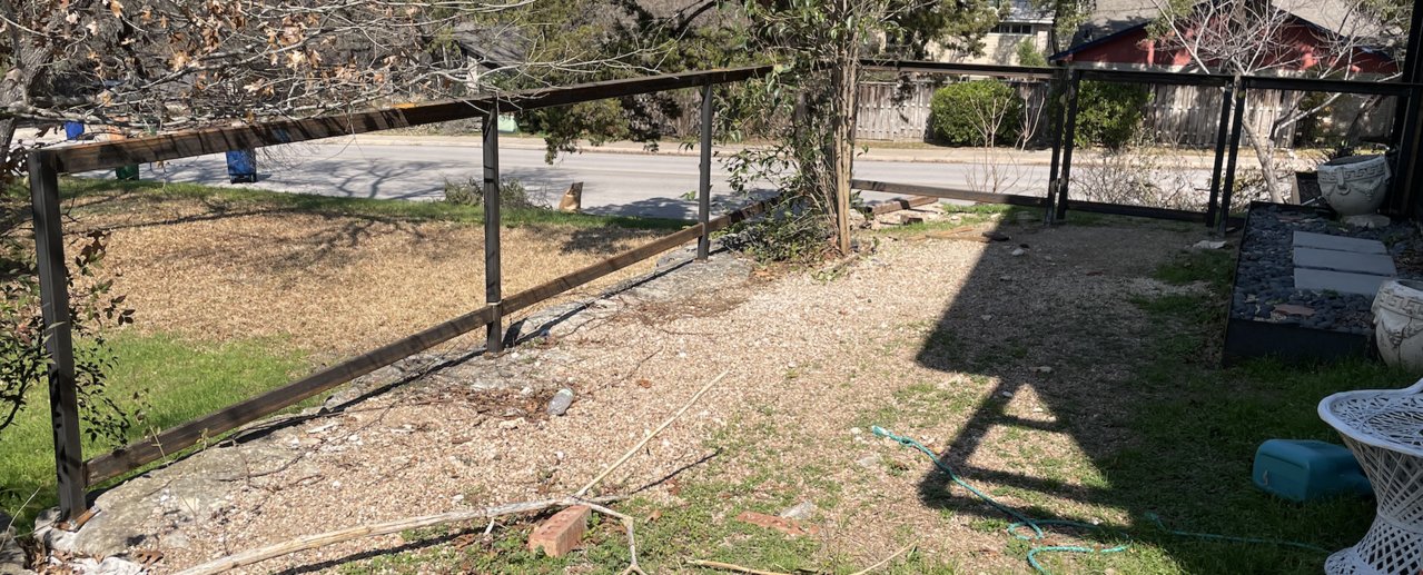

    This fence has been a great project using the welder, grinder, bandsaw, and various other tools. The original wood fence was inside the rocks on the left so I added concrete screws to several 4x4 plates to the edge of the rocks and welded the posts - giving me 28" more width on the side of the house. 2x2 posts with 1x3 runners with a 4" flat bar across the top. I'll be cleaning and clear coating the metal next weekend then adding 1x1 wood slats alternating sides with a gap so we'll see through but it will keep the dog in.
    All in all a fun project - great excuse to have and use all the tools - and great practice for vertical and upside down welds in my futile attempt to improve.
    a lot of good upside down and vertical practice ... amazing how fast the rust comes (this is about 1 week) - cleaning - fixing the horrible spots - and coating this weekend.

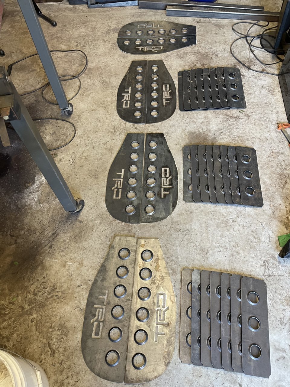

    Lots of plasmas and dimples today. For sliders on 3 DSCB’s with Full fill plates and 1 with just fill plates in the kick outs

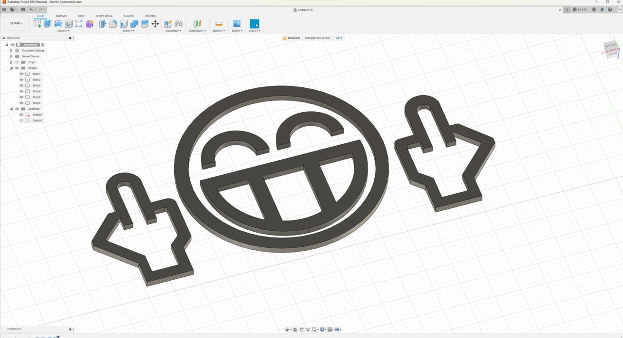

    Thinking I'm going to cut these pieces out tomorrow.
    Use a small plate as a "back piece" and drill some holes in it so I can plug weld this on the front -

    Nice. How big?
    Those eyebrows look like they might be risky for tip ups. In CAM selections you can use the Preserve Order and Entry Point features in F360 to minimize the chances of torch hanging up on one. You select where a cut starts and finishes and where to go for the next cut.

    You could add small tabs for those eyebrows as well. Then just snap them out.
    Did we ever figure out exporting DFX in F360?

    What you guys are suggesting makes sense, I just don't know how to do any of that at all.
    My time limited every day and unfortunately the only time I spend on F360 really is when I'm cutting. And I'm only cutting once a week for a few minutes each time.
    As for the save file, I had to go some weird way about it cause the screenshot you showed me has mine greyed out like I stated before (if you missed it).

    It's easier than it sounds. You just want to pick entry/exit points and paths to minimize risk. See if these make sense:
    Instead of selecting all your contours at once by clicking the face, go through and pick each one, in the order you want to cut them so the flow doesn't make the torch come back over places already cut out (potential tip ups).
    Here for example I'd recommend selecting them in this order: right eye; then left eye; then mouth; then outer circle.
    Then on the Passes tab, select Preserve Order
    Then on the last tab click Entry Positions. You can see I picked so right eye it starts and finishes at a point ending in the direction towards the next cut. Same on the left eye. So if either piece tips up, no matter as I am moving away and not coming back there.

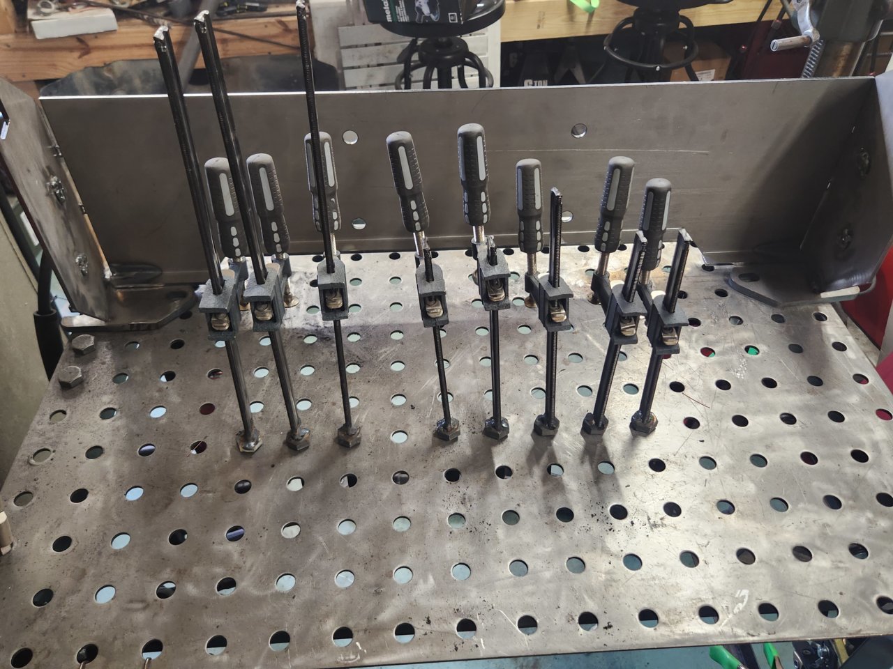

    Basic clamp.
    Looks like he welded a bolt and probably runs a nut on the bottom to hold said clamp?
