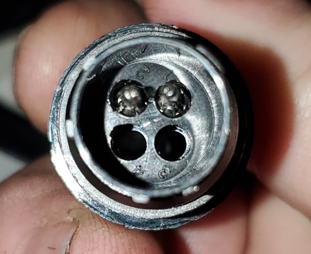

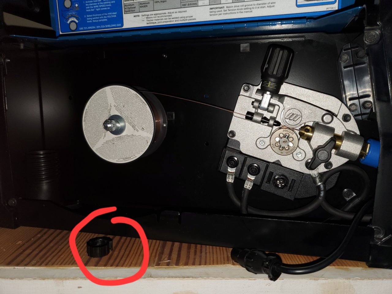

    New machine 141, 110v nothing else on the circuit
    I just found the retaing ring is broken on the gun powerplug, might be the issue
    There are only 2 pins, I assume that Is normal on a 110v?

    Can you get a picture of the connections inside the door? I have the same machine

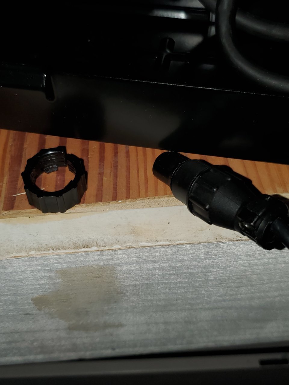

    I unplugged it because I found the retaining ring was broken

    Yup same as mine, aside from the broken ring.
    Id bust out the multimeter and start checking connections between the machine and the tip. If it’s not that then the internal electronics are probably bad.

    I had the same problem with spattered bird shit welds. Turns out the gun connection wasn't seated all the way and the gas wasn't making it to the gun. I put some lube on the o-ring (there's a joke in there...) and it was good to go.

    Yes only two pins a poor connection there would most likely cause intermittent wire speed . That is just the trigger switch
    Try jumping the machine side plug with the wire removed see if you have full wire speed control.
    A shame I have a few of those in my parts . They tend to break if you try to screw the plug tight when the plug is not seated correct.I had my guys break a bunch over the years.
    That should fix things Good luck.

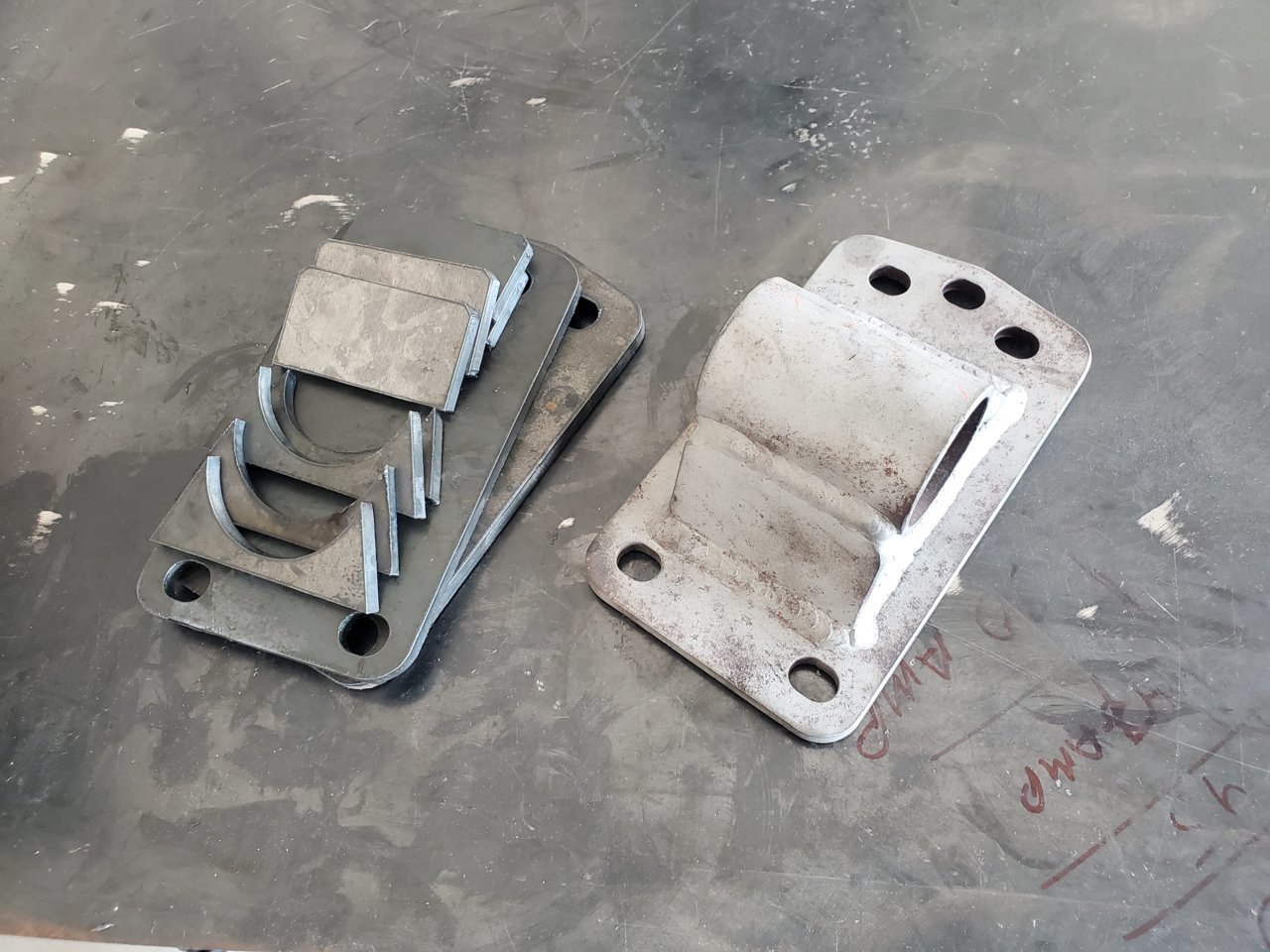

    Got a call last night with some dimensions.
    Cut these out and they're on the way to pick them up.
    One-off crossmember mounts as the motor will sit lower than the other mounts.
    Don't know why but the dross is damn near non-existent this time around on my 12 gauge, 3/16" and 1/4".
