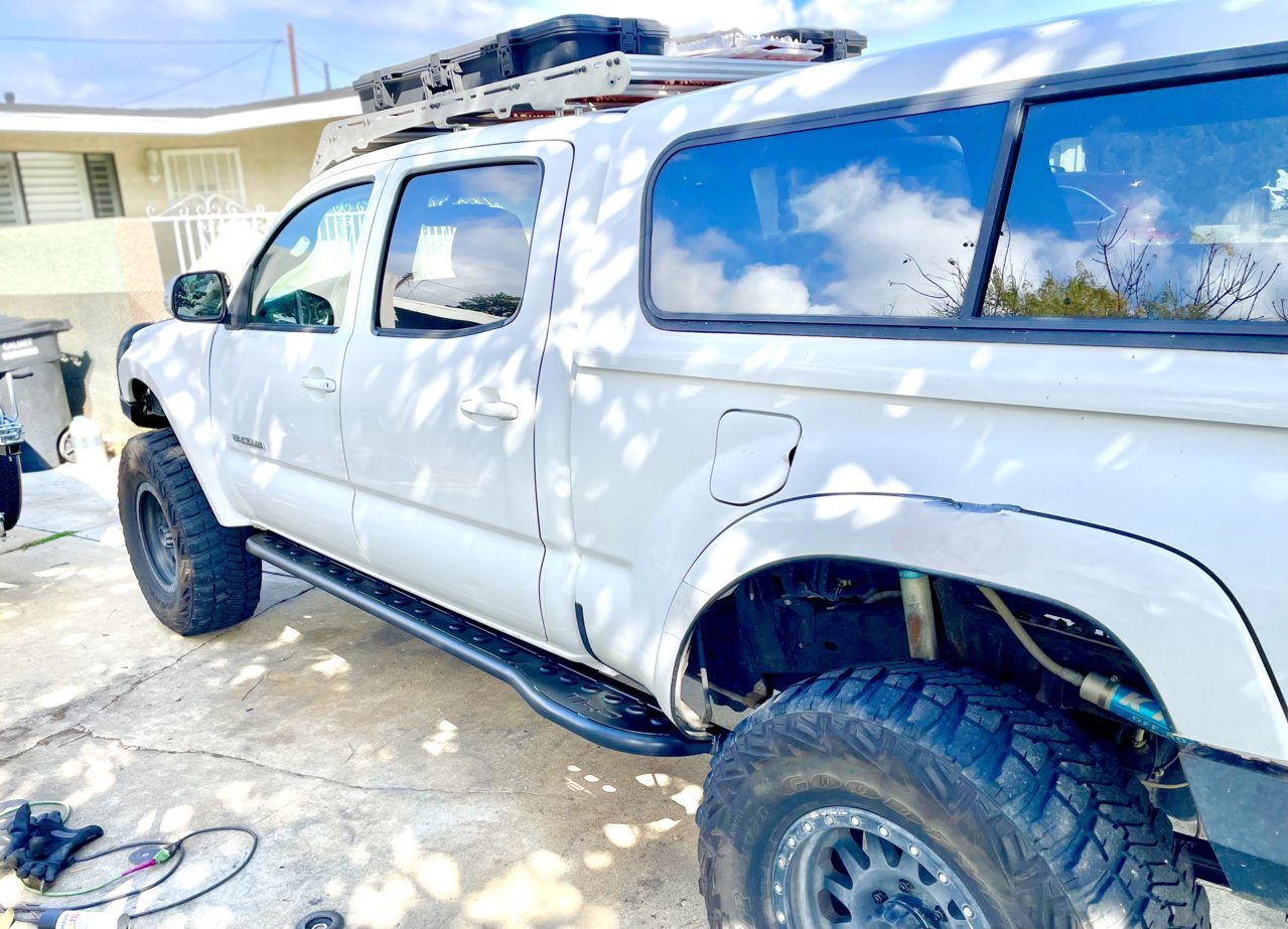

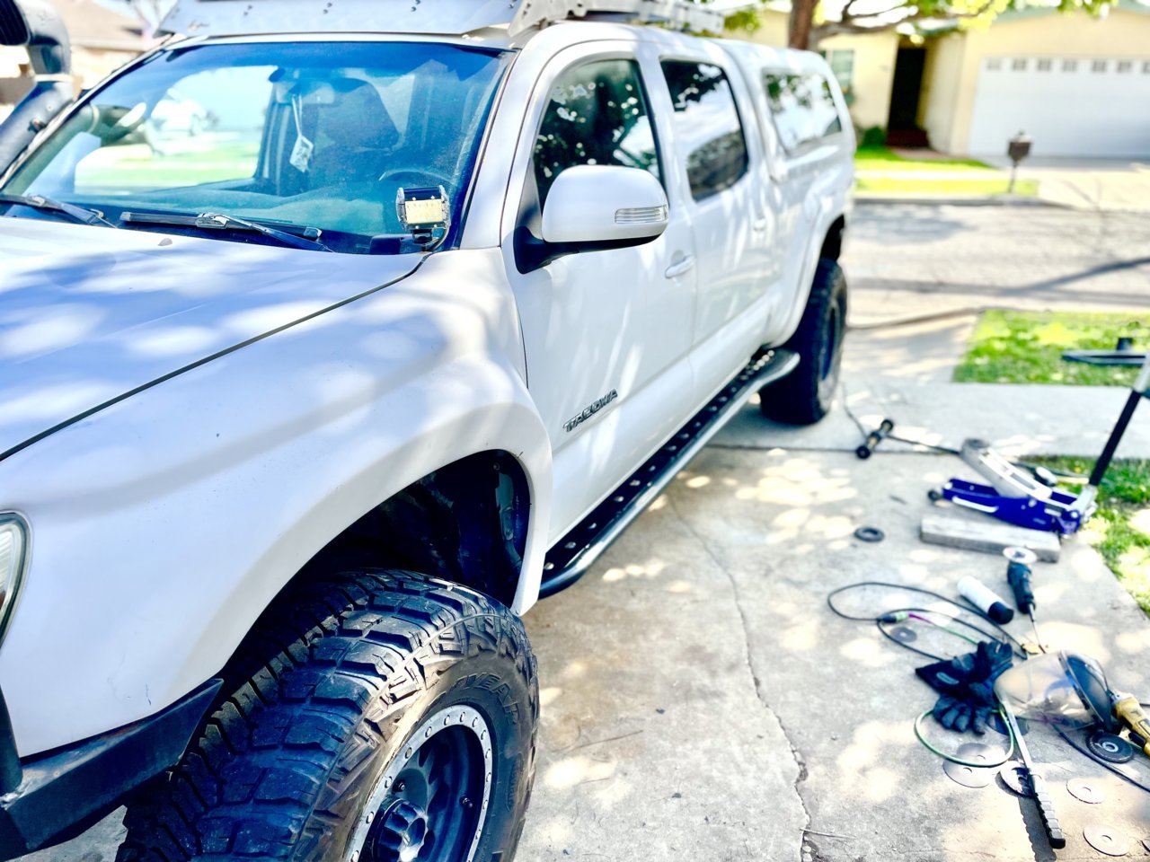

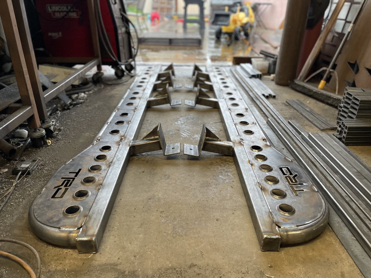

    Finally after 8 years and roughly 700 sets of sliders for other people later, I decided to make a new set for myself!

    About damn time!
    Funny. I built my 1st trailer for myself, someone bought it from me because I said I'd just build me another trailer.
    It took me ten years to build a trailer for myself. I built around 70 before I kept one for myself.

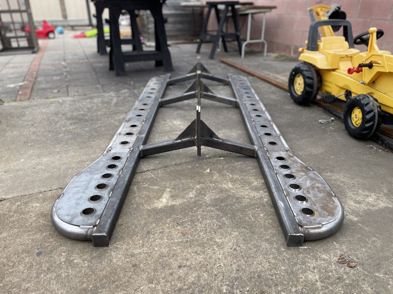

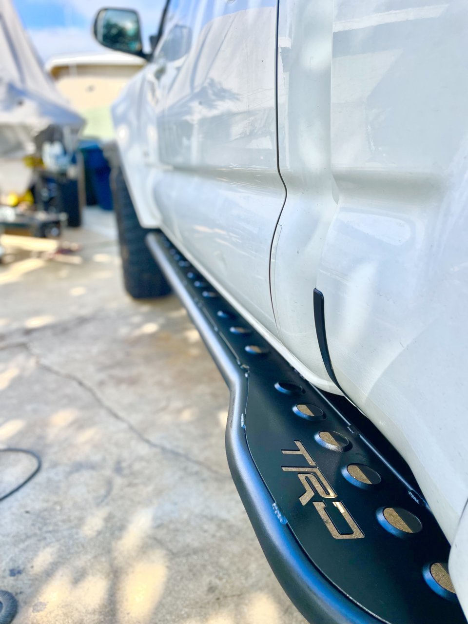

    For real. Real talk, I’ve been wanting to build myself a new set for like probably 2 years now. Happy I finally got around to it.
    What did you do for 10 years in the middle when you needed a trailer???
    That’s what happens. Other people’s trucks usually are priority over my own since they’re bringing in the cash. But I got pretty caught up with my customers and found a little time for myself haha
    DO IT!!! My other set was welded on. What a pain in the ass to grind those off. Hated that part lol. I just made these bolt on. 1/2” grade 8 bolts with 15,000 lbs of shear strength a piece. They ain’t goin nowhere

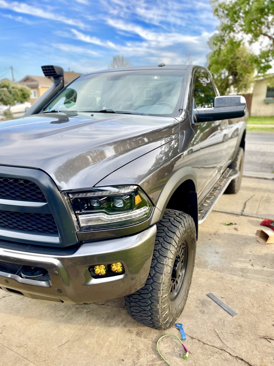

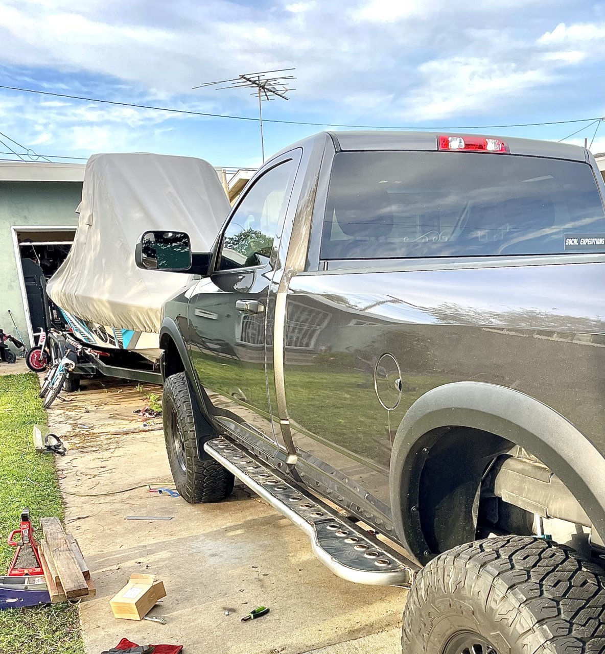

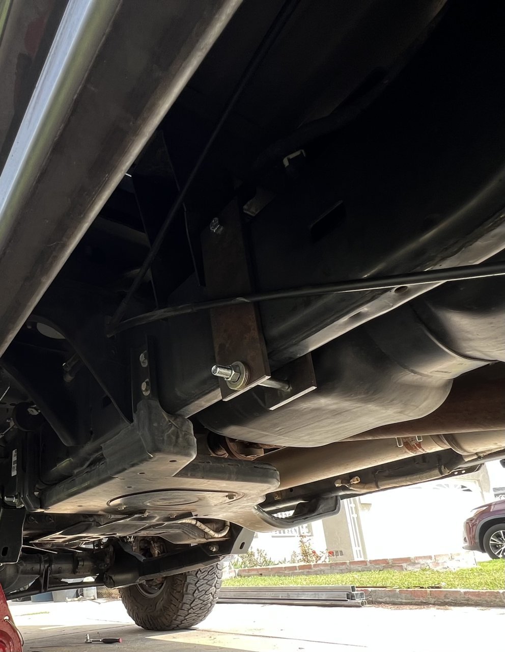

    Built a set of Sliders for my buddy’s single cab Ram 2500. The length of a set of DCLB Tacoma sliders was perfect for the truck. Just had to figure out legs and mounting. Main square tubing was 3/16” since his truck is a heavy pig. Frame plates were 3/8” and we made it like a clamp on with a bolt over the frame and a bolt under the frame with a giant pressure plate from the rear side of the frame. Fun challenge as really nobody makes a set of sliders for this configuration
