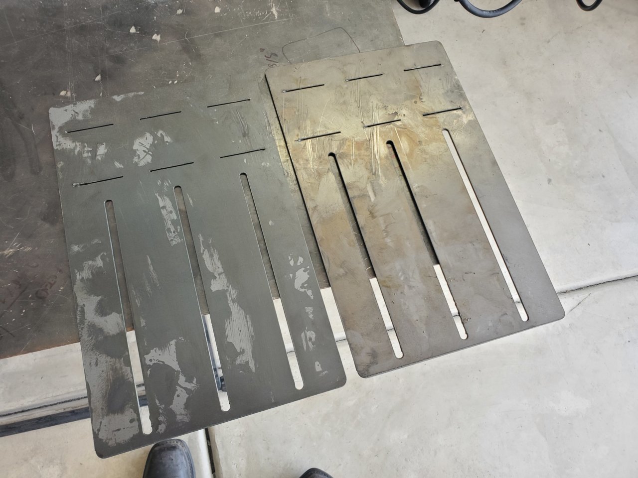

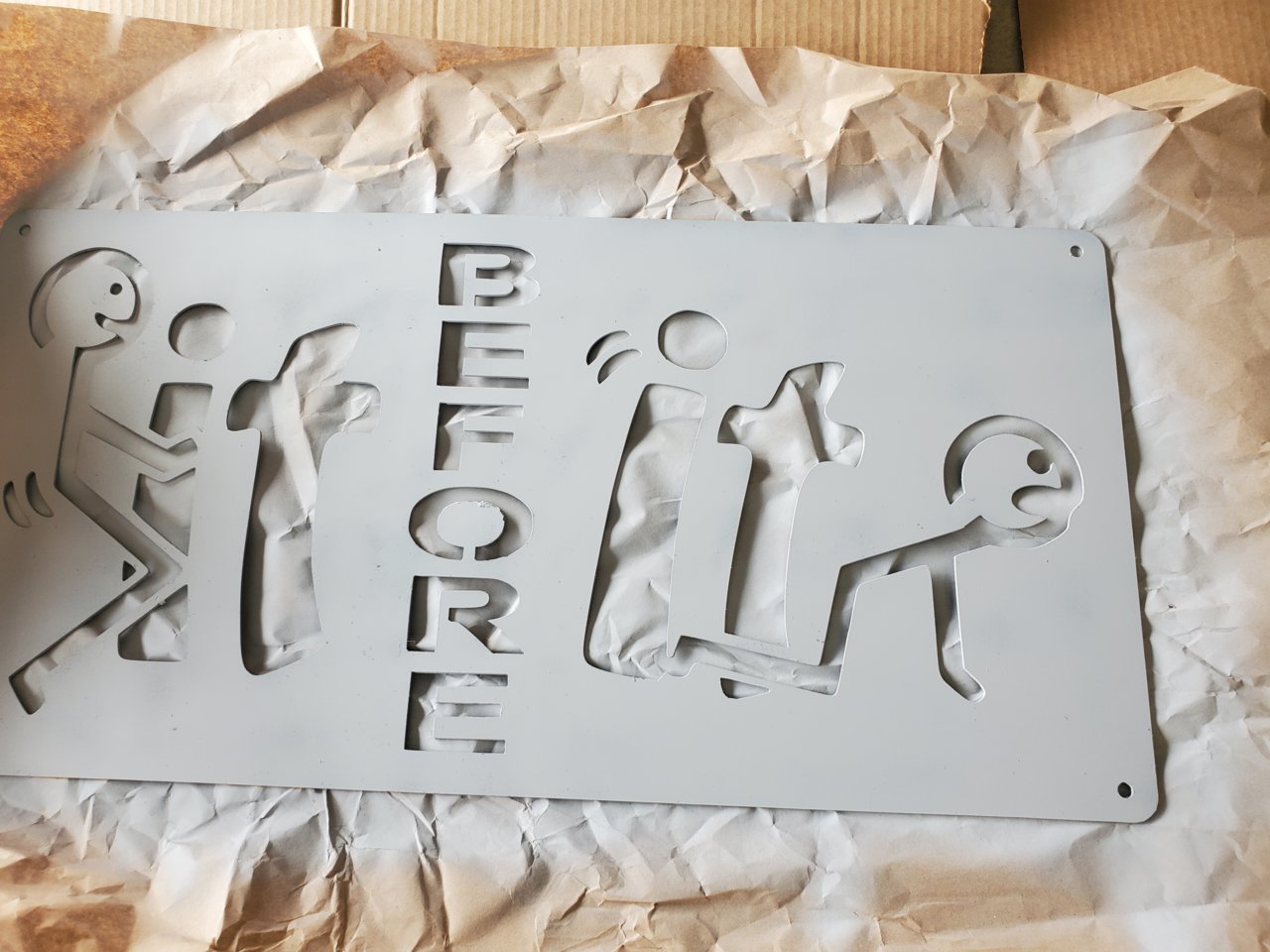

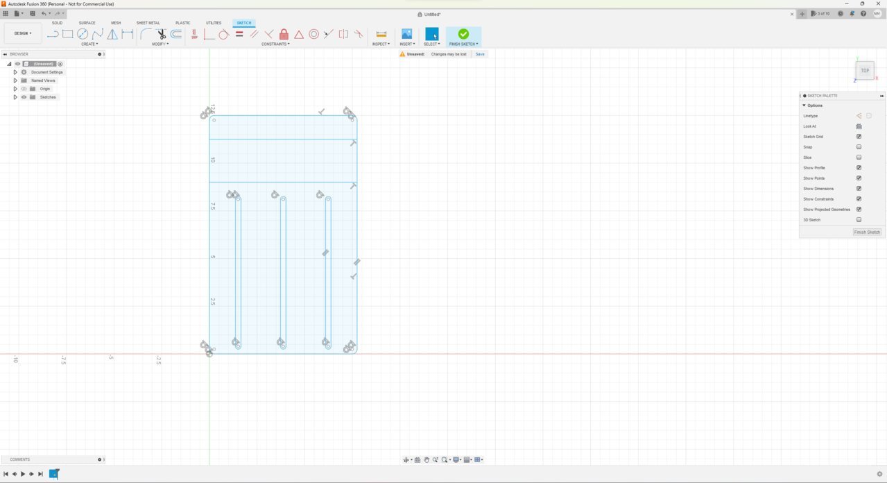

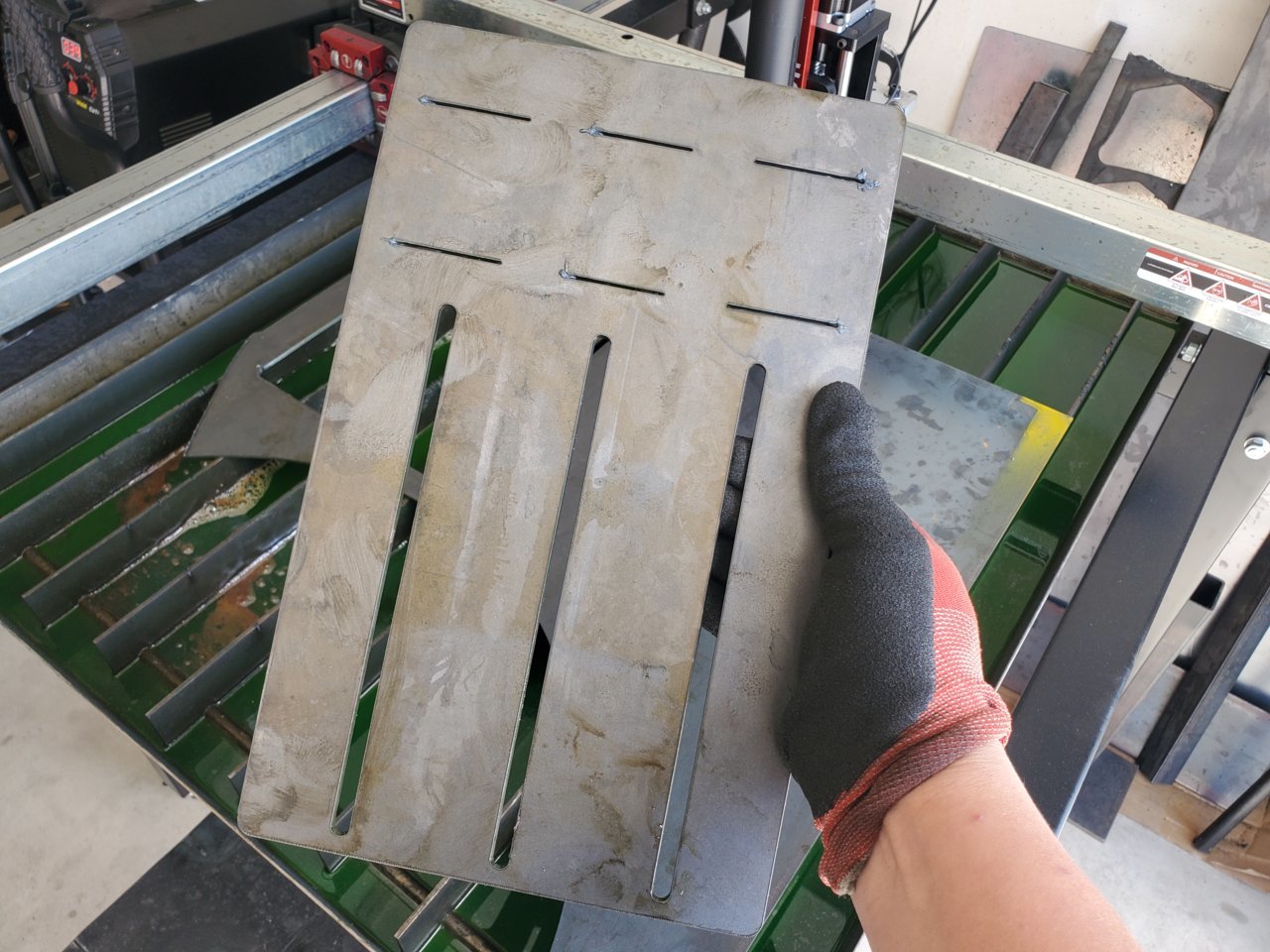

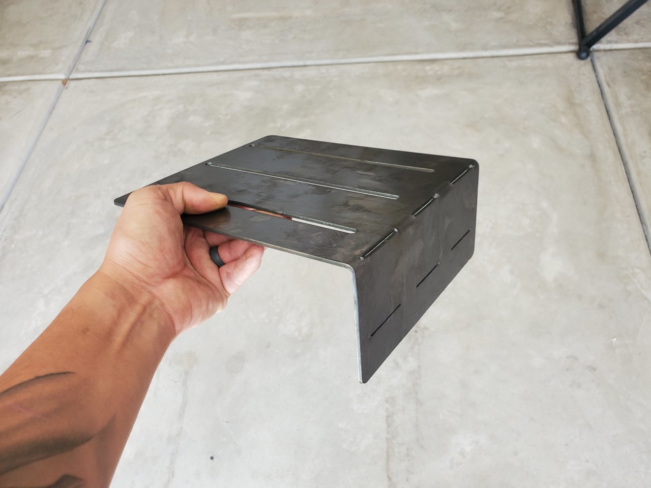

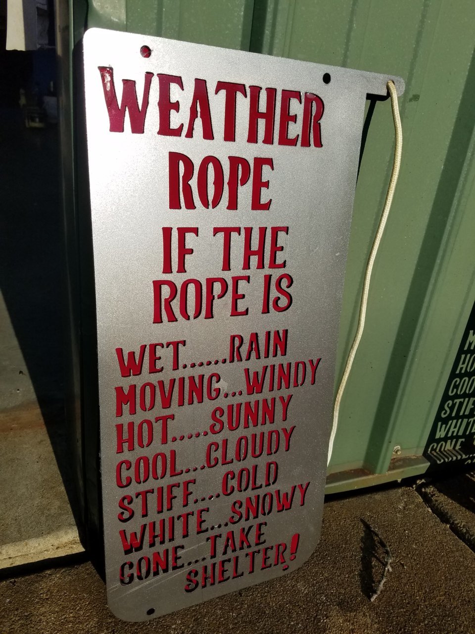

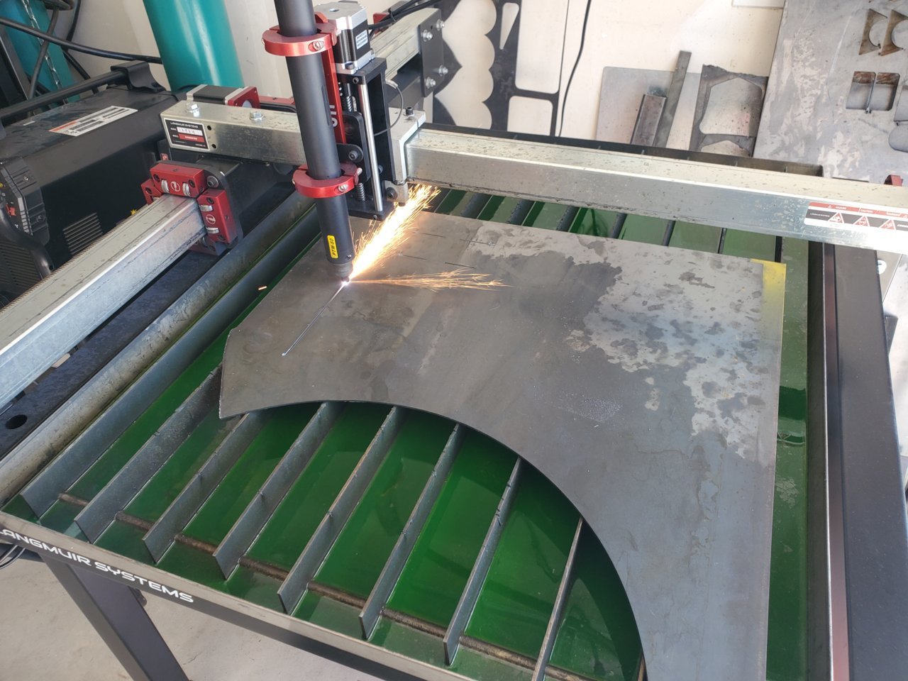

    I keep expecting someone to hit me with "bro, do you even weld?". It's true, I've only MIG'ed once in the last 2 months. I'll take the hit like a man. :anonymous:
    I think I have OCD, Obsessive Cutting Disorder. I can't resist this CNC table. I cut three of these and 8 "FBomb" bottle openers this afternoon.

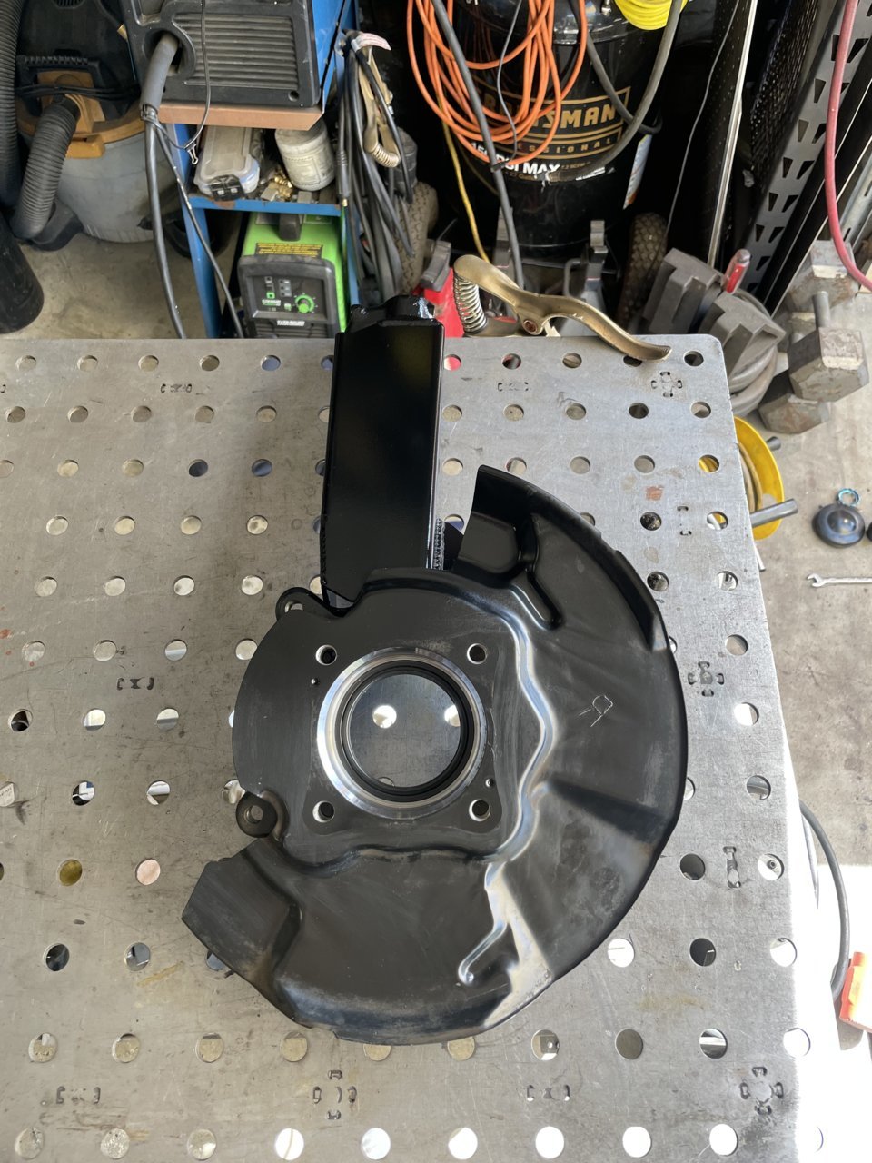

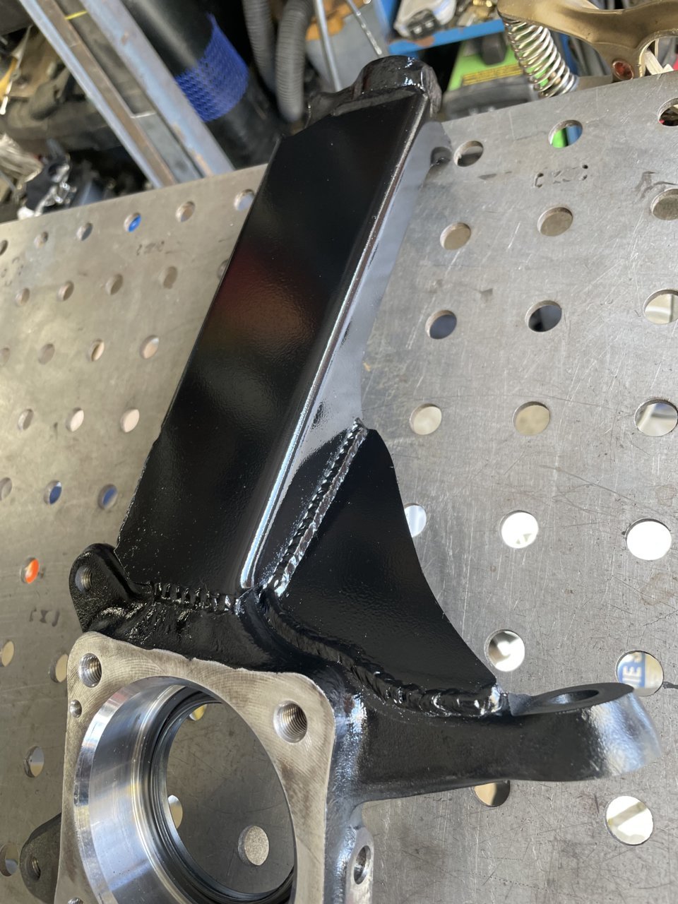

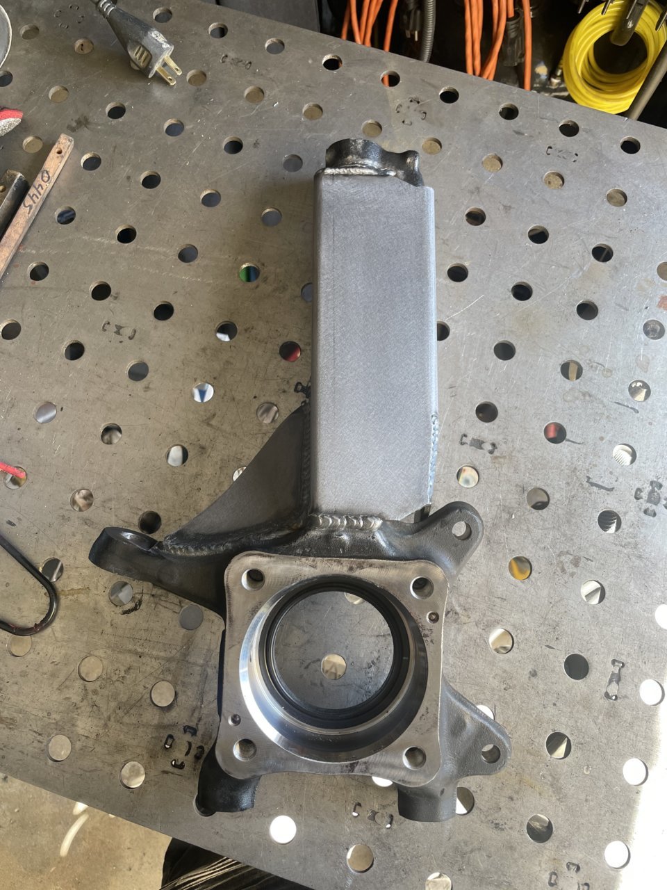

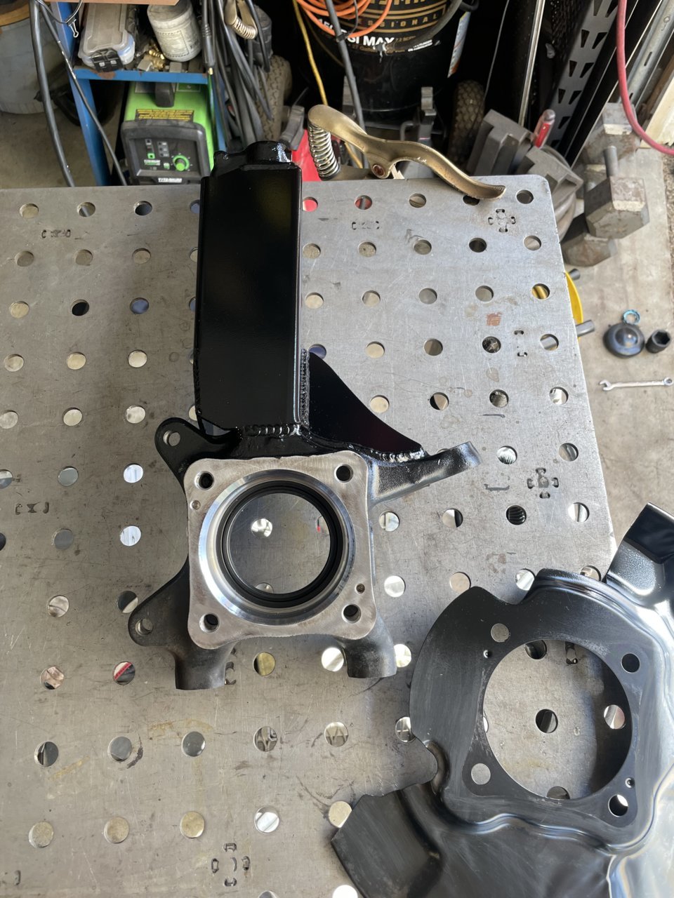

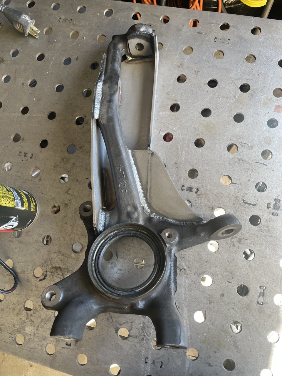

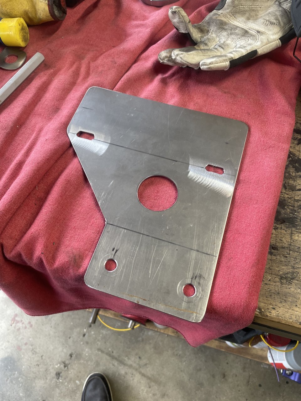

    Welded some TC spindle gussets, does that count?
    6CC33580-1D1C-42DE-BFD2-571F722B1B9A.jpg B80B3127-8D8E-46E4-8E02-6103A3FB3058.jpg 05C7EDB7-7342-419F-A9E2-28E9DEF9F917.jpg 2CC9BCE6-DE9B-47E7-8C4F-31D1E485919E.jpg 44FD3065-0B93-47E6-92A3-AF80A7749FEB.jpg

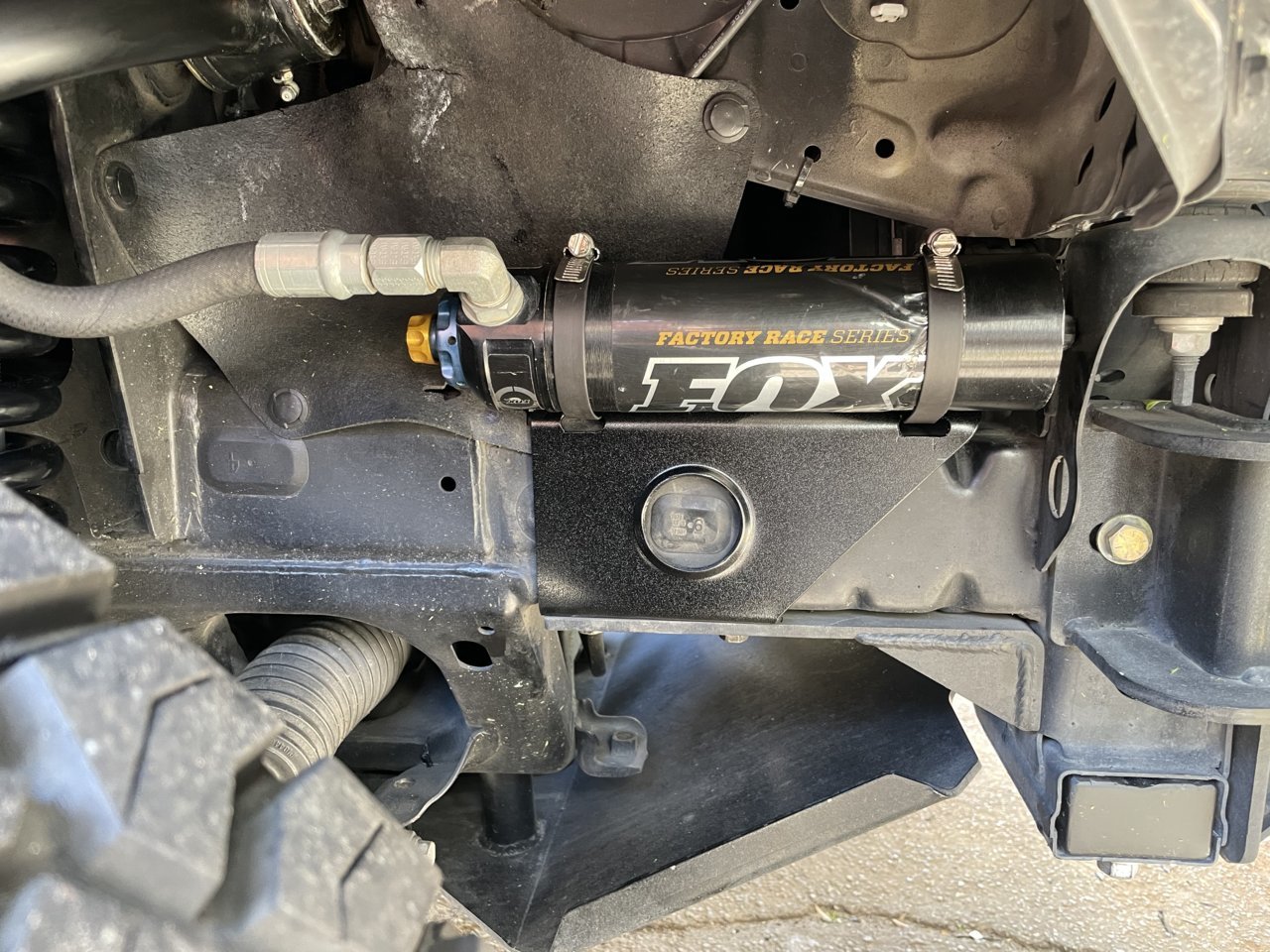

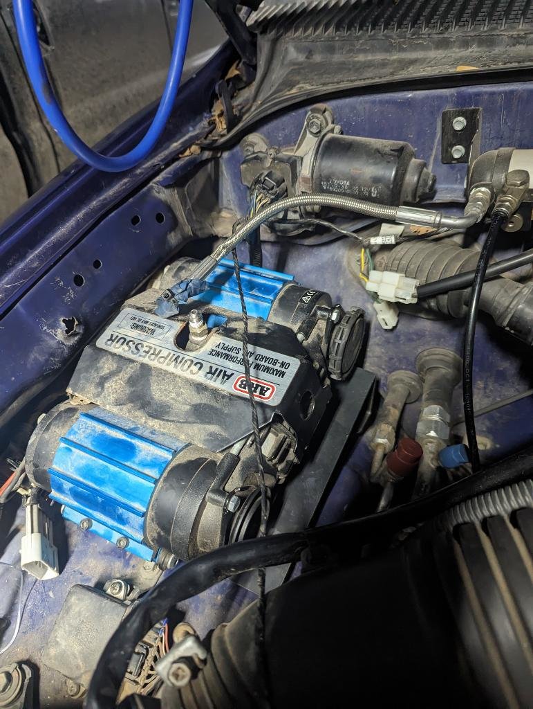

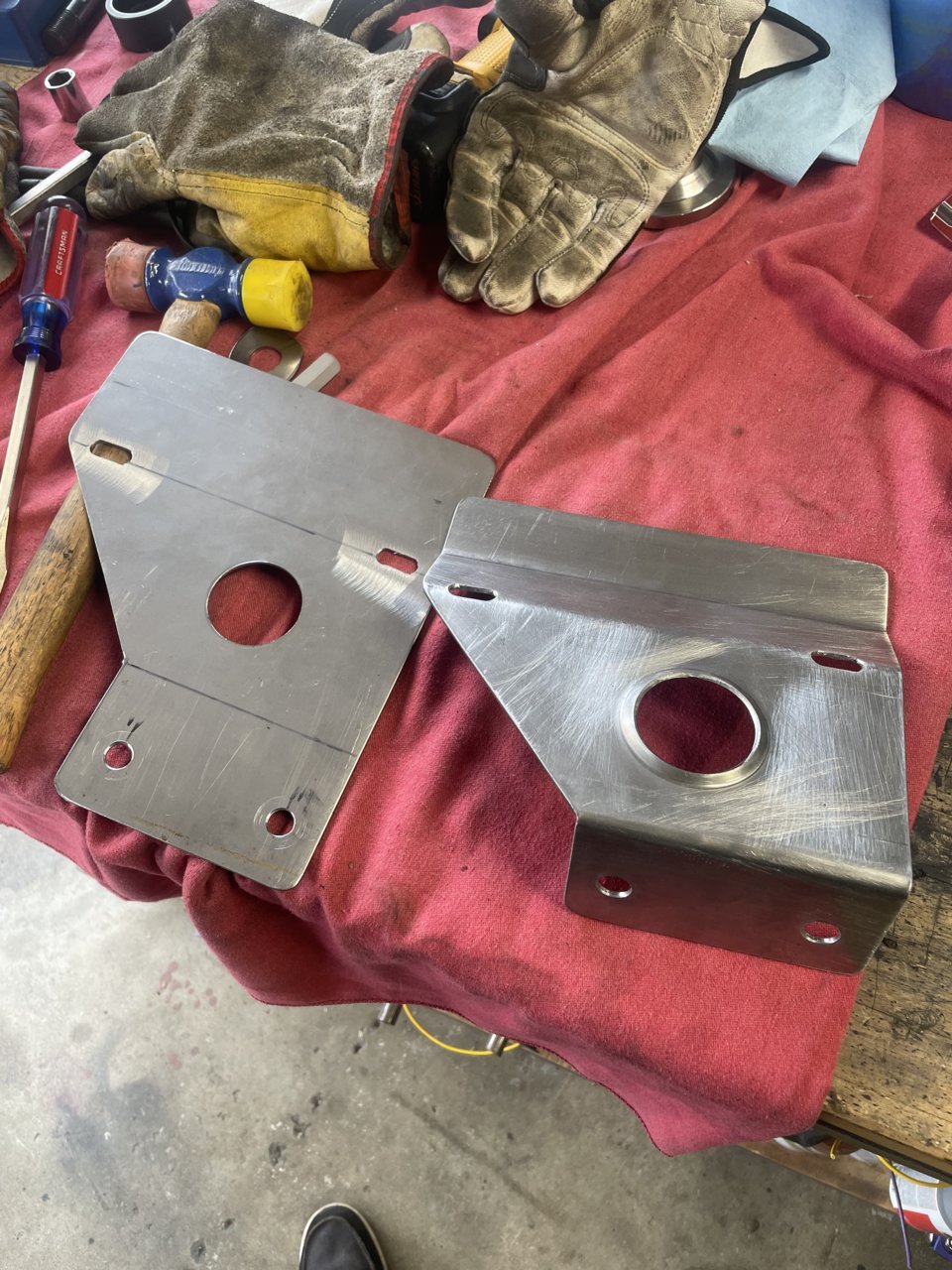

    Also made some RR mounting brackets because I didn’t want to pay $100 for new ones. Kind of a happy accident that the dimpled hole lined up with the access hole in the frame.
    Zebinator, la0d0g, soundman98 and 7 others like this.

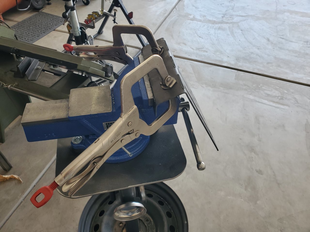

    :rofl:
    Why do you think I made myself a cart?
    I keep cutting shit I don't need to!

    Dope! Nice job man!

    Thanks Ryan. Haven’t been welding a whole bunch lately but feels good to make things when I do.

    Always feels good saving money too. “$100 for new resi brackets? Naw I’ll make them FO FREE!!”

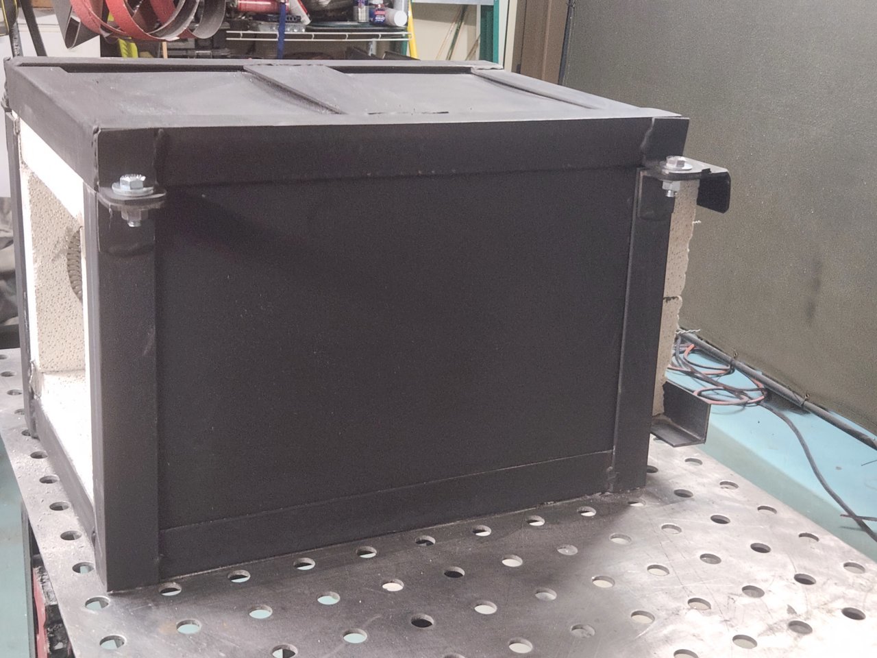

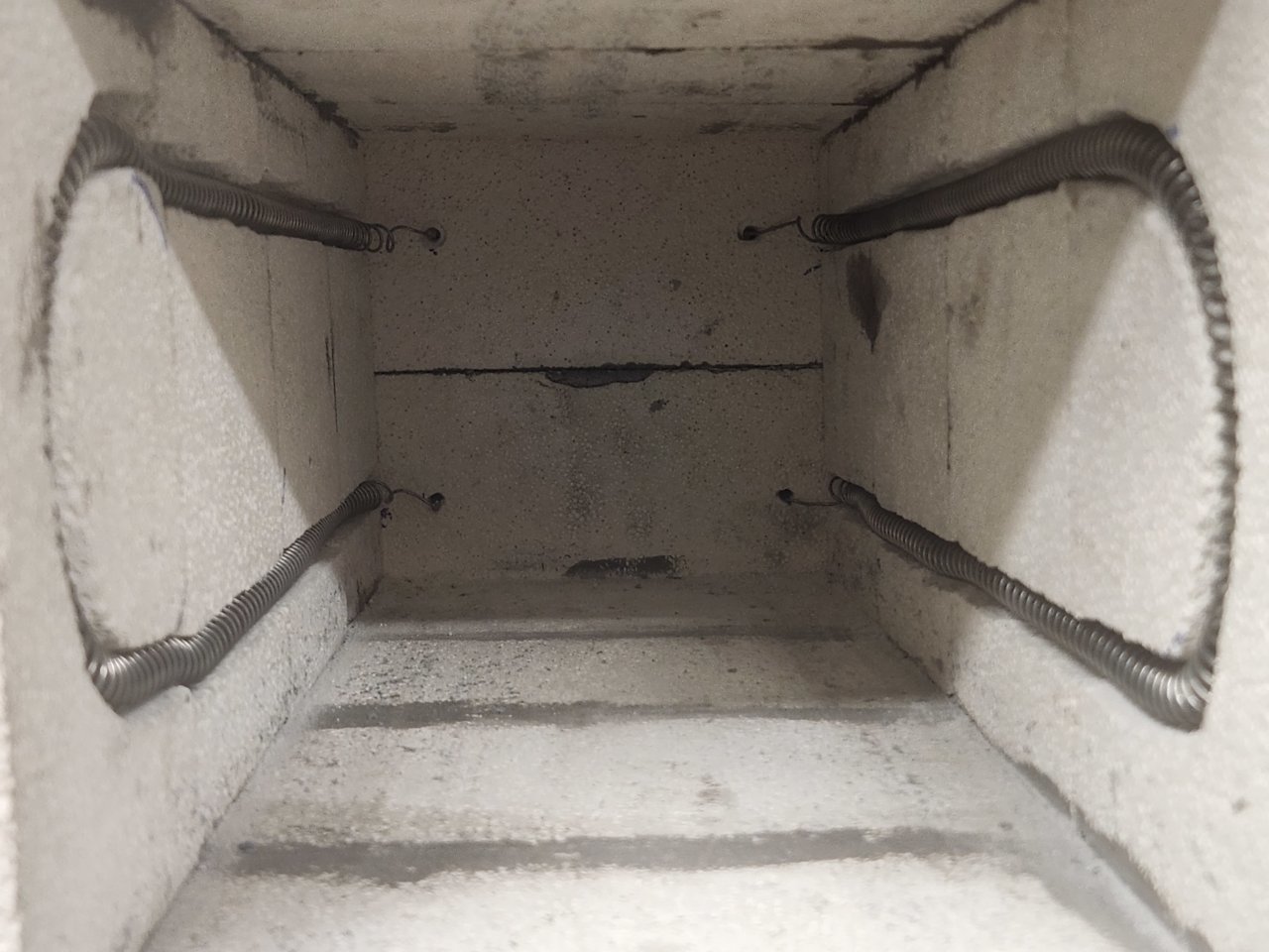

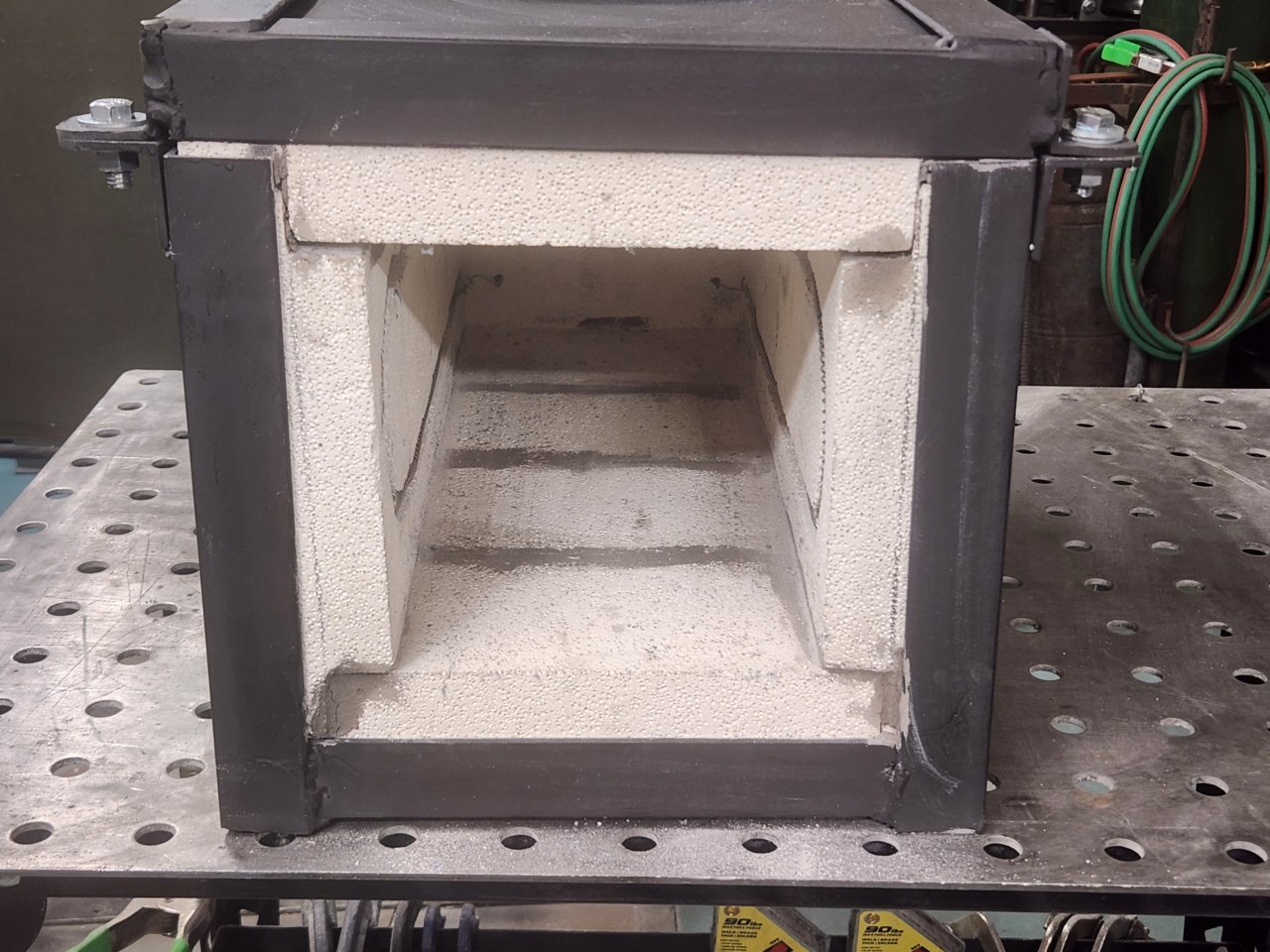

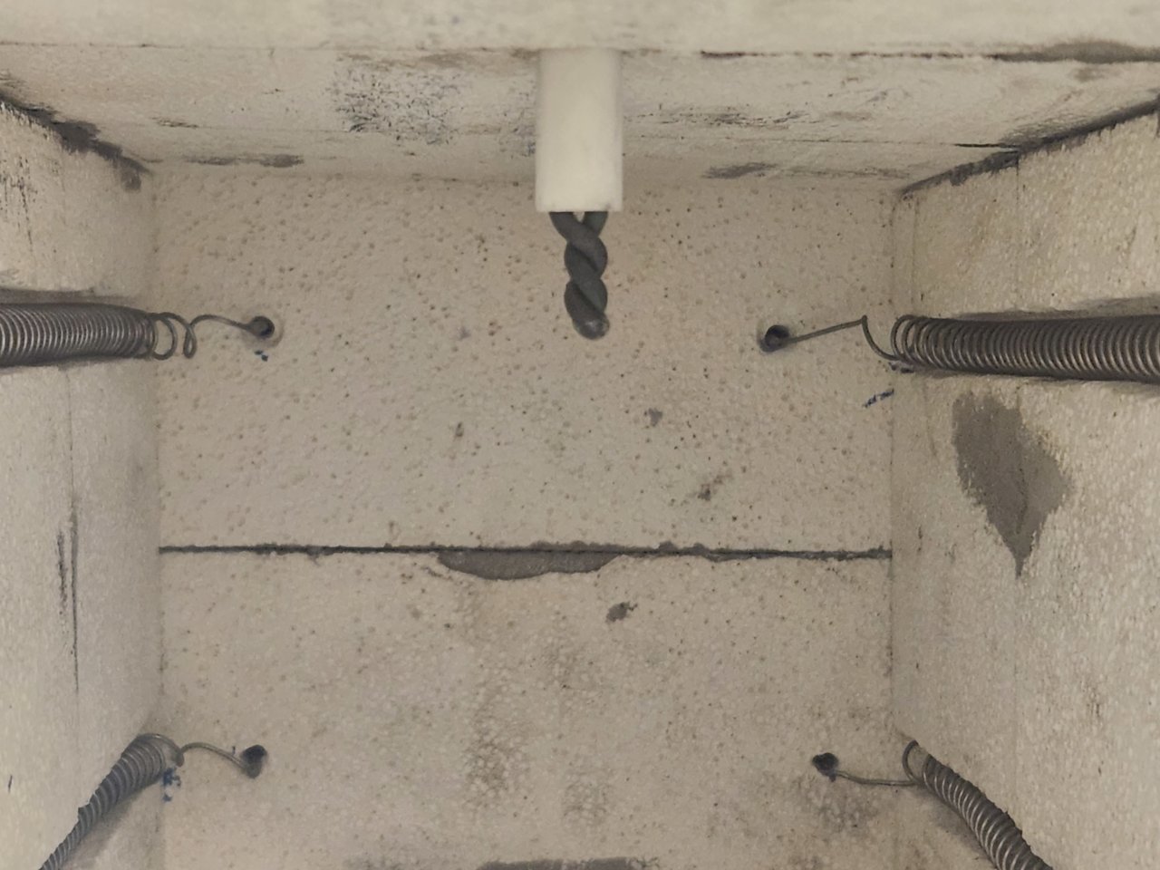

    Little Project I been working on... A small heat Treating oven.
    First version ended up, "going to live on the farm" after it broke and caused a cut eyeball from a fragment of brick.
    the metal frame was a :censored::censored: to get in place around the brick but it should be a very long time IF ever that it needs to come apart. the elements can be installed with the top on and they are the most likely to need replacement in a few years depending in how much it gets used.
    7"x7"x18" and comes in right around 8200 watts. 34amps @240v an the brick is rated for 2700F
    I still need to build the door, and wire the PID controller up

    How much does that thing weigh, and are you going to build a stand for it?

    Right now around 130lbs an yes a stand will be made for it

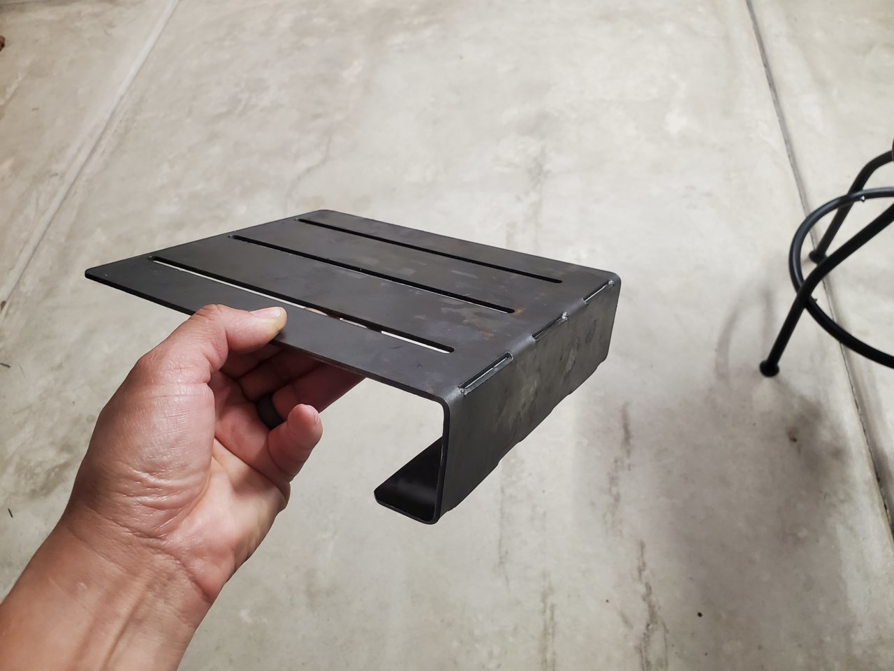

    Bracket received and it fits like a glove -

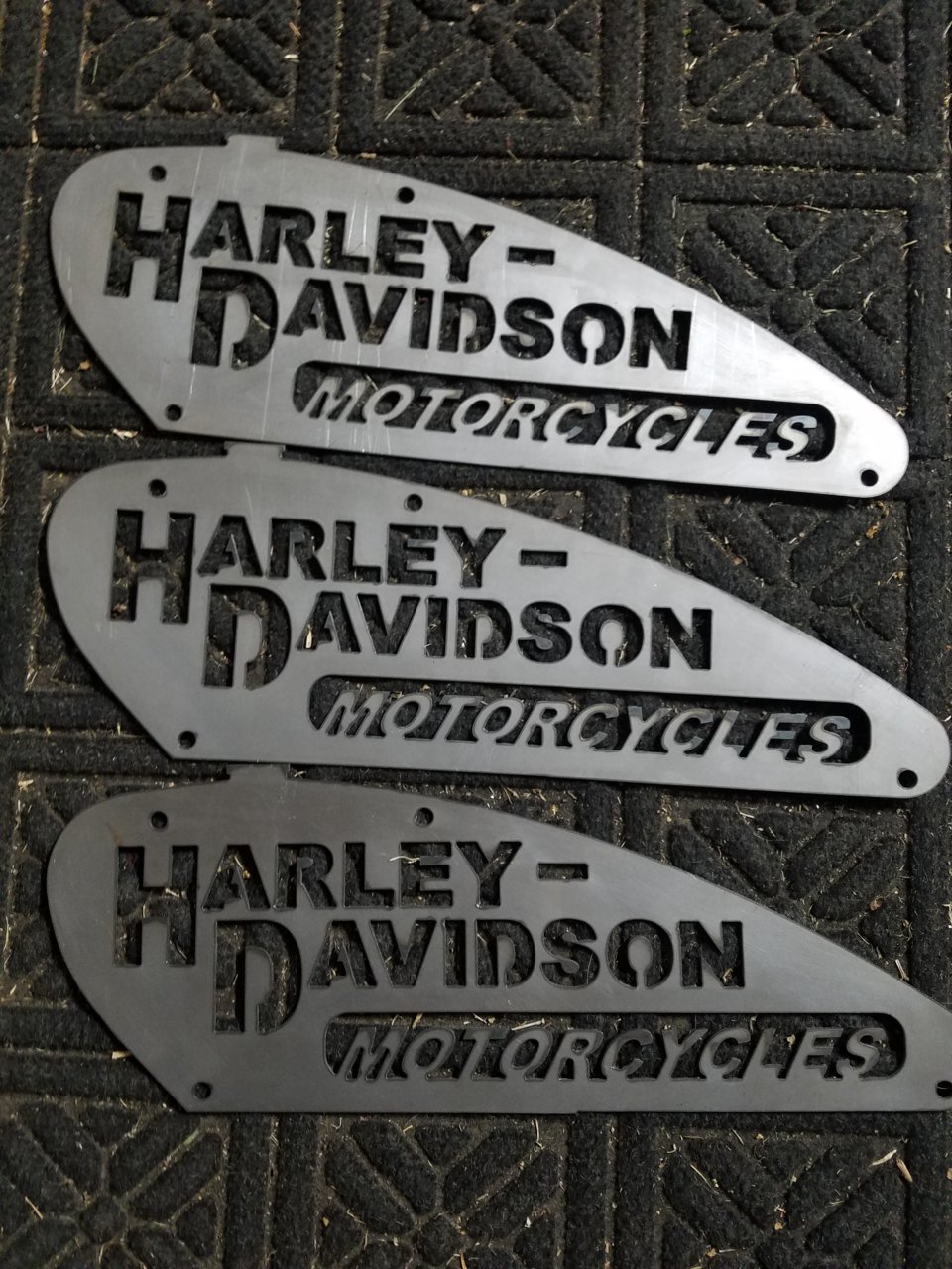

    I have a friend who loves Harleys. He has three. He bought my last one.
    He and his super intelligent wife home school their 3 kids. Ages 5-14.
    I cut these this evening to give to his wife and tell her this is for art class: bobber tanks 101. Their Dad will love the results!

    It's alive...
    Did the second firing today, took it up to 1500F. Previos was 800F. Working uo to 2100f in stages to cure the mortar.
