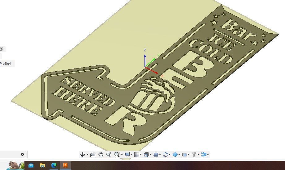

    There are several versions floating around. The one I got would likely have cut okay without massaging it. However, I redid the top 1/3 of the sign so I could fit the "Veales Bar" and the stars. I added the wing tips at the top too.
    I have another copy of it where I just replaced their name with a larger font "Bar".
    We need to see if we can get permission to share .dxf files in this thread.
    @tcBob there are some of us in "Anything Welding" who are regularly discussing plasma cutting signs and the CAD files that are required to make them. We can't share the image files we use in our CAD programs.
    Any chance we can get permission to upload .dxf file format info here? The file sizes are a lot smaller than a JPEG.

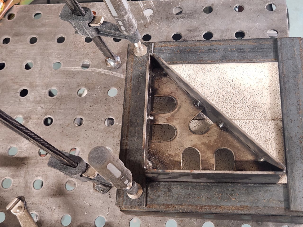

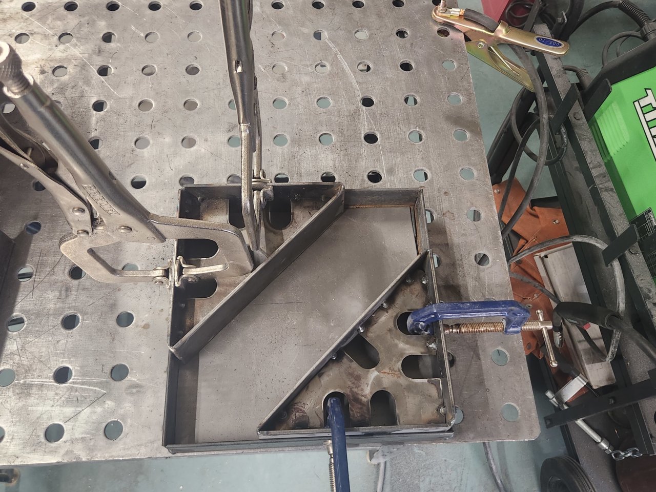

    @koditten I think you may recognize the welding squares...
    First time I really got a chance to use them.

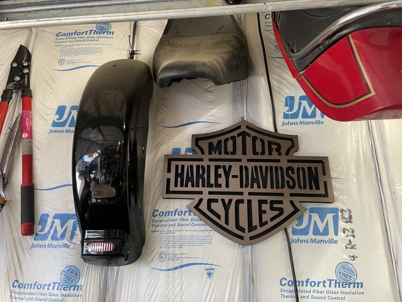

    Just got home from a week on the East coast and finally able to hang my new sign from @Wsidr1
    It only felt right to hang next to my FXR fender above my tools. Sadly it was also the only free wall space I had. Yamaha tail section is just above it.
    If you zoom in on the fender, you can see my bike and truck is the reflection. I painted that fender a few years back for my last bike.

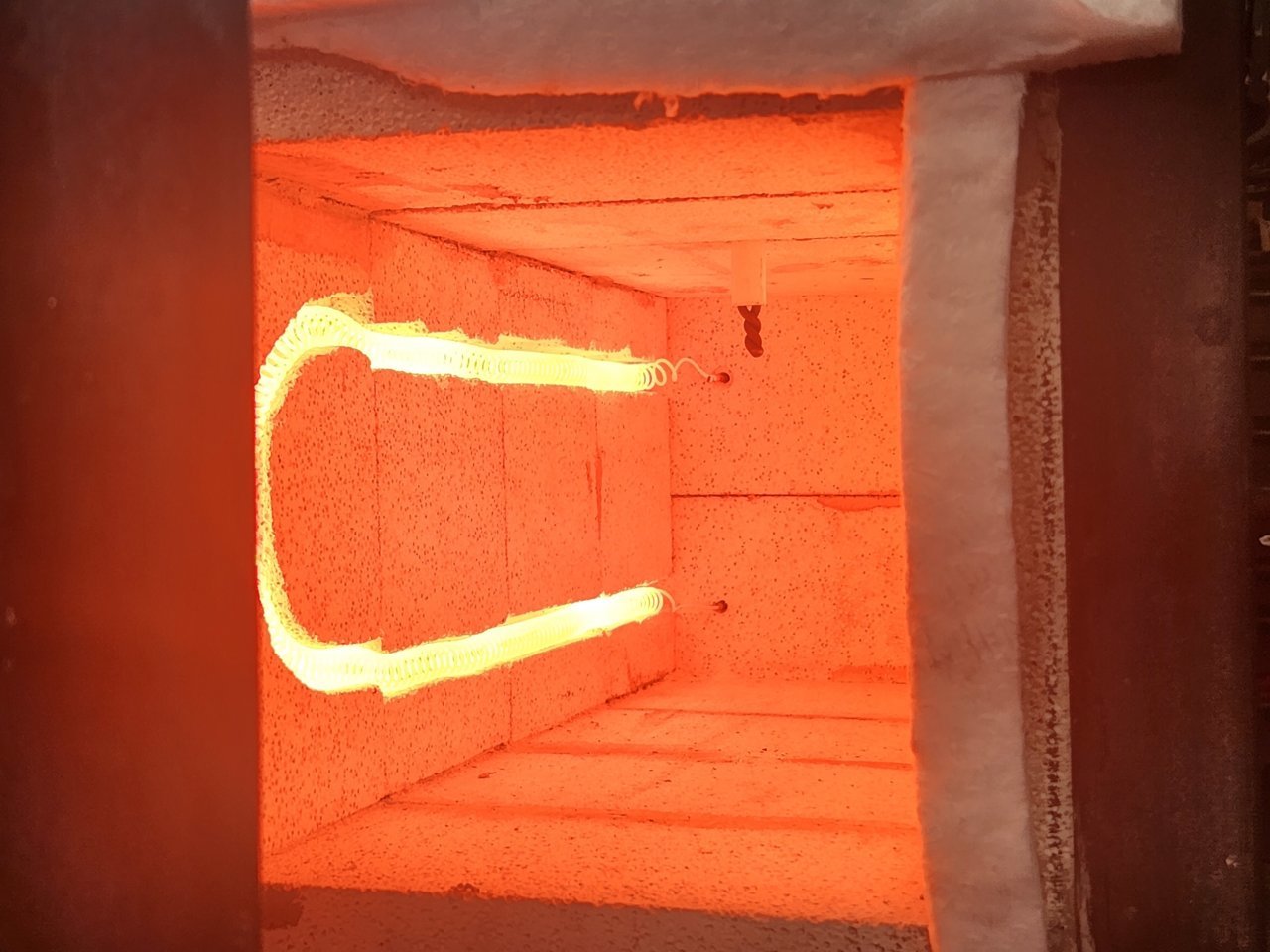

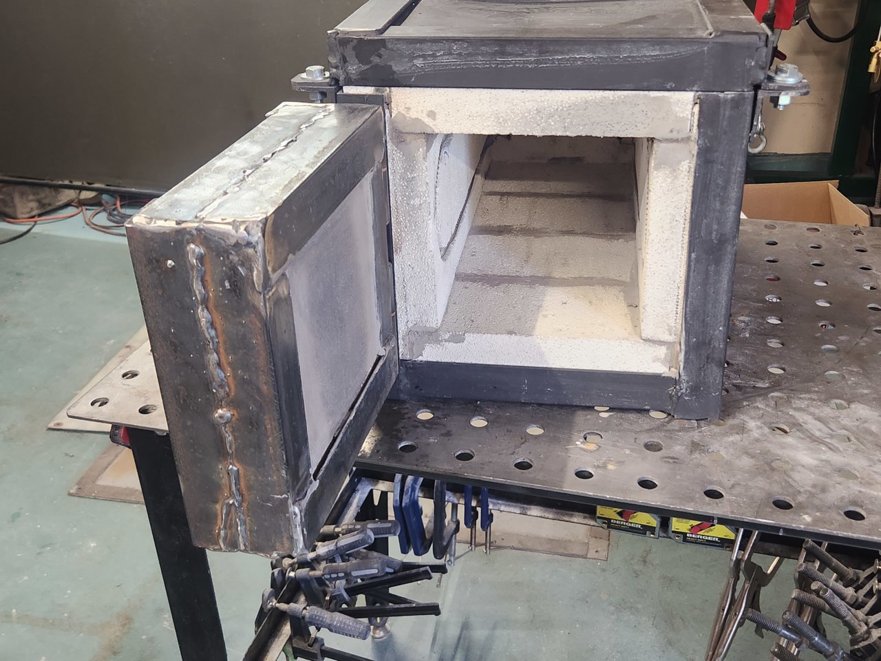

    Very cool - I am curious to hear how this works out for you. I'm more and more making little tools and would love to be able to do a little case hardening.... This is a whole rabbit hole I have yet to delve in to...

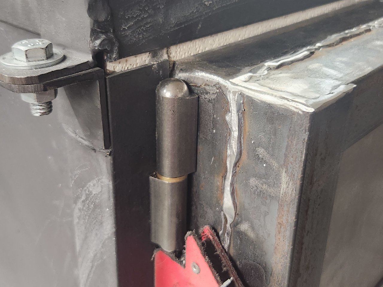

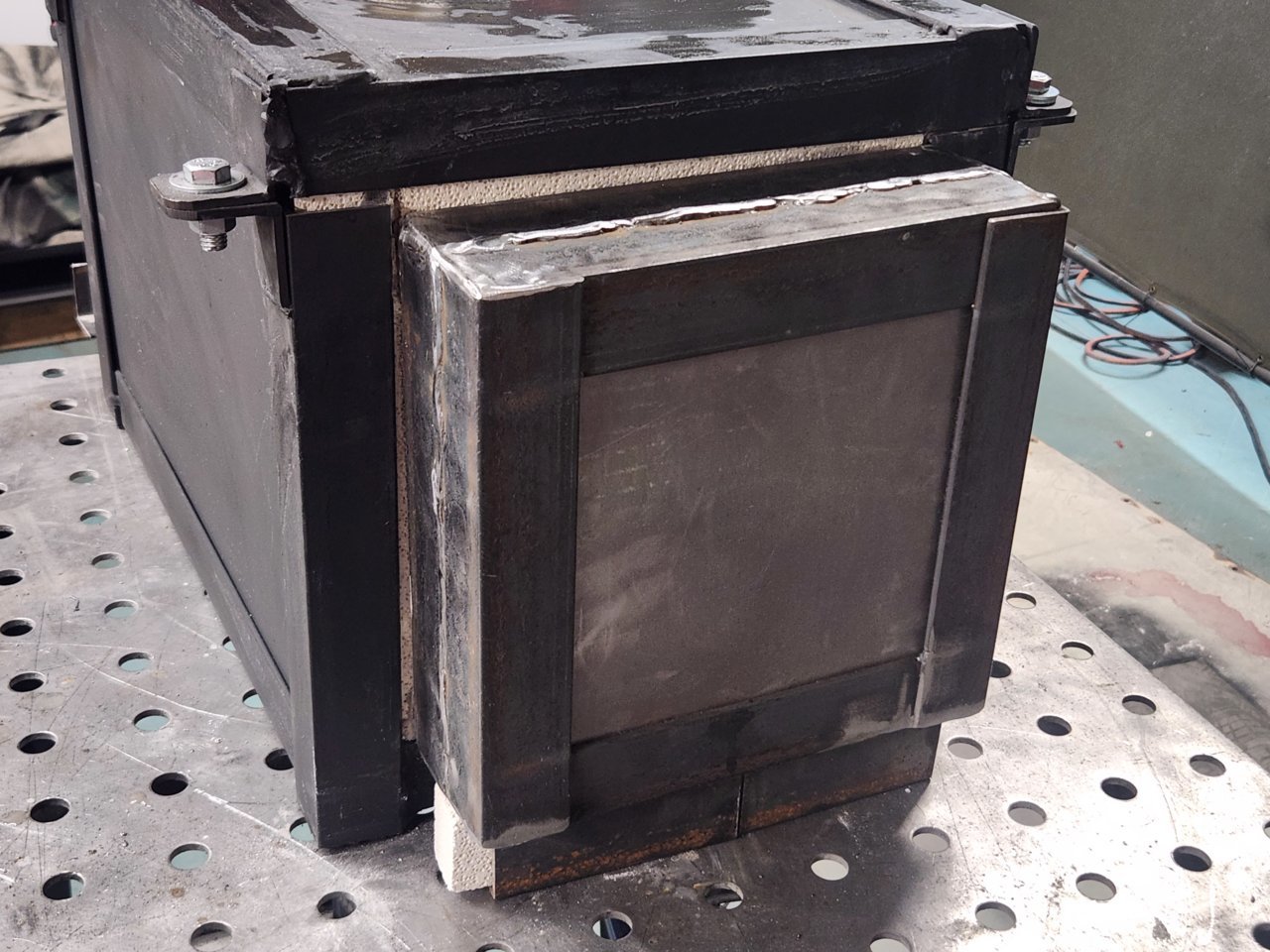

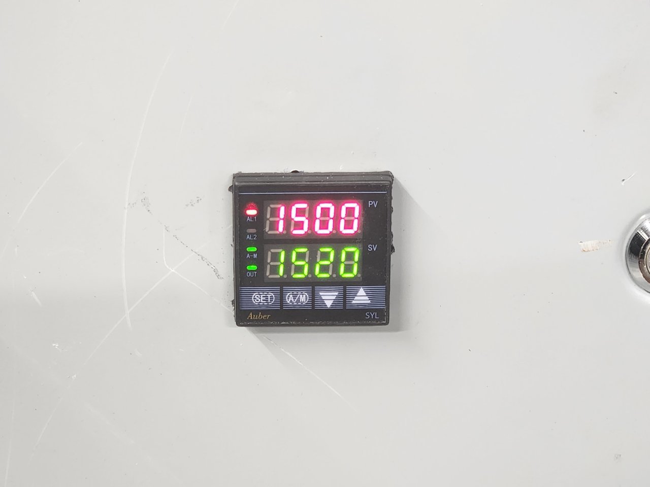

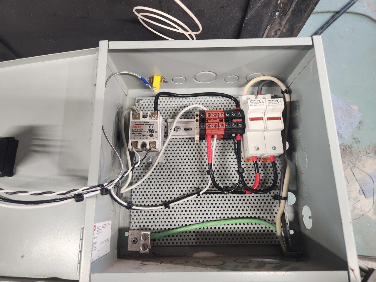

    case harding is something I want to try as well... once i got the door latch done an gasket installed it hit 1500f in 30 minutes an a measured current draw of 19amps per leg @1000f
    Hopefully this weekend I can use it to actually heat treat something

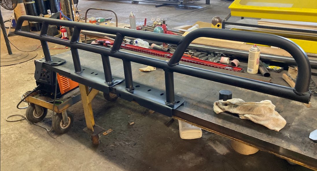

    First set of sliders. I learned a lot about tube coping and ended up creating a homebrew 4th axis for the CNC plasma after hand cutting 90% of these parts.

    I sure would like to see a vid of this...

    I assume you mean the 4th axis... [warning: poor camera control]

    Very nice! Exactly what I was hoping to see. Thank you!
