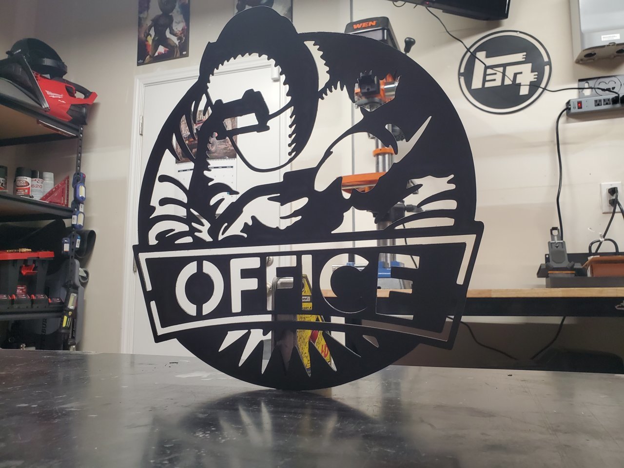

    I did, unfortunately I didn't realize how bad they were until I cut out that Office sign 2 weeks ago.
    The face shield part of it came out a bit jagged as it failed to cut through the first time around.
    Fortunately, the rest of the sign came out really good.

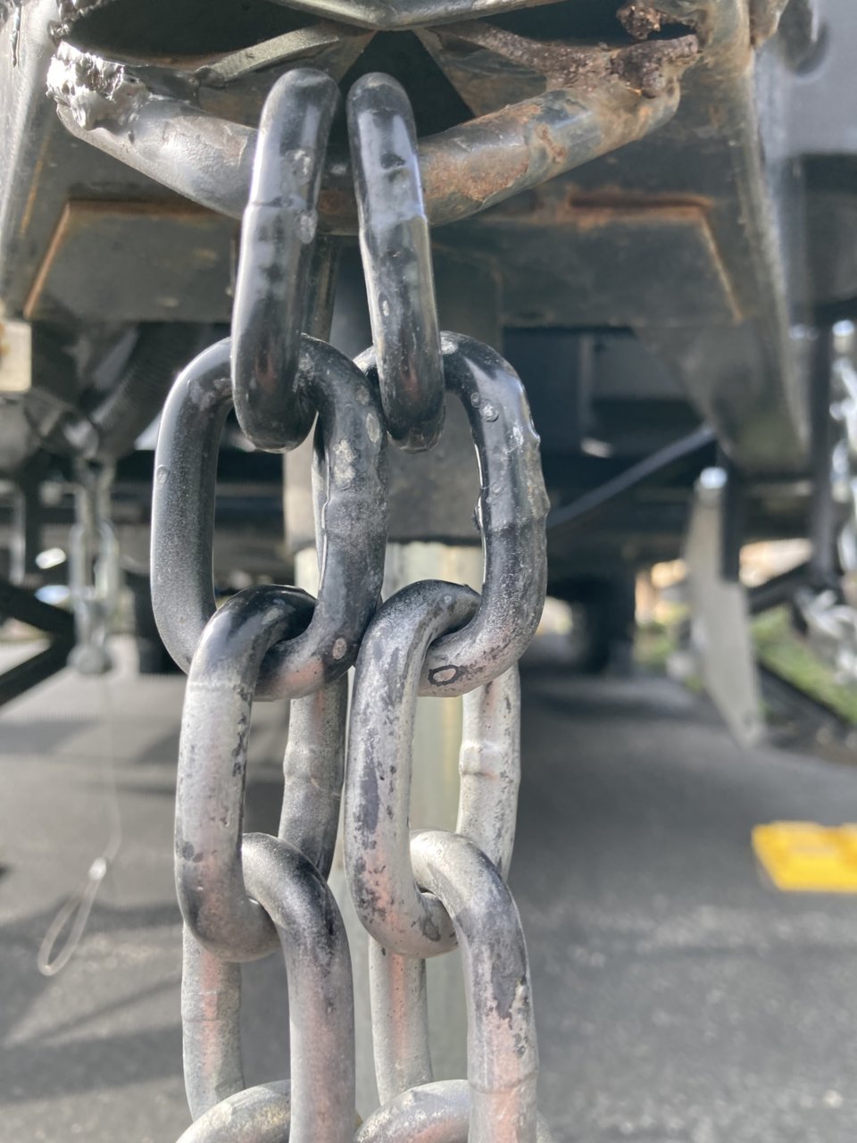

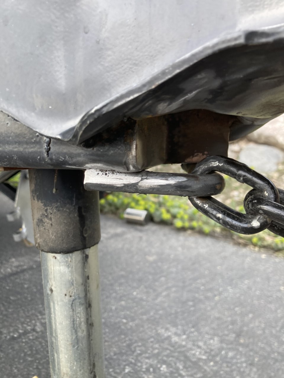

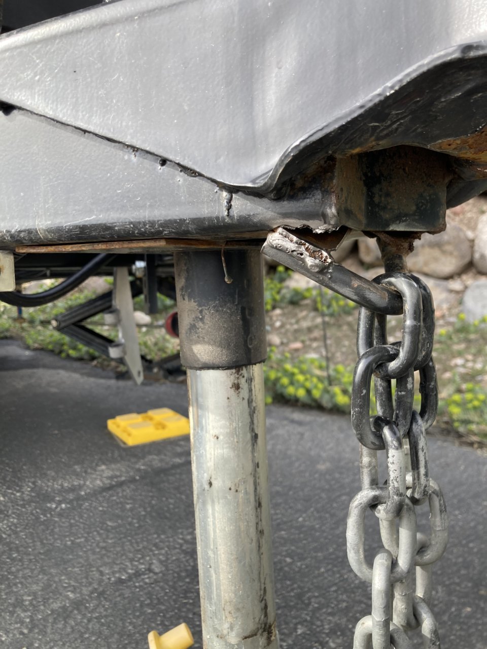

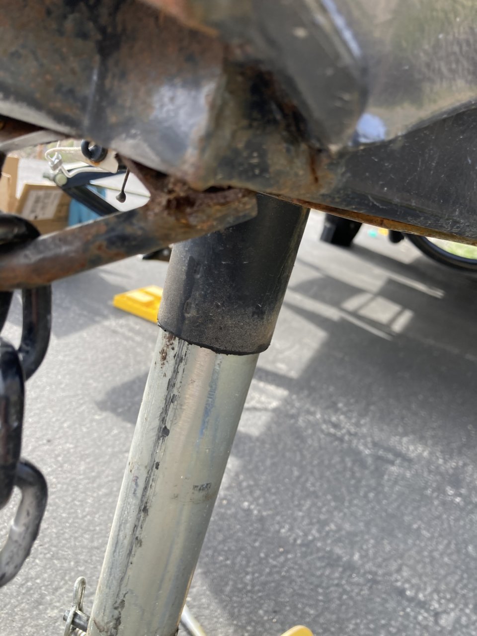

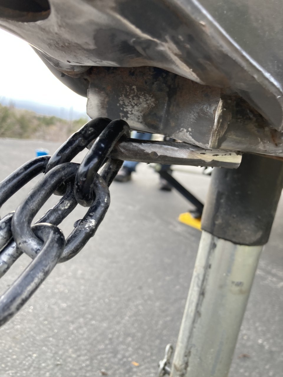

    Wife and I recently bought a camper that was delivered from out of state. The dealer took full advantage of the situation and sent it with a piss poor deliver prep. Lots of mess and a few broken things so far.
    This is the latest we’ve found, didn’t notice until today. The safety chain attachment point is all busted up. Got started on cleaning it up and getting it back into place. Ran out of time, will have to get back to it later this week.

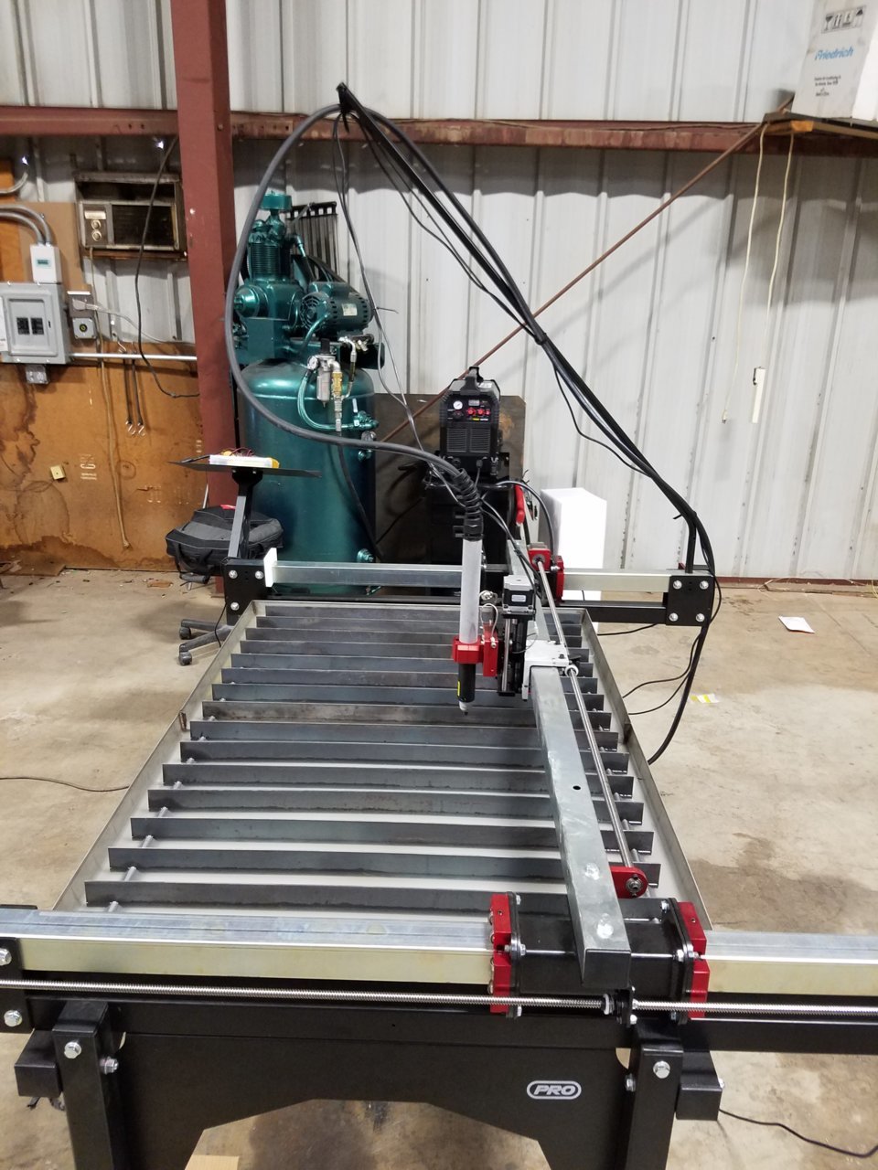

    Its still a valid question, and meant more than anything to prompt the thought process of tracking usage and checking consumables more regularly. Each system, material, and location will definitely give different amounts of usage (within reason, otherwise there is a problem) but one can start tracking their system and get a pretty good idea of expected life to preemptively change consumables before failure and part loss.
    For example, on our arclight table, for one particular repeat customer, we have a cutfile of 36 parts with about 50 pierces. We know we can cut approximately 11 of those files with new consumables (2.75 sheets of 60 x 120 x 3/8 mild steel) with impressively regular consumable failure half-way through the 12th set of parts. Saves us from re-cutting any parts to change the nozzle and electrode a few parts early. So tracking, along with regular inspection, can save time in the long run.
    We also track pierces, as pierces wear parts much more than cutting.

    I would say a reduction in consumable life of 80% in humid months is plenty enough validity for me. Thats a lot of money being lost to consumable wear and time spent changing them due to humidity that could be recovered.

    Adding a refrigerated air dryer to our system (low humidity in Colorado) easily doubled our consumable life.

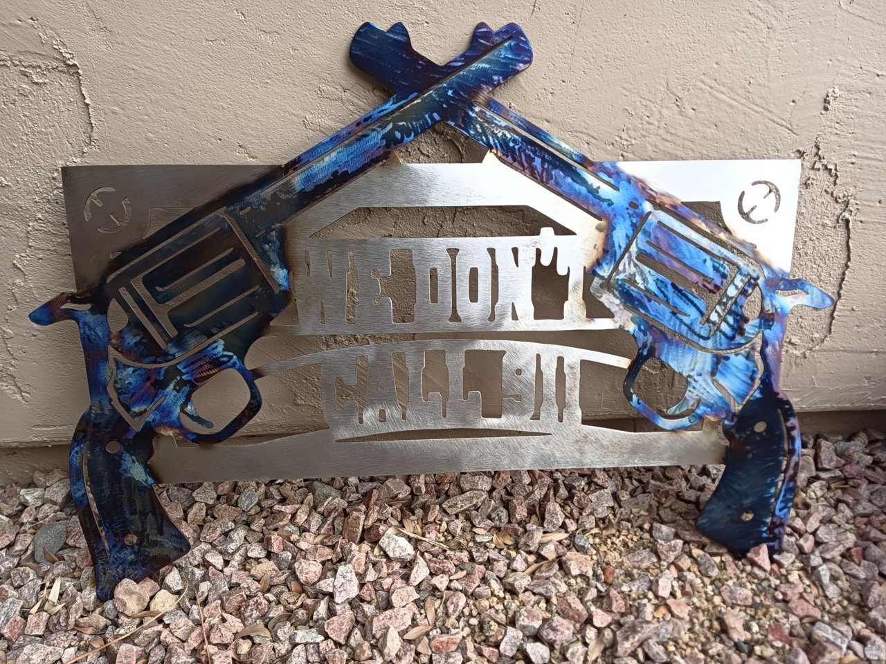

    Heat treated sign I was commissioned to do.

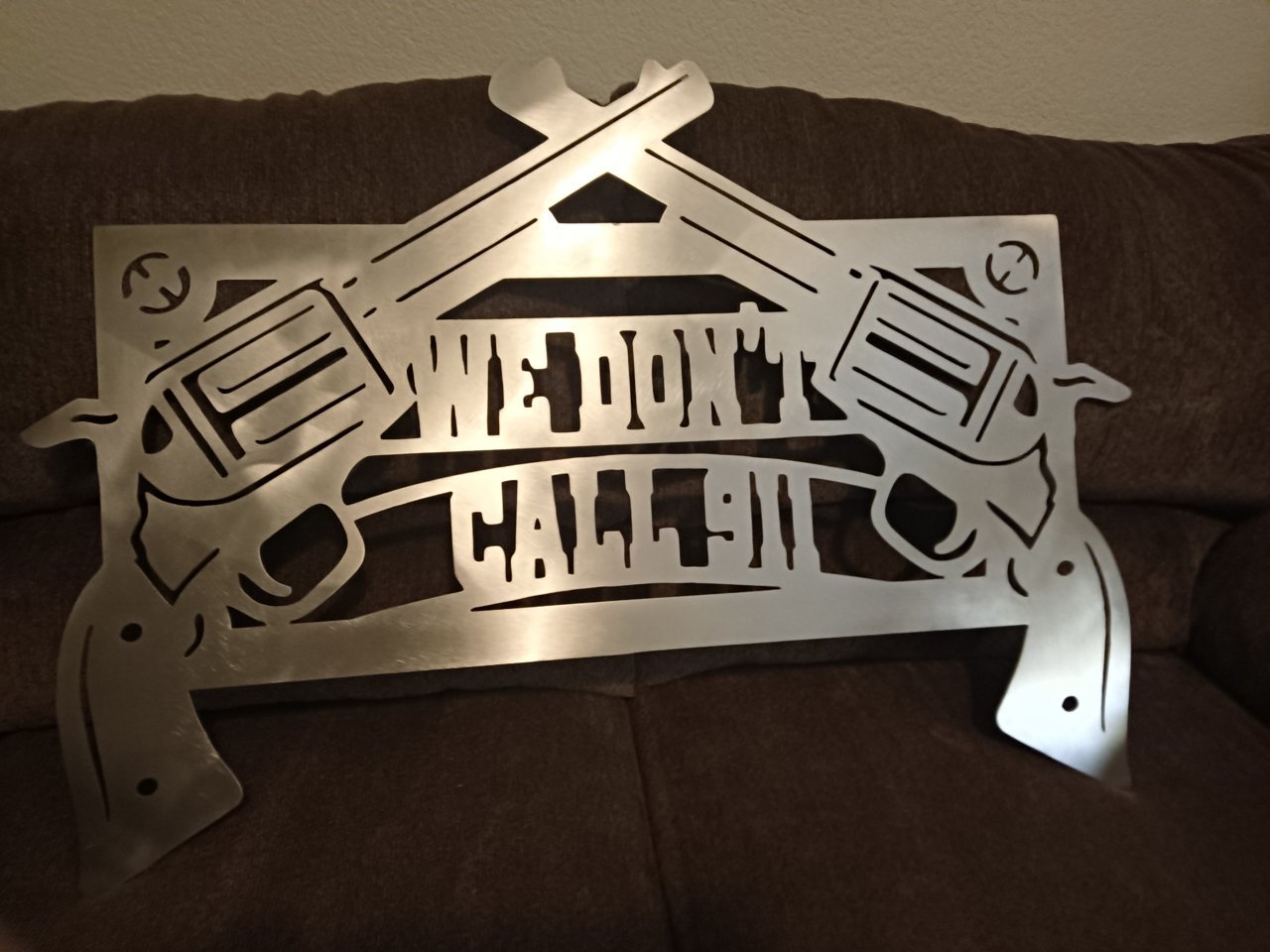

    If I was the owner of that pistol sign, I'd be tempted to make some wooden grips to add to it.
