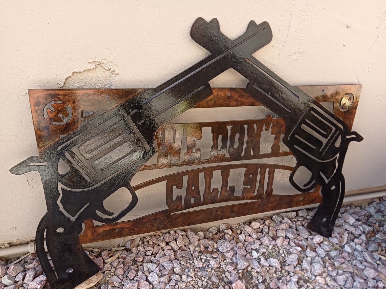

    Here's another one I made. Copper patina with black oxide guns.

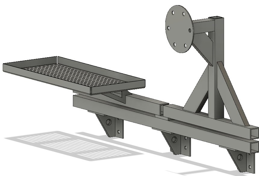

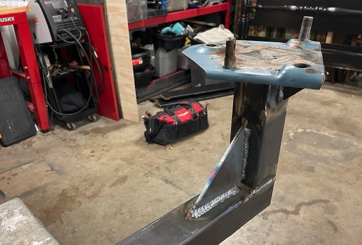

    Finally got started on a tire / gas / cooler carrier for the fj40 last night. the goal is something like the pic below using spare 2x2 and some 1x3s left over from my fence project. The 40 purists may cringe haha - the tire mounting plate is from the original 1973 swing out. The old swing out won't hold the weight of the larger tires so I cut off the mounting plate portion and used it for the new ... keeping some of the original.
    The end goal will be something like the pic below - I have swing EMS Offroad carrier hinges for each side to incorporate and will probably sandwich 1/4" plates as the 3 base pieces to bolt to the frame.

    That looks bitching!
    It won't matter much on this piece, but it's a good habit to take your welds all the way to the end. Don't necessarily have to wrap them either, just finish your weld all the way to the end.

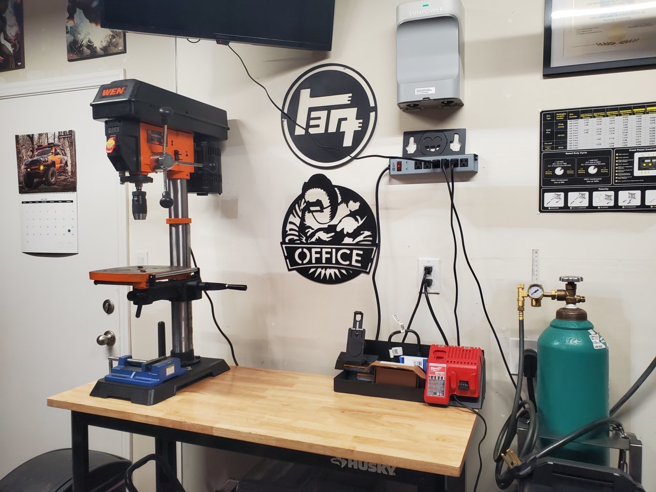

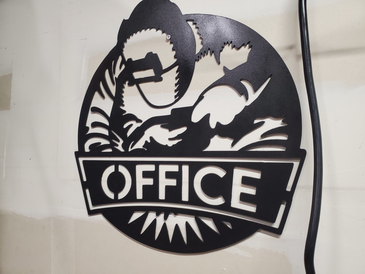

    Officially dry, and hanging on the wall

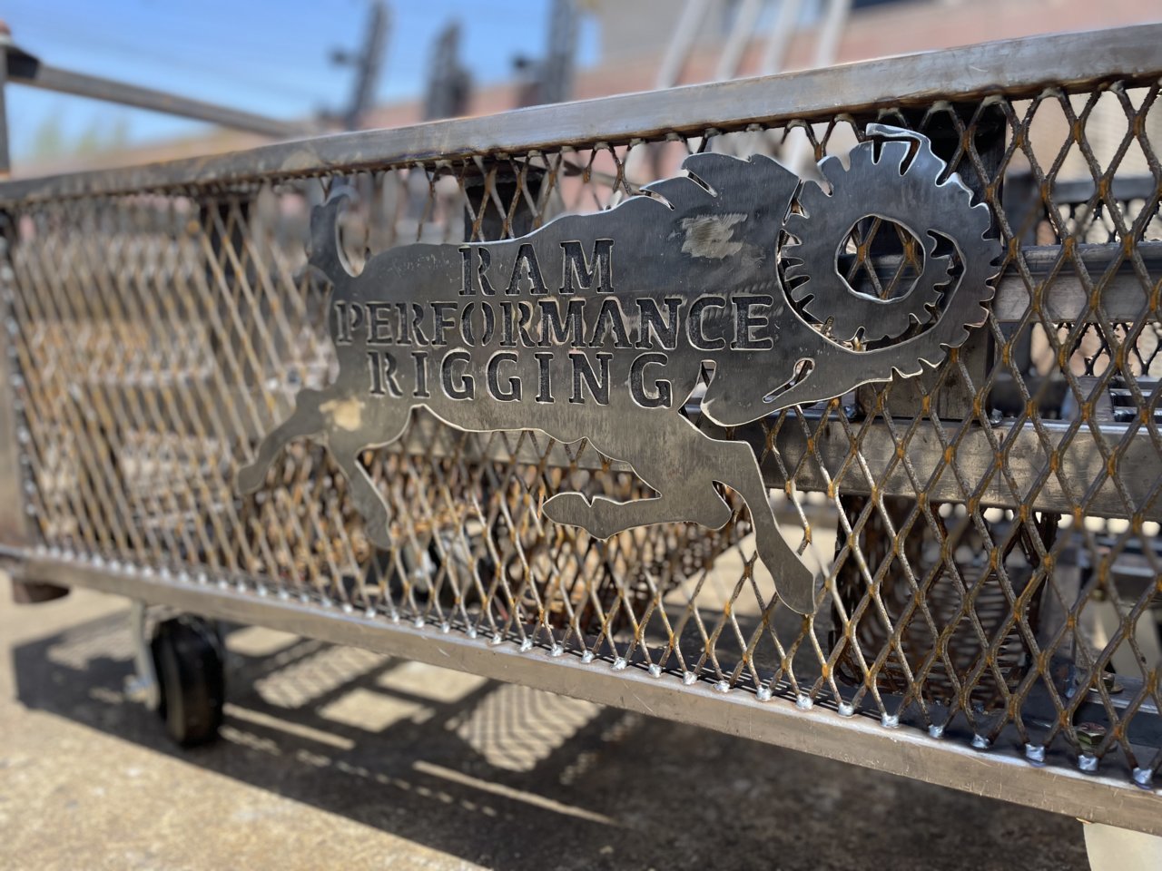

    Bunch of stuff
    Done with these bins. Glad they’re done and finished. The owner will get them powdercoated soon and I will post pictures of the official finished product

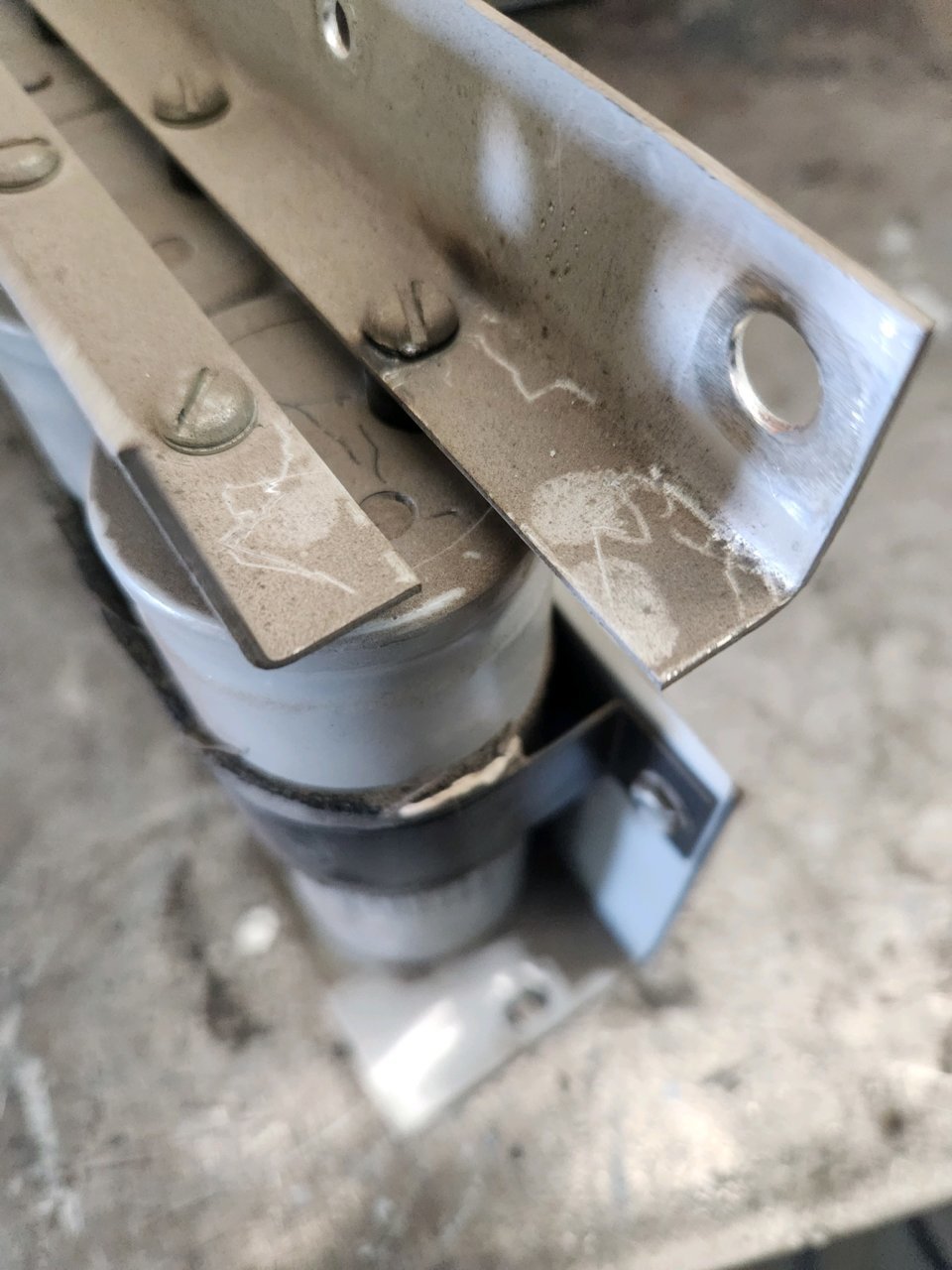

    The ole Lincoln mig welder decided to put out I light show deep within it's bowels. It is was a colorful whitish blue with hints of yellow. Only happened when wire would strike the arc. Pulled it's clothes off and looked around inside while triggering an ark. Found a bIG capacitor connection screw causing the light show. Of course the screw is welded in. $900.00 for replace capacitor bank. Be delivered some time in June. So I fired up old faithful, a Millermatic 35. This old machine lays out awesome welds and it's almost impossible to hurt it. It just does what you want with no complaints.20230425_120602.jpg 20230425_133746.jpg 20230425_120818.jpg IMG_20230430_231117.jpg

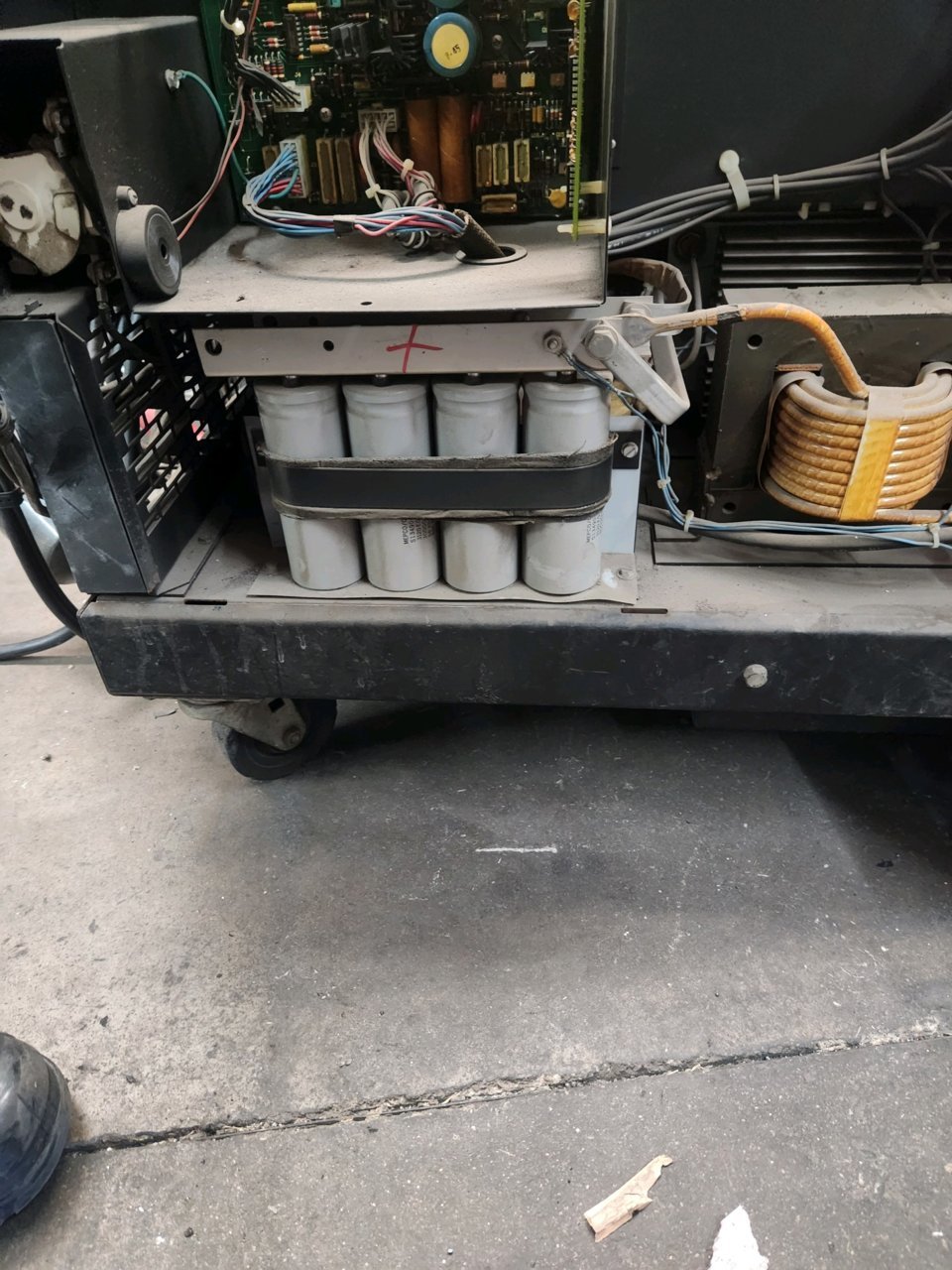

    Miller matic pic for reference. Mines not quit that clean. :welder:

    Grind the screw off if your lucky only that cap failed you can get away with replacing just that one.
    It sucks when a exploding Cap takes out the control board as well.
    As long as you keep the voltage taps clean those are great machines.

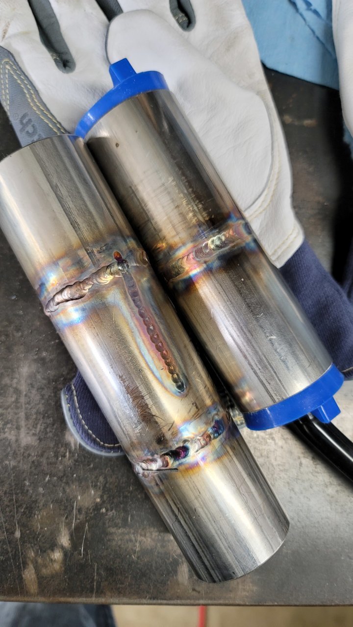

    Third attempt at stainless header material, first attempt with the purge plugs. First and second attempts in the second pic.

    It's sad that 99% of the population has no idea how much skill is involved for something like this.
    We, all here know how much time it took to make those welds happen.

    Lol thanks for the acknowledgement. But it's true 99% of my friends and family have no idea what the hell I'm even talking about when it comes to welding stuff. But I still post it for those 3-4 people that do haha
