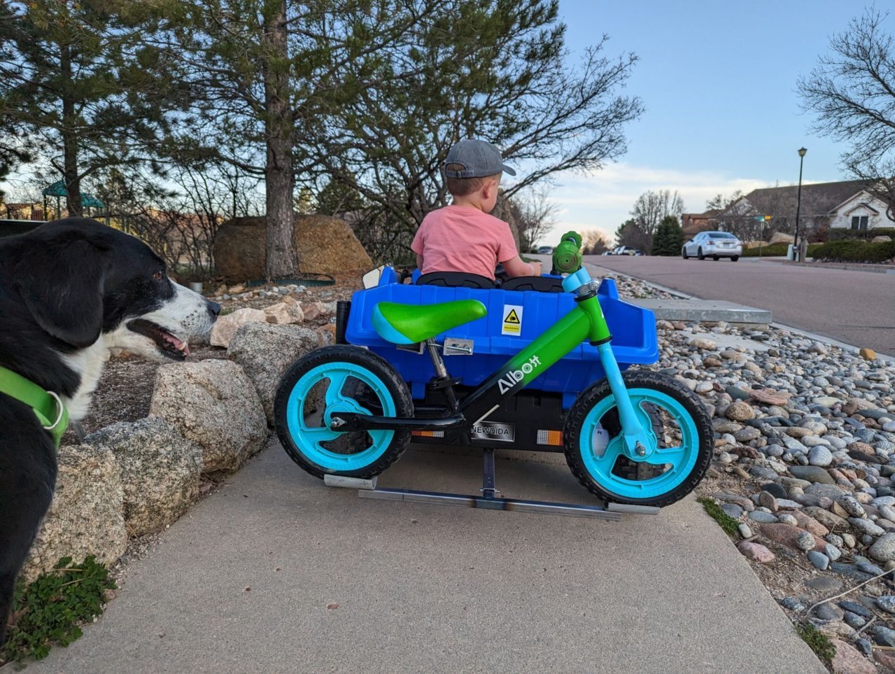

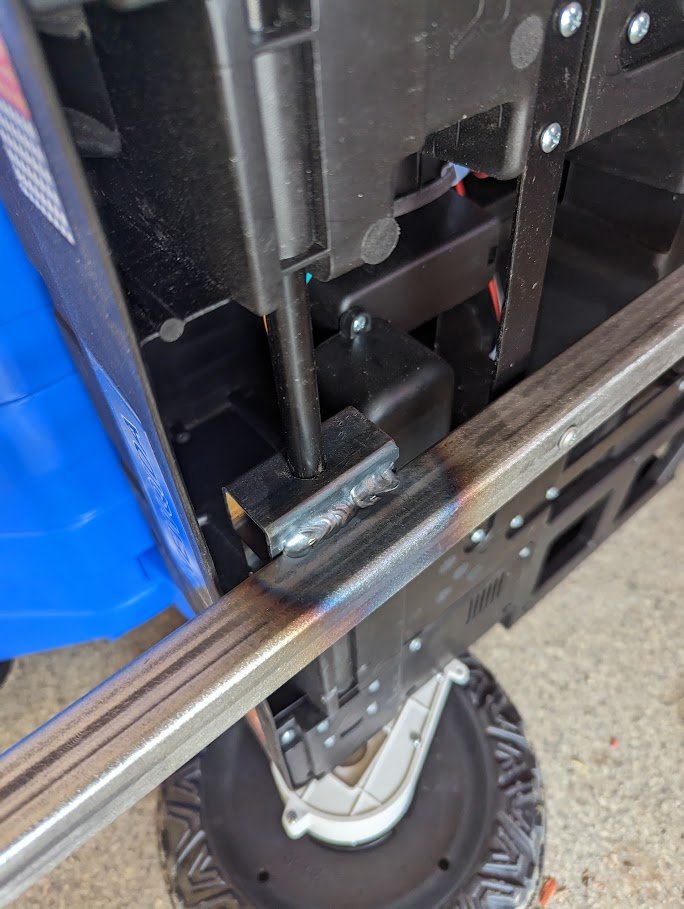

    I made a 1" trailer hitch from 14gauge mild steel and a bike rack from 3/4" 14g plus some random spare parts I had laying around.

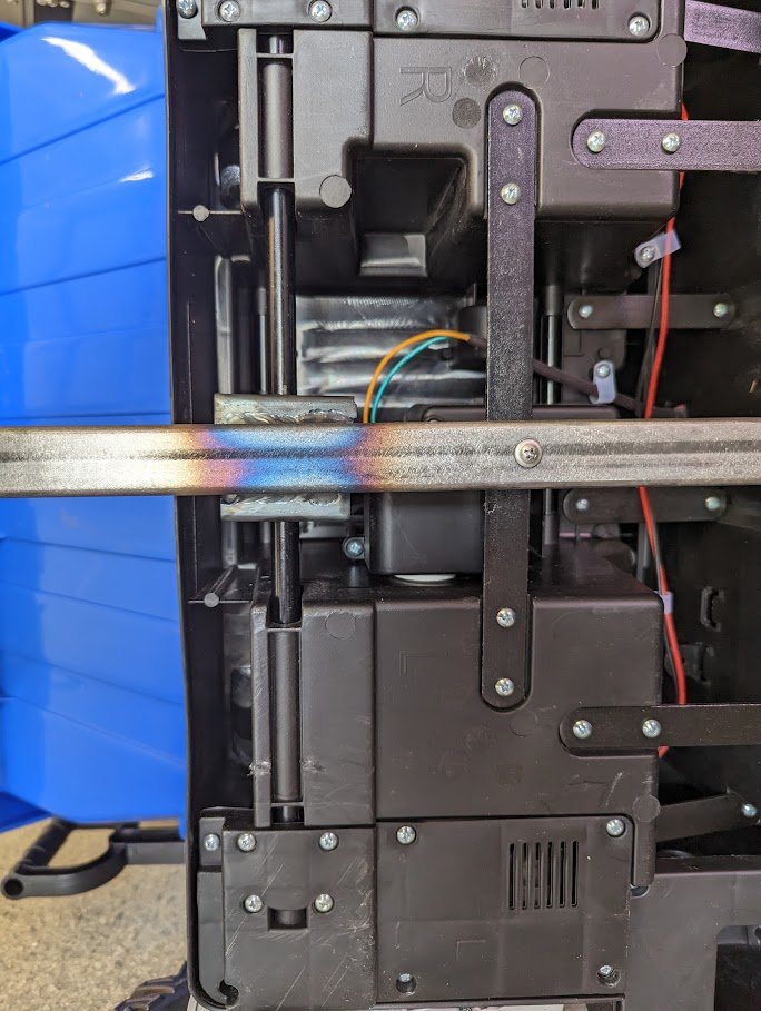

    if you don't mind, could you post some pics of how you mounted it underneath?
    i've decided that my next power wheels jeep project is going to be a small trailer, as the one nephew loves trailers and backing them up everywhere. but the big issue i keep trying to figure out is how to securely mount a trailer hitch without building an entirely new frame under the vehicle.

    It's mainly supported by the axle. I used 2 cutoffs of the 1" square, welded them above side by side, then drilled a 12mm hole through it. The entire tube is 36" long. I put a couple smaller screws thought whatever metal I could find. You can see 1 of the screws in the photos below.

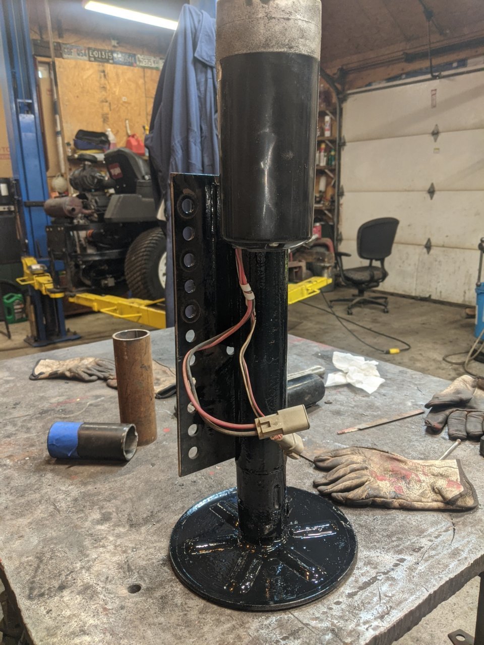

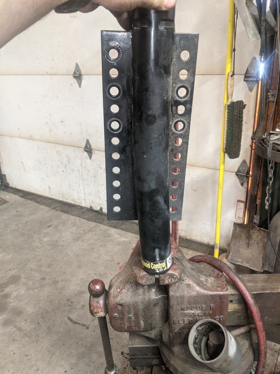

    Bent my auto leveler jack for the RV.PXL_20230502_161226772.jpg PXL_20230414_163712832.jpg
    $600 to replace.
    $5 + my time to fix .

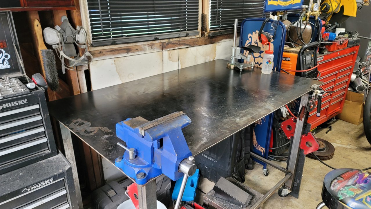

    Cleaned up the welding table.

    I need to clean mine. It’s looking pretty best right now. I usually grind off all the random BBs, sand it with a DA and 80 grit and then wipe it down with wd40.

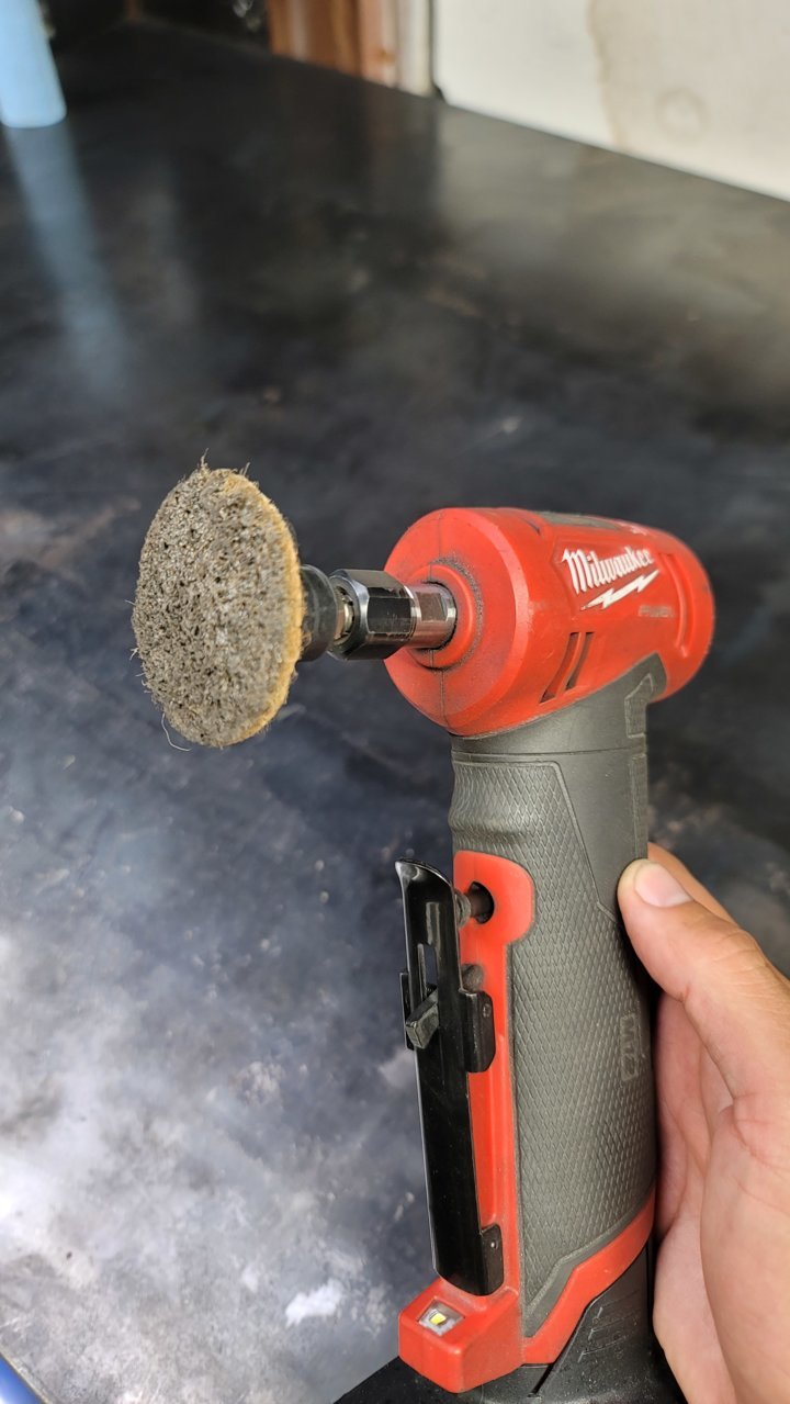

    I'll have to hit the whole thing with some 80 grit. I just took the random rust spots off with this paint removal pad on my die grinder wiped it all down with acetone then another wipe down with wd40.

    It’s pretty satisfying to get that even sheen and sanding pattern on the surface after hitting it with 80grit.

    Y'all clean your welding tables?

    Lol once or twice a year

    I weld on my tables, but fortunately I don't get any dingle berries.
    That or when I do, they don't stick.
    What does muck up my table is any steel that got splashed from my water table; that shit collects crud real quick so a quick wipe down with acetone does the trick. It's the vacuuming and sweeping the grind dust I hate most.

    Yeah I havent gotten them lately cuz I've really only been tig welding. Before i was mostly cleaning up the anti spatter i was spraying all over everything. Now I'm mostly cleaning up chemicals that have spilled because I'm careless, or beer. lol
