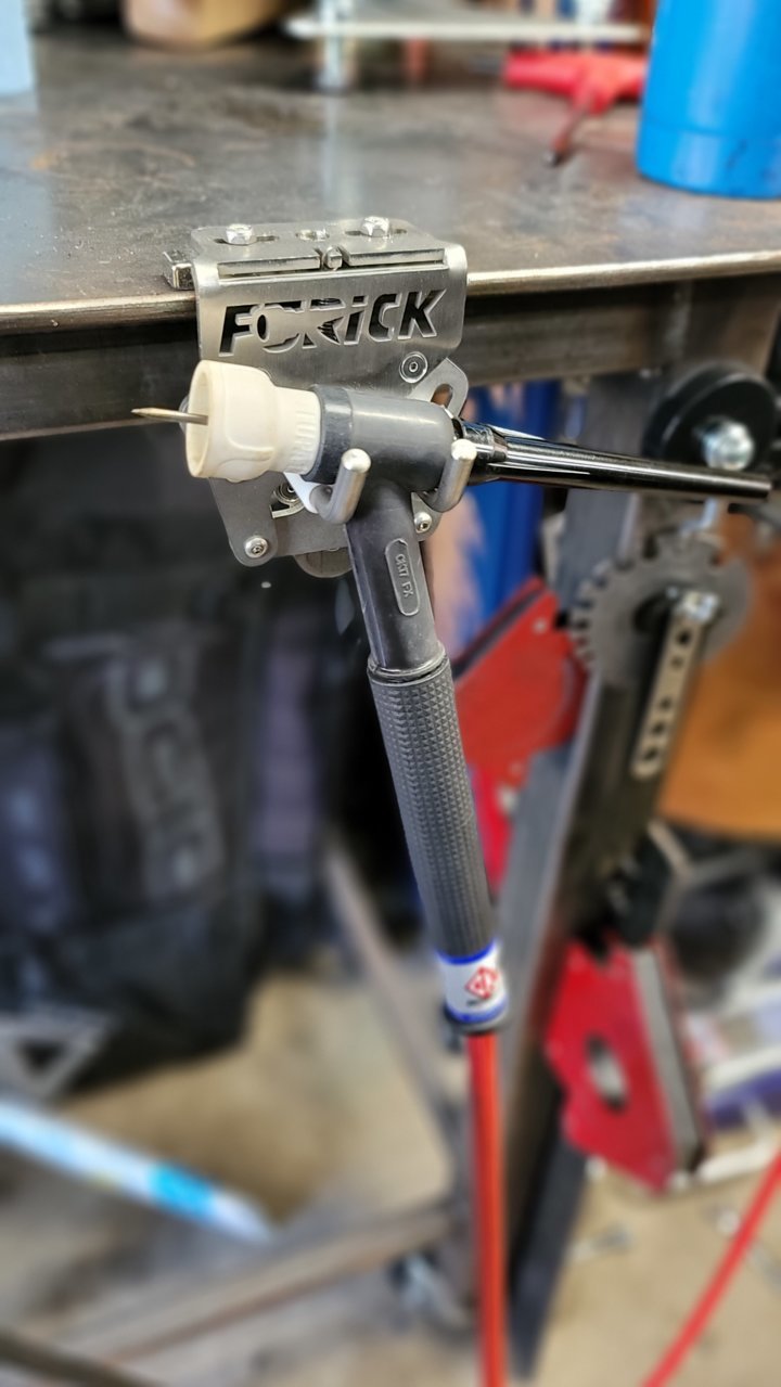

    Love my ck torch

    I've always liked them, specifically cause of their flex head. That and it's what I learned to TIG with.
    Thing is these are what, 150 amp torches so if you're doing something thick or running multiple beads you definitely want to go water versus air.
    I got spoiled by the water cooled Miller TIG setups we had at my last job, but we did a lot of TIG on stainless so anything to keep the torch cool (and your hand).

    PERFORMANCE Custom Turbo Setup FRONT SUSPENSION Drop Spindles by Aaron Carswell 01-04 Swaybar Endlinks Energy Suspension Endlink Bushings Cando Upper Control arms QA1 coilovers with 8" spring Custom 4 pot Brembo BBK Modified lower control arms with mjbfab qa1 mounting plates and Poly bushing sleeves REAR SUSPENSION Chasis Tech drop leafs QA1 adjustable shocks weld in drop notch Gas tank cross member bridge 3" angled blocks 2013 Double Cab Short Bed TRD Sport Eibach Pro Truck Shocks front and rear Lifted to the 3rd setting on the front shocks
    Yeah im finding that out now that I'm tig welding more lol. Might have to upgrade to water cooled soon.

    Liquid cooled allows the torch to stay much smaller for the higher output .

    Yep, that'll do it.
    You'll need a whole new torch just for water, a cooler, and remember to never run a water cooled torch without coolant.
