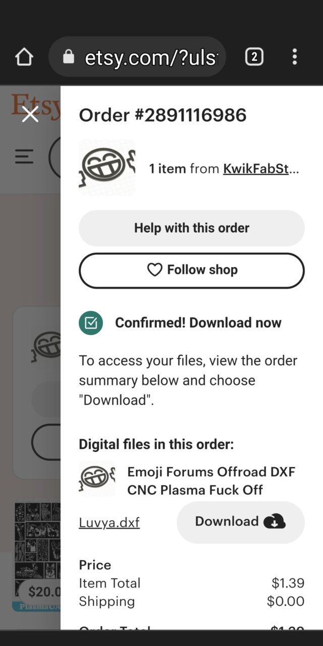

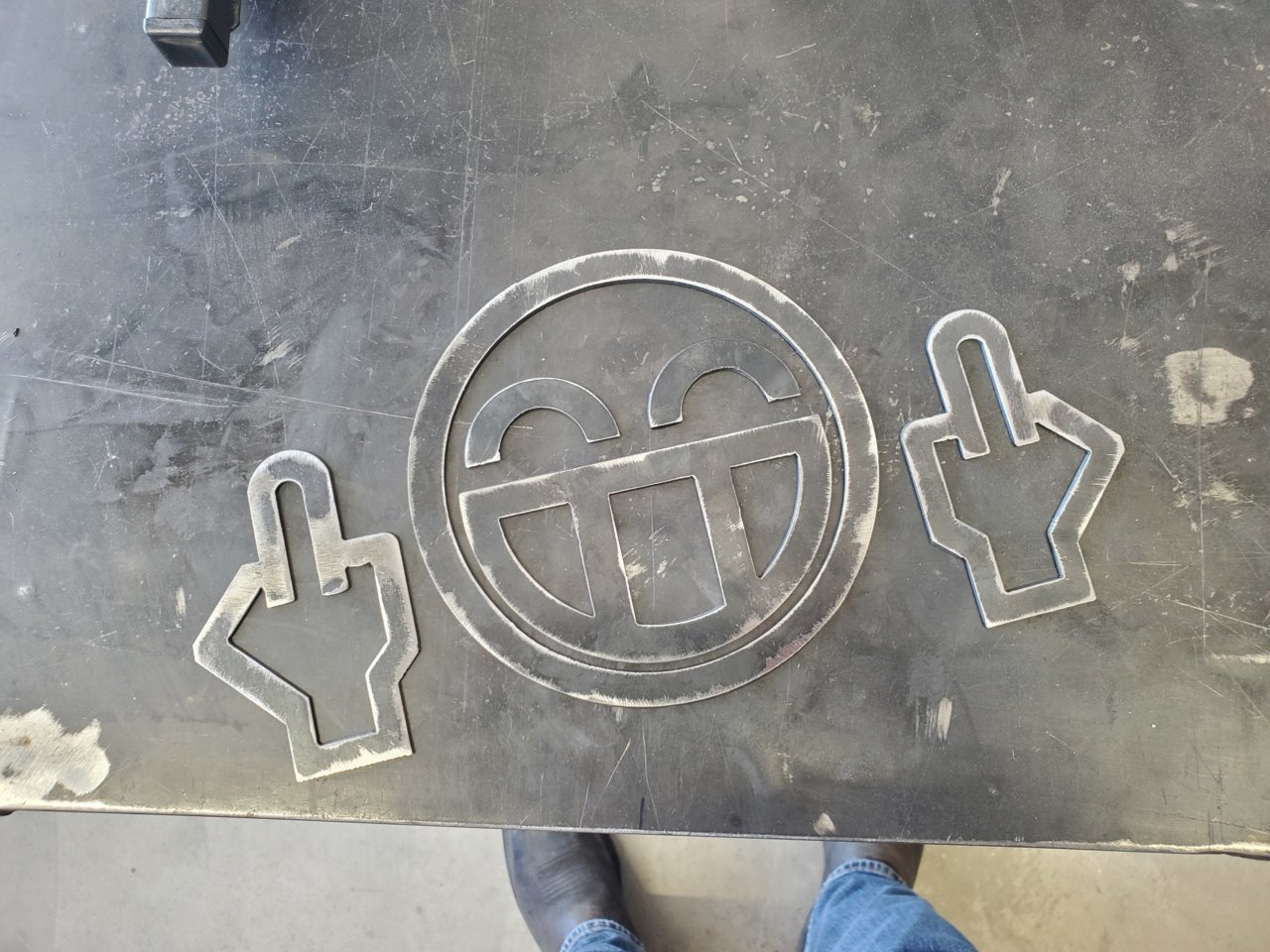

    Thanks for the support!
    I especially love how Firecontrol easily allows you to scale items without having to go into Fusion again and generating new g code
    16 gauge, 85 ipm, 30 amp, 50psi

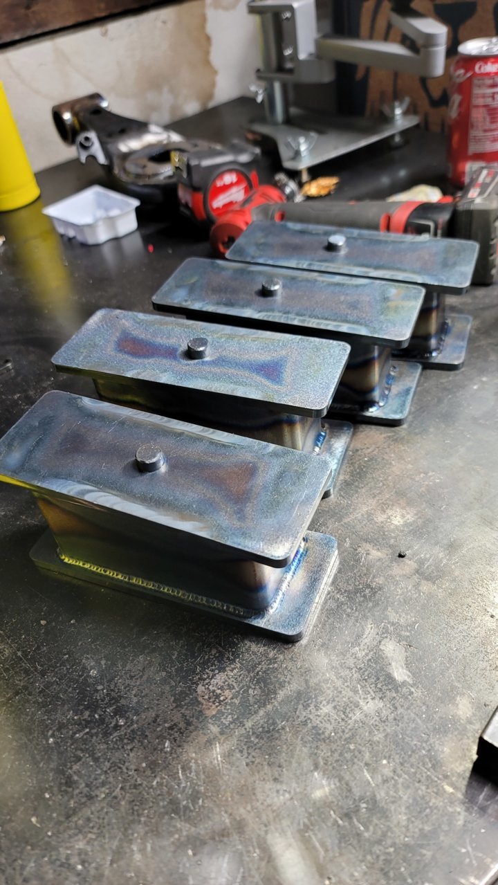

    I have two hours into these and still not done. Need to weld the long sides on the tops of all of them. That includes fit up and tacking together. Sure takes longer than mig but im using these as practice for tig while making a little bit of money. My torch gets super hot and I have to take some breaks for it to cool down too. Would probablt shave some time off with a water cooled torch.

    My only question is, are you cutting and grinding those top and bottom plates yourself?

    I get them laser cut. I do cut the rectangle tube myself. I didn't include the rust/millscale removal in that time lol

    Well aware of the mill scale removal lol I got spoiled with the stainless steel I would weld at my old shop
    It came laser cut but with that plastic coating on it so you'd just peel it back and it was all weld-ready
    You making money at least? Can't imagine buying that stuff cut for me

    Yeah im selling these to mini truck dudes on instagram. Offer them in their custom requested specs. Making about a $40 profit per set. Nothing crazy.

    I won't tell you how to make money, but keep in mind not to sell yourself short.
    It's ok if the profit is say...$25 or so...as long as that is separate from your hourly wage you pay yourself.
    Since you're learning or practicing, you'd just quote a flat rate job (to be fair to customers and remain competitive since you'll take longer than an experienced fabricator). But once you're doing other jobs, your profits should consist of anything made after you've exceeded the cost of material, consumables if you need to add that, as well as your labor. I still do flat rates on cutting stuff for the most part but I charge 150% on material and do so by the square foot.

    Yeah this was a i had extra material, make some money back situation. I'm charging a flat rate for these. If I charged hourly they'd sit in my garage for an eternity lol.

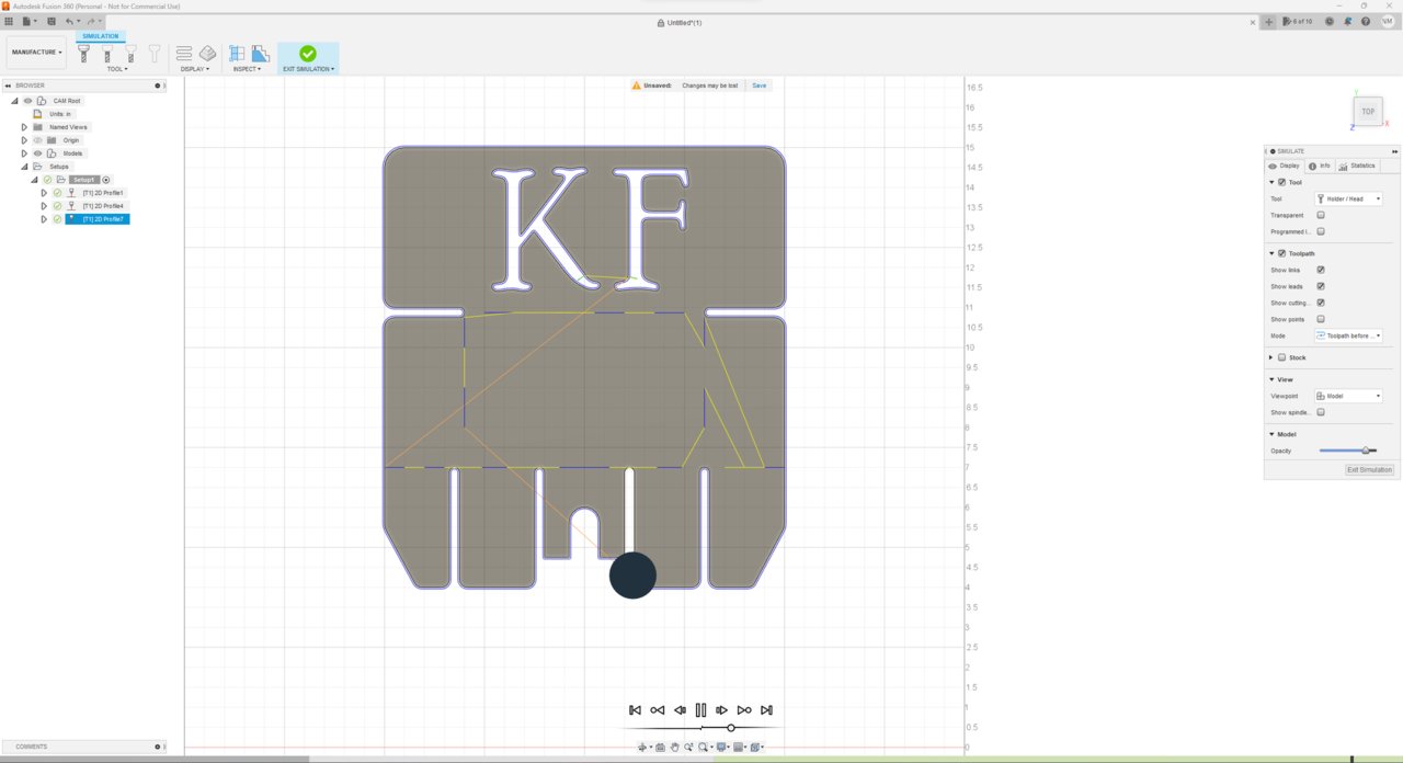

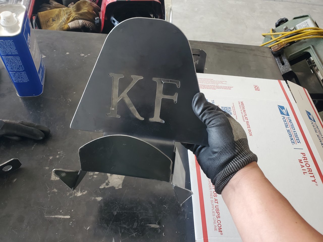

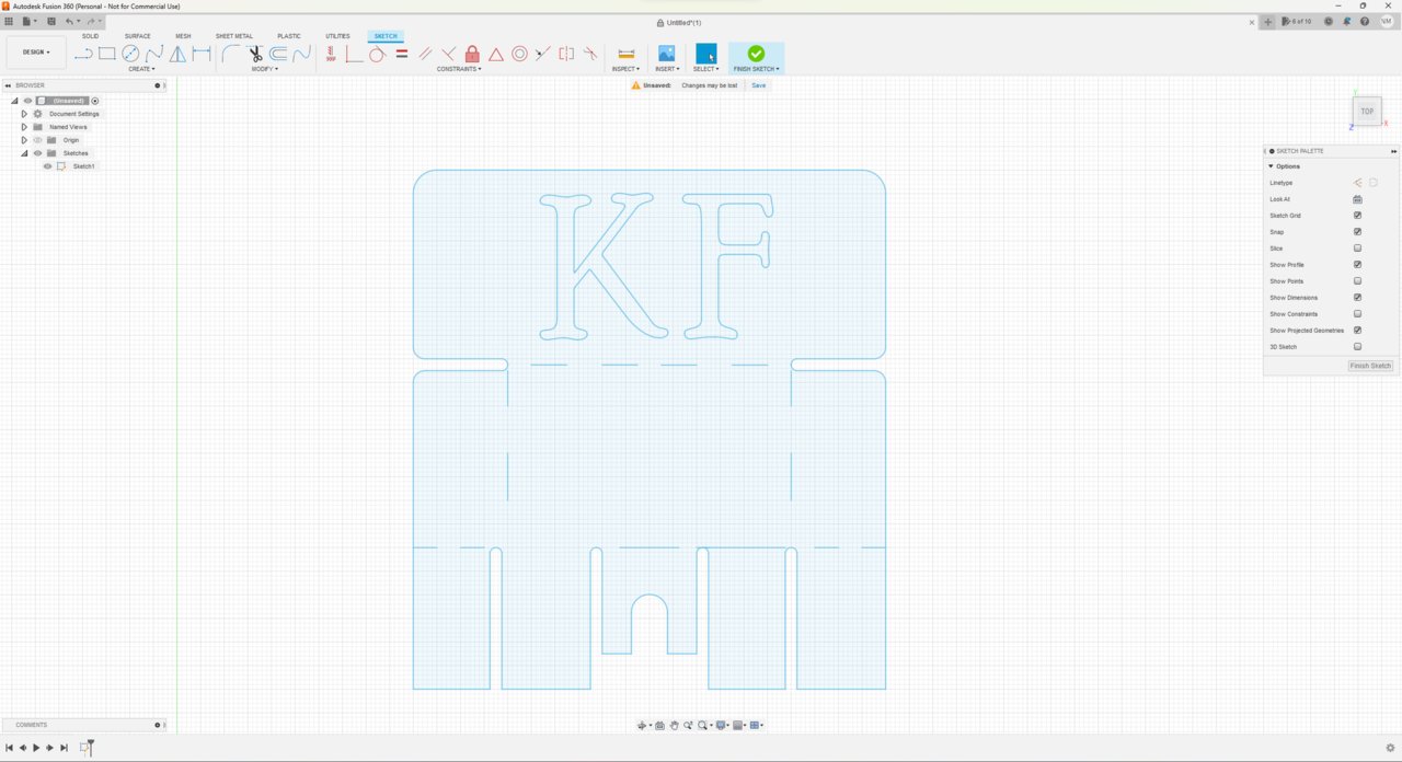

    Posting today's fuck up.
    Before I actually make my mini-TIG cart, I wanted to get the 'accessories' out of the way.
    Drew this up earlier and was really liking the layout.
    After seeing a 3D version of it, I modified it a bit and the end result was this.
    It'll be for cable management, specifically my TIG torch cable.

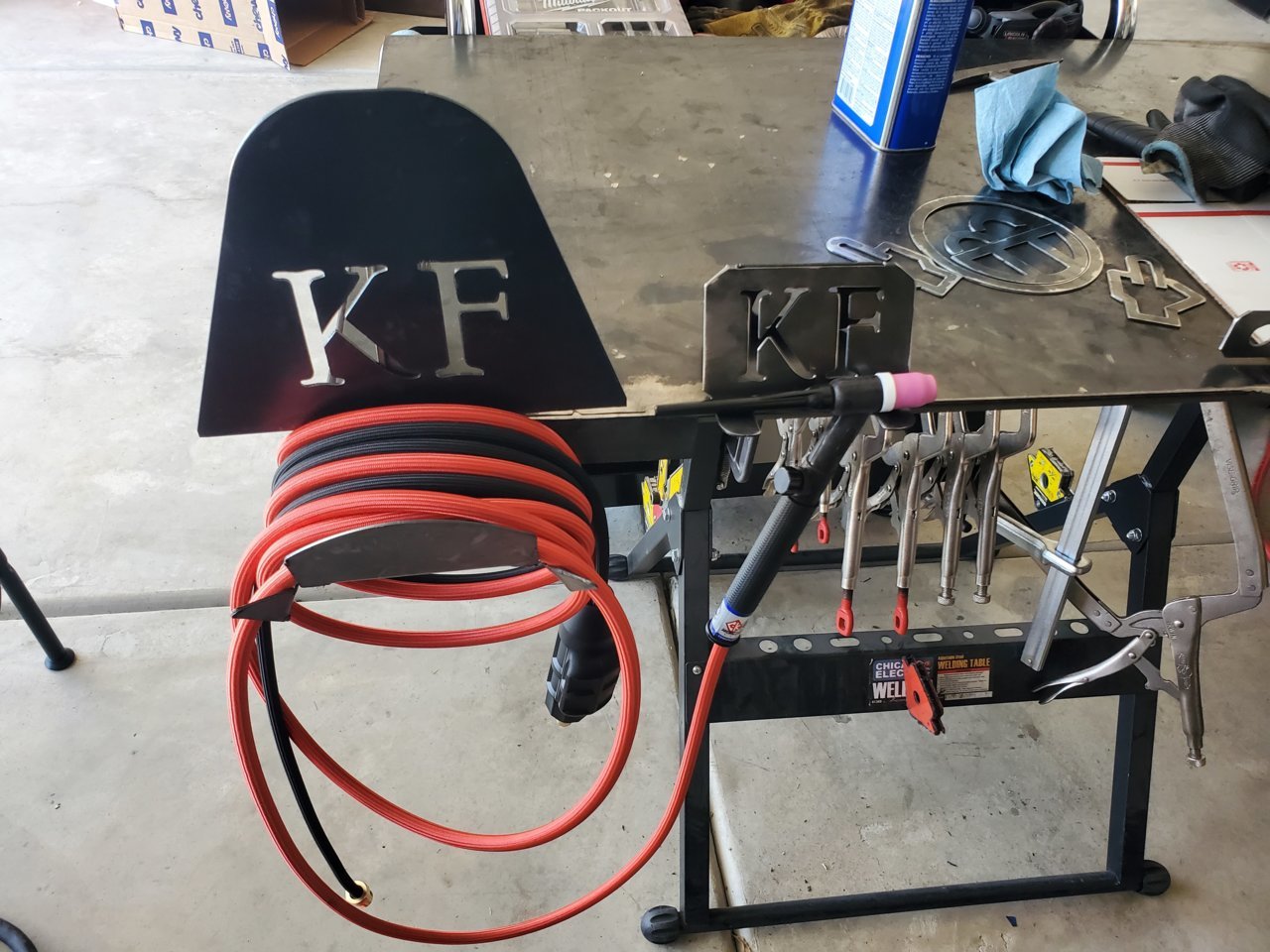

    Well I had drawn that up on the PC, shut it off, and came to the garage to cut it out. My dumbass didn't save the file :facepalm:
    Found a half-ass freebie and said fuck it I don't want to draw it again so here it is.
    Cable management will be on one side, and TIG consumables with holder and whatnot will be on the other side.

    You have the picture, why didn't you screen shoot it and make a canvass with it? Once it's drawn up, the dimensions aren't needed. You scale it with the controller software.

    Because I was at my laptop, and I don't do well to even manage a touchpad so I quickly downloaded one and modified it slightly.
    Was way quicker than even what you're suggesting, mainly cause of the touchpad thing :rofl:
