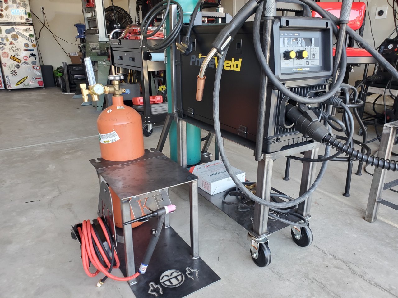

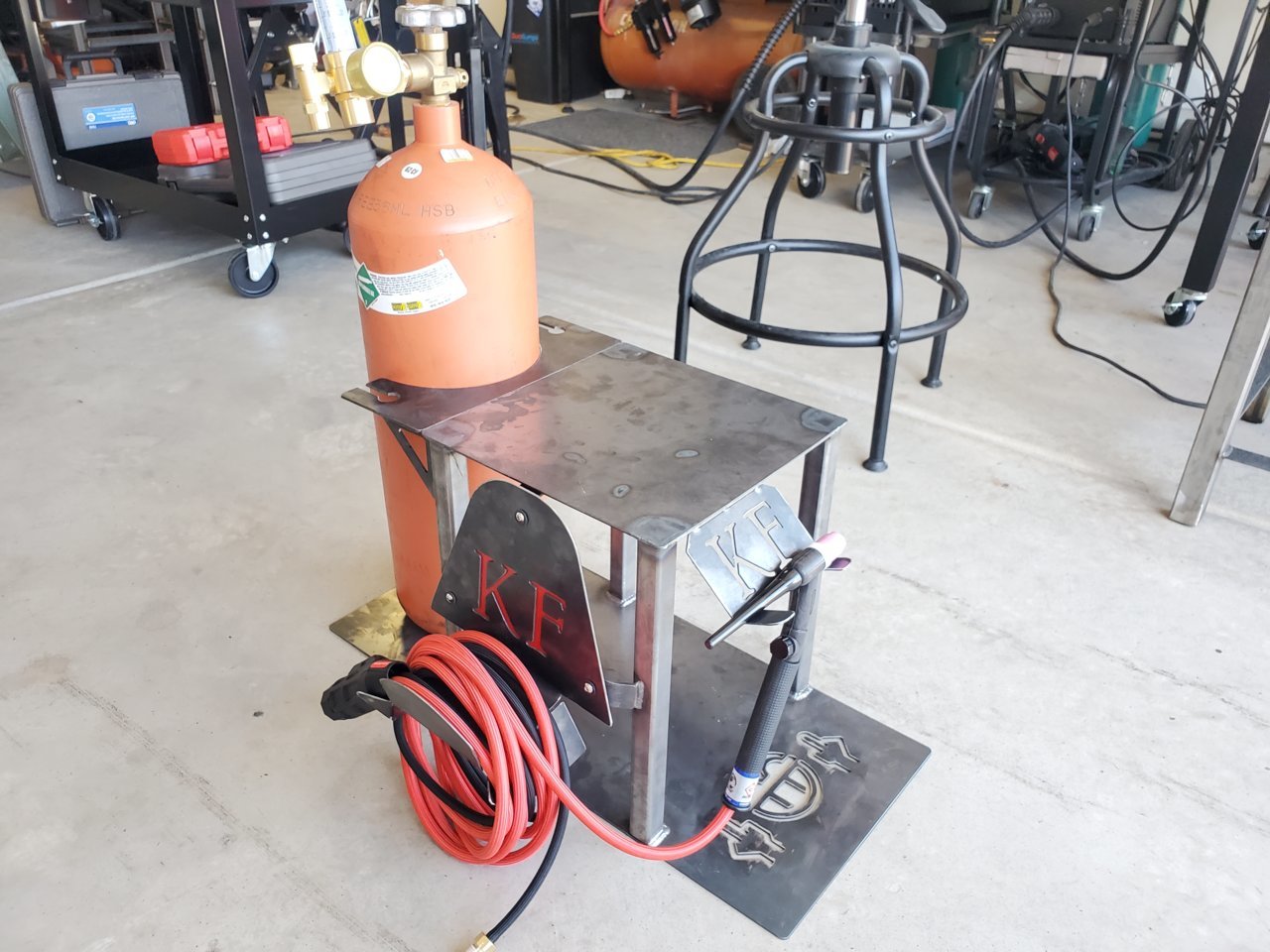

    This cart is meant for TIG only, and since I don't have a dedicated TIG welder, it'll only get pulled out when I hook it up to my multiprocessor
    Being compact was the main goal as you can see by the comparison
    By the way, these little caps from Amazon helped clean up the square tubing on the big cart

    That's looking really sharp

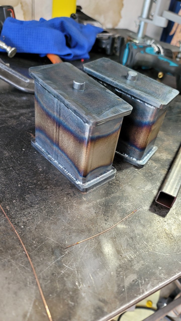

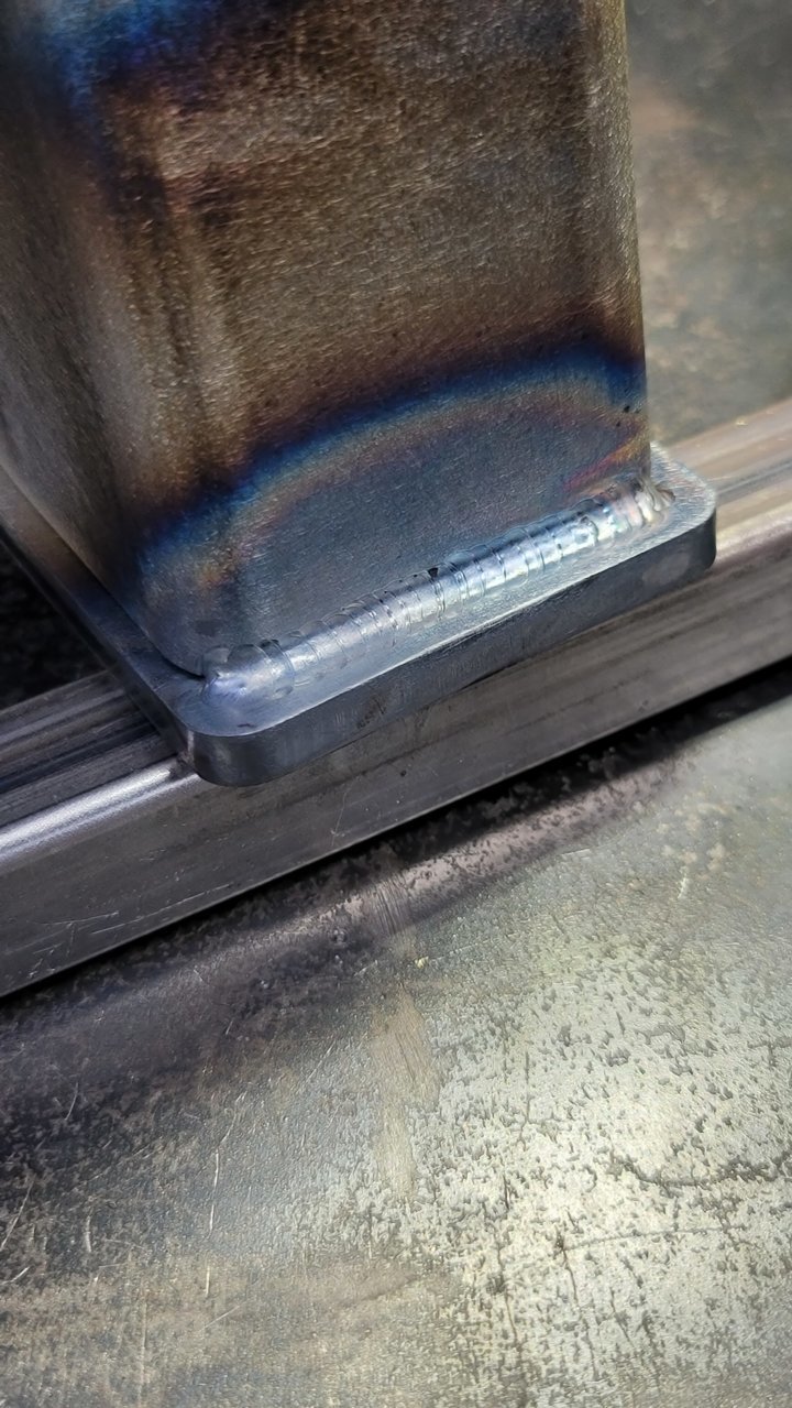

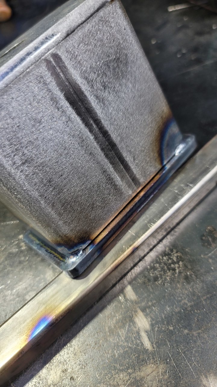

    Oh yeah I finished the blocks lol. These were "smaller" for a Hilux. As usual I built them with the customers requested specs. He requested a smaller center section and over all top and bottom plate size. Standard sizes are 5.5"x2.5" with a center section of 5x2. These are 4.5"x2.25" with a 2x4 center section. Not much room on the sides so burned up the edge on a few spots. Gotta work on that.

    It still falls under practice welds so your excused on minor errors!

    Lol yeah still gotta work on it though. If the next person asks for 2.25" wide blocks I'm saying no! Lol

    smashed this, broke that, covered it up with tape and paint
    You could always get some chill blocks to help
    Something to help pull the heat away
    Or
    Start practicing pulse

    You are allowed to do what you can to control the heat.
    A nice piece of copper flat stock clamped to the tube makes a great heat Sink!
    I have done that many times!
