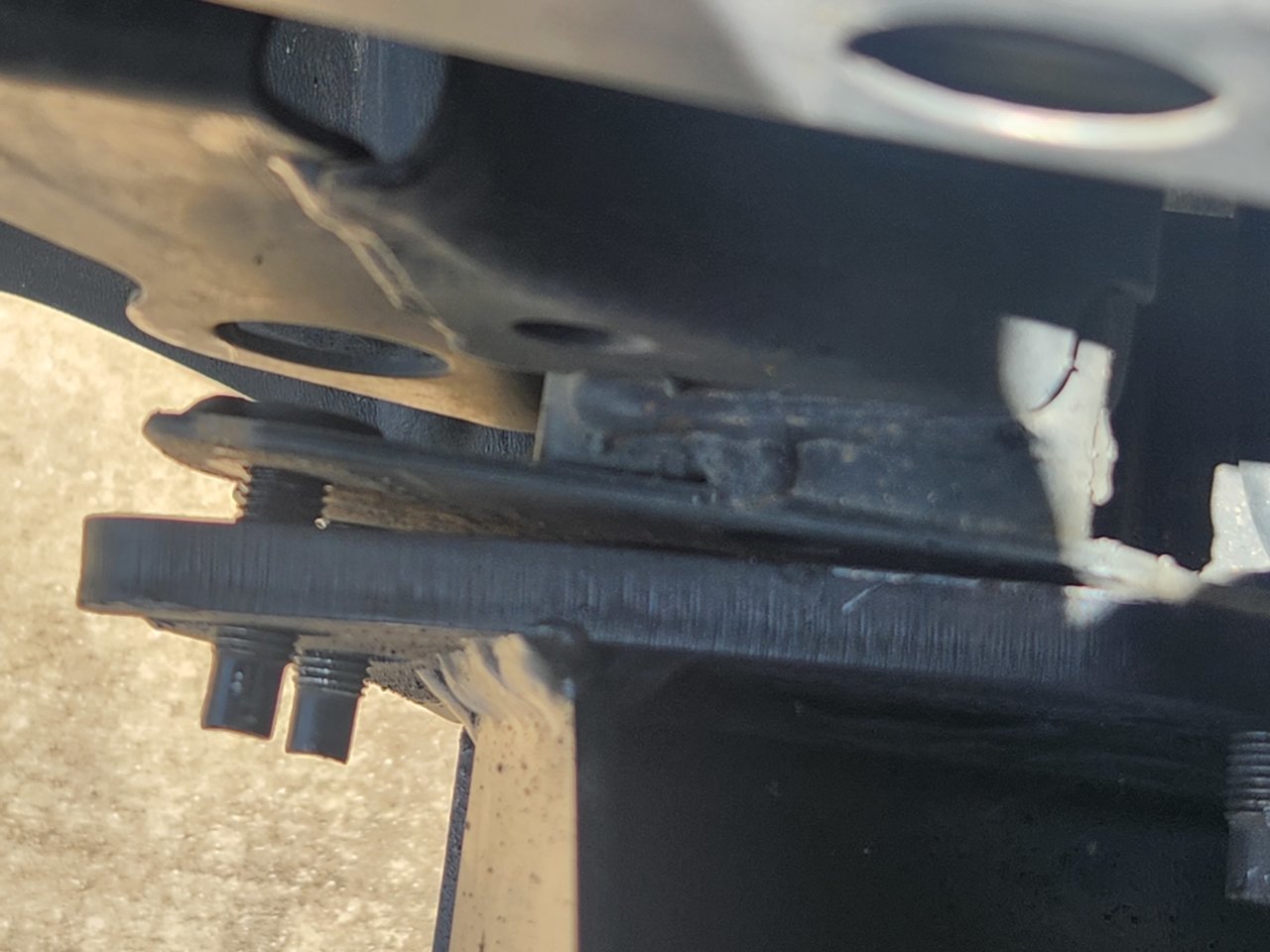

    well. that is not going to work...
    finally got around to installing the bumper, and discovered a a problem.
    Not sure if it is all weld distortion, or a the frame being tweaked on that side, that was discovered when the lift was installed or a combination of the two. But I not in the mood to mess with it further, and discover that once the trim is cut it will not work or look right.

    Totally distorted from the heat.

    What's the problem? Just bush it with washers until it's the same on both sides.
    Both my bumpers had that issue. I forgot about it until you reminded me with your pic. Must not hurt anything because they close ten years running since I built them. Lol.
    You got this.

    Those tabs are really flimsy. You can just tighten down the mounting bolts and they'll "self-correct" by forming to the bumper mounts. I would make sure both sides were loose and tighten them slowly going back and forth so both sides bend evenly. Not a huge deal if you ask me.

    The "tension" (or need to bend back) just works as a natural loctite :burp:

    i count 2 threads of engagement. that's plenty from where i'm sitting!

    Those tabs are so flimsy they won’t want to bend back. You can almost bend them by hand. Haha. Either way, I wouldn’t stress the install- just tighten everything down and be GTG.
