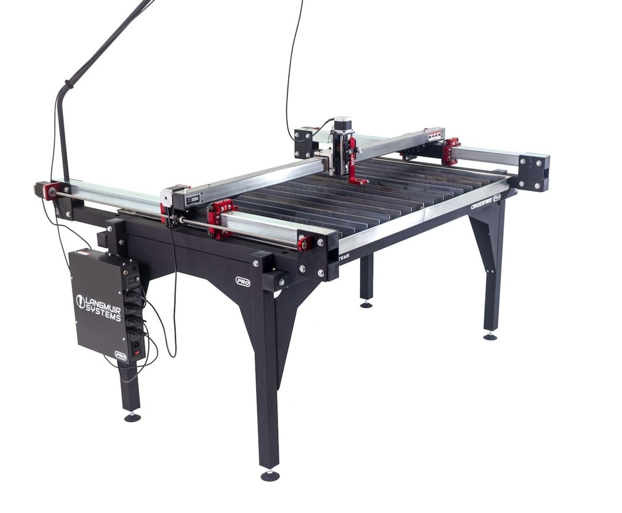

    TXpro4X4 Fuck Cancer!

    #66093

    Costa Mesa, CA
    2011 TOY
    Happy bday man!!
    Nice!:cheers:

    We're gonna have to talk later; I keep having beveling issues which is related to torch height.
    However I narrowed that issue down a few months ago to a gantry tube that wasn't squared but now it's beveling again :annoyed:

    I would've and could've gone Pro, but space is a real constraint :bananadead:
    I'm betting the problem is Me really, but I do feel there's enough deflection that the torch lends itself to sit "lower" at one end of the table compared to the other. That's where the beveling comes into play and THC isn't helping to alleviate that.

    Some good tips in this thread. My pro table has been great. I've had a lot of problems with EMI freezing FireControl, but the table itself is awesome. You won't be disappointed.
    Also, there are guys doing extended brackets (file on FireShare) to increase the cut envelope by changing the position of the X-axis gantry if you feel you might need a bit more wouldn't hurt to investigate before you assemble.

    Sometimes it’s tough to troubleshoot the issue. Is it the slat bed might be off a little bit like one side the slats are sitting funky in their grooves? Maybe the torch cable is getting pulled on ever so slightly when it makes it way to the end of the gantry that’s it’s pulling it sideways a little and causing that beveling? I don’t know haha
    Yeah dude I’m super excited! I wanted one back when I saw you get yours lol. I’ve been making do with the size of mine but want to start doing more larger scale projects so time to upgrade!
    Thats badass dude thanks for sharing that. Yeah maybe being able to have the most out of the cut envelope will make that difference in certain projects

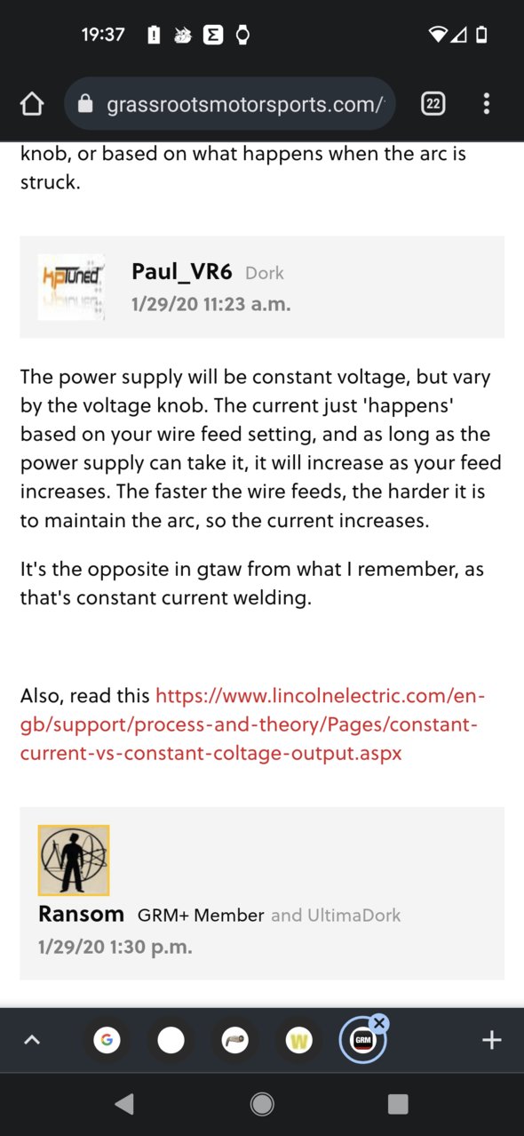

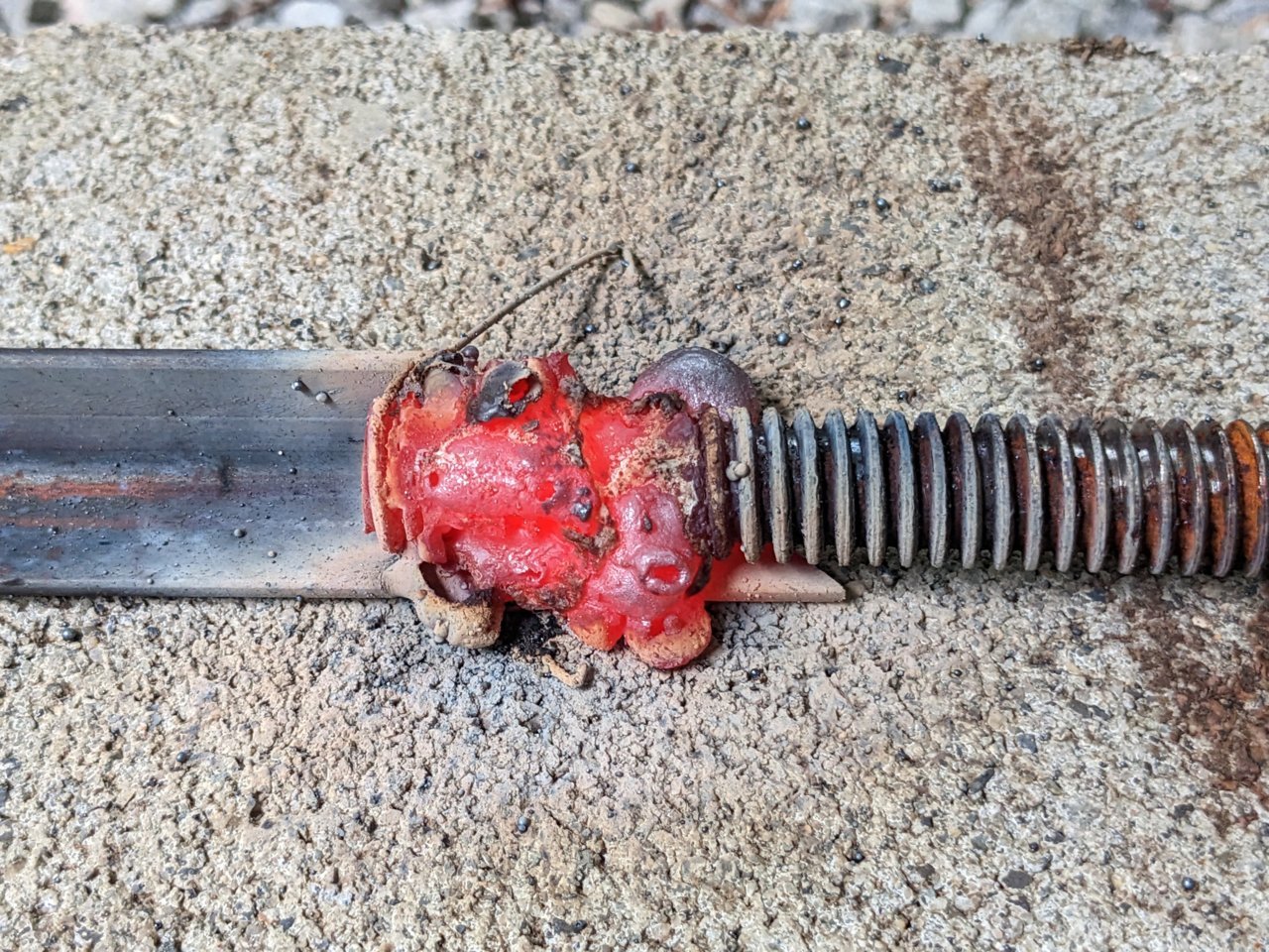

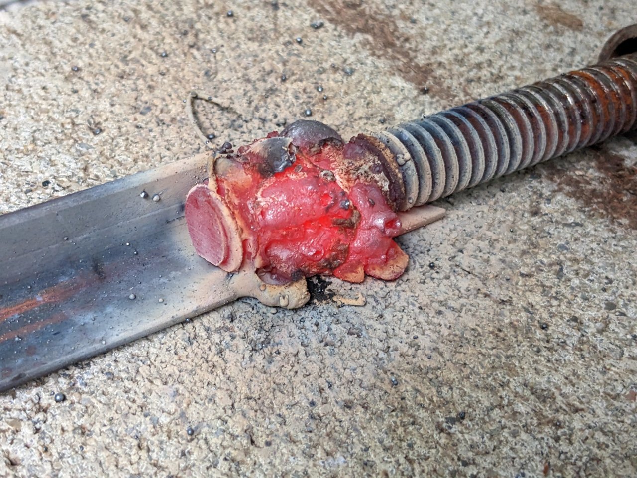

    Welding question: in a dumb mig welder, to turn down the "heat" can I leave the voltage alone and turn down the wire speed? This puddle was created with 24v and the wire feed motor run at 24v. The screw is a lead screw from a vice, something like 1/2 core and maybe 5/8" to the edge of the thread.
  15. May 30, 2023 at 5:48 PM
    Kwikvette
    Feb 27, 2019
    #284735
    81,827
    Fresno County
    4 run, 2 don't
    Heat normally refers to the actual current.
    Granted, wirespeed does play in part with that transfer of current, but if you need to "turn up the heat" you would adjust your voltage up and add a little bit of wirespeed to allow the wire catch up with the added current.
    And hey, I take offense to that! I'm a MIG welder myself :luvya:
    Turning down the heat in your case would mean turning down the voltage and lowering the speed a little.

    How much could I expect the wire speed alone to affect the amperage? Marginal at best or would it allow for a somewhat reasonable weld.
    I'm looking for a trail recovery acceptable weld.
  17. May 30, 2023 at 5:52 PM
    Kwikvette
    Feb 27, 2019
    #284735
    81,827
    Fresno County
    4 run, 2 don't
    Also, that's a shit ton of metal and heat applied to that lead screw.
    I'll bet money it'll easily snap here
