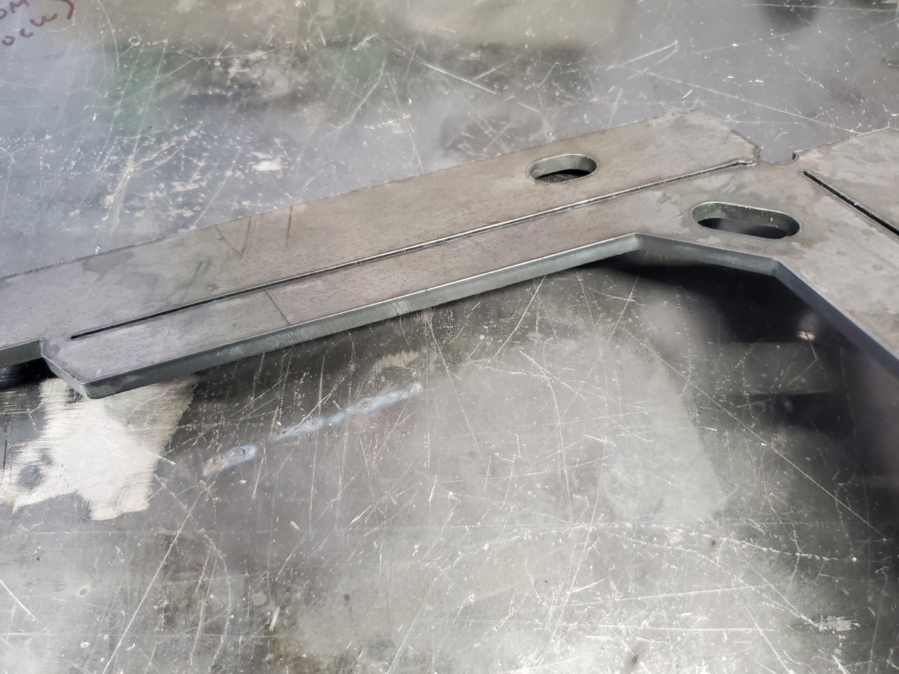

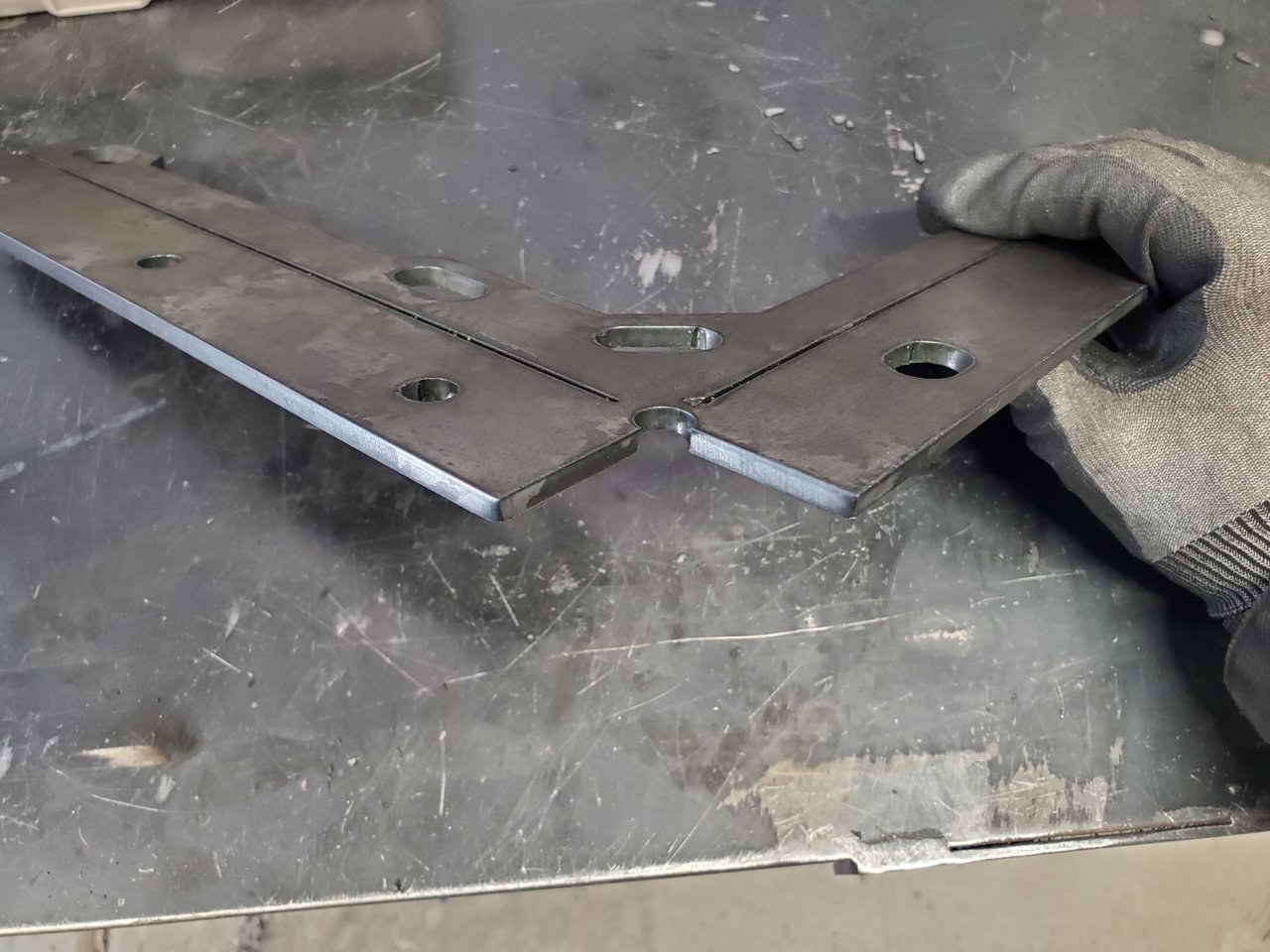

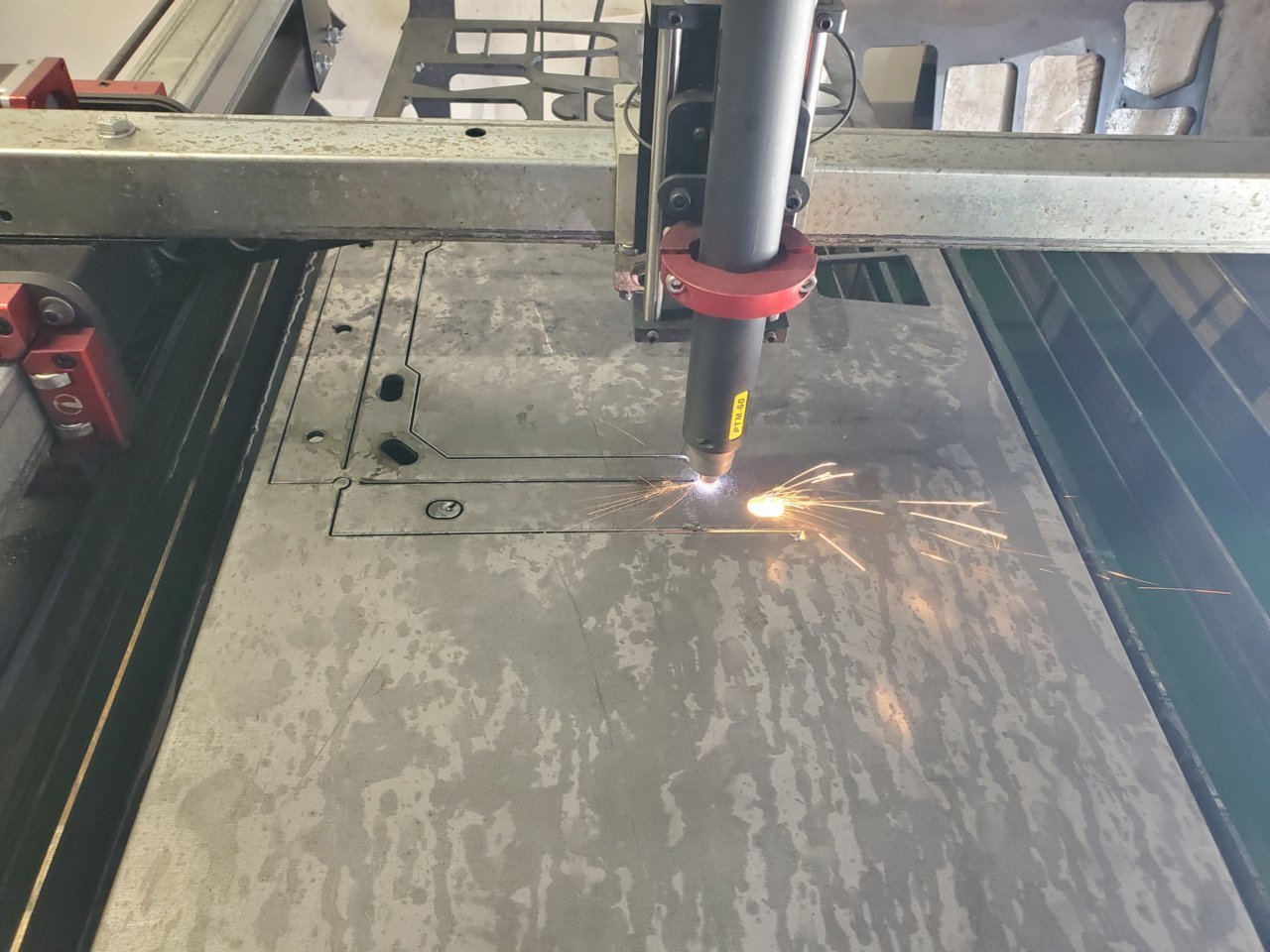

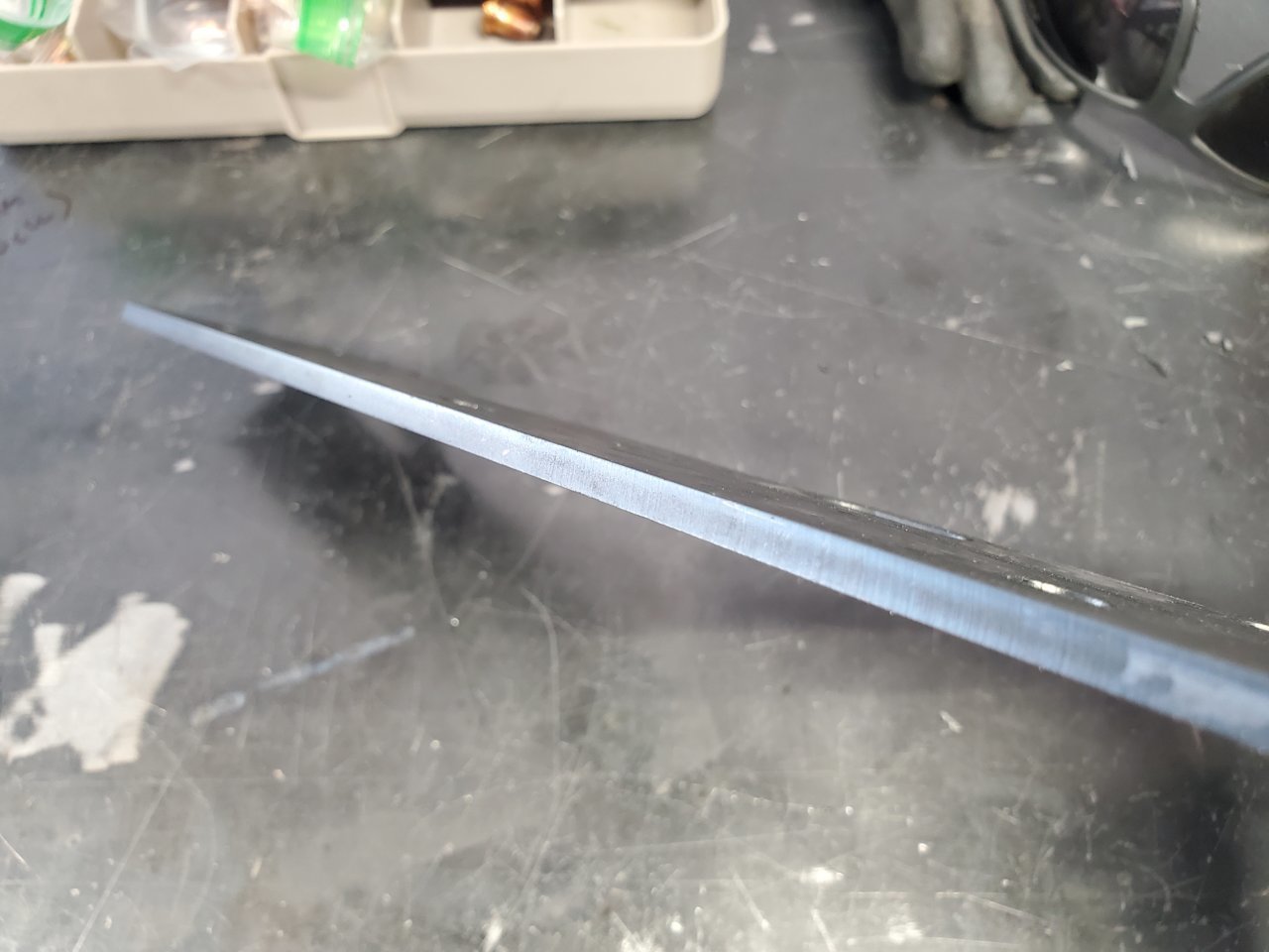

    I did what I did last time; loosened up the gantry tube bolts and squared things up again.
    I don't know if I just need to throw on some loctite or something cause guess what, it's cutting square again.
    On 3/16" it was super obvious as the metal is thick enough to display a large bevel; not today!
    Can see how clean and square it cut.
    Putting that press brake to use.
    KRAMERICA, RDT415, dk_crew and 7 others like this.

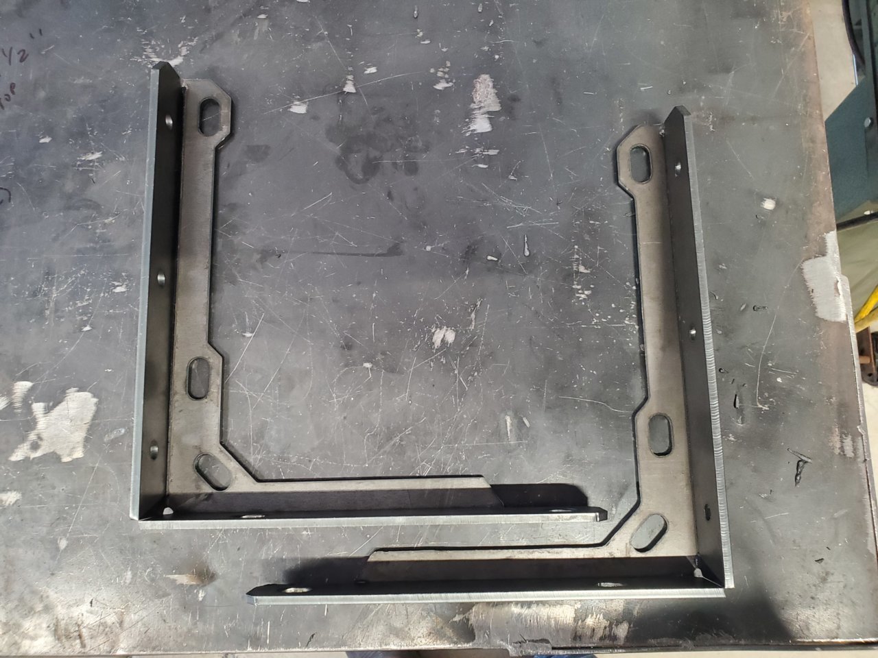

    Heck yeah! Nice work. Some bed stiffeners. Great job

    The goal was a square cut; achieved once again.
    Need to cut more since several people want some after posting in the 1st Gen section.

    Moving up to a much larger table...

    Those are some fancy looking bed stiffeners.
    Are you sharing that dxf file or is that something you make $$ off of?
