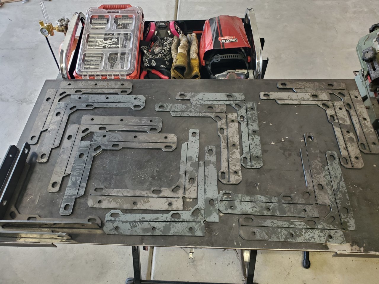

    Initially I was just making a set for a friend but with the demand, I'll make a few bucks off each set; they're for 1st Gens.
    Shipping is $22 flat rate so that takes up a chunk of the total price.

    I guess we'll see how many I make today. I've got two 4' x 4' sheets of 10 gauge and was thinking of making 6 or so sets. Can probably make what, 24-30 sets?

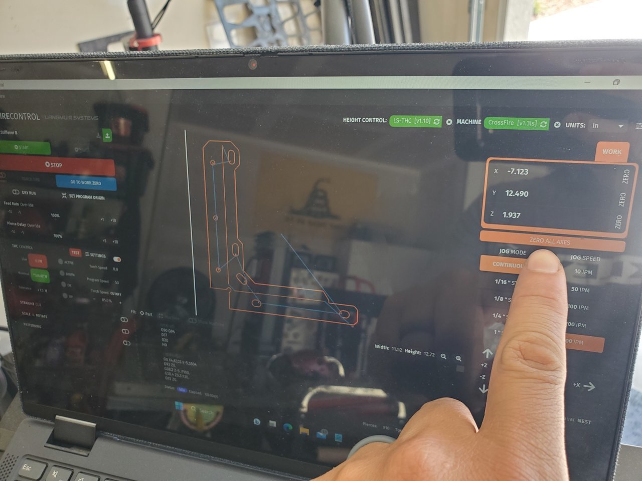

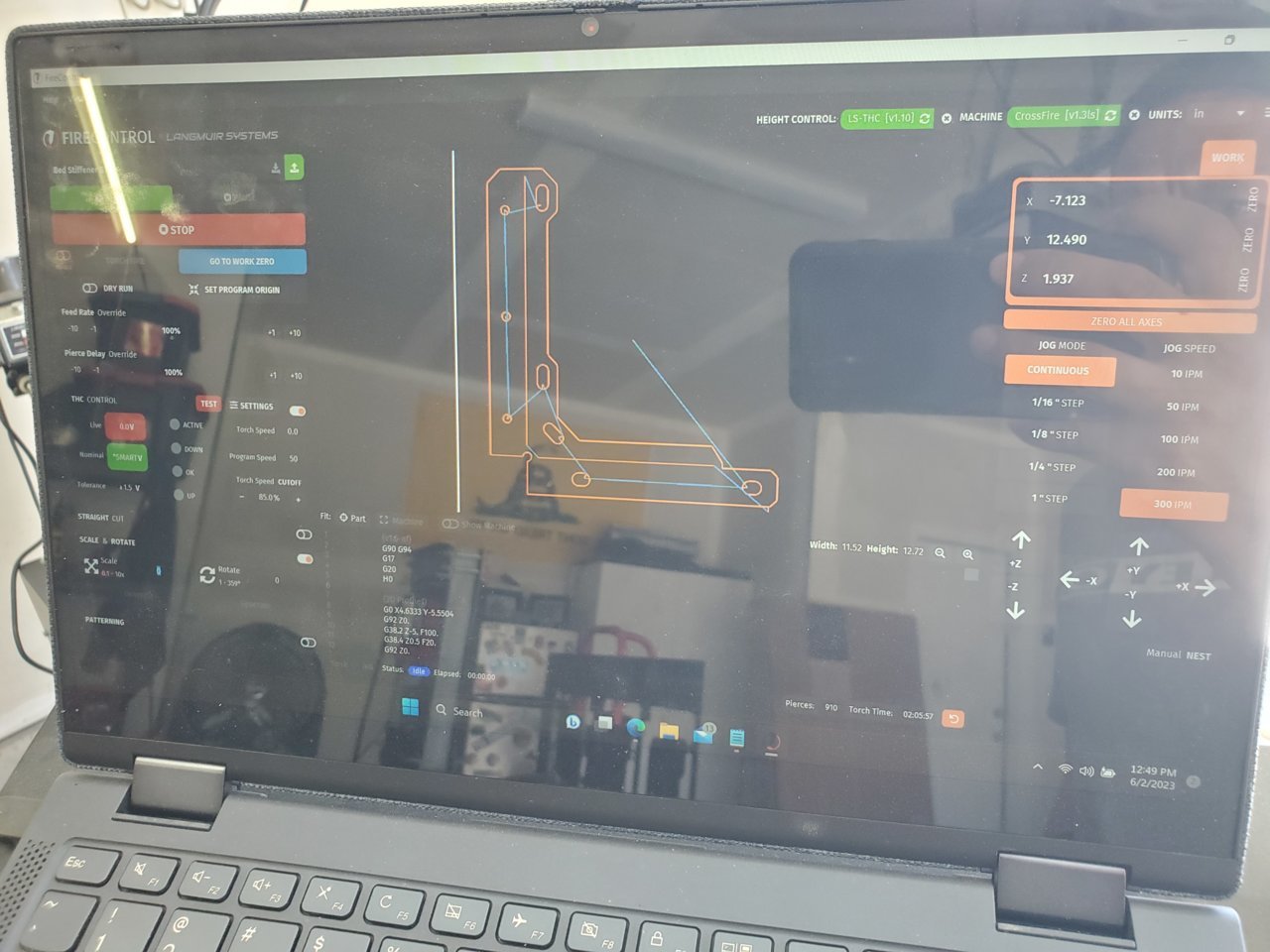

    What are you using to nest? (Im not familiar with the software package the langmuire systems come with)
    koditten likes this.
  9. Jun 2, 2023 at 12:50 PM
    Kwikvette
    Feb 27, 2019
    #284735
    81,793
    Fresno County
    4 run, 2 don't
    Langmuire does offer an add-on for like $99 for repeatability and all that.
    And I believe it allows for indexing, cause I know it's needed for the larger machines such as the Pro and XR.
    But since I cut each one individually, I can just rotate as needed and zero my position with the click of a mouse.

    I use Fusion 360 to make a bunch of copies, then I move/rotate the design to fit into the smallest area needed. Basically hand nesting.
    The controller software does not do the arranging of the designs.

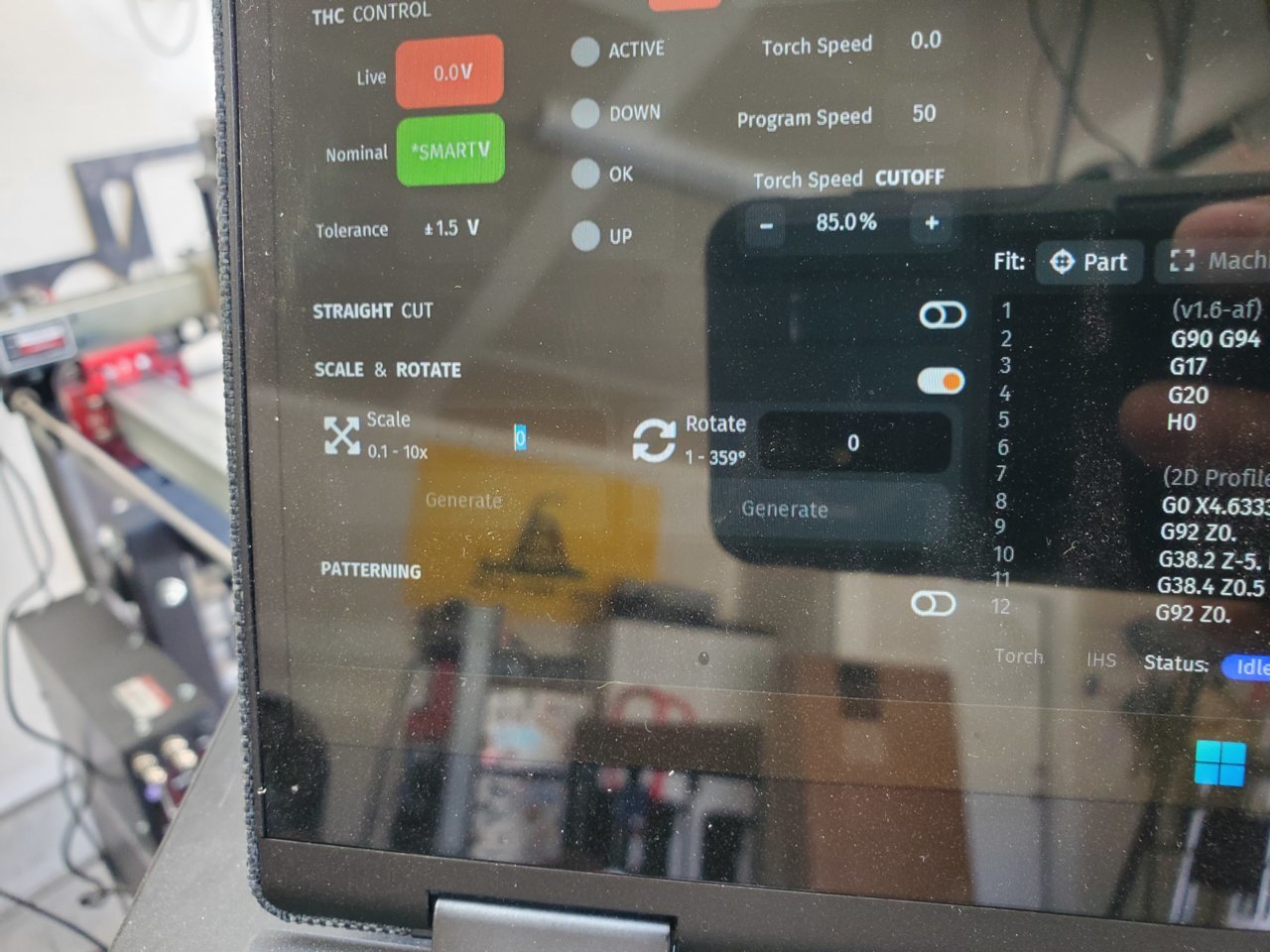

    I wish someone would have dumbed it down for me when I was learning the CNC plasma table game.
    Design software and controller software are separate.
    Design your part and make copies using your favorite program. The design program will allow you to move and pivot your design to nest any way you like. The cad ( design software) was my biggest challenge...and I'm still learning Fusion 360.
    Once you have the number of copies of your part and have arranged them to get the most use out of the sheet of iron, you can tell the the design software to generate the "G" code. There will be choices you need to make-speed of cutter-pierce height-start inside/start outside and some others. You can test run the cut pattern on your computer before you tell the program to " post process".(generate or build the G code)
    Now it's time to import that "G" code to the table controller software. The table will now run the cutter in the same fashion that the design software specified.
