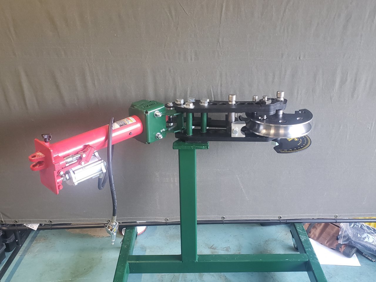

    2x3 tube for the stand. Harbor freight air over hydraulic ram an the swag mount for the cylinder.
    Setup for 1.75 tube

    That is looking damn near identical to what I was going to do.
    Got plenty of 2" x 3" left over; someone on this thread said they needed some?

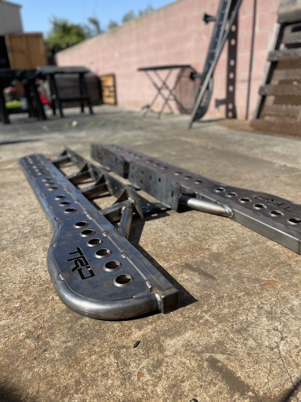

    The new crossfire pro has been getting a workout!
    Took a ton of measurements for DCSB, DCLB, and crew max tundras and started CNC cutting out the frame plates for my sliders

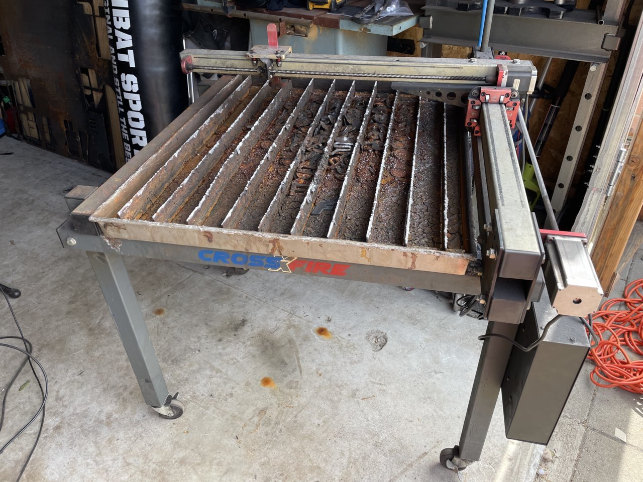

    For those wondering, the XL kit adds 10" of cutting area as it replaces one of the main and gantry tubes to allow full use of the water table.
    You'll notice movement of the torch is restricted on one plane due to the mounting bracket. The replacement tubes move the mounting bracket farther down to allow the torch more travel.

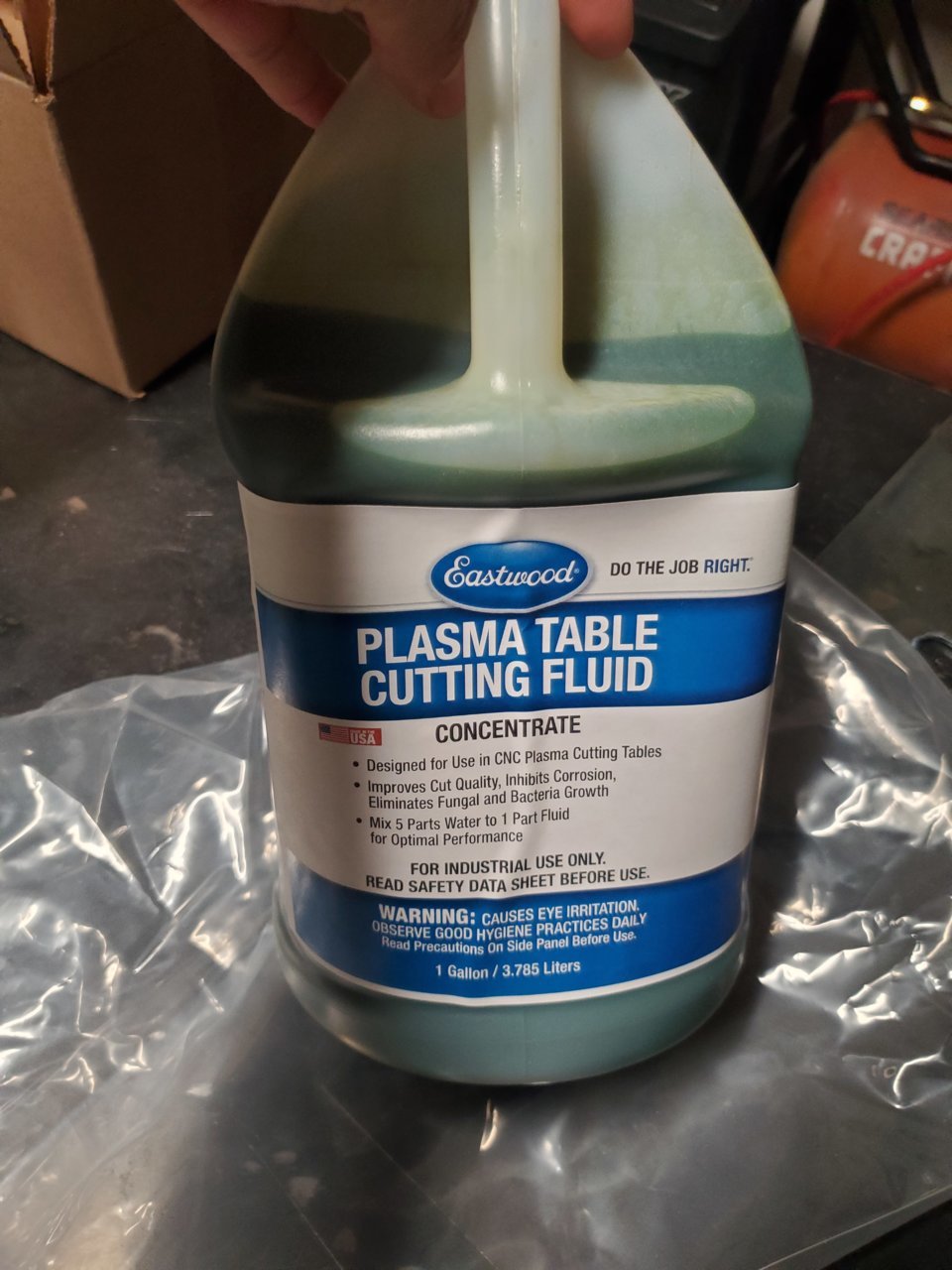

    Is anyone using the home made water table fluid?
    If yes, can I get a review?
  13. Jun 14, 2023 at 8:02 AM
    Kwikvette
    Feb 27, 2019
    #284735
    81,580
    Fresno County
    4 run, 2 don't
    I keep hearing Borax thrown out there.
    After months of using this stuff, and still being able to use it for awhile longer, I'll be sticking to it -
    koditten[QUOTED] likes this.

    We tried home made on our first table and it was marginally adequate... commercial fluids are 10x better IMO.
    I just dumped 55 gal of SterlingCool Plasma Fluid in our new machine (800 gal water table).
    Initially I am fairly impressed with it. The gunk seems to clump together better and settle to the bottom of the table rather than floating around and mixing.
    Chose it because it was cheap(er) per gallon than others and got good recommendations. Mixes at 5-10% by volumn.

    Thanks for the replies, guys.
    Another question, does it evaporate as fast as plain water?
    If yes, do you just top it off with plain water?
    My table will sit for 4 months while I'm south for the winter. If it's just easier to use water, I'll just do that.
    Thanks in advance
    Kirk

    We just top off with water. The fluid doesnt seem to evaporate as quickly as they are typically some type of water soluble oil.
    And we typically top off weekly. Between heat based evaporation and evaporation due to Colorado's wonderfully low humidity, we lose a lot. Once we start seeing rust on the table, then we add more cutting fluid.
    I would drain the table if I were leaving it for 4 months. Either fully drained, or into a sealable container for later use. The other option is to fab up a cover for the table that can be installed during those long stints to reduce evaporation, as it seem like those might be a somewhat common occurrence for you (judging from some past posts).

    I find myself adding water; fluid itself doesn't seem to evaporate but I do add water once a week...at least 2 gallons worth each time?

    I have been thinking about a cover. My worry is I don't think a cover that covers the gantry as well as the water pan would be good.
    I keep the shop at 50* and I would expect the gantry to cool faster than the WP and could develope condensation. I don't want condensation on the steppers or the gear rails.
    Decision, decisions...
