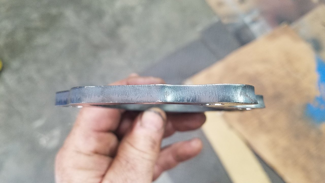

    I actually did some welding today!!!...and forgot to get a pic after the welding. Wasn't anything pretty anyway. The guy showed to pick it up and we got to talking...forgot my pics!
    Neighbor is making a rally car out of an old Miata. He's mounting a T-25 turbo and asked me if I could make an adapter plate to go to the exhaust.
    Drew it up in conFusion 360 last night. I cut an 18 gauge test part, then two pieces at 6mm each to be welded together.
    He wanted it "at least 1/2" thick". I told him that was overkill, but, it's his car. I cut two of these, bolted them together, and welded them up.
    Designed and made this a couple days ago. I was happy with it. 18 gauge. I'll probably cut a 26 gauge back plate for strength and more color. It's actually fairly rigid w/out a plate, but 26 gauge is only $1/ft2 right now, so why not add some color to make it pop.

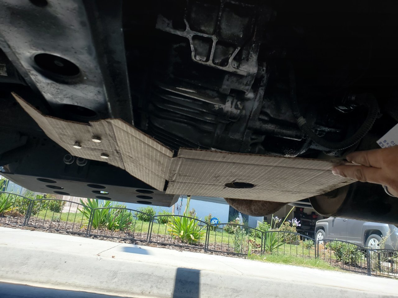

    Did some cardboard aided design for a skid; will draw it up on Fusion later tonight
    It'll be out of 1/4" plate, and will utilize 3 existing bolt holes on the crossmember as well as having an opening for drain port access
    Should be fun putting it on the press brake to get the intended bends below

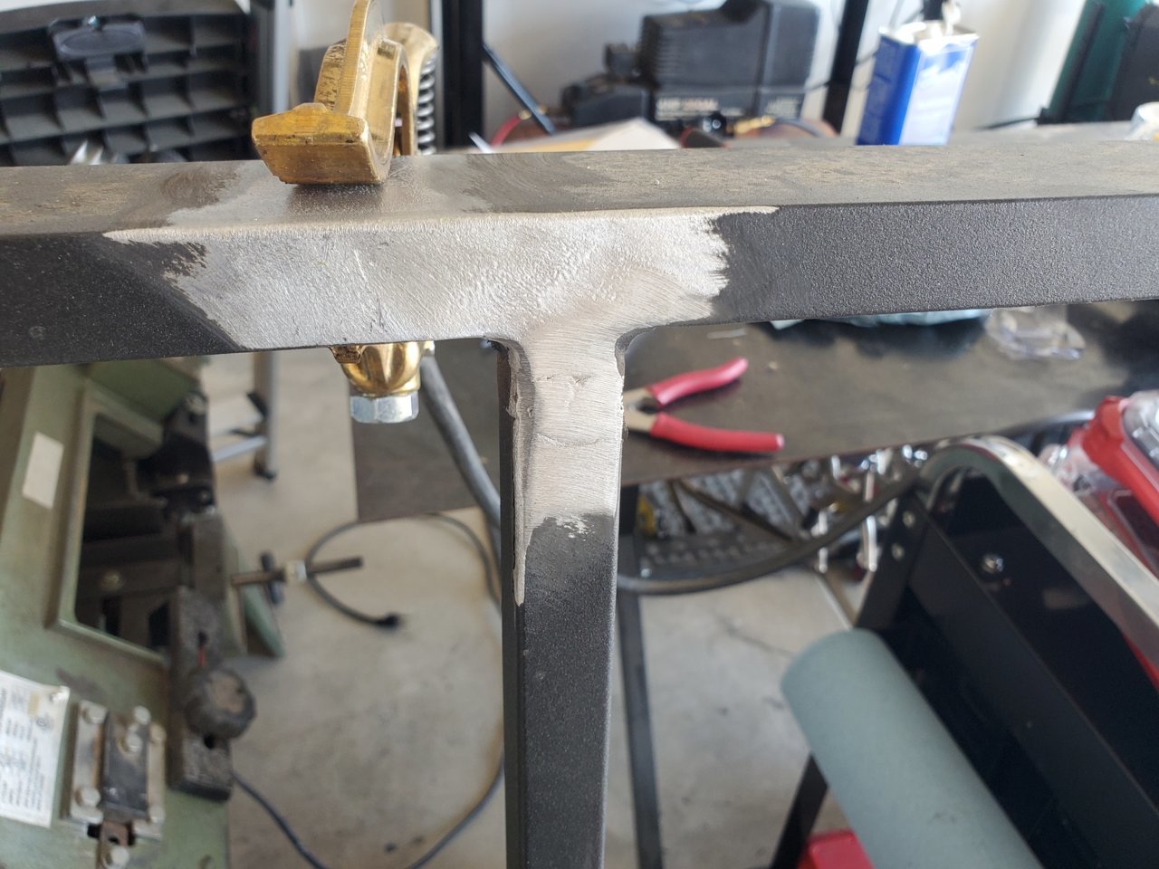

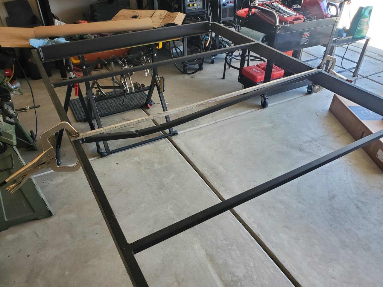

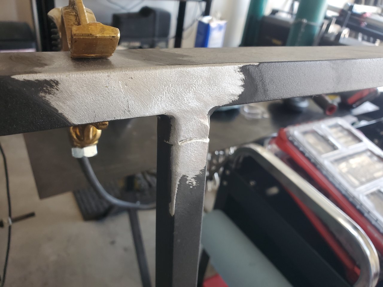

    Also took care of my neighbor's aluminum patio furniture; this one had a severely bent center piece
    Problem is, he'd have to return the whole thing and wait for weeks as it's on backorder through the company. Too much time has passed to return it to Home Depot so I figured I'd bend it back and weld it back up
