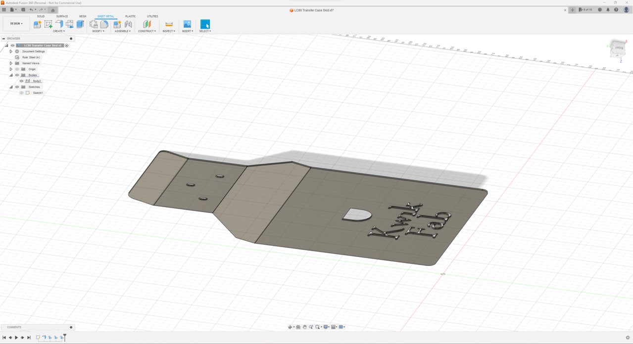

    So you basically start on one end and work out towards the other.
    You work off a basic sketch, then go to create a flange. Make sure you draw lines where you want your bends to be; do not extrude your sketch.
    Flange will automatically 'extrude' it and you will be asked to choose a side (1 or 2). I picked 2 as that will apply the sketch on top of your solid, versus below it. You can opt to work whichever way you want.
    Once you've selected your material (it didn't let me input a thickness, just STEEL IN.), you can proceed with using the bend feature.

    When utilizing the bend feature, remind yourself that the first thing you're choosing is STATIONARY side which means, this part (towards the rear of your work piece not bent) will sit in place, and everything ahead of it that you choose on the other side of your line will be bent.

    I posted my question on Langmuir group (Facebook) cause I thought...maybe I'm crazy in thinking that Fusion will recalculate my dimensions to make up for the bends but I guess it does it for you.
    Trying to figure it out but I bet I'll get the answer right away anyway; I couldn't see the option anywhere when I was in Fusion and it didn't allow me to edit certain parameters where I thought I would input my desired thickness.

    Ok update.
    You need to draw your initial sketch when you are in the Design -> Sheet Metal section of Fusion.
    Drawing your sketch in Design - > Sketch then bringing it over to Sheet Metal will only bend your design given the dimensions on your drawing. But drawing the sketch in Sheet Metal will adjust and automatically compensate for when you bring your design over to CAM.

    Onto the sheet metal bending stuff -
    Too hot outside so I'll mock up tomorrow.

    Probably missed it, this is just a template to be used to ensure both dimensions as well as figuring out a rear mount to the frame.
    Once done, I'll cut the updated design out of 1/4".
    It's a transfer case skid plate for my Land Cruiser.
