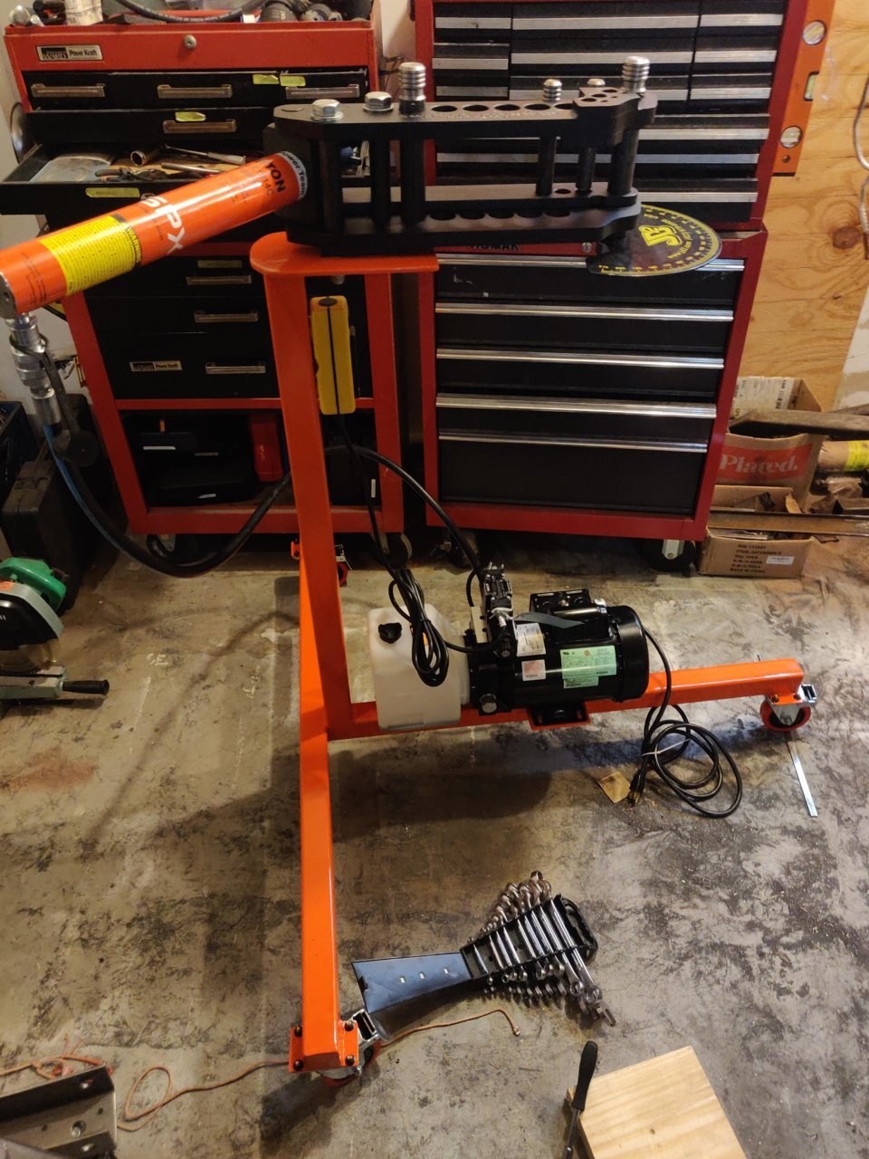

    The rolling stand is really handy for me since I'm space constrained. 2" square tube with 1/4" sheet for mounting pads.
    Kwikvette[QUOTED] and Drainbung like this.

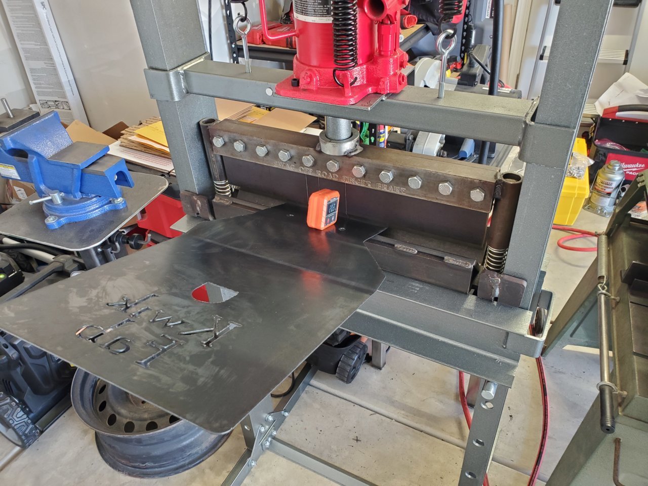

    Question for you guys with the JD bender.. what's your minimum offset for a tubing bend? Asked another way.. how much straight tube do you have to have before starting the bend for say a 6" radius?
    I really like the Rogue Fab 605 since it's fairly easy to dial in accuracy and perform tweaks (by leaving the tube clamps attached while moving to the next bend). My only grumble is that there's a 5.25" offset required for 4.5" radius bends (and a 6" offset for 6" radius.)

    I have over 20' of angle iron ready to be cut down to put on the brake for tighter bends but in this case, the skid benefits from those large radius bends.
    I really only wanted about an inch of clearance from the lowest part of the transfer case as to not sacrifice ground clearance.

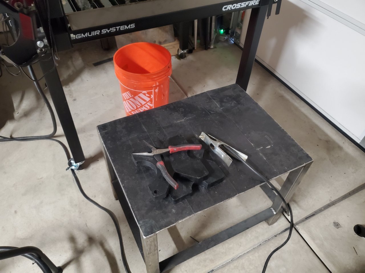

    I have some pieces I use for the same purpose. I cut a lot of my signs out of 18 gauge and it can be bad about warping in areas where there is a lot of cutting going on.
    I have an 18" piece of 1/2" PVC pipe and an retractable magnet at my table. After I hit start when cutting 18 ga or thinner, I pick them up and I am armed for tip ups and excessive rebound/warpage. I use the pipe to hold down on the metal if I see much rebound after the tip lifts. Also, when I grab a tip up, I use the pipe to trap it against something to get it off the magnet.

    Damn, you thought it through completely.
    Me, I don't worry about tip ups unless -
    1. My cut path causes the torch to run back over a previously cut piece
    2. It's thin stuff like 16 gauge or 14 gauge since I don't cut anything thinner than that
    If I do get a tip up, and the torch has to travel back over that area, then I pause my cut and remove that piece with needle nose pliers. Those pliers and arbor plates live at a small table next to my CNC table :laughing:
    Otherwise, I leave my work being cut unattended (but I'll still be in the garage working on something else)
    Be curious to see a pic of your setup you described

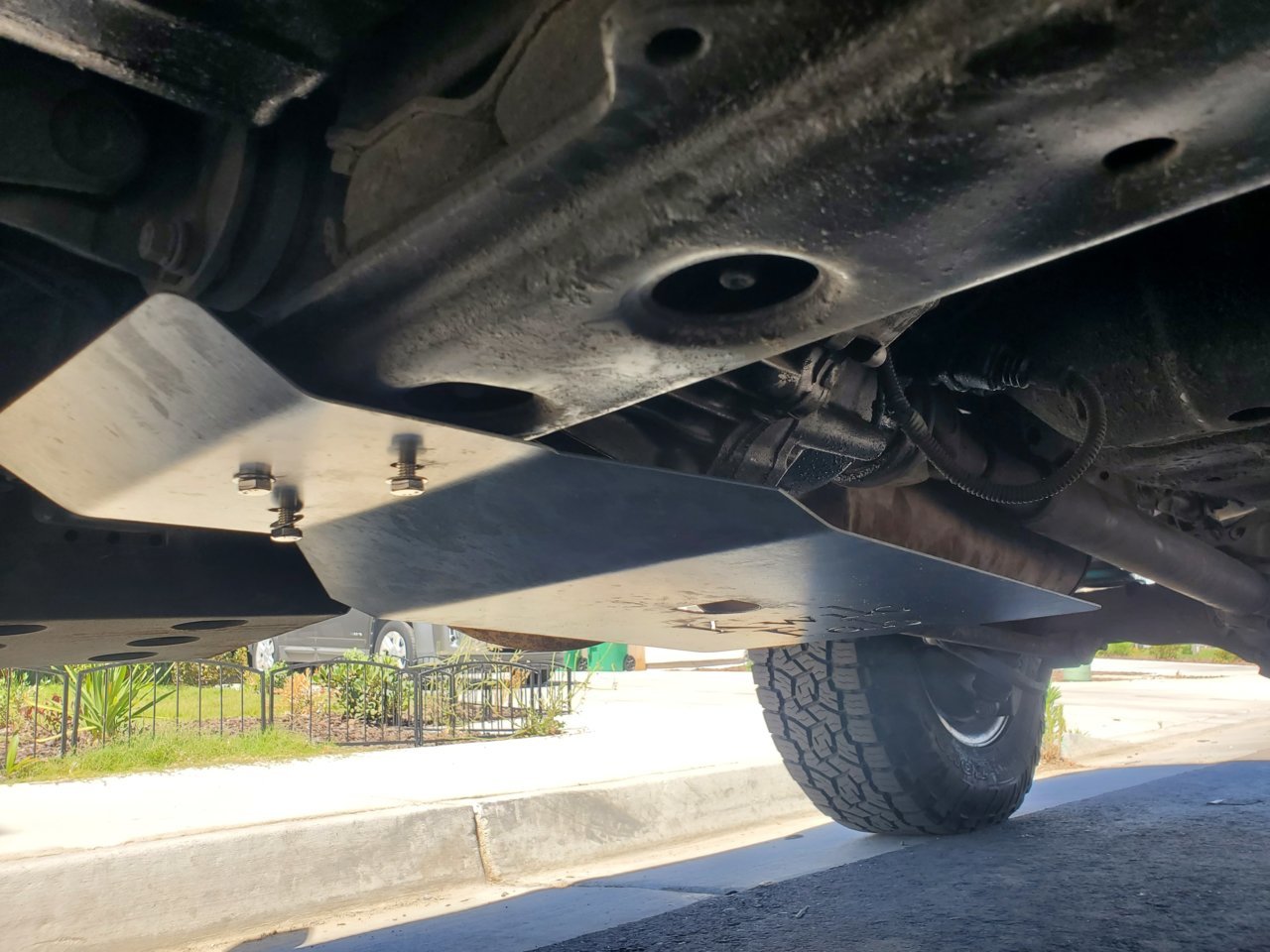

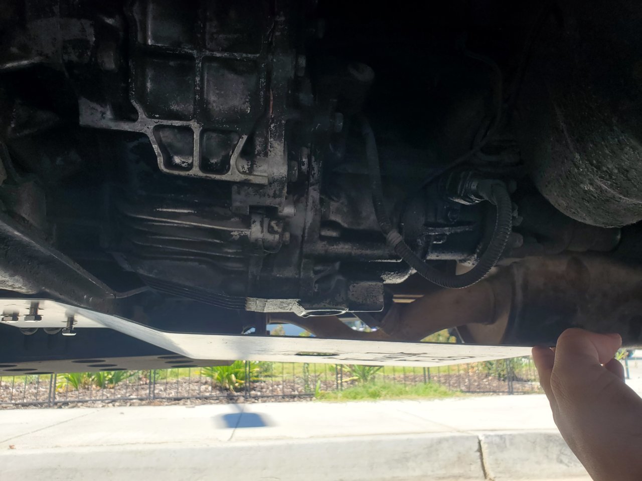

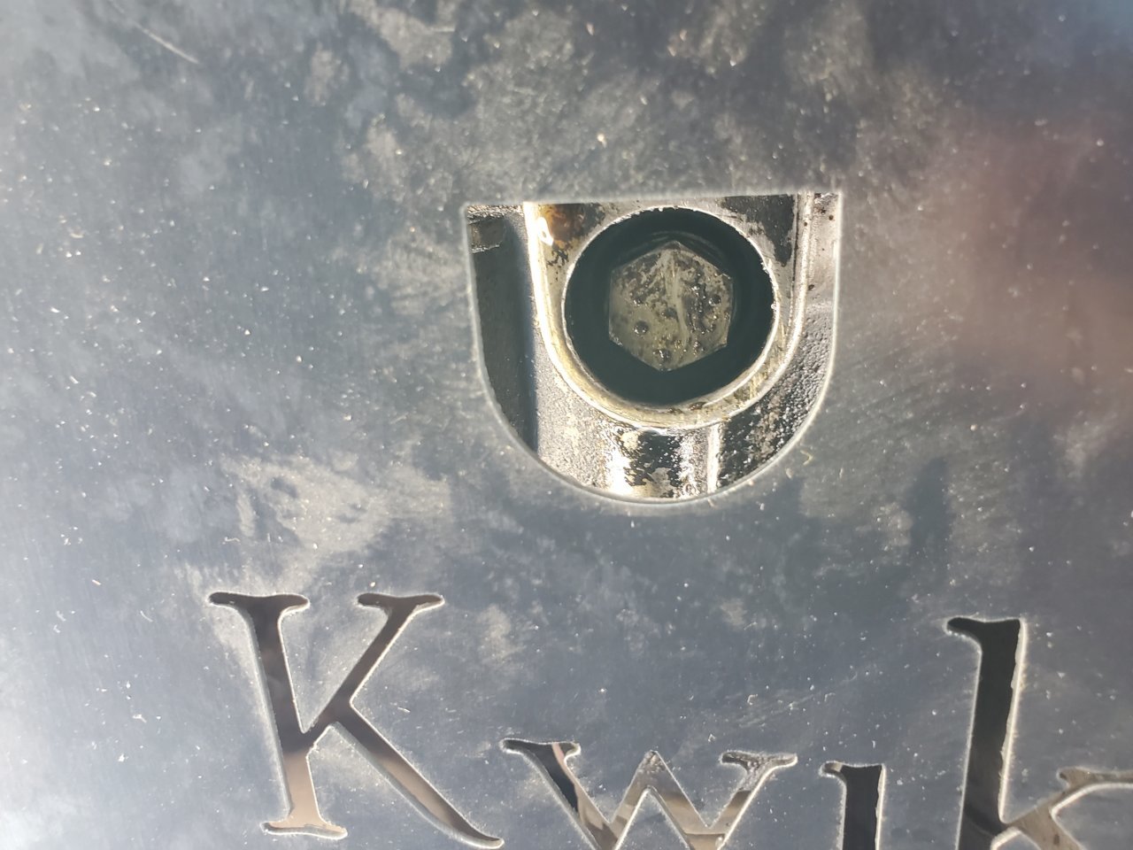

    Having forgotten that it was Father's Day, my wife's taking me out to dinner so I'm unable to work on mounting my skid
    Her words being "you're not supposed to do anything today"
    So I did a 5 minute test fit -
    Properly butted up to a rear mount, access to the drain plug will look like this -
    Clearance will be a bit tighter than this, just ran into one tiny hiccup -
    The hiccup being that, my measurements translated to my skid so well...the hardware fits perfect in the slots I created in terms of width/diameter
    The issue is my measurement from the holes center to center was off by less than 1/32" which tells me I should've measured in millimeters
    The difference is the threads catching on the edge of the slot in the skid
    I am loving the large radius bends as it clears the front of the crossmember perfectly

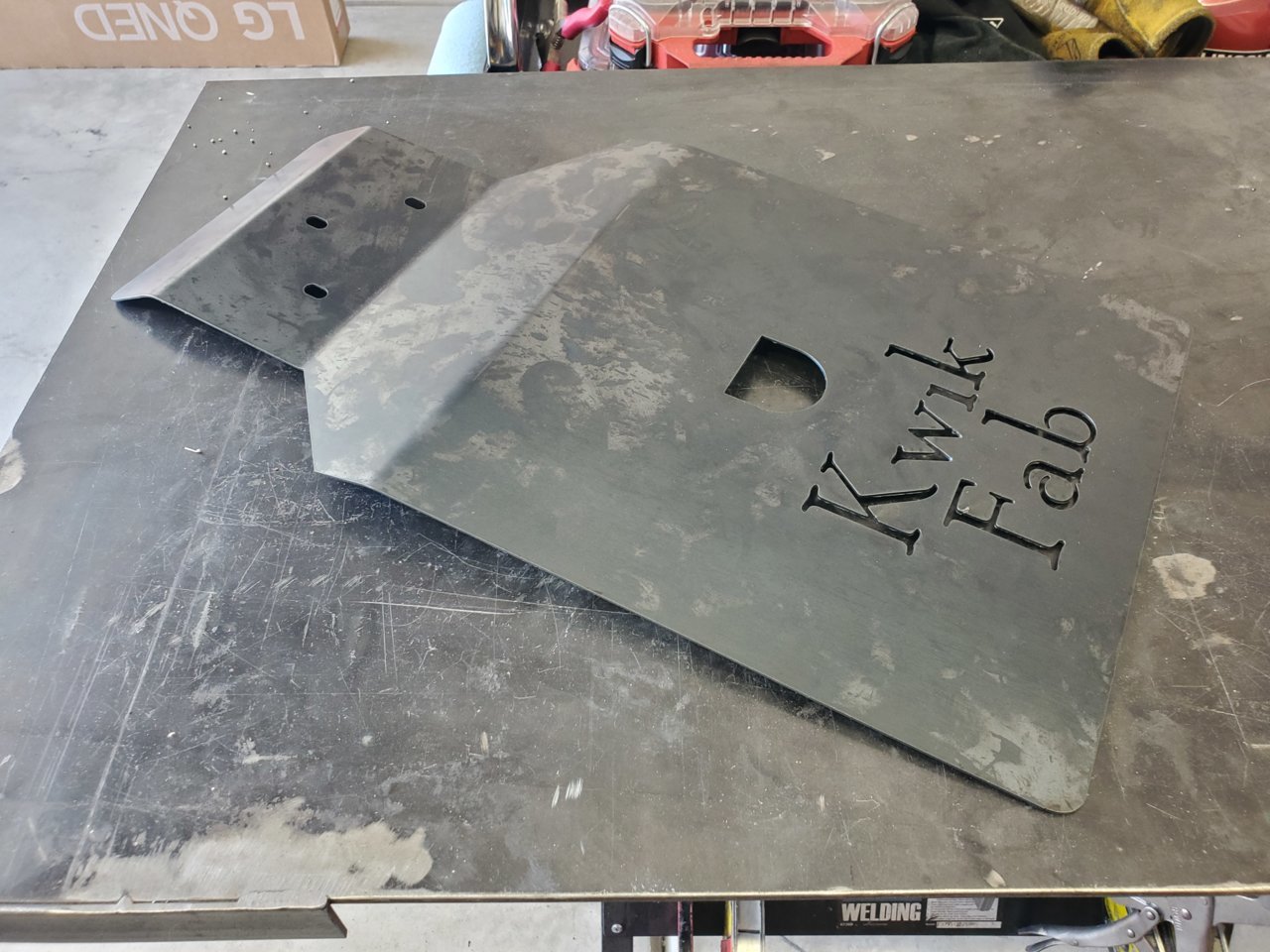

    Did some mock up for mounting the rear of the skid
    Fixed my dimensions in Fusion 360 and thinking I'll cut it all out tomorrow :burp:

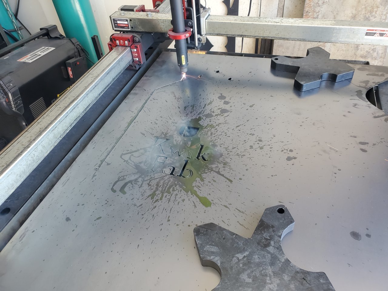

  18. Jun 20, 2023 at 3:23 PM
    Kwikvette
    Feb 27, 2019
    #284735
    81,768
    Fresno County
    4 run, 2 don't
    Giving @Bivouac another opportunity to give me shit for "using my table any chance I can get" :rofl:
    Everyone can appreciate a bevel-free, clean smooth cut :drool:
    Bent and ready to go!

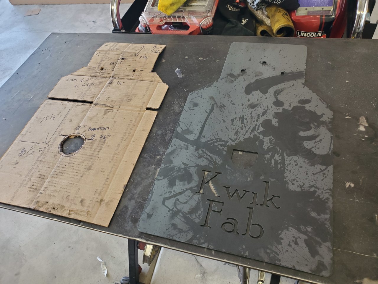

  20. Jun 20, 2023 at 3:51 PM
    Kwikvette
    Feb 27, 2019
    #284735
    81,768
    Fresno County
    4 run, 2 don't
    CNC owners know what's up :fistbump:
    Here's the aftermath from the plate I cut it out of
