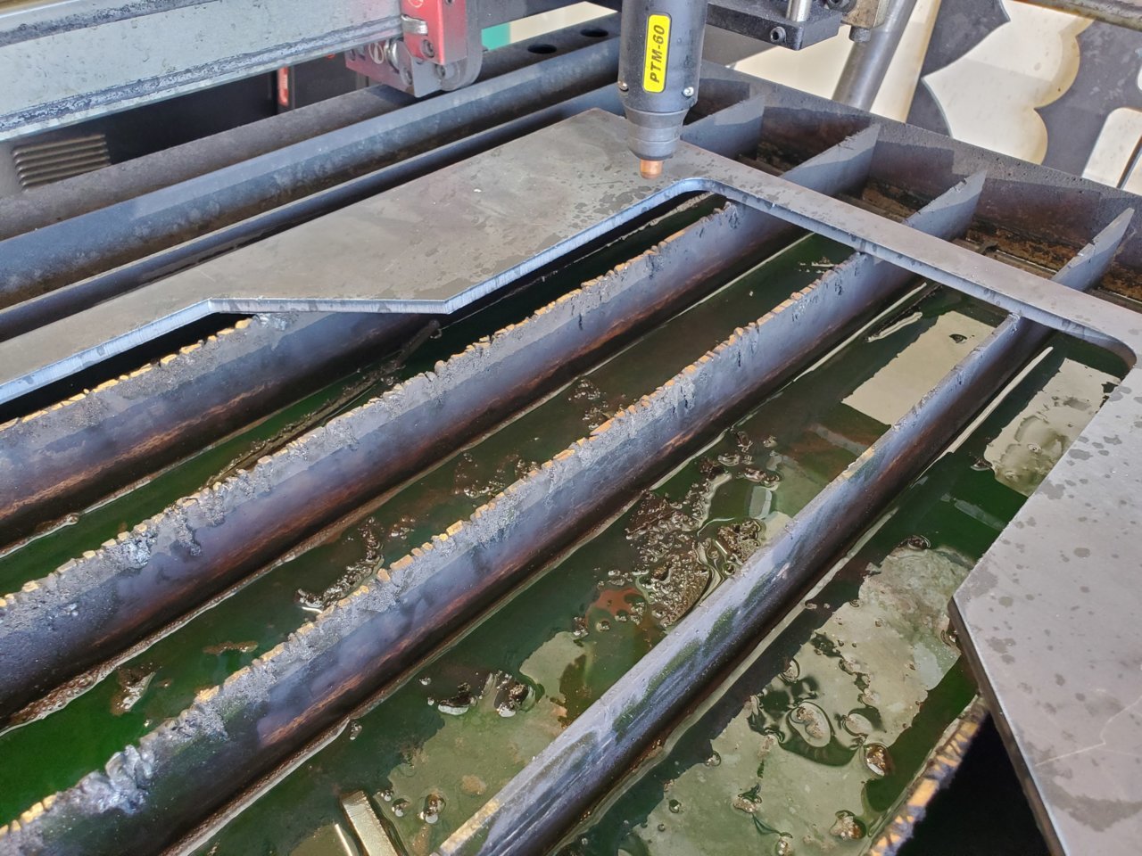

    So I see the slats get cut in the process of using the table. Is there ever a point where the metal will no longer sit level because the slats have gotten so fucked? I imagine it takes a while?

    I was wondering the same thing.

    Those are the 'worst' slats as I often cut stuff in the middle of the table (to minimize splashing).
    It's only "not level" if a piece of slag is stuck on there but a few taps with my chipping hammer, or worst case my angle grinder, it gets knocked off and my pieces still sit flush.
    I probably won't have to replace a few slats for another year or so, and when I do, I can just cut them out myself on my very table.
    I could also swap the end pieces with those in the center as I rarely ever cut towards either edge.

    IIRC, the slats are 2” x 1/8” plate. It would be cheaper to buy the flat stock and just cut it to length as you need replacing. I looked into it when I was considering buying Ryan’s table.

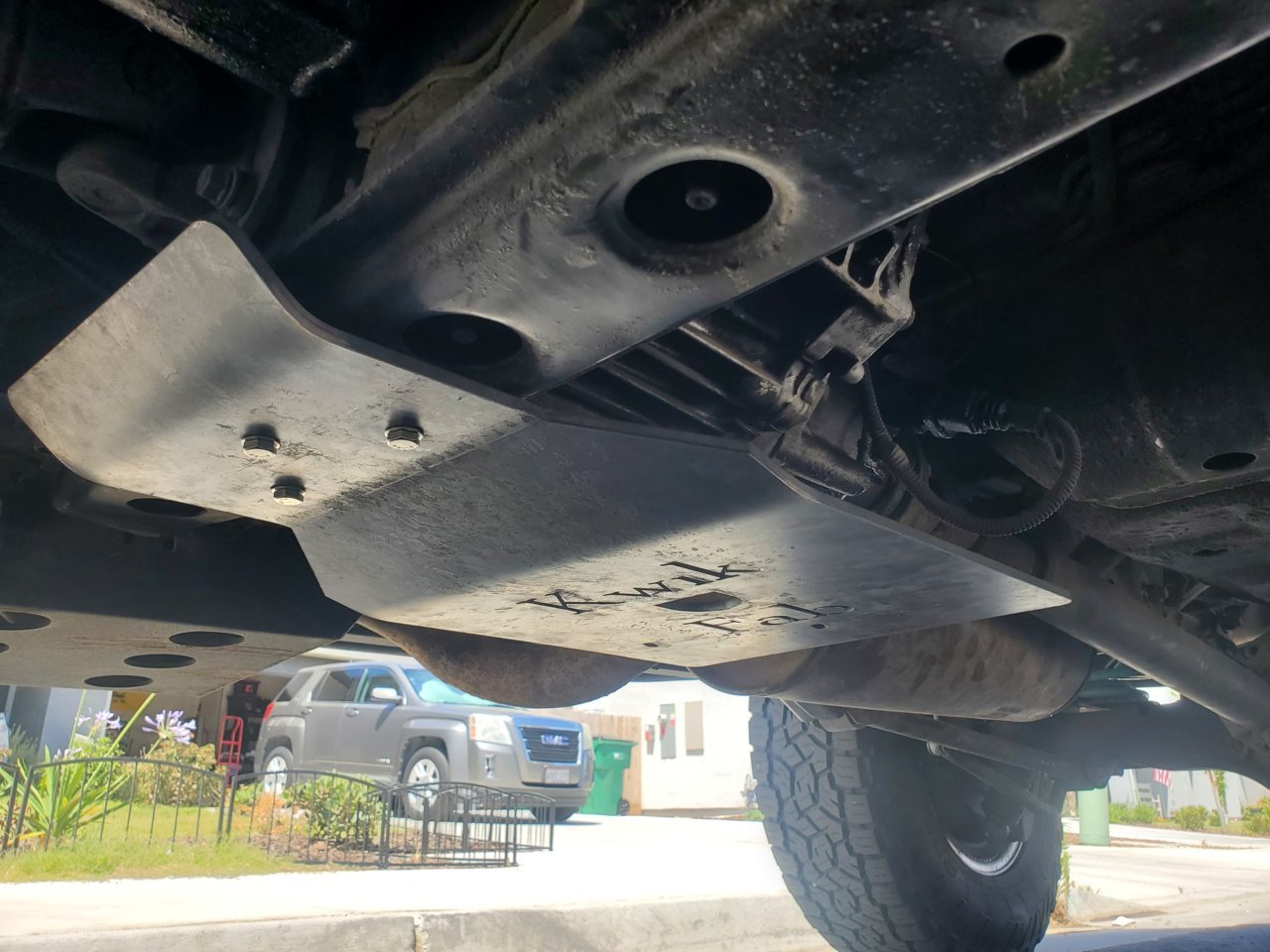

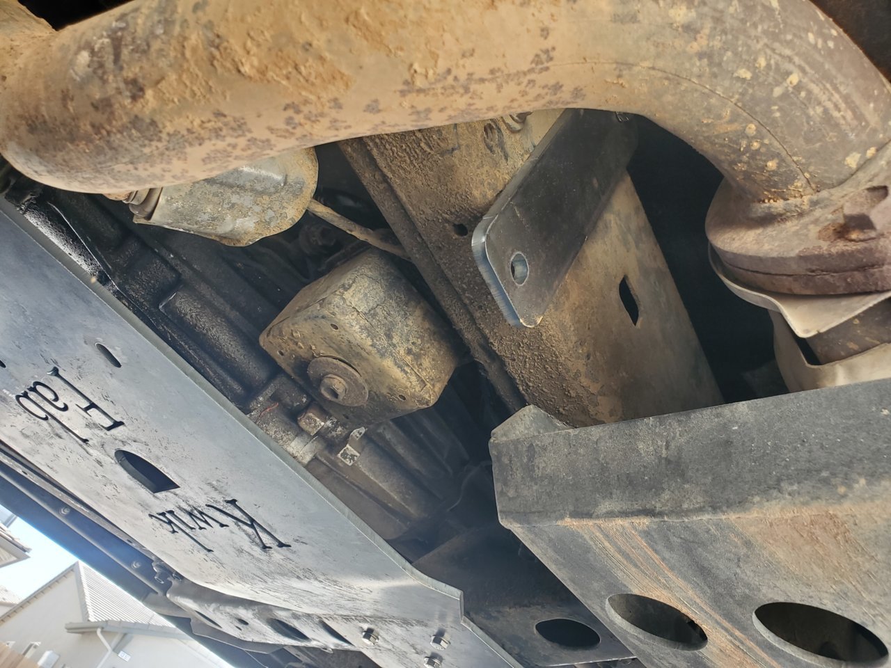

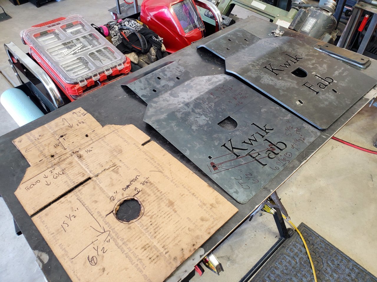

    Fucker's mint
    Just have to order a custom u bolt for clamping to my "bracket" for rear mounting then I'll weld up the square tube to it for bolting to the skid plate

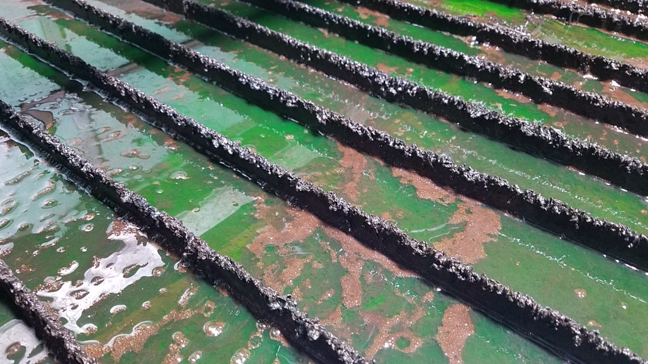

    Here's what mine look like after 6 months of moderate usage. I only break off any actual pieces of metal that get stuck there. I leave the dross (slag) alone and it kinda self heals. I guess I am a little cocky about it assuming the torch height control system is compensating, and so far that is working out for me. No issues caused by being unlevel.

    Looks exactly like mine.
    I had a complete 4 x 8 sheet of 15 gauge sheared into 2" wide strips.
    $70 for 3 years of use so far. When they get real bad, I'll just flip them over.
