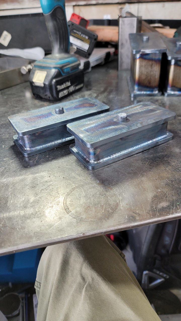

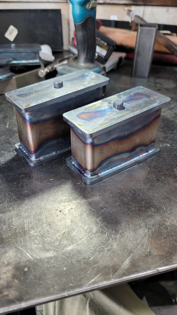

    More blocks lol

    Dude what cup, tungsten, ar cfh you’re using. those look smooth.

    Smooth :fistbump:

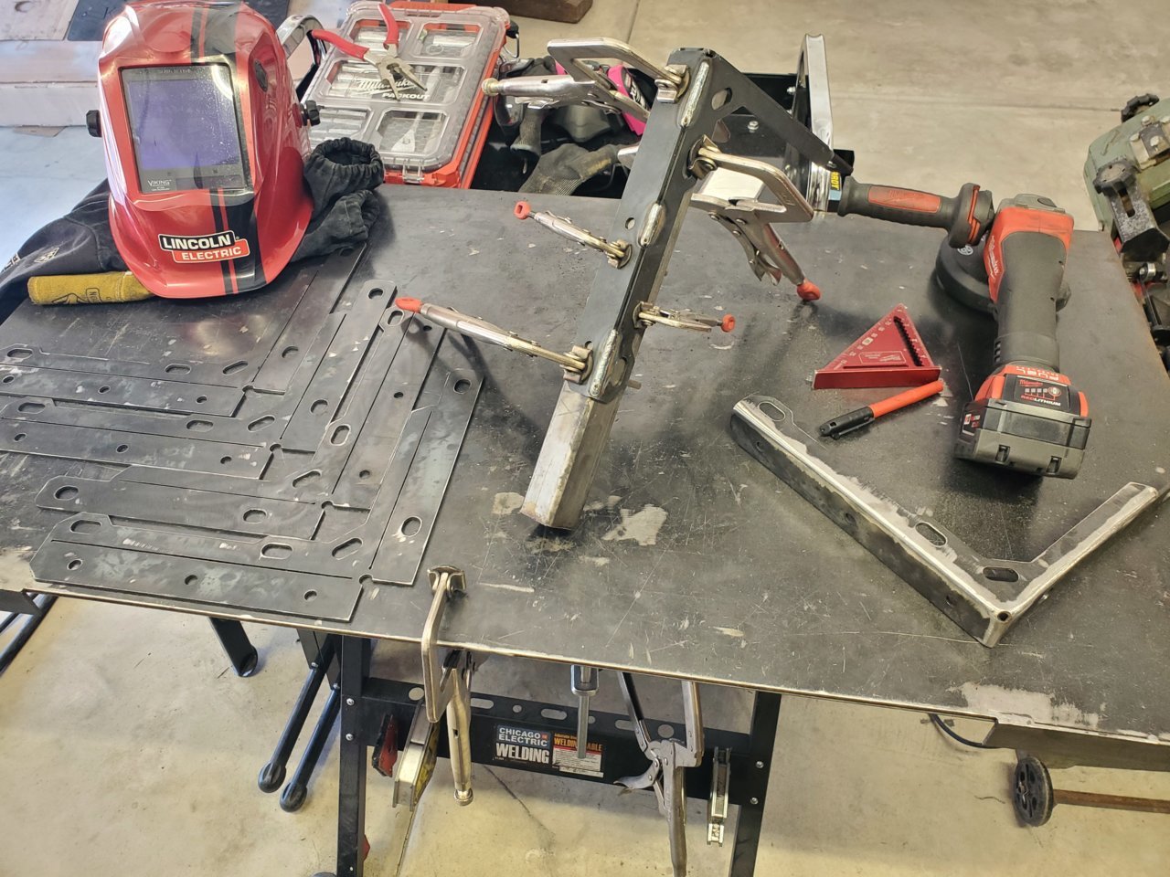

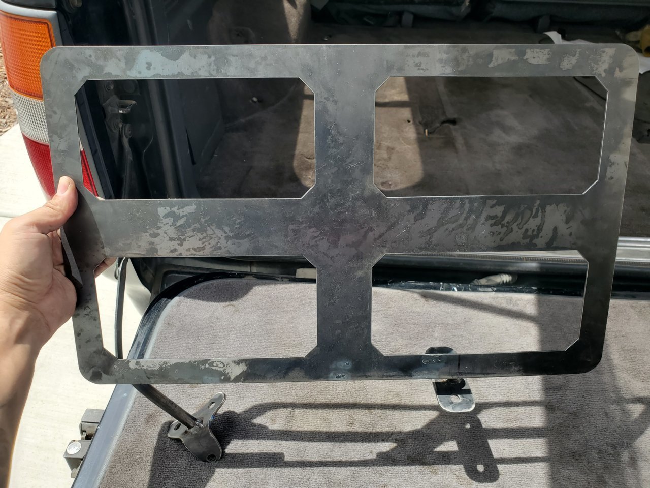

    Little cutting, drilling, and bending.
    Customer wanted a clean way to mount an amp and crossovers for his full system. Can't go against the inside plastic panels cause the components are too big. That and it'll look ghetto. But also can't go in the rear as the width (wheel well to wheel well) will be taken up by the sub box.
    Skeleton will get MDF mounted to it, with amp mounted on that and facing inward.
    Made these mounts to utilize existing mounting points in the vehicle normally used for 3rd row seating.
    Mounts in place; fucking mint.
    Just need to figure welding the plate to said mounts while keeping it level with the side glass.
    Reason for the openings is to maintain clean wiring, meaning the crossovers will mount to the backside of the MDF through those openings.
    This is all he sent as far as how he wants it mounted.

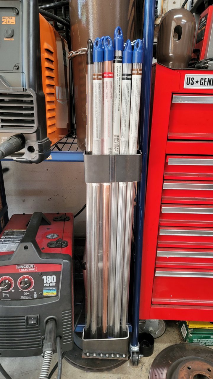

    Here's a 5 minute scrap project I whipped up. I dont feel like doing much else to it lmao

    It works though I did find sparks will melt through those plastic tubes.
    Helpers not aiming sparks in a good direction .

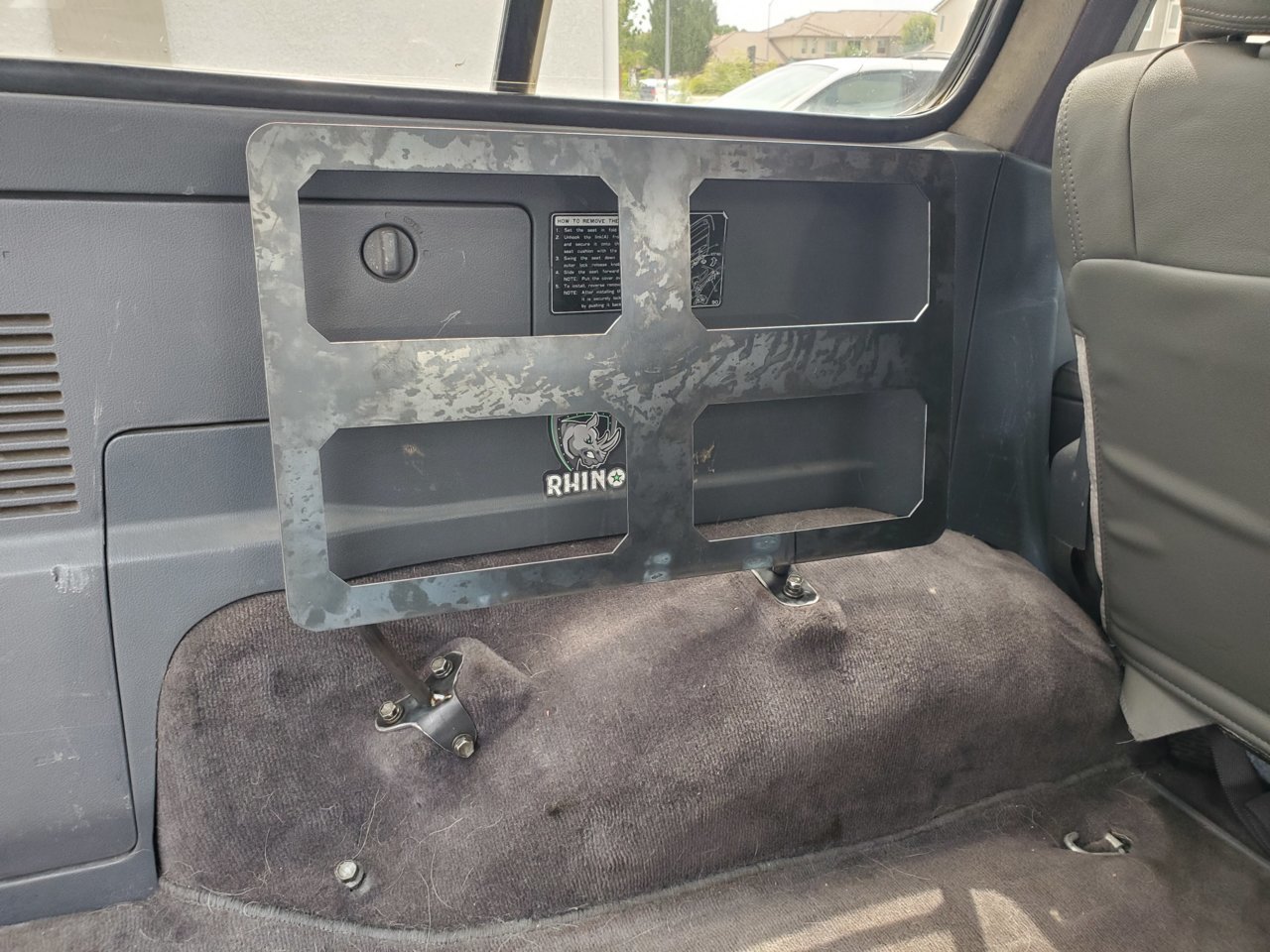

    Product delivered.
    Below while I mocked up the final fitment; bent 1/2" solid rod as that would not only provide a lot of strength, but keep a clean aesthetic over square tube -
    Finished product -
    As mentioned in my own post above, MDF will be attached to the front of this panel for rigidity and a solid mounting platform for the amps and crossovers.

    Yeah I try to avoid the welders with sparks so hopefully they'll be okay lol.
