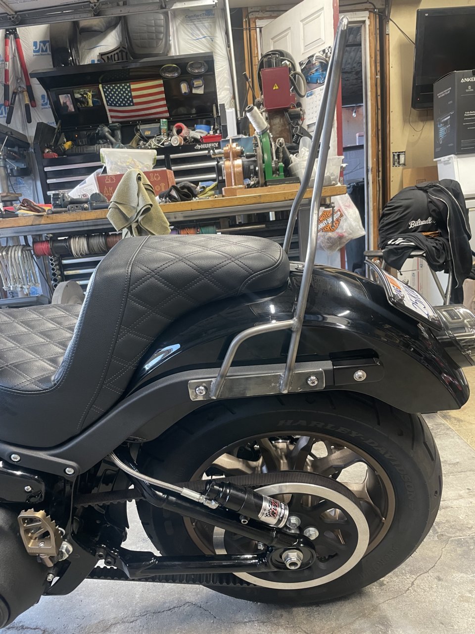

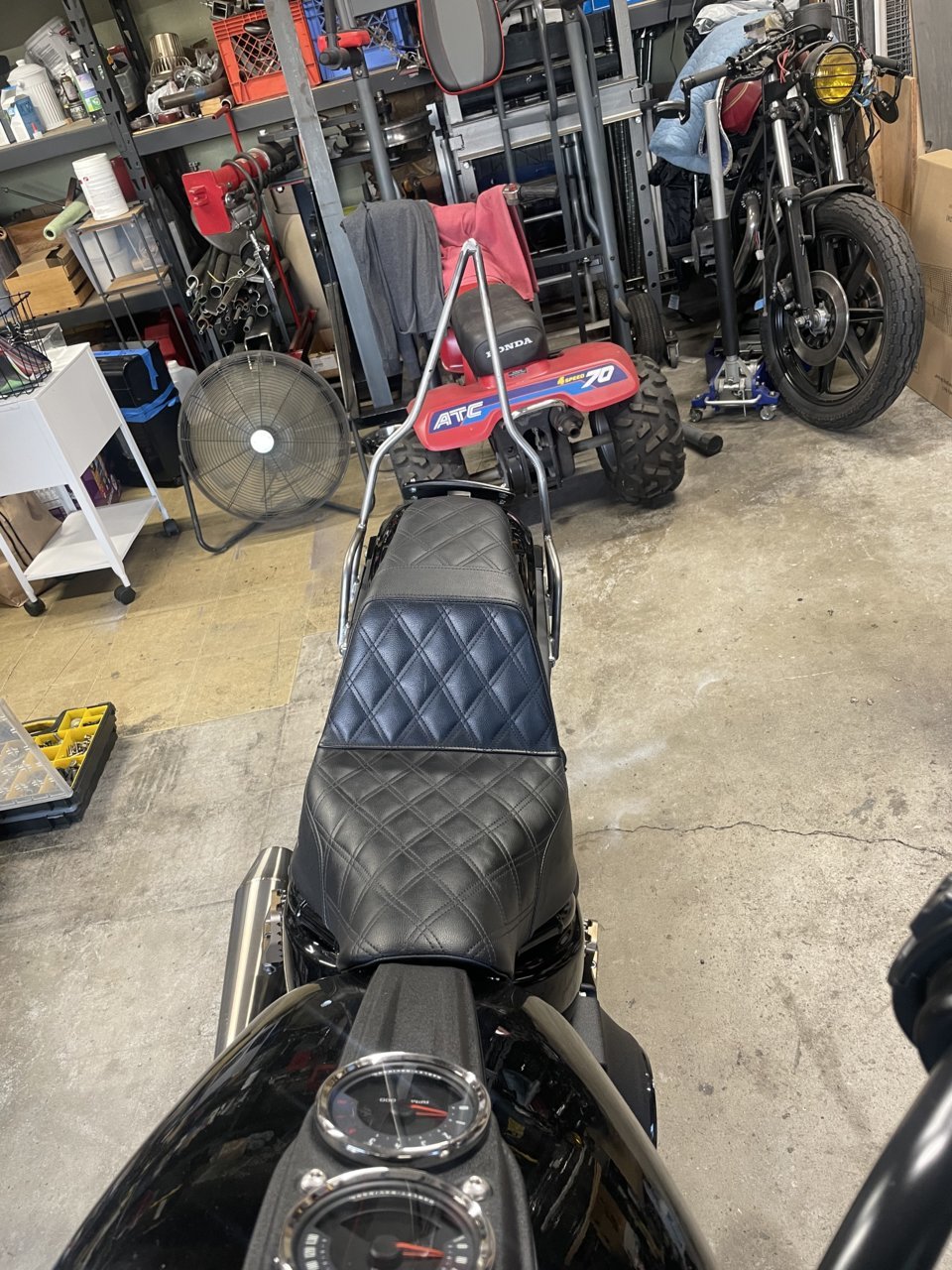

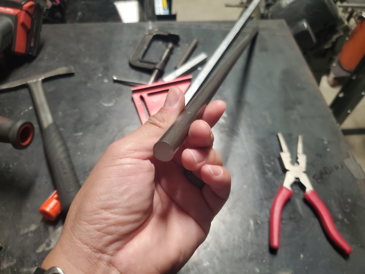

    Funny, I just made a sissy bar for the scooter this weekend with some 1/2”.
    I bend it using my vise with some aluminum soft jaws. The knurling on the steel jaws will transfer to the work piece so the aluminum avoids that. As for the actual bending, I sleeve the solid rod with a 3’ section of 1” tube and use that as my leverage. The tube also prevents the rod from bending anywhere inside the sleeve so you can control the radius of the bend to be tighter by keeping the sleeve right against the vise jaws or have a larger radius by leaving a couple inches exposed. Spring back is a real pain though so I draw out my plans to scale and I constantly check my bends agains it.

    Looks awesome! Good work dude

    it might work for mild steel, but is going to be close. also, 1/2" electrical trade size is 7/8" diameter, so it won't fit tightly.
    i just know i had an apprentice once try to bend rebar with his bender like a standard piece of conduit. he didn't get 10 degree's before the bender popped apart like a button down shirt at a buffet.

    That came out really clean :drool:
    Yeah I didn't have tube at all so I just had to man handle it

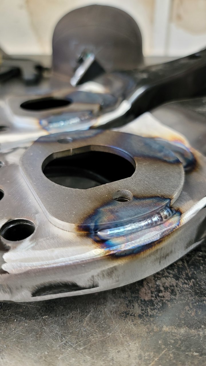

    Not blocks!

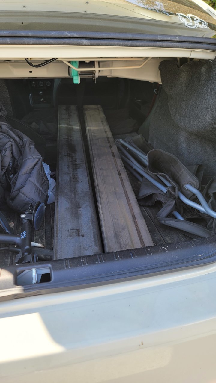

    Well just figured out I was getting ripped off at my go to metal supply.
    I paid I think $120 last time for 5' of 2x5 .120 rectangle tube last time.
    Today I paid $76 for 10' of the same thing at a different metal supply. Safe to say I won't be going back to my usual place.

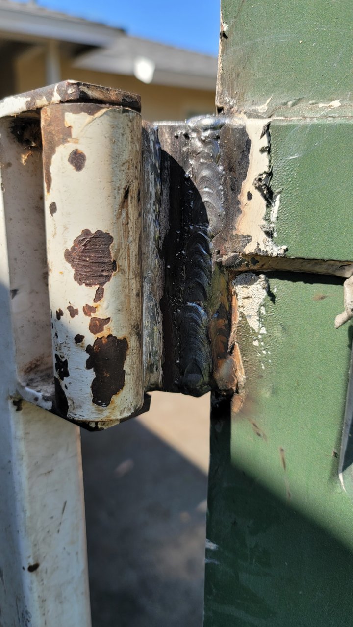

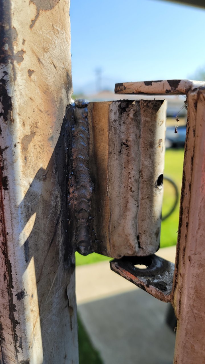

    $80 and a case of beer for this 30 minute job.
