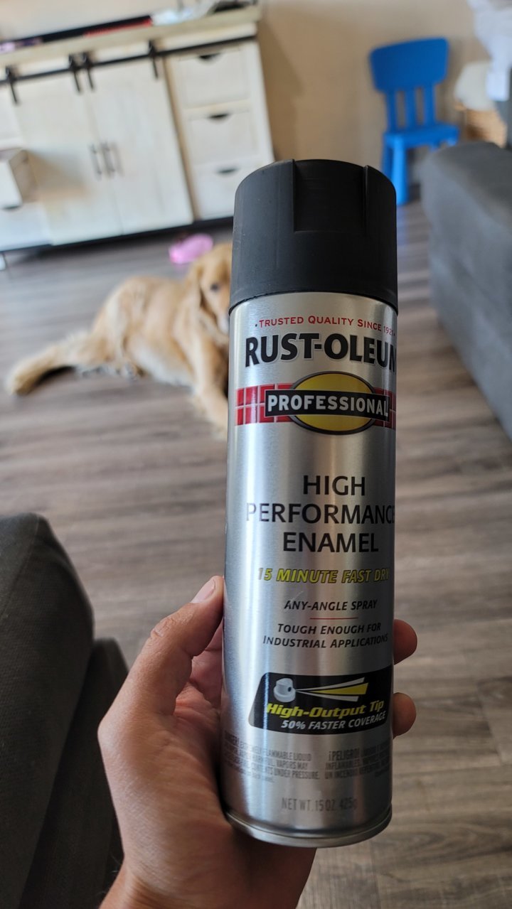

    This paint I'm trying out lays down super smooth. We'll see how durable it is.

    Niiiice, what paint you using?

    I asked what paint IE Rustoleum, Krylon, paint and primer combo, flat sanding paint, etc

    Shit I got a new can of that on my shelf for months now.

    90% of the time I use that, too. I love it. Only issue I've found is that if it dries too fast it'll crinkle a bit.

    I've had really good luck with it so far. One really light coat to start. Wait 20 minutes, then heavy coats after that. 3-4 coats and it's been super smooth.

    This was my latest from last weekend, granted it’s the gloss not the matte. Same though, light coat for adhesion and then three or four heavier for coverage and build. My garage was probably 85 degrees?

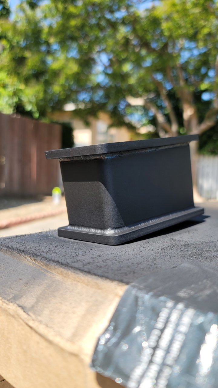

    I painted this set of blocks in direct sunlight and they turned out really smooth.
    After the last coat I put them in the garage to fully dry. It was like 90 degrees yesterday
    Come to think of it, I have way worse luck getting a smooth finish with gloss paint.

    Definitely could have just been that it’s gloss. I’ve had great luck with the flat/matte cans. Oil pan on my cb750 is painted with it and even through heat cycles and road grime it still looks perfect.

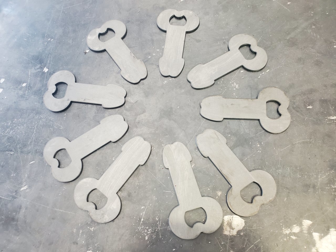

    F Bombs went quick that's for sure, but I had a special request I just had to fulfill today :laughing:

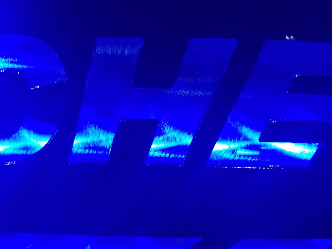

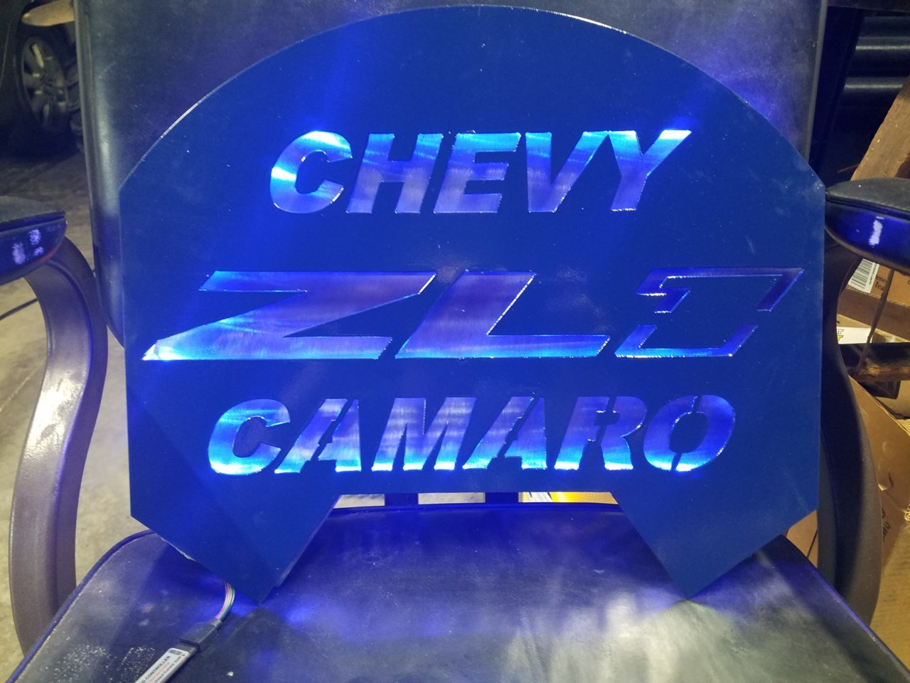

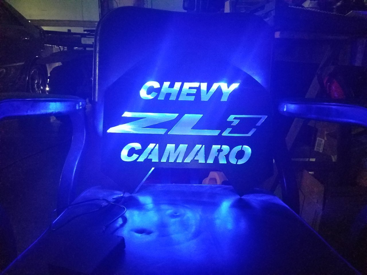

    You might want to give this stuff a try:
    Rust-Oleum 214944 Specialty Reflective Spray, Clear, 10 Fl Oz https://www.amazon.com/dp/B000LNVC1M
    it’s semi-transparent, meaning it’s clear but as you build up more layers it will start to look a bit milky. My experience with it has it reflecting some light but not as much as the safety tape on trailers. It might be that good balance that will act as your clear coat and reflect the light for your projects without you having to add the labor of scuffing the backing plate.

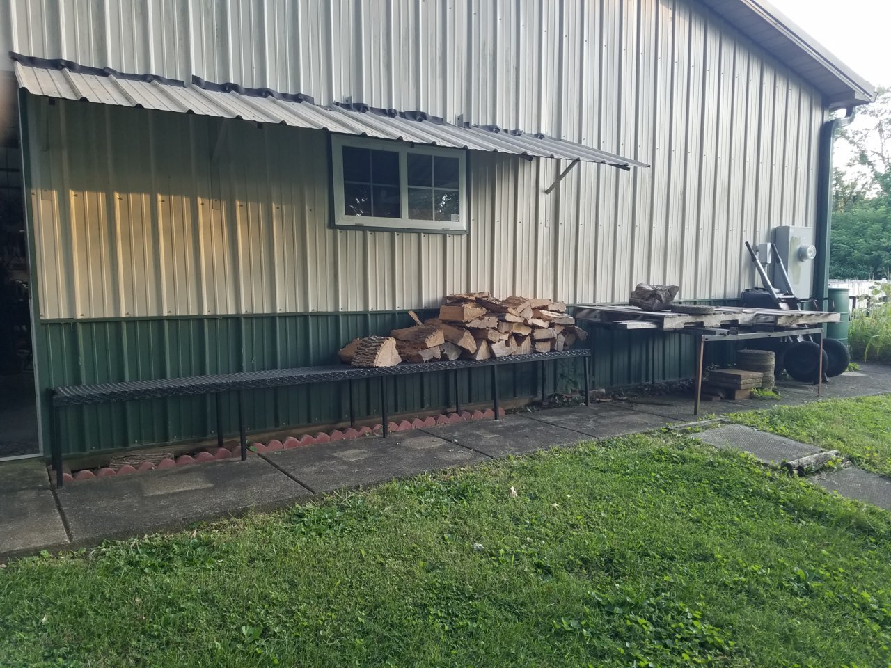

    I remember when I first got my plasma cutter, even a hand job was fun. Now, not so much. Just wanna cut on the table.
    I heat my garage with wood in the winter. I have one 2' x 12' permanent rack completed, but I need two more 5' x 4' racks to make it through and not run out of wood. Been using some temps for the 4'x5' ones. Started a permanent replacement this evening. I use heavy gauge expanded metal, thick wall 1"x1" and 1"x2" tubing. They are plenty strong for wood plus any snow that piles on top.
    I bend the expanded metal over both the front at rear and weld it. Makes the top really tight.
    No glamor shot welds because I didn't put much effort into mill scale removal since these are just wood racks that sit outside behind my garage all winter.
    Need to extend my cover roof also.
