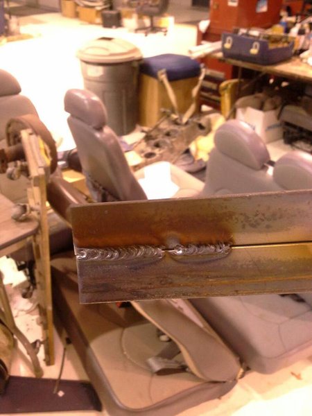

    Alright guys im having some trouble tig welding with my new Ranger 250 gxt. It stick welds normally, great actually. But whenever I hook up the tig torch its a different story. Trying to weld on some mild steel. Machine set to DC-, anywhere from 15-30cfh of 100% argon, 2% thoriated tungsten sharpened to a point, running about 100 amps, metal is cleaned up with a flapper disk so its good clean metal. Also using a foot pedal. Also I know how to tig weld. Been doing it in welding school for a while now.
    Now to the problem, the arc looks like a sparkler, not a focused arc, sparks flying, orange rust colored oxidation on one side of the weld. Welds get porosity in them etc etc. Something is not right. I checked for air leaks in the gas line and couldn't find any. I pressurized the line, turned the gas off, and it stayed at a constant unmoving pressure for 2 hours until I let the gas out. So the gas line is good and not pulling in air. uploadfromtaptalk1391921910130.jpg
    The only thing I can think of is that Airgas gave me the wrong shielding gas. Would that be causing this to happen? Any other ideas? Is their any way I can test what gas I have?

    Looks like it's not argon. I've seen similar welds with 75/25.

    Shielding gas.

    I have been having similar issues with my Lincoln 155 invertec. Cleaned the metal, sharpened to a point but it was struggling to focus the arc and it was burning the tungsten up as well. Straight into the cup. Sent it in for repairs and they said it worked fine. Did this on both the stick and tig setting.

    Is it set on DC+ or DC-?

    It's an inverter, not selectable. Always DC neg if memory serves. I haven used it in over a year as it pissed me off too much.
