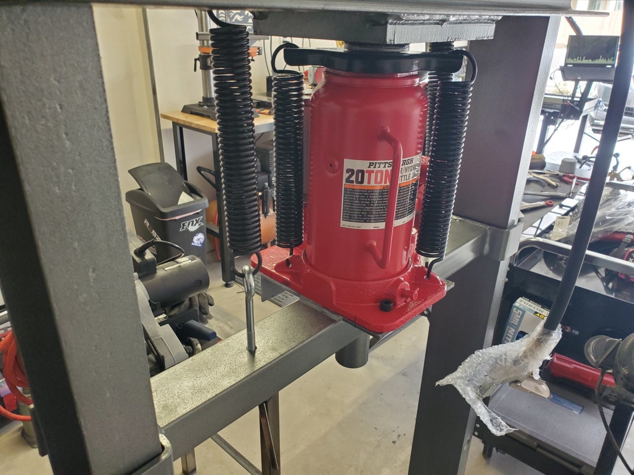

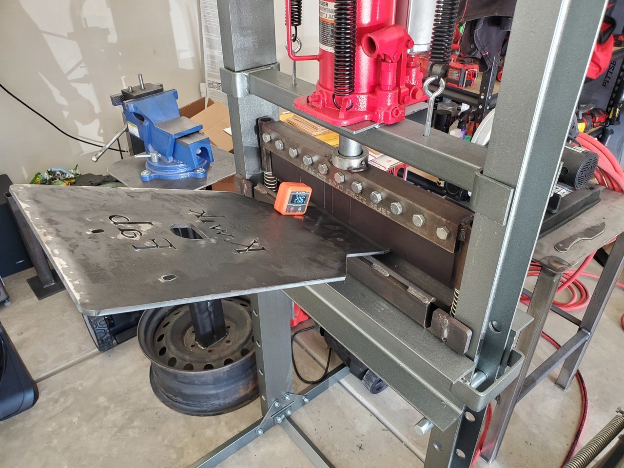

    Got mine used, otherwise I was going to buy the weld it yourself kit.
    It's a really small assembly in terms of parts welded, a weld it yourself bumper would take longer.
    I may not use it much, but when I do it's stupid useful and I love it.

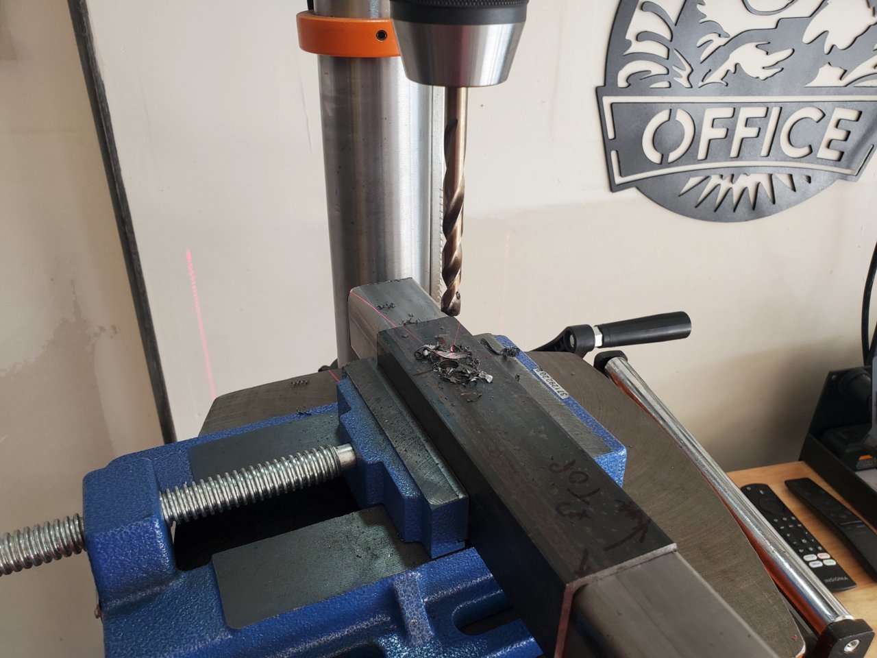

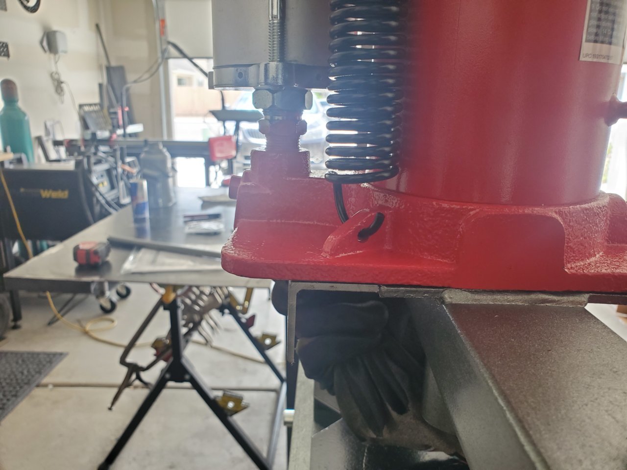

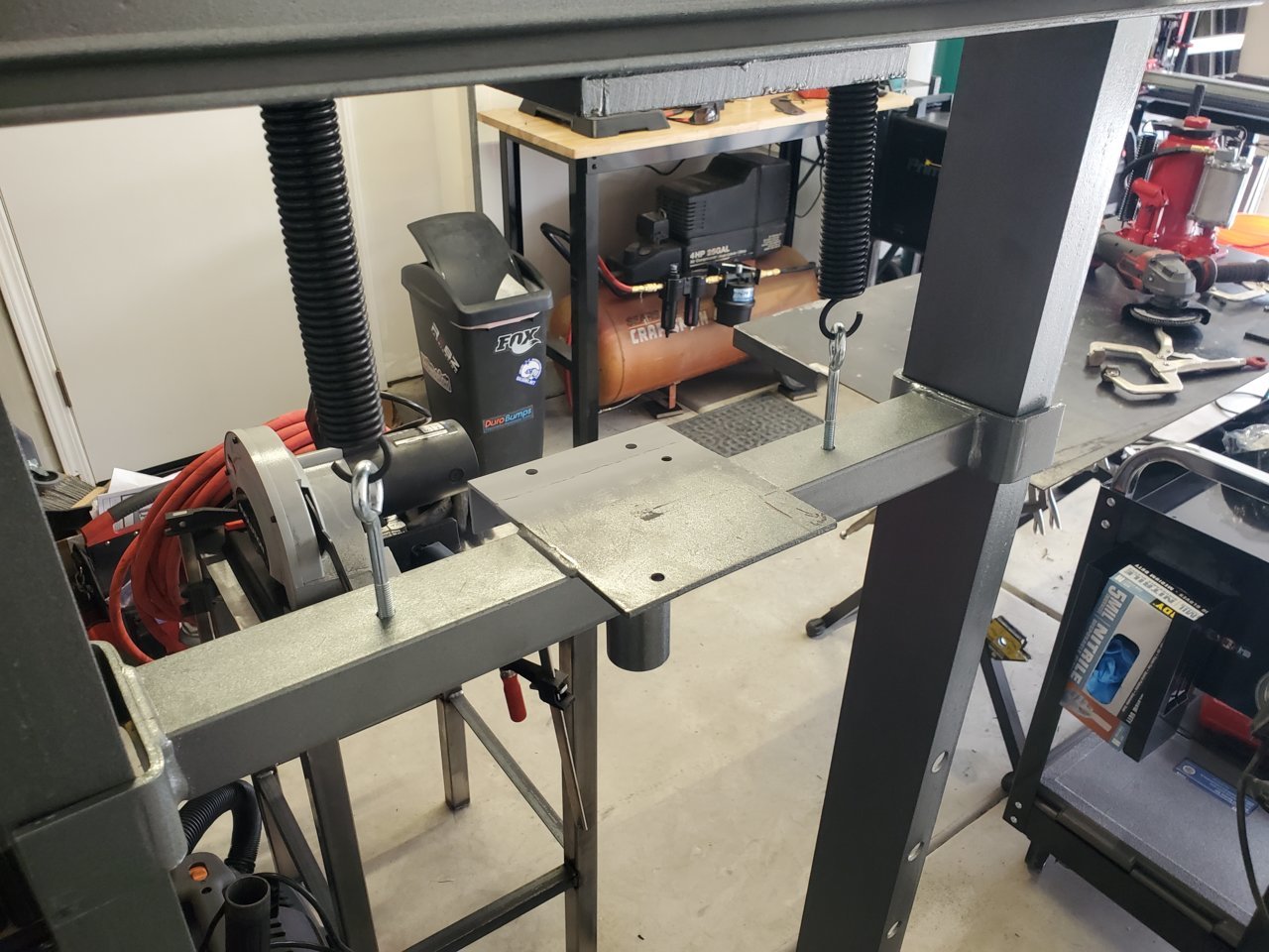

    Can't imagine bending on it by hand, go air over hydraulic. Just requires the simple mod of drilling a new hole, and widening the platform it sits on if you wish to do so.
    Whatever jack you use, if it has a hand switch I recommend dumping it for a foot switch.
    Makes handling heavier stuff in place much easier so your bends end up being square as you'll be able to use both hands instead of one.
