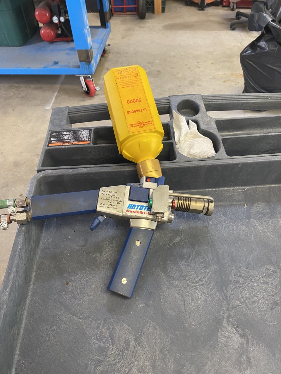

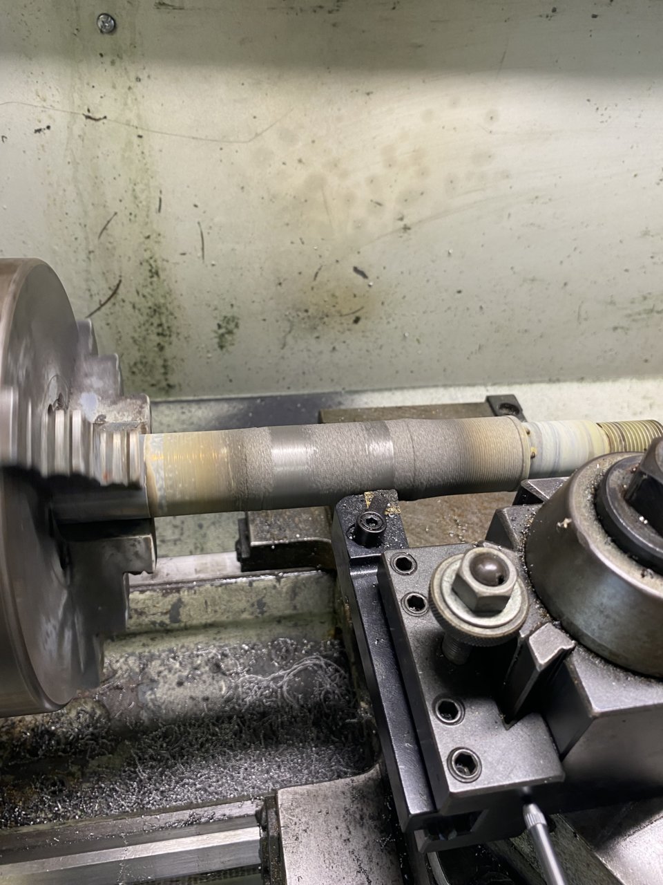

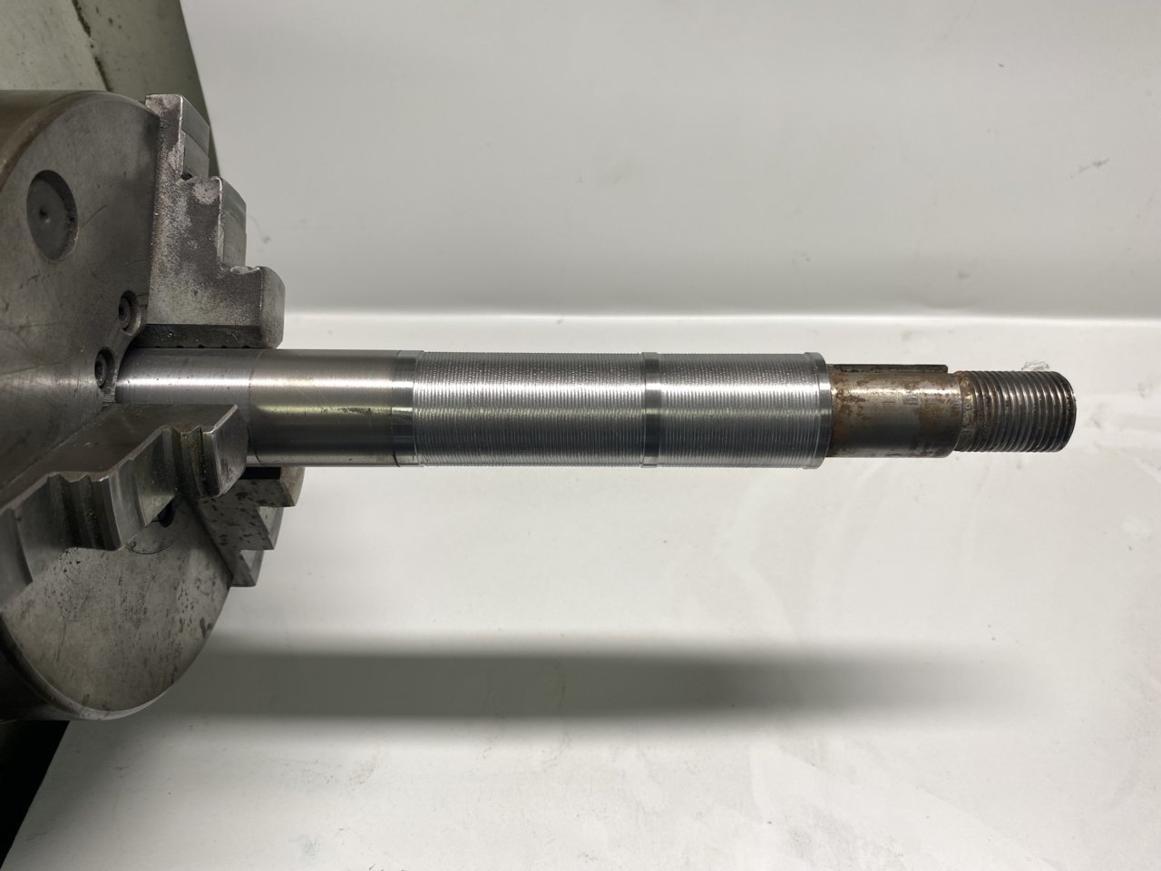

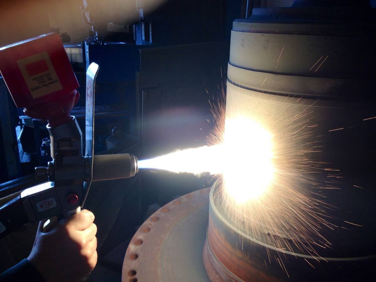

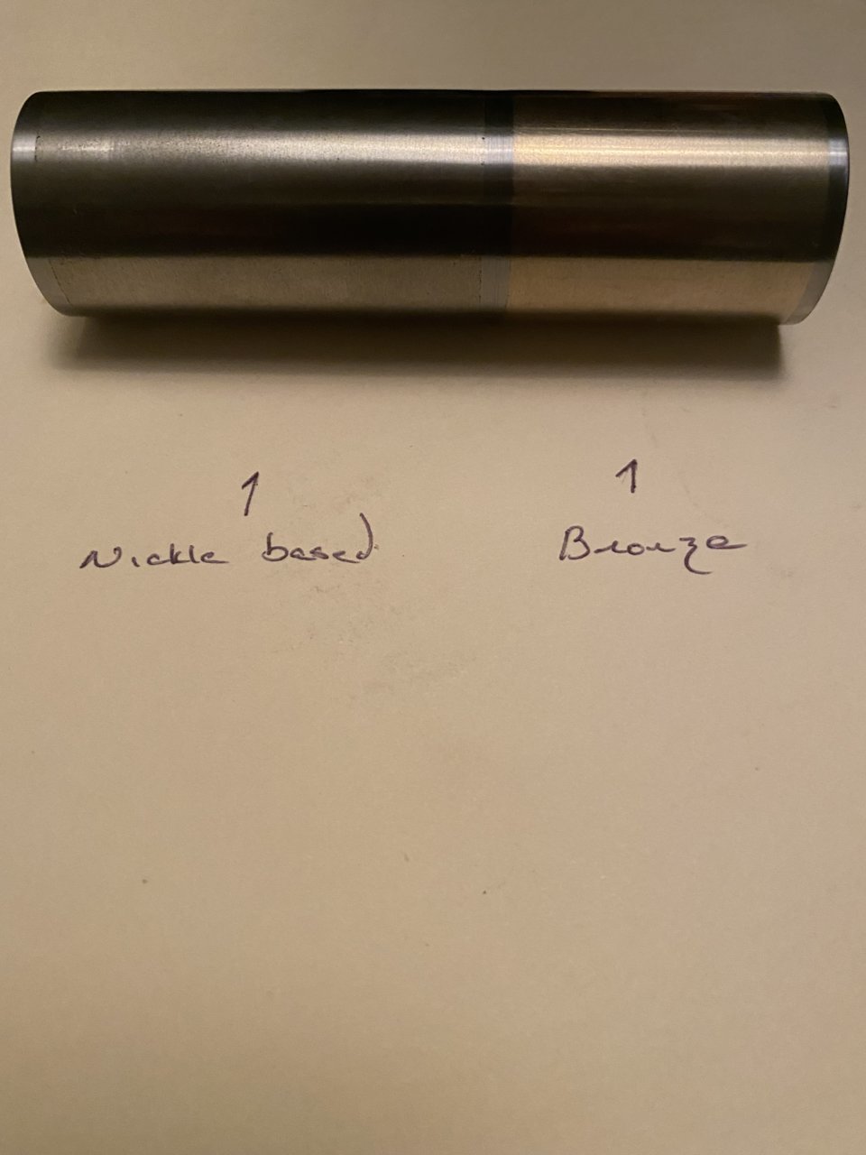

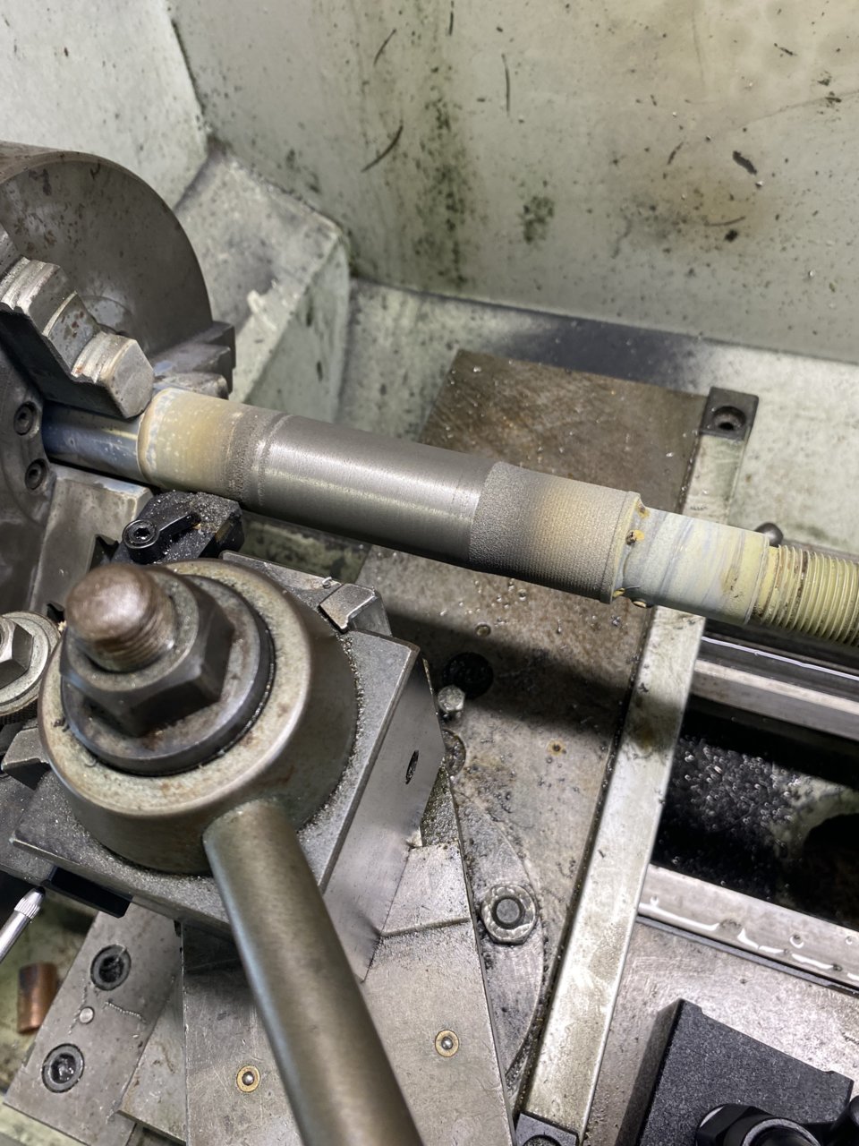

    I specialize in Thermal Spray and fuse welding.... generally for shaft repair; bearing fits, sealing areas.. can apply bronze, nickel, ceramics.I can apply materials so hard they must be wet ground finished. Send me your worn out junk... IMG_9677.jpg IMG_9665.jpg IMG_9676.jpg IMG_9681.jpg IMG_9680.jpg IMG_9704.jpg .

    Yeah, we ain't using Metco wire guns no more lol, Eutectic high pressure, exotic powders. I can maintain.0001 on bearing fits with mirror image. Not many are aware of it. It's much more popular overseas

    @Rachelsdaddy is this called metal spraying? We use to have seal areas done on Dunham-Bush refrigeration compressors when we would rebuild them. This would bring the dimensions back to factory specs & take care of any wear / scratches causing the shaft seal to leak. Unfortunately this didn't work on Mycom or Howden compressors because the pressure leaked through the metal spray causing a refrigerant (freon, ammonia, etc) leak. We had to chrome (this was industrial chrome) those seal areas but took longer because the chrome would only grow .001" per hour and had to be ground / polished to size.

    Precisely, normally for vacuum applications I use either Bronze or ceramic, those pumps are fussy. Plating is ideal. I've also repaired the seal areas with hardened ground polished sleeves machined for .0002 interference, warmed up and set w/ loctite 609. Customers prefer this because they are replaceable, although I haven't had to yet

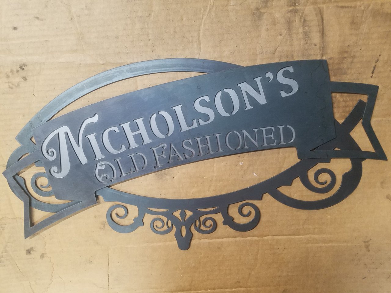

    Despite the heat and humidity, I cut a sign this evening. It's for the daughter of a friend who has a drink stand at local craft fairs.
    She drew it up in some paint program and it wouldn't convert to anything I could use so I had to draw it from scratch. Good thing I wasn't trying to do it for money. Her dad is a really good guitar player and teacher and is trading me some lessons in exchange.
    There will be a 1" gap between the layers. She is going to paint gold and green, with the background for the lettering in black.
