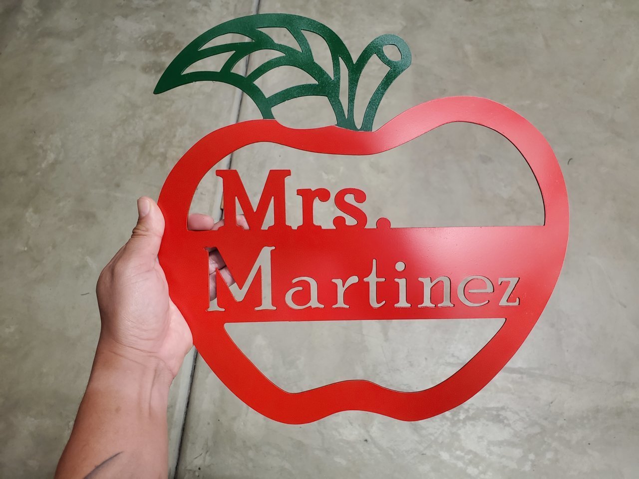

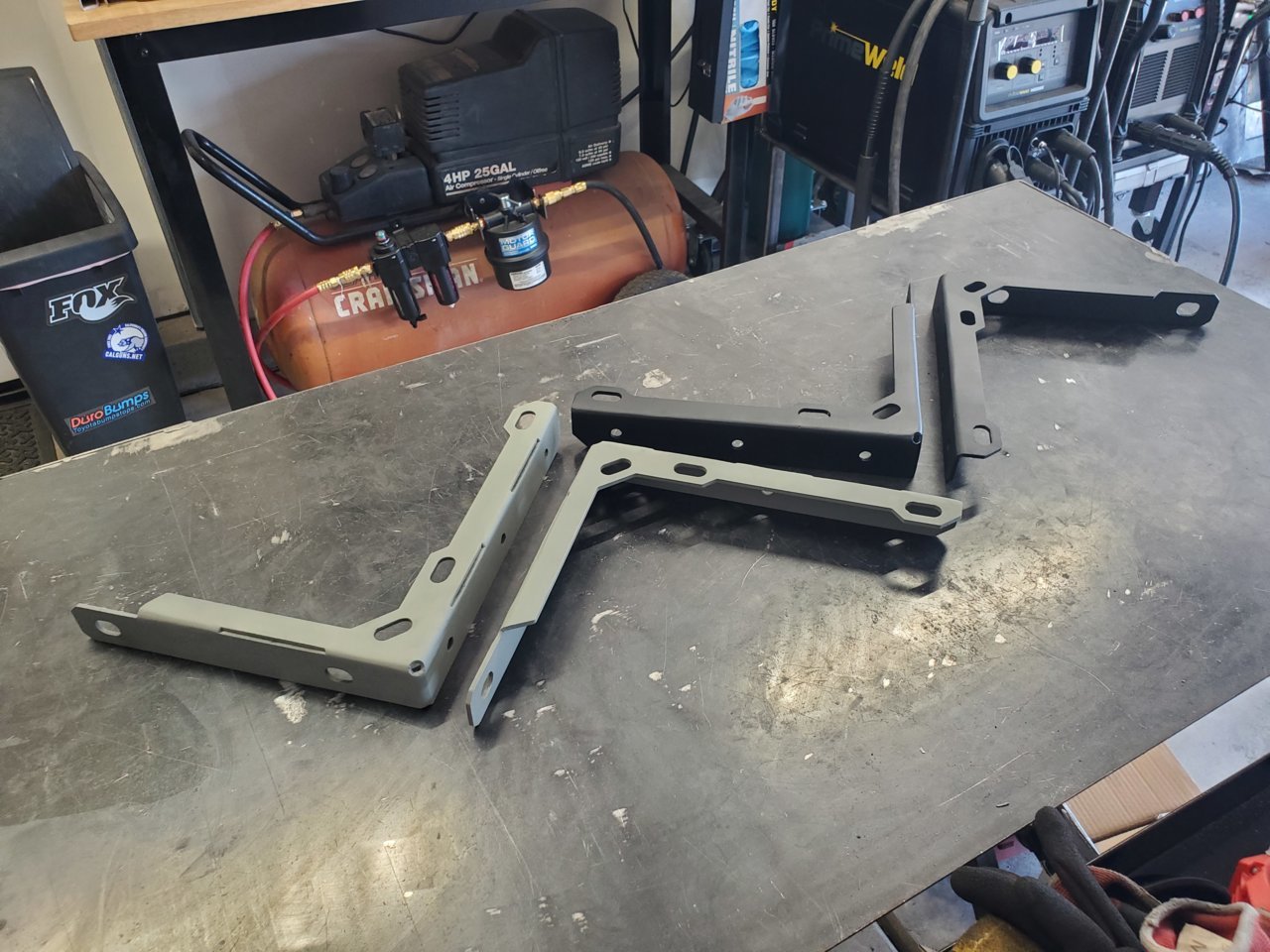

    Painted this up; loving the green I picked up today from Home Depot

    That is pretty!

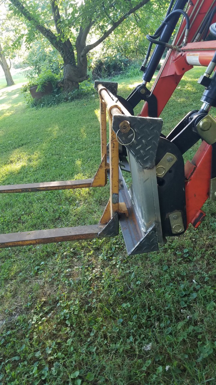

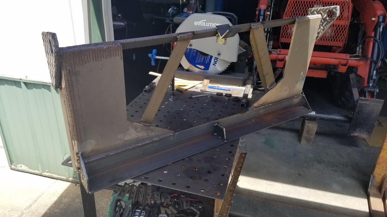

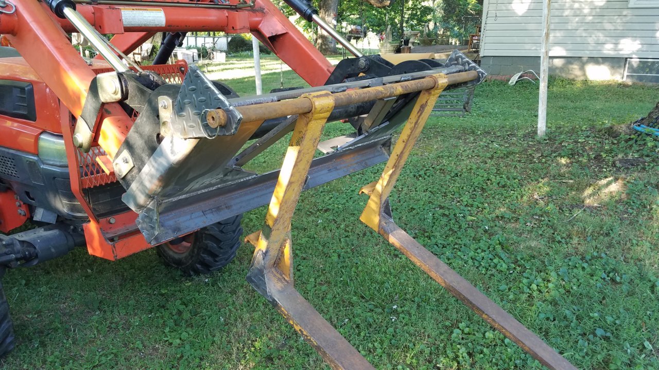

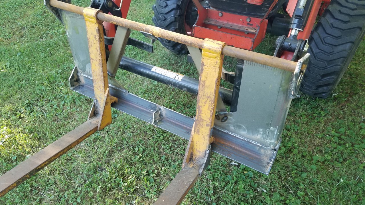

    I think I posted here when I made the setup last year. Basically, modified a quick attach system so my forks are strong and easy to reposition. Been working real well. Go to any tractor site and you'll see guys say "I don't know how I lived without these pallet forks". They do come in handy.
    Just tilt forward to re-position. Bottom helps keep the weight off the round mounting bar at the top. I've seen guys bend those so I tried to isolate the round slide bar as best I could.

    I like it, especially the way it folds up out of the way when it isn't needed. The round top bar reminds me of the Hyster and Clark forklifts I used in the military. I'll suggest you might consider welding in a piece of square bar to the bottom along the edge, where I marked it green, with an open space toward the middle where I marked it with red. The size of the bar would depend on the amount of space behind the forks, maybe a 3/4" or 1" bar.:notsure: That would hold the forks from swinging forward until you push them all the way to the middle, like most commercial forks. It would also add some extra strength to the bottom plate. But most importantly, it would give you more control over where the forks are pointing and let your forks spear down into something at a downward angle.

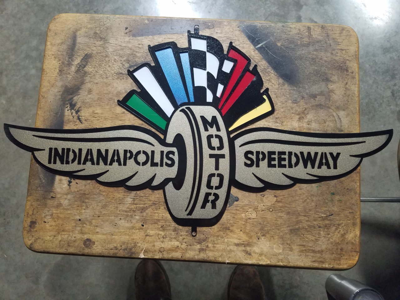

    Being from Indiana, making this sign was mandatory. It's not glued together yet. I'm going to recoat the black. I also have a 2nd copy I am going to go 3D and maybe some LEDs.
    22" x 12", 18 gauge, 30 amps, 65psi, 130 ipm cut speed, .051 cut height, 0.7 sec pierce delay, 40 amp consumables.
    Here is the official image. I left off a little of the flag detail (thin slivers of color), but it's real close. Oops, looks like I forgot the "TM" emblem. Guess that means "Team Members" as a shout out to employees there at the speedway...:D
