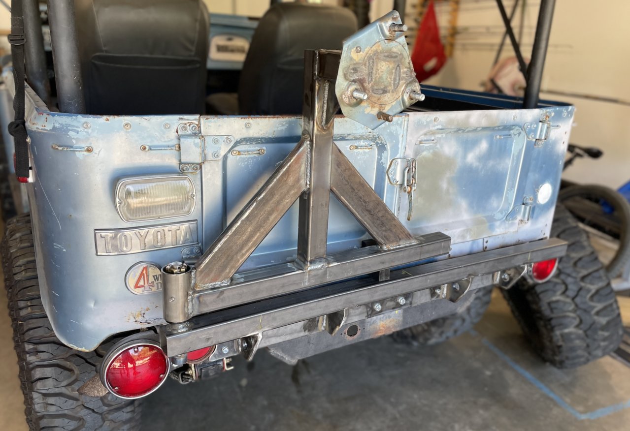

    Nice work!
    Next time don't hesitate asking one of us for part cut outs if you need them so you don't have to shape parts with an angle grinder!

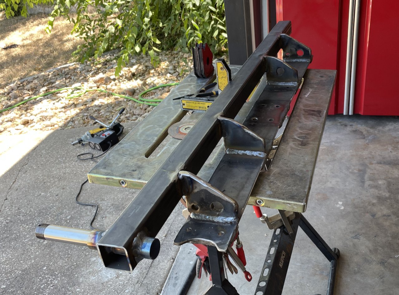

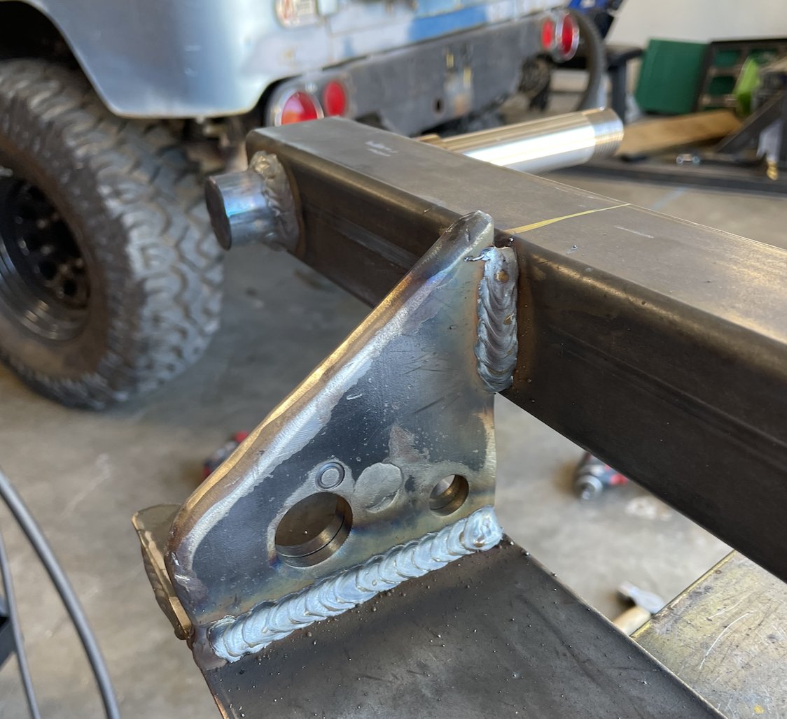

    I appreciate the offer - Everything started as 2" square tube and 4" flat bar. Between cutting the gussets and sandwiching them together for addtl strength I definitely paid my dues with the cutting and grinding. I know you all know that welding is 95% prep with 5% welding. Lucky for me I find the process therapeutic. However, a mailbox is up next so I will be hitting you all up for some numbers to be cut once I get them drawn up.

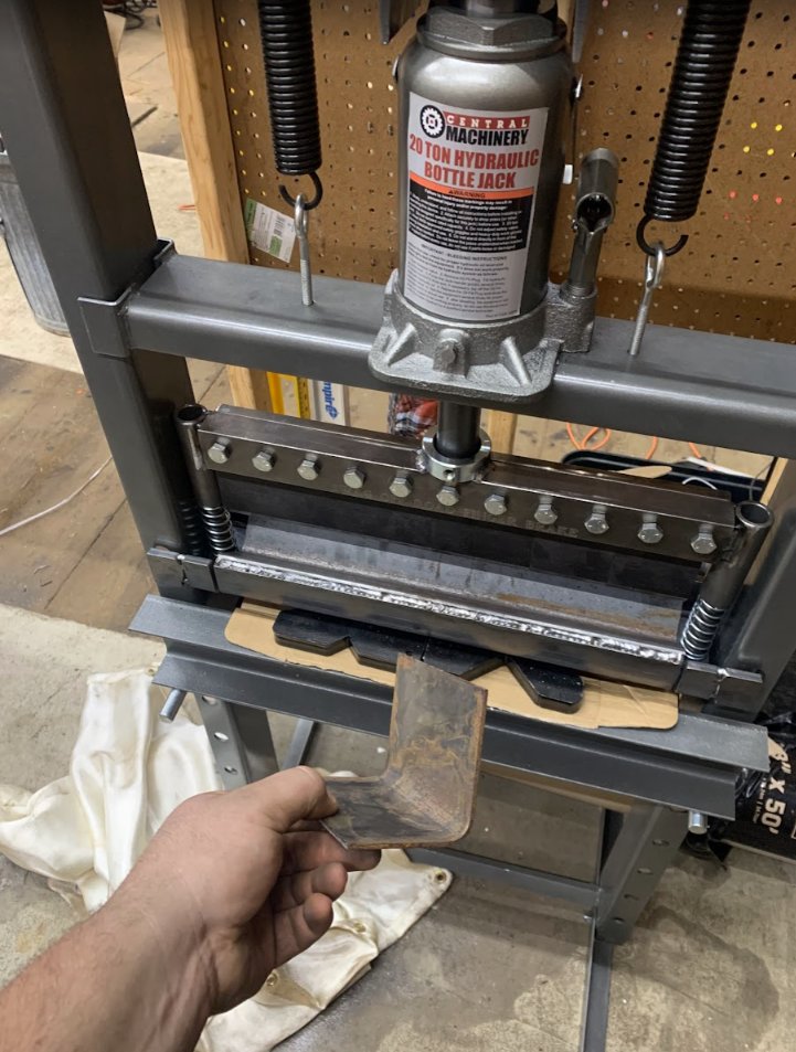

    Got it all burned together. You guys arent kidding about needing air over hydro. Otherwise it is great.

    Never used the manual bottle jack, but I'd recommend the air over hydraulic simply from a safety perspective

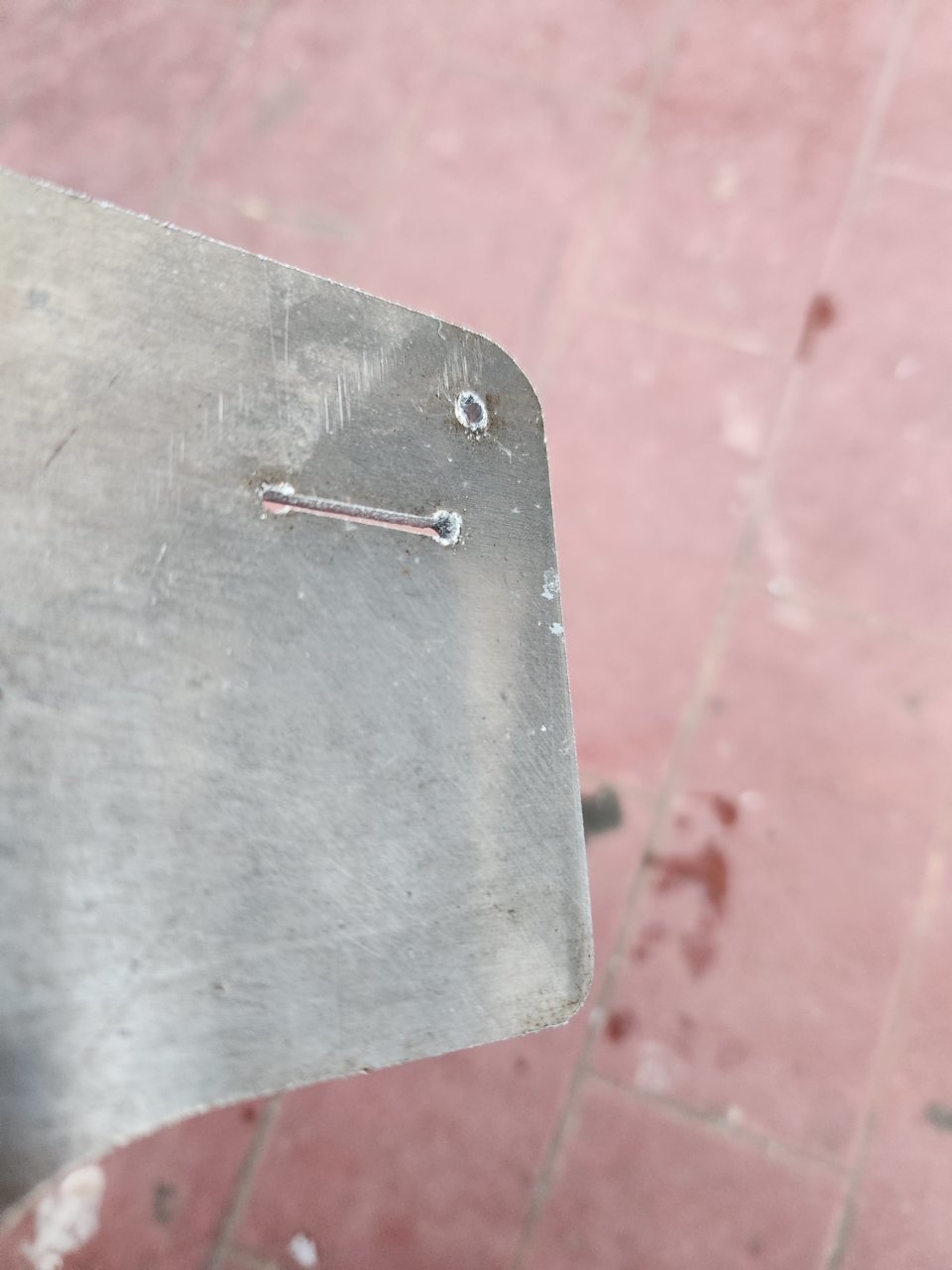

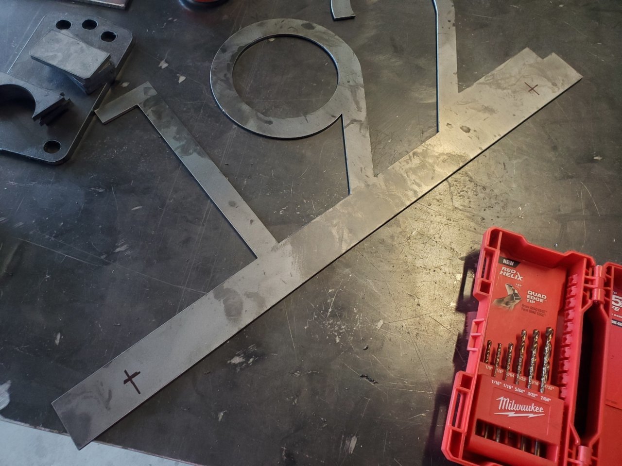

    So, pictures don't do it justice but I've only ever used 1.1mm tips on my PTM-60 torch the entire time I've owned it.
    Older picture showing just how much 1.1mm cuts into your sheet -
    Yesterday I got a few orders, one of which I could cut today. Being 16 gauge I normally run a 0.6 second pierce delay with my 1.1mm tip.
    Decided to use one of my 0.8mm tips I've had in my drawer for months now and learned that a longer pierce delay is required. I opted for 0.9 seconds even though 0.8 would've probably done the job. Kept the same cut speed of 100IPM and 30 amps (max for this tip size) -
    The biggest noticeable difference is the lack of any "burn-ins" caused by a lead-in. I made no changes to the offset as...you can see above why. Several of the cuts between the letters were extremely small so I left them at default values.
    Came out way better than expected -
    My only real issue is for some reason my cutting was much slower than the 100IPM I set it for; I'm thinking between yesterday's update on my PC when I drew it and created the profile to today's post processing on the laptop (without the update) the 100IPM didn't translate to my NC file. I noticed it when I started cutting but decided to leave it cause I don't have much spare 16 gauge left.

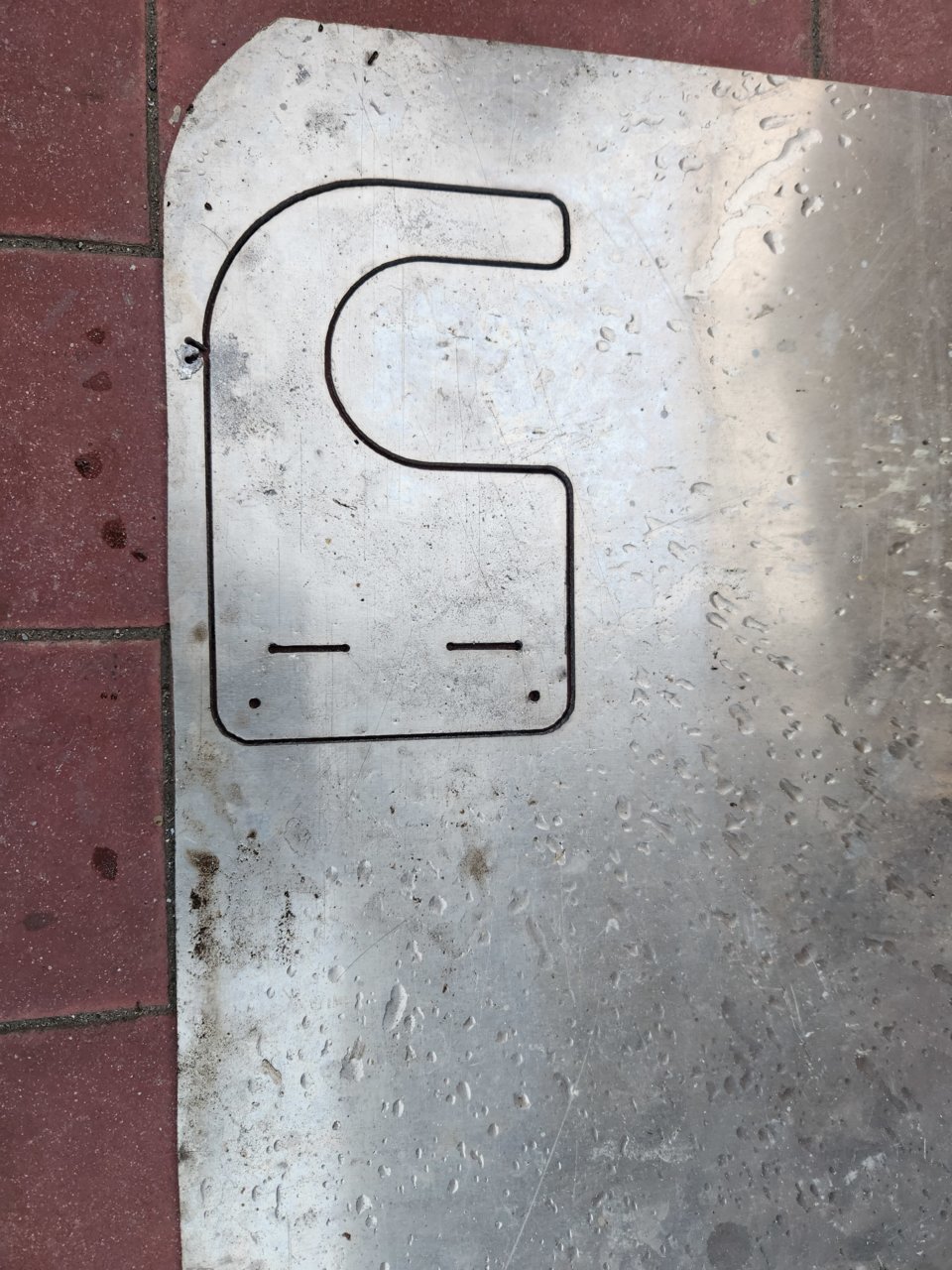

    Finally got to test out the xfire on mach3. Game changing and I can't wait to dig into fusion 360. No metal laying around so I cut out on 1/8 aluminum
    File is a grinder holder I downloaded from fire share

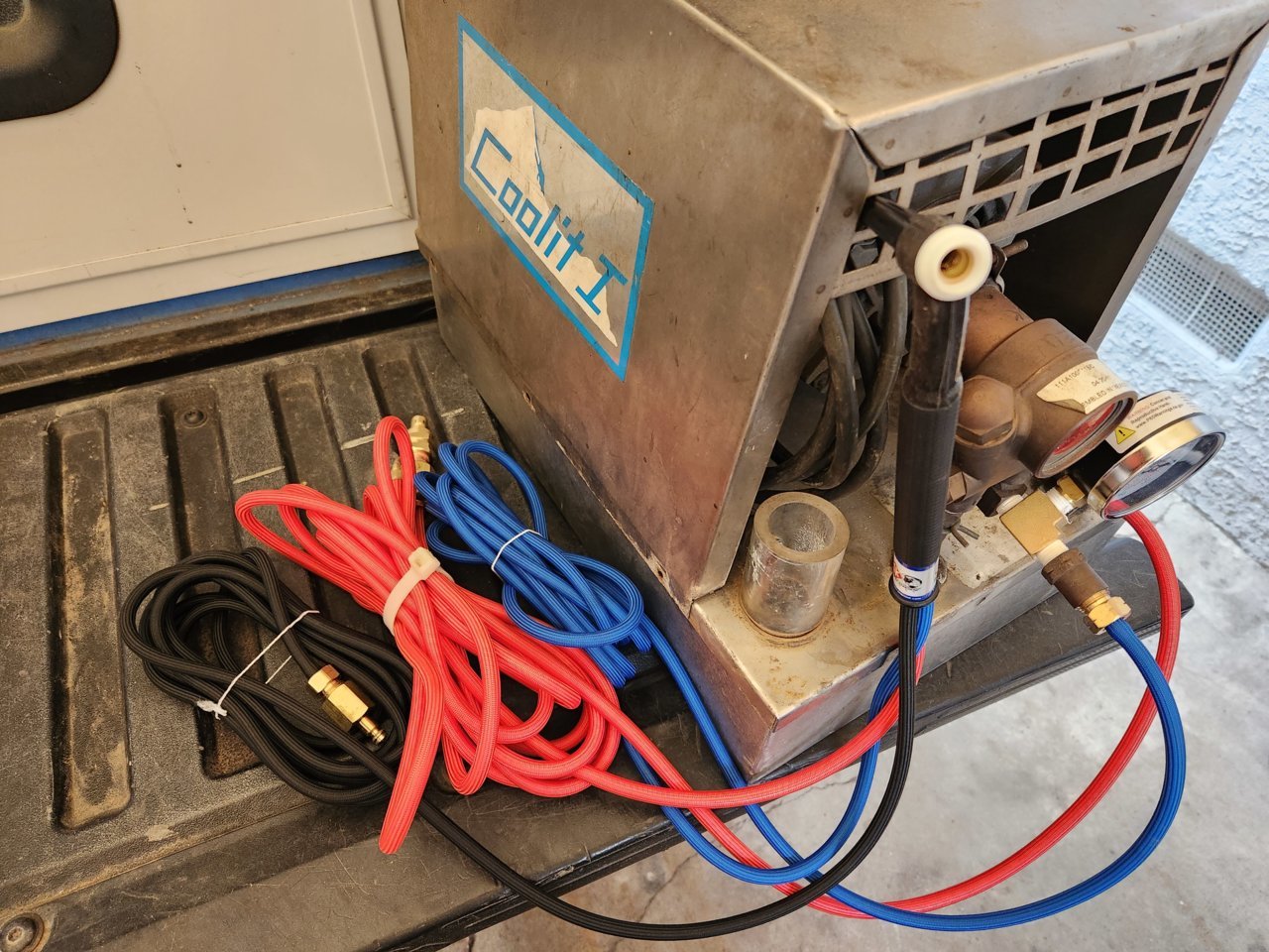

    Also my 17 torch from ahp finally dry rotted. Upgraded to a 20 and picked up a water cooler and added the pressure gauge. Hope it's a major improvement.

    Good shit; what were your settings on aluminum?
    Someone's needing stuff cut out on aluminum but I'm only on compressed air.
  17. Aug 9, 2023 at 4:52 PM
    ejwan
    ejwan Well-Known Member
    Sep 25, 2016
    #198245
    249
    Compress air at 30 amps. Not sure on ipm since I just used whatever the setting is in the file. I'm using a hypertherm 45xp.
    Bivouac likes this.
  18. Aug 9, 2023 at 4:56 PM
    Kwikvette
    Feb 27, 2019
    #284735
    81,769
    Fresno County
    4 run, 2 don't
    No way, the TAP file worked out for ya huh?
    Looks good.
  19. Aug 9, 2023 at 7:12 PM
    ejwan
    Sep 25, 2016
    #198245
    249
    Yep. I was pretty excited nailing it without trying. Even guess on the amps too.
    Kwikvette[QUOTED] likes this.
  20. Aug 9, 2023 at 7:26 PM
    Kwikvette
    Feb 27, 2019
    #284735
    81,769
    Fresno County
    4 run, 2 don't
    Right
    Cause aluminum has a hard oxide layer that takes a good pierce delay to get through, but too slow a speed can cause hard dross on the backside
    You'll see its a back and forth when it comes to dialing it in
    A successful cut always feels good though
