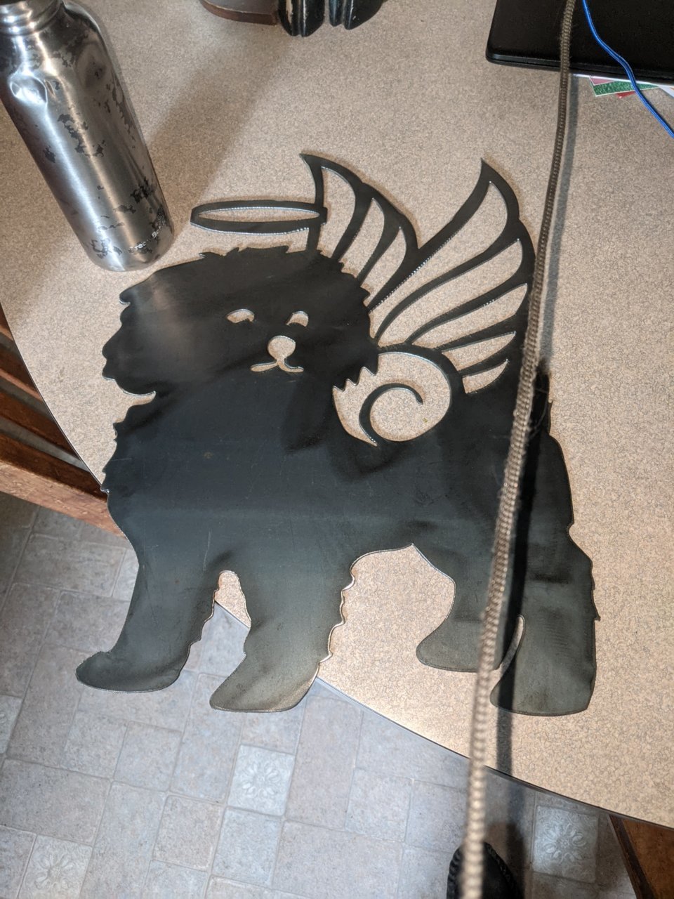

  10. Aug 15, 2023 at 7:47 AM
    koditten
    koditten Well-Known Member
    Sep 8, 2013
    #112077
    19,956
    Kirk
    Central Michigan
    04 trd x-cab 4 x 4 3.4l
    Reserected from the dead.
    Got shamed into breaking out the plasma table by a member here. Been a full year since I cut anything.
    Sister in law wanted a yard ornament in memory of her Bichon Friese doggo.
    Still need to attach it to some rebar so it can be stabbed into the lawn.
    She said she wanted to paint it.
