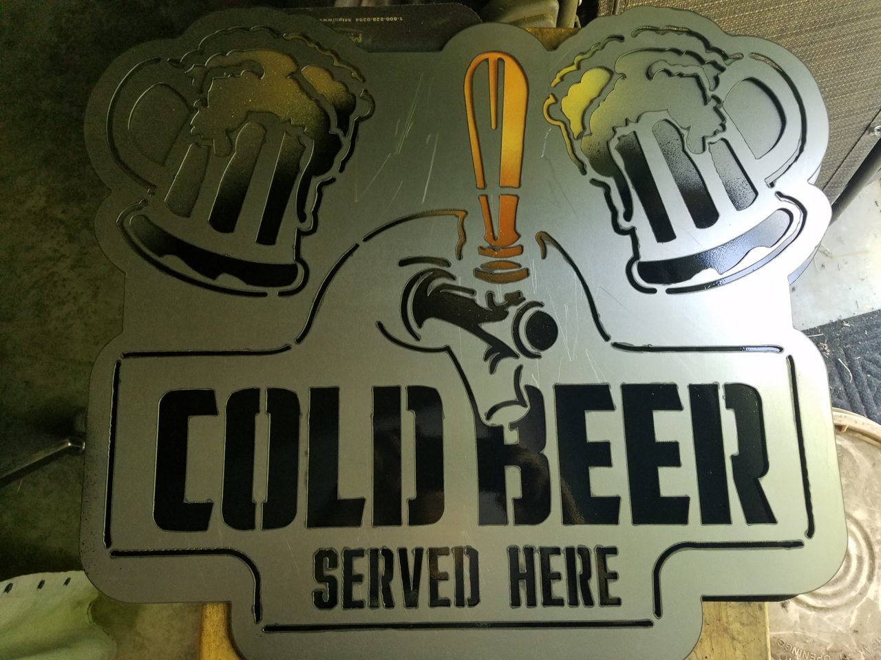

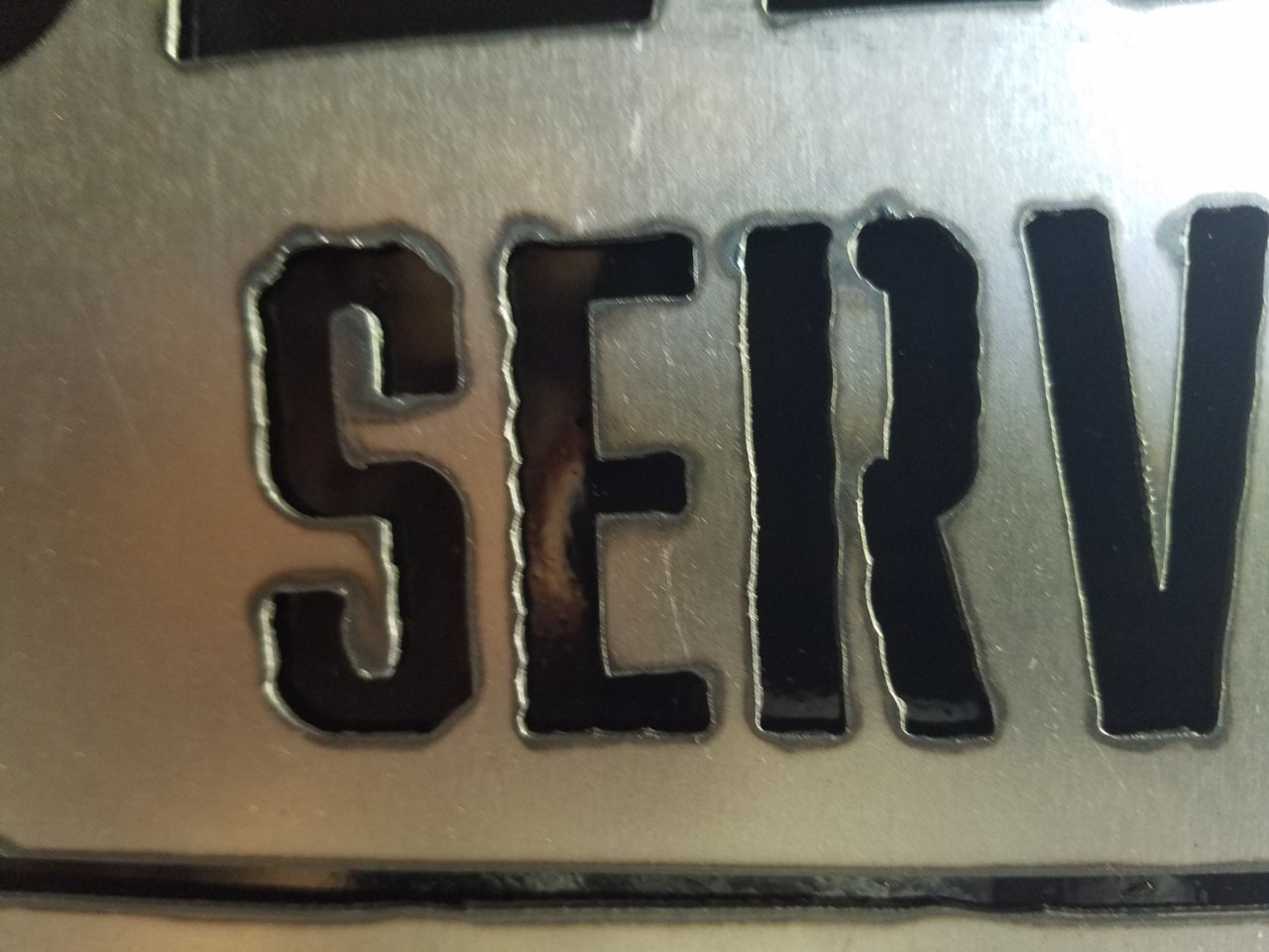

    True. I've been cutting with mine for almost 10 months now and never had the wavy line syndrome... until yesterday. I think just me reading @Kwikvette posts gave my cutter the idea to act up!
    Ignore the paint job, it's just getting started.
    This sign was originally made by somebody else. I made a lot of changes to the top half but left the text alone. I may replace all the text (all looks like $hit) and try again, but this one is still usable, just not perfect. As sloppy as it looks, I think maybe the original creator may have not created a text box but used converted image text.
    Once it's painted, the average person won't notice it from 5' away.

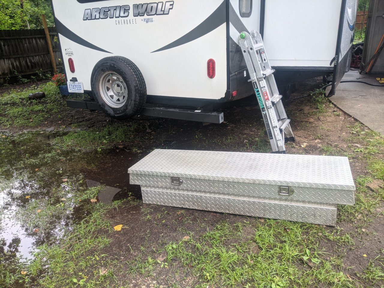

    Need to mount this to my RV bumper. The tire/bracket is going away obviously.

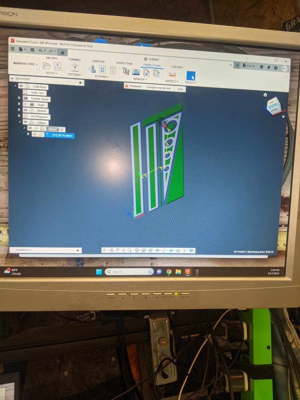

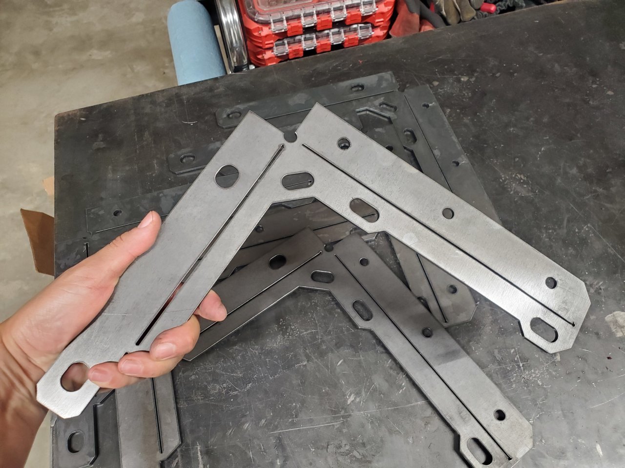

    Designed a bracket out of 16g sheet metal. Used F360 to create the sketch then manufacture the G code PXL_20230817_170319653.jpg

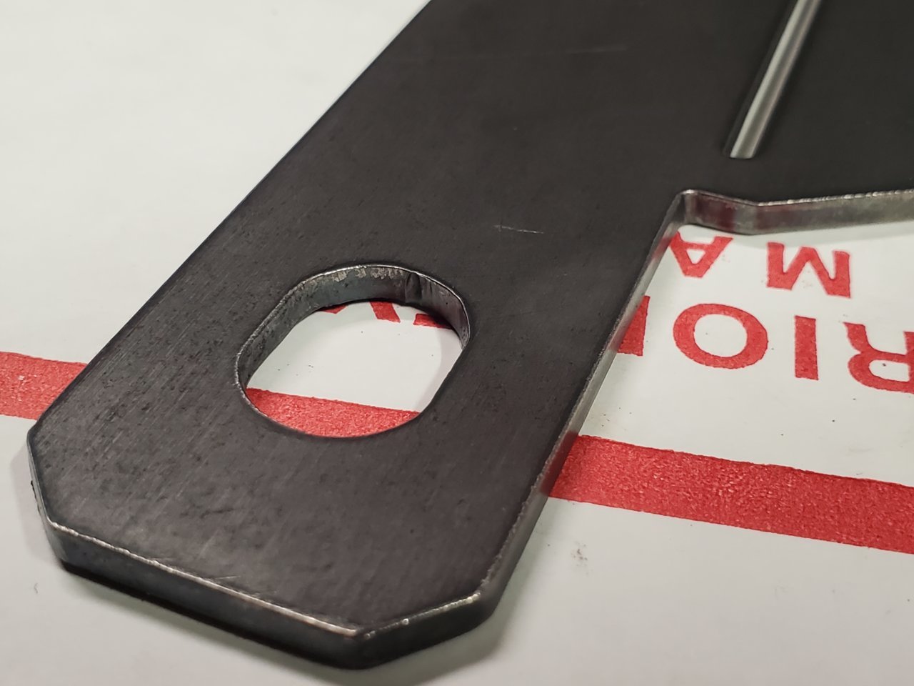

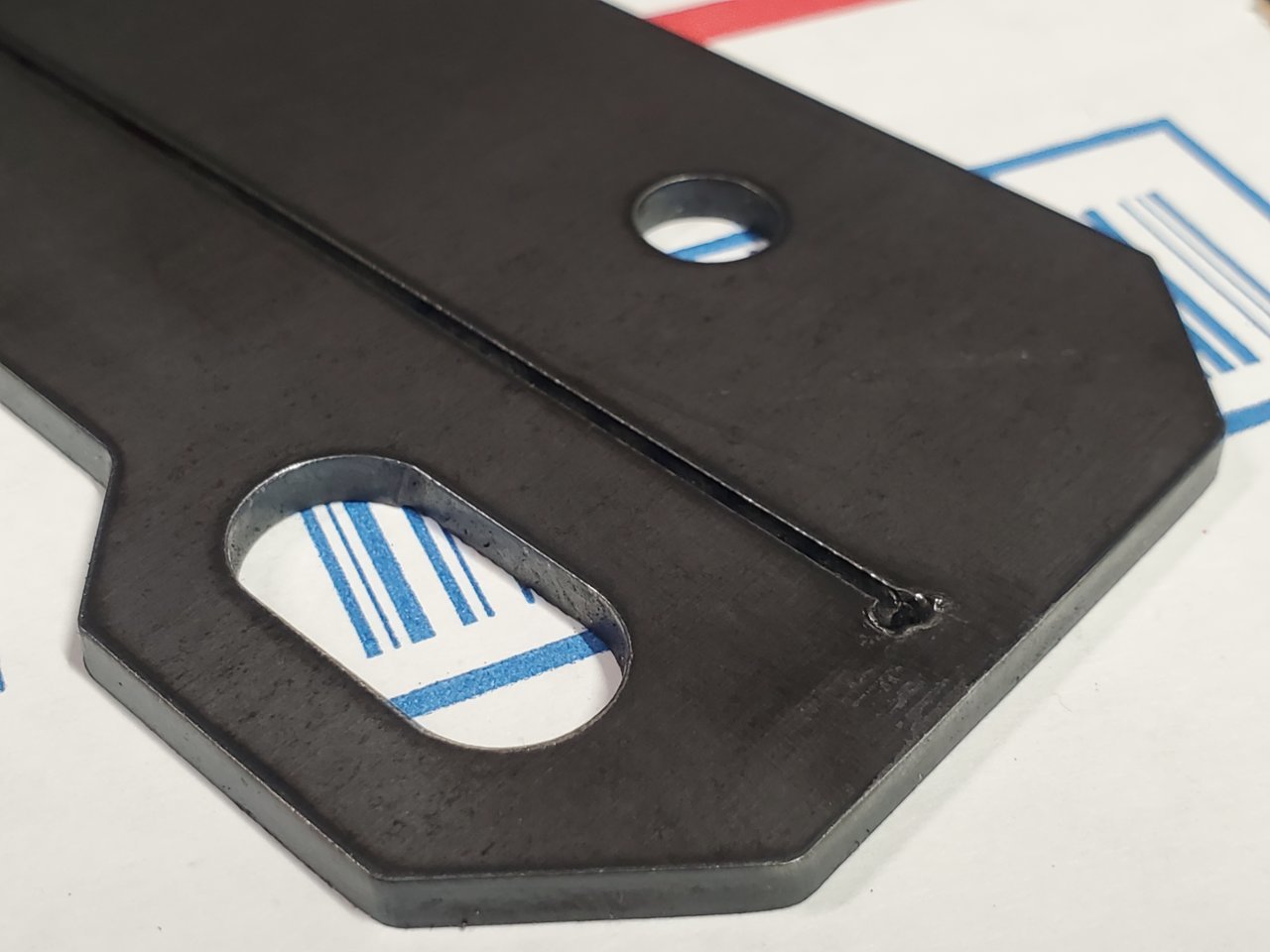

    Cut out bracket parts for 4 brackets.
    The holes are just to remove weight.
