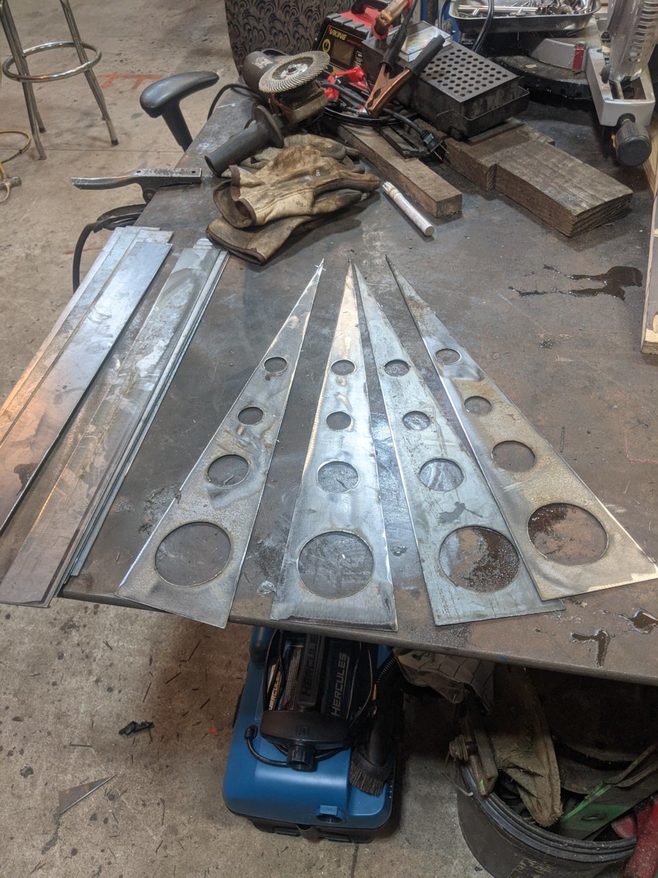

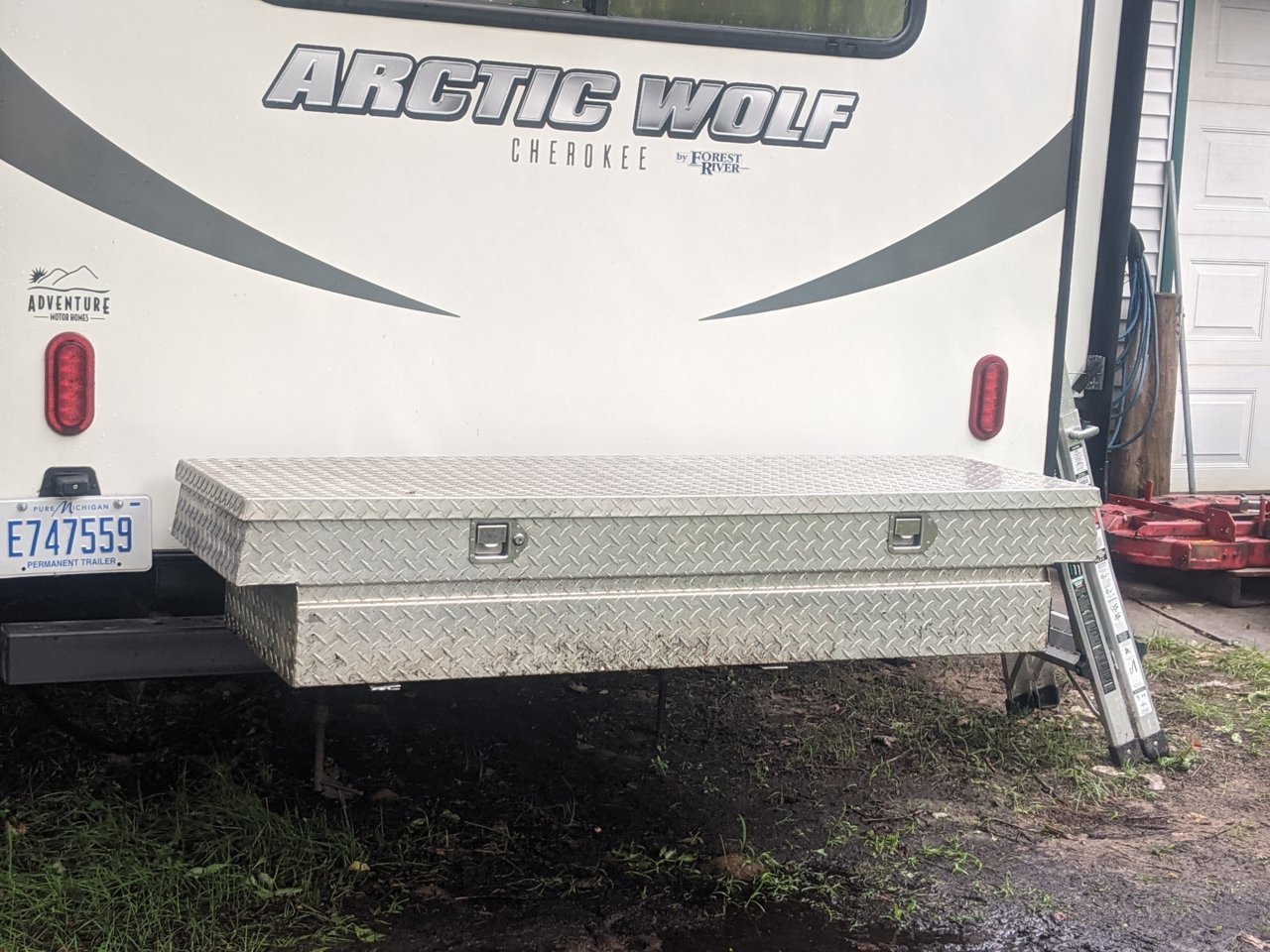

    Parts all cut, just doing some quick clean up with the flap disk.

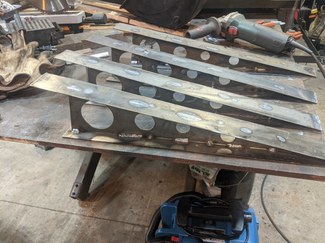

    Tacked up then welded up.

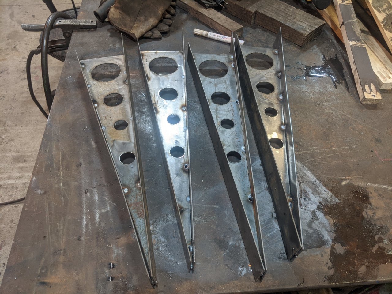

    Test fitting. Looks like a win.
    Going to have to wait a couple days before I weld on the brackets. I'm not fond of laying in a mud puddle. The electrical PXL_20230817_181527882.jpg shocks are kinda painful.

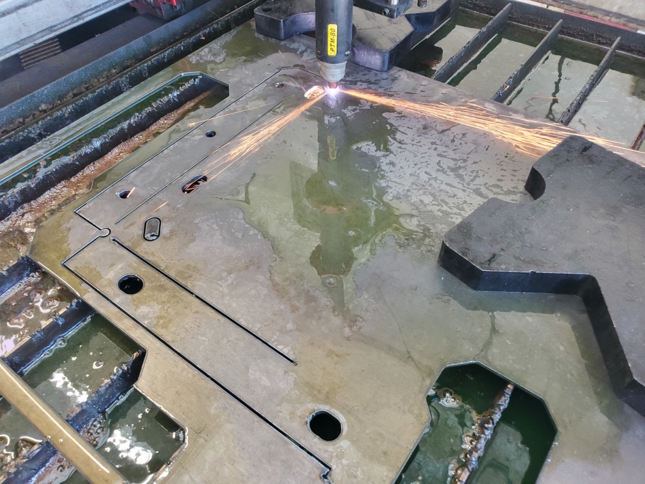

    I had zero issue with jagged cuts. In fact I'm using a pretty badly blown out tip.

    Also cutting now and none to report
    I put small wedges at the casters to prevent too much movement

    Clamped a couple brackets into the bumper to get an idea for spacing.
    I'm pretty happy with how it turned out.

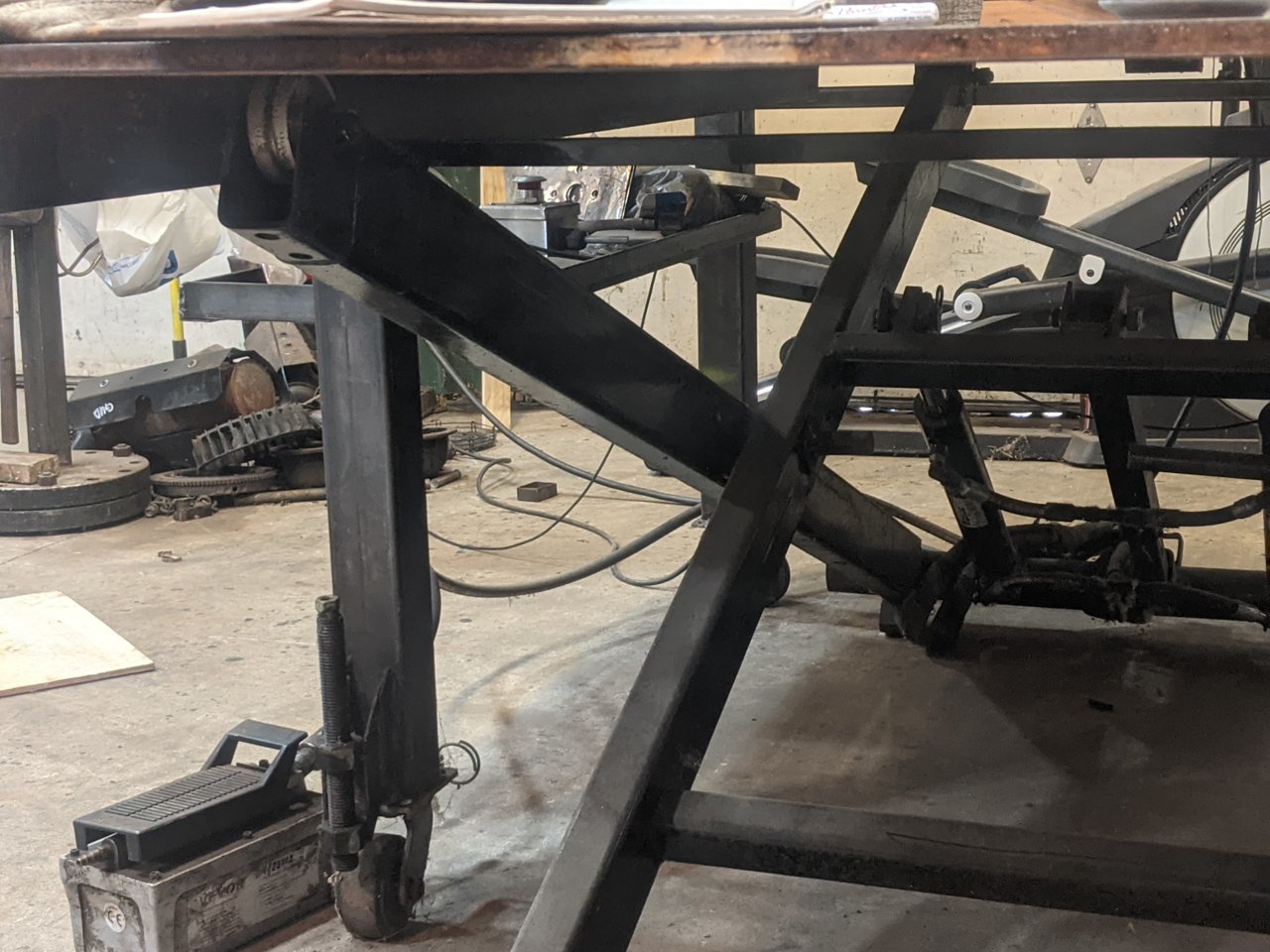

    My fabrication/ lift table fits under my plasma table. I hydraulically lift the fab table into the bottom of the CNC table. I have a pretty good handle on keeping unwanted movement in check.

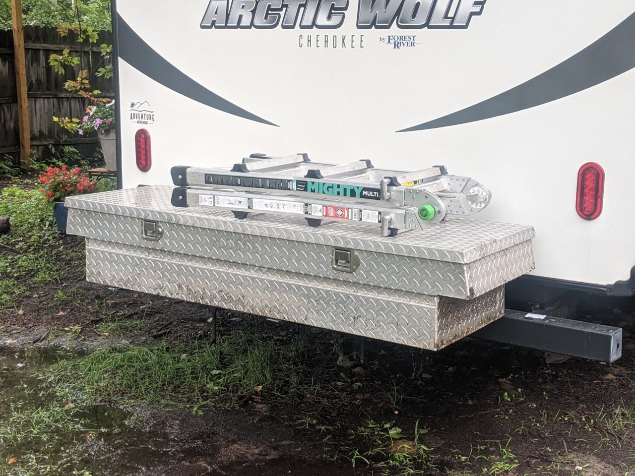

    A couple of rear window decals...
    You should build another bracket that will hold your spare up here.
    Drainbung and Kwikvette like this.
  11. Aug 17, 2023 at 1:13 PM
    Kwikvette
    Feb 27, 2019
    #284735
    81,613
    Fresno County
    4 run, 2 don't
    He can cut out a plate for mounting the wheel; weld the lugs on the backside of the plate.
    Two square tubes welded to the rear bumper there, one straight up and one as a support at an angle.
    Great idea
  12. Aug 17, 2023 at 1:26 PM
    KRAMERICA
    KRAMERICA Old Man Mike
    Mar 22, 2015
    #151504
    3,883
    Middle Tenn
    '18 F250 Super Duty
    He can probably use the bracket that was on the bumper, just weld on the square tube and support pieces to tie it all together.
