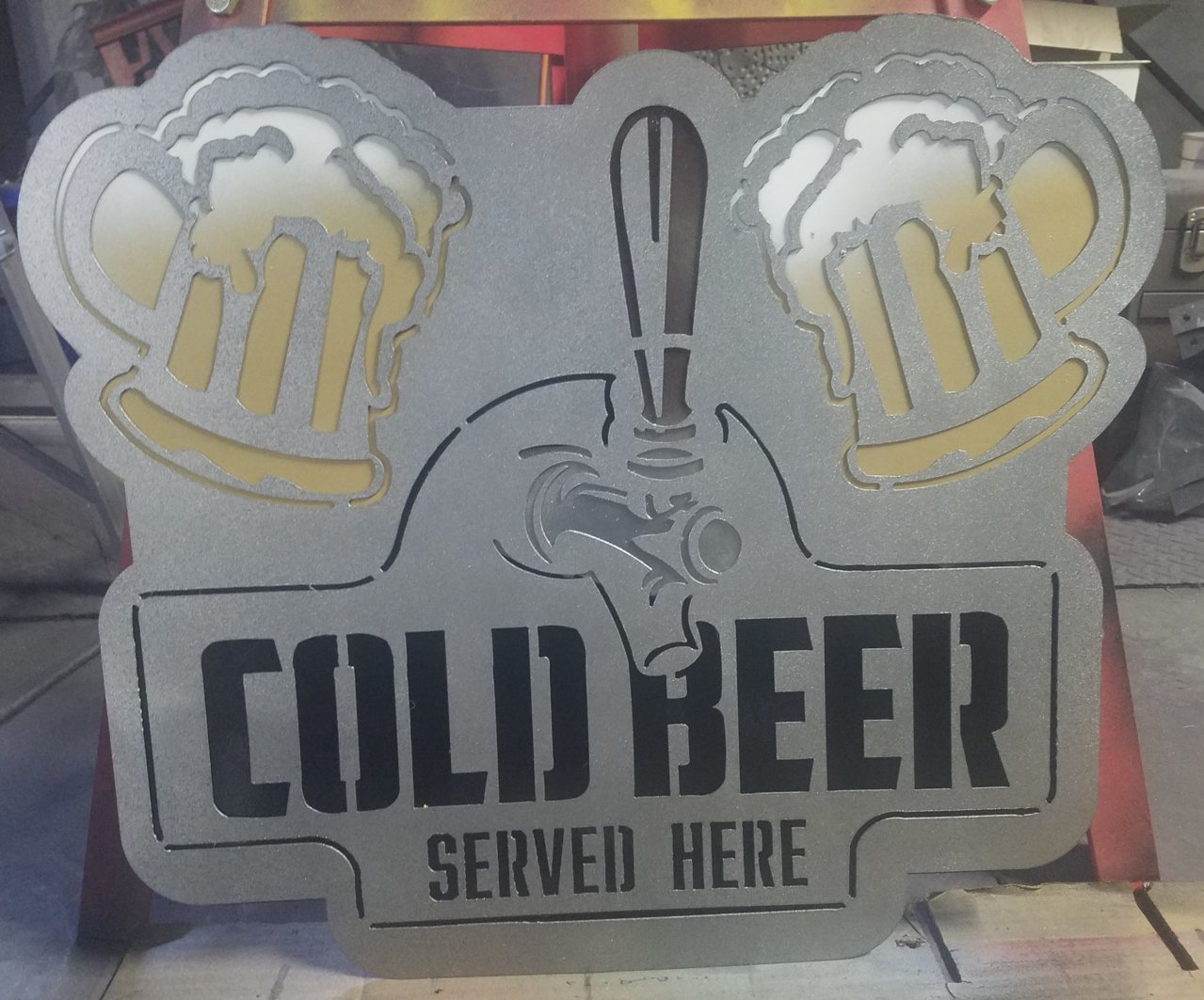

    Just before I cut that sign, I accidently opened Firecontrol with an internet connection which is something most regulars on LS forum warn against. I hope that isn't the root cause. It flashed that I was "up to date", but no further explanation. Same FC revision still showing.
    All I did was some straight cuts this evening and had no issues. Hoping it was just the beer sign.

    Looks okay after paint applied. I'm gonna repaint the tapper handle before gluing it together. I was trying to go for a wood grain affect, but failed.

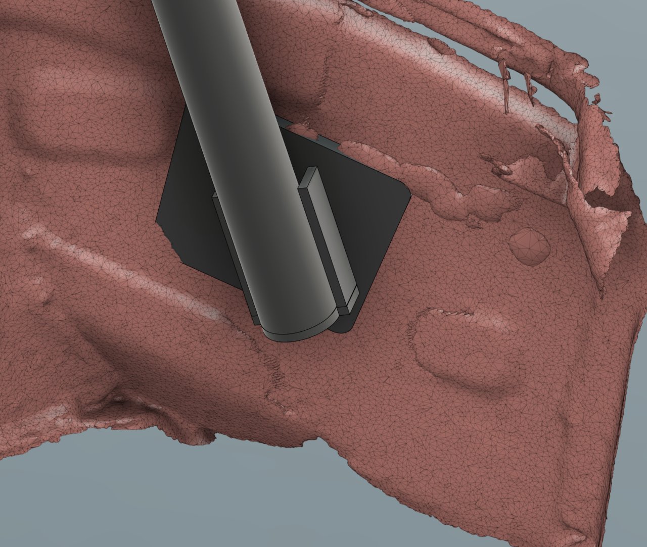

    I'm looking for some ideas on using fasteners to attach the DOM to a plate on the lower right side. I was originally going to just weld it all but I like the idea of making it removeable. Drilling holes and trying to get a nut on the backside would work but I'm hoping for a better. Anyone have a good idea they can share? I'm happy to share these CAD files (or DNG) if anyone wants them.

    A lot of companies I've seen adding a secondary shock up front don't go as far down as yours shows; less material, lower cost, and just as strong while still keeping it all in line.
    Just from what I've seen, no actual experience with it.

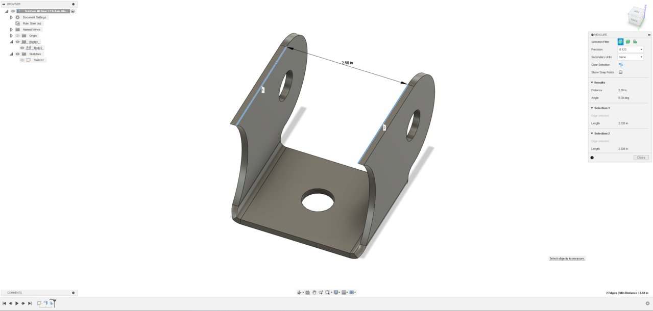

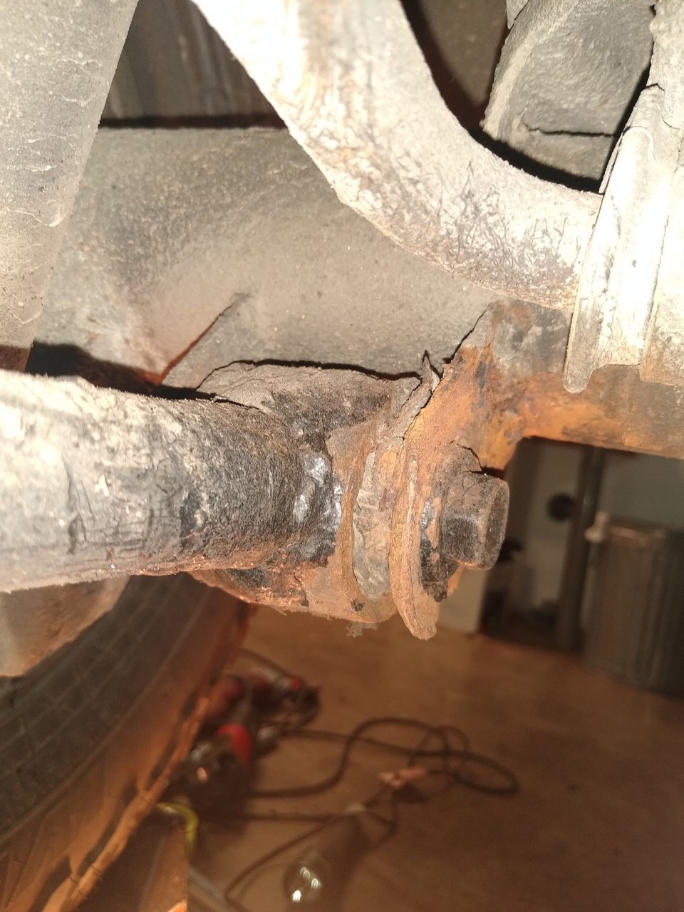

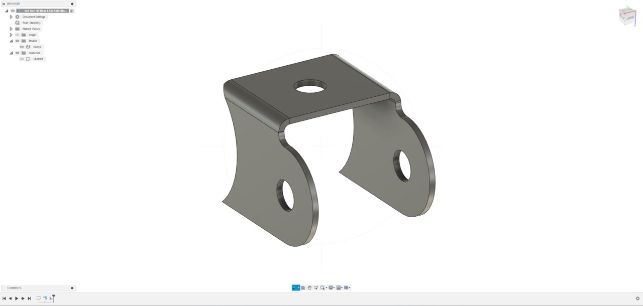

    New 3G4R rear lower control arm brackets for a 4R member; his are rusted to shit.

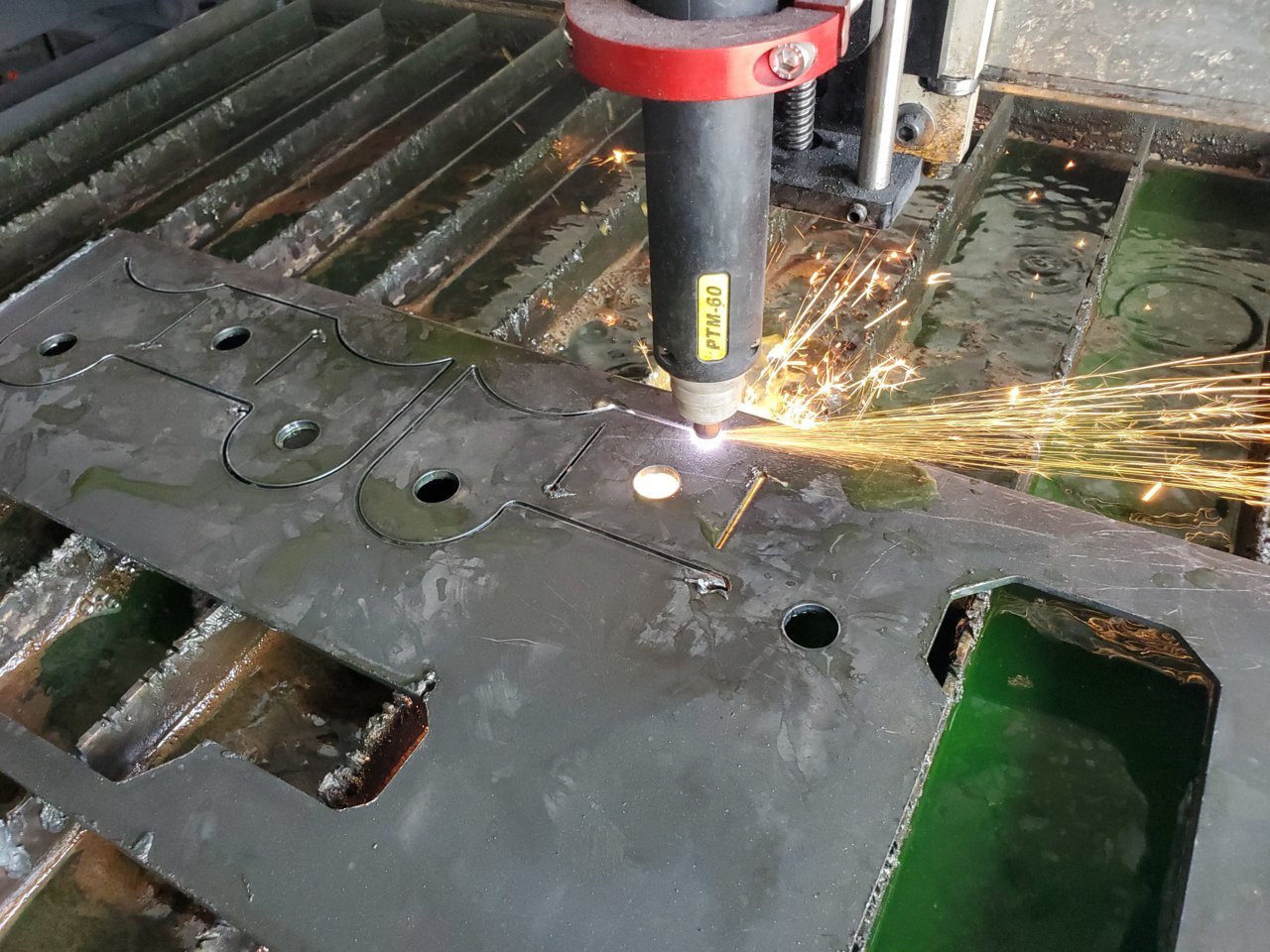

    Will be cutting and bending them tomorrow -

    Rivnuts?

    Make a bracket for the bottom use weld nuts to secure the bracket .
    That is what i would do any issues your shock mount is easy to remove and repair or modify .
    I have been using Weld Nuts for years make many projects so much easier.
    Your local Industrial supplier should have or be able to get them.
    I tend to use McMaster- Carr for that type of hardware.

    That looks like That 4Runner could be a neighbor!!
