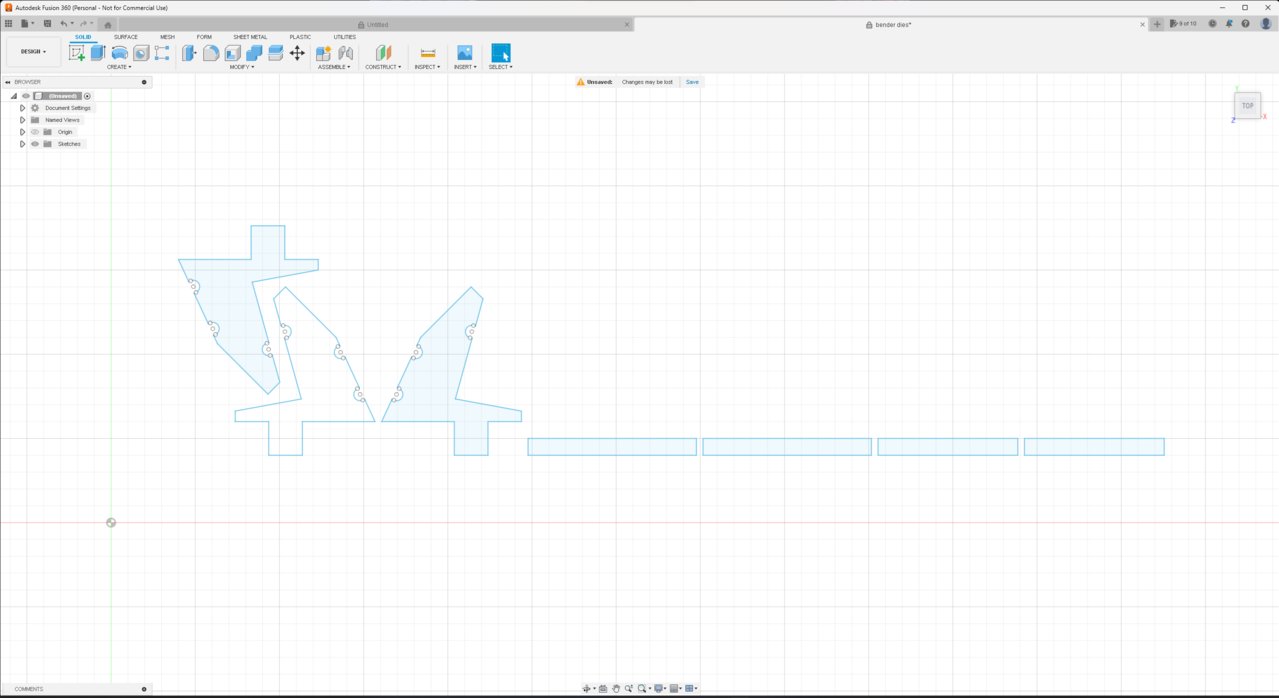

    See if you can import this. I got eleventeen tabs open with all in use.
    soundman98 likes this.
  11. Aug 20, 2023 at 2:53 PM
    Kwikvette
    Feb 27, 2019
    #284735
    81,614
    Fresno County
    4 run, 2 don't
    It worked!
    The real question now is, are they the appropriate size and will they work on my setup.
    Also wonder what the three pieces on the right are for?
    Anyway, this will be a good project to try out. Thank you for the files!

    dont you need to scale it 1st? DXF files usually dont have dimensions.
    i wondered about those bars, too.

    So long story short, someone suggested I needed gooseneck dies to which I replied "my work demand does not justify the cost"
    Someone else suggested cutting my own and I instantly became intrigued
    Well apparently the guy that created that file you downloaded for me, implied he made them for the Swag brake.
    I don't know about you but all my drawings and made to scale but yeah before I actually cut anything I did plan to measure the "top clamping area" to see how large/small it needs to be

    They drop in the 3 radius cutouts to align the pieces and weld together for added strength.
    Cut the dies, put them in the press, and drop them all down onto the bed for alignment, then slide in the reinforcing bars, tack them together, take them out and weld them up.
    Best case scenario, mill them after welding.
    The plate dies do work, but take your time setting them and tacking them. Single piece dies are obviously better, but are rather expensive. You might try Fab Supply so some off the shelf small dies. Last 32" general purpose gooseneck die I bought was around $400, I believe. Worth it once you factor in plate costs, cut time, fab time, and frustration when the left side is hitting 5* harder than the right side... Food for thought

    Just like Swag's offerings, I figured the radius cuts are where you'd weld them.
    As for the 3 long parts, where exactly do they 'drop in' ?
    I'd just take a stab at it in an attempt to make myself a small set...no wider than 2.5" really but if I did have to buy a set they're only $165 from Swag
