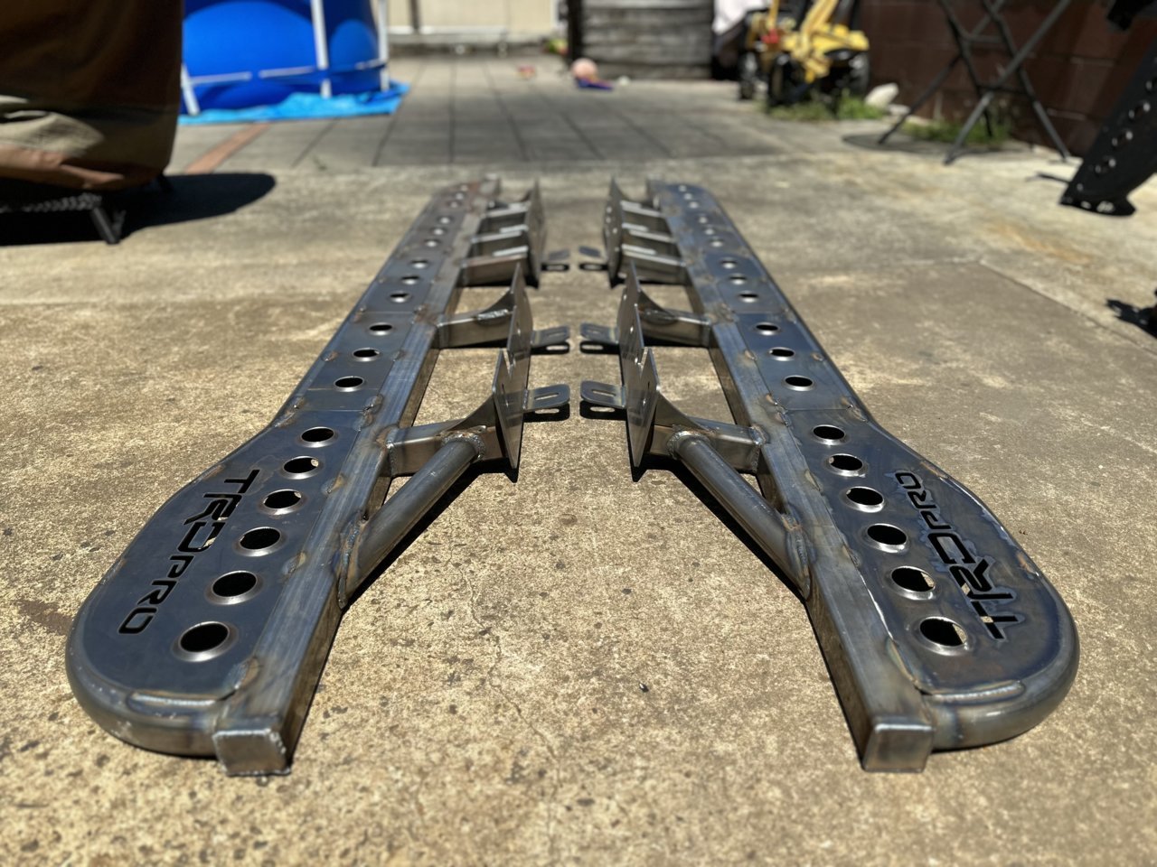

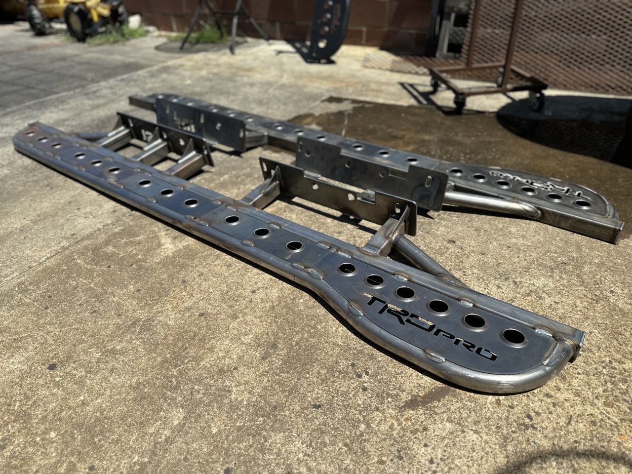

    Set of 2.5 Gen Tundra sliders I finished up today. Customer came down from Canada! Planned a Disneyland trip with his wife and kids to come get the sliders haha. Install on Wednesday

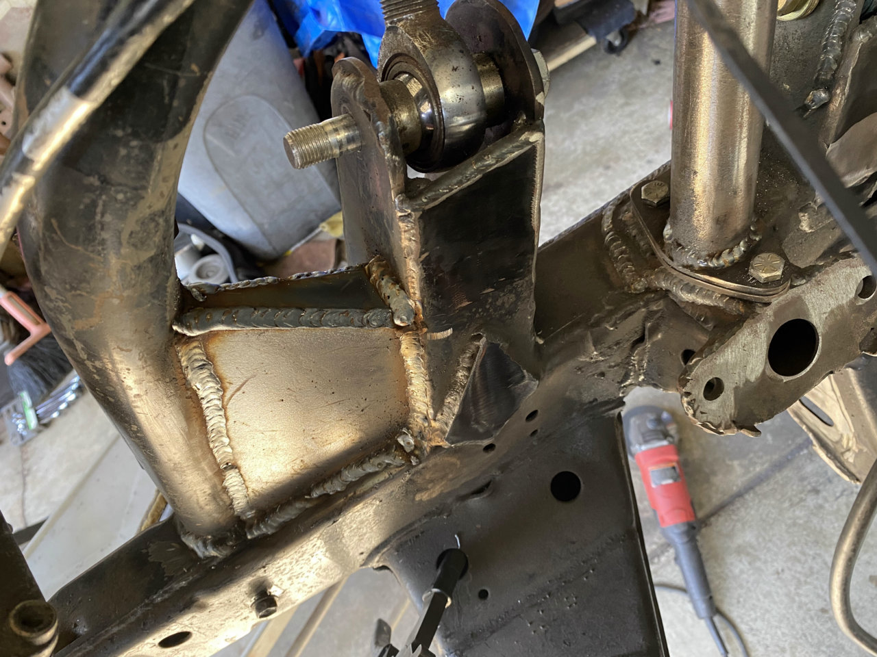

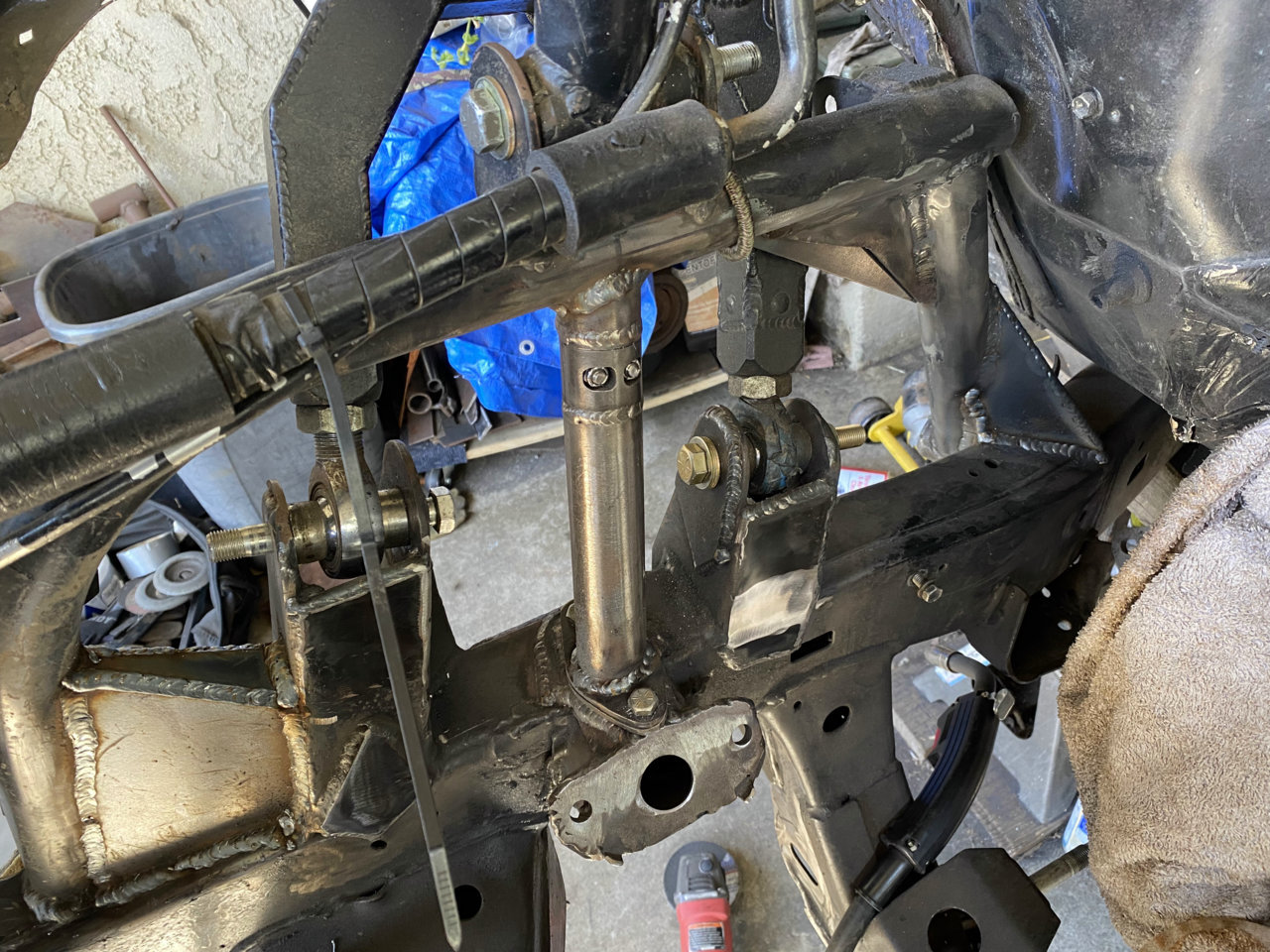

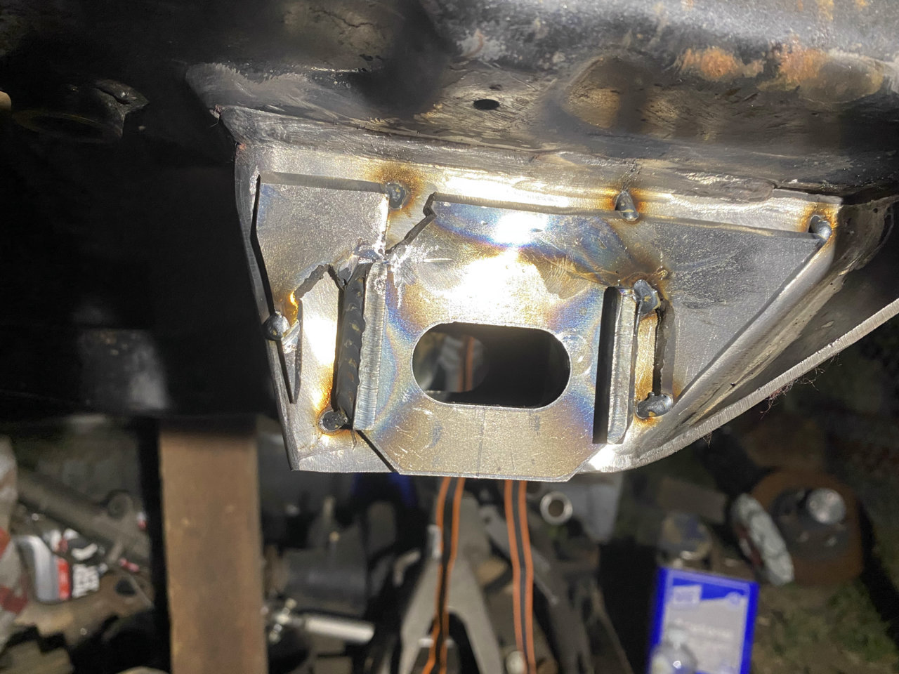

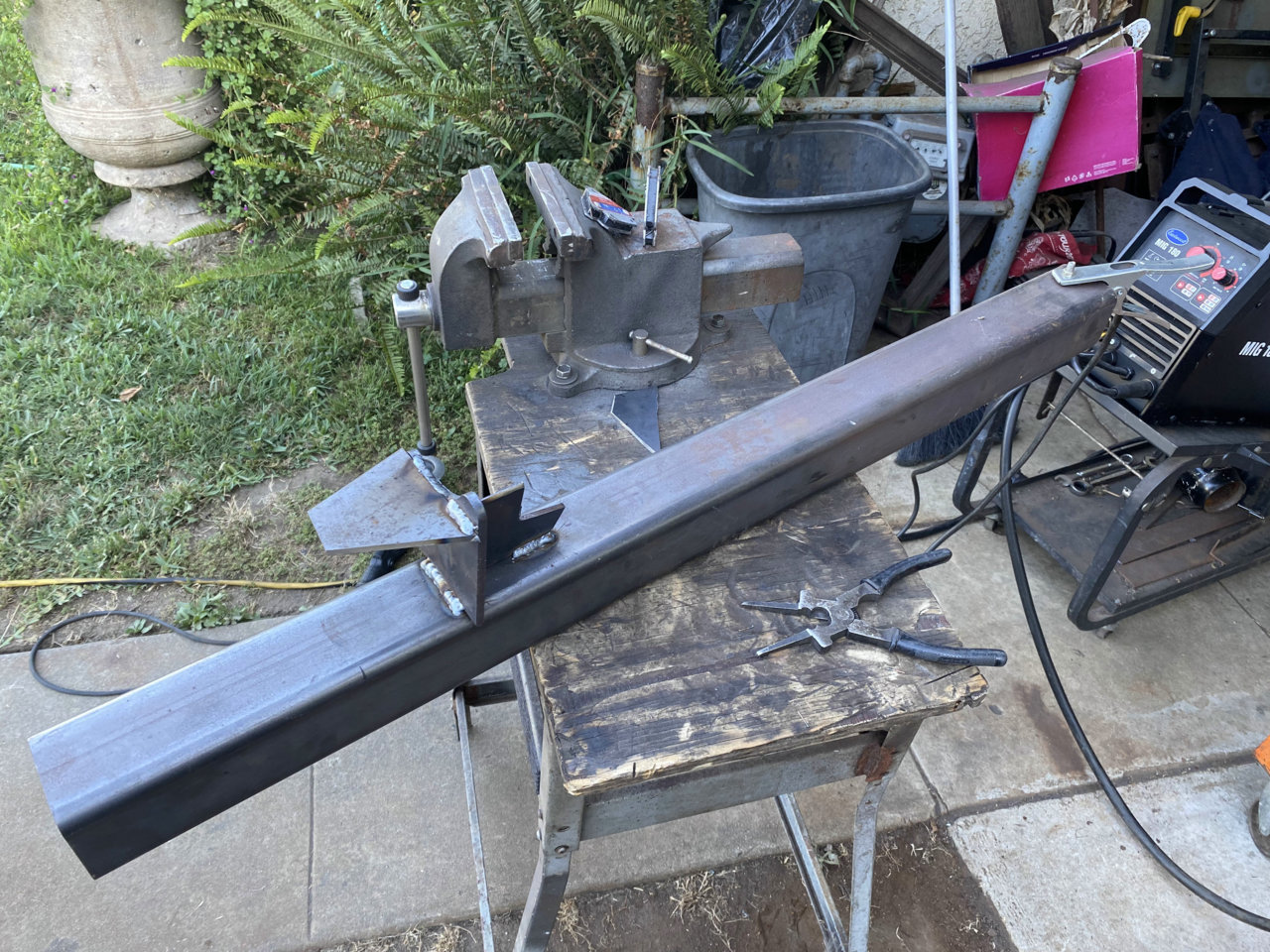

    Some things I've been working on lately
    UCA / Shock hoop mounts for my 98. May or may not remember, however @Shmellmopwho bent that tube like 5 years ago... thank you again Ryan

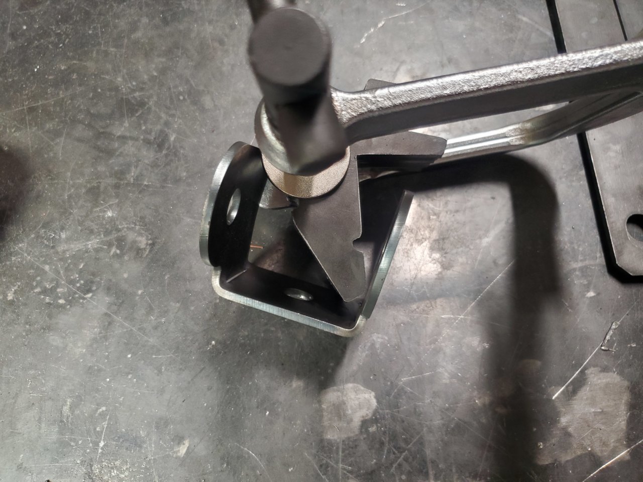

    High lift jack stand
    Because why not, doing cam tabs is no fun on regular jack stands.

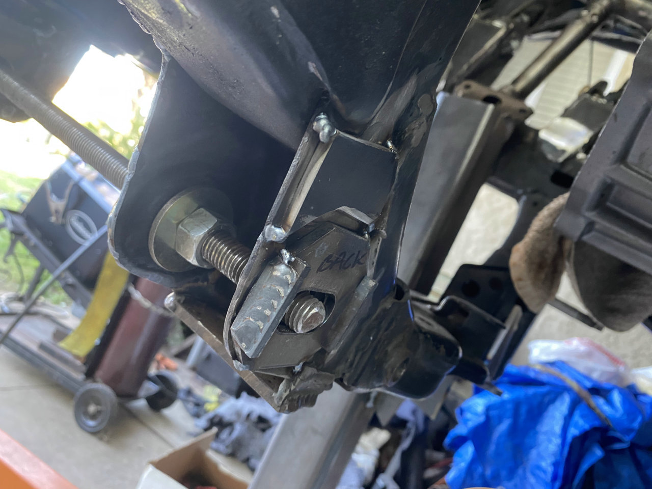

    Modified KPO cam tab gussets

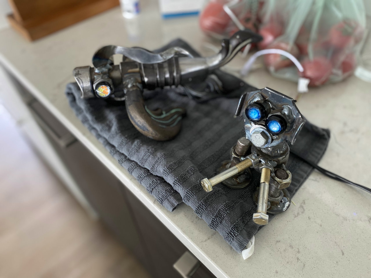

    Made a couple night lights for my niece and nephew (not dim enough with those LED eagle eye lights lol)

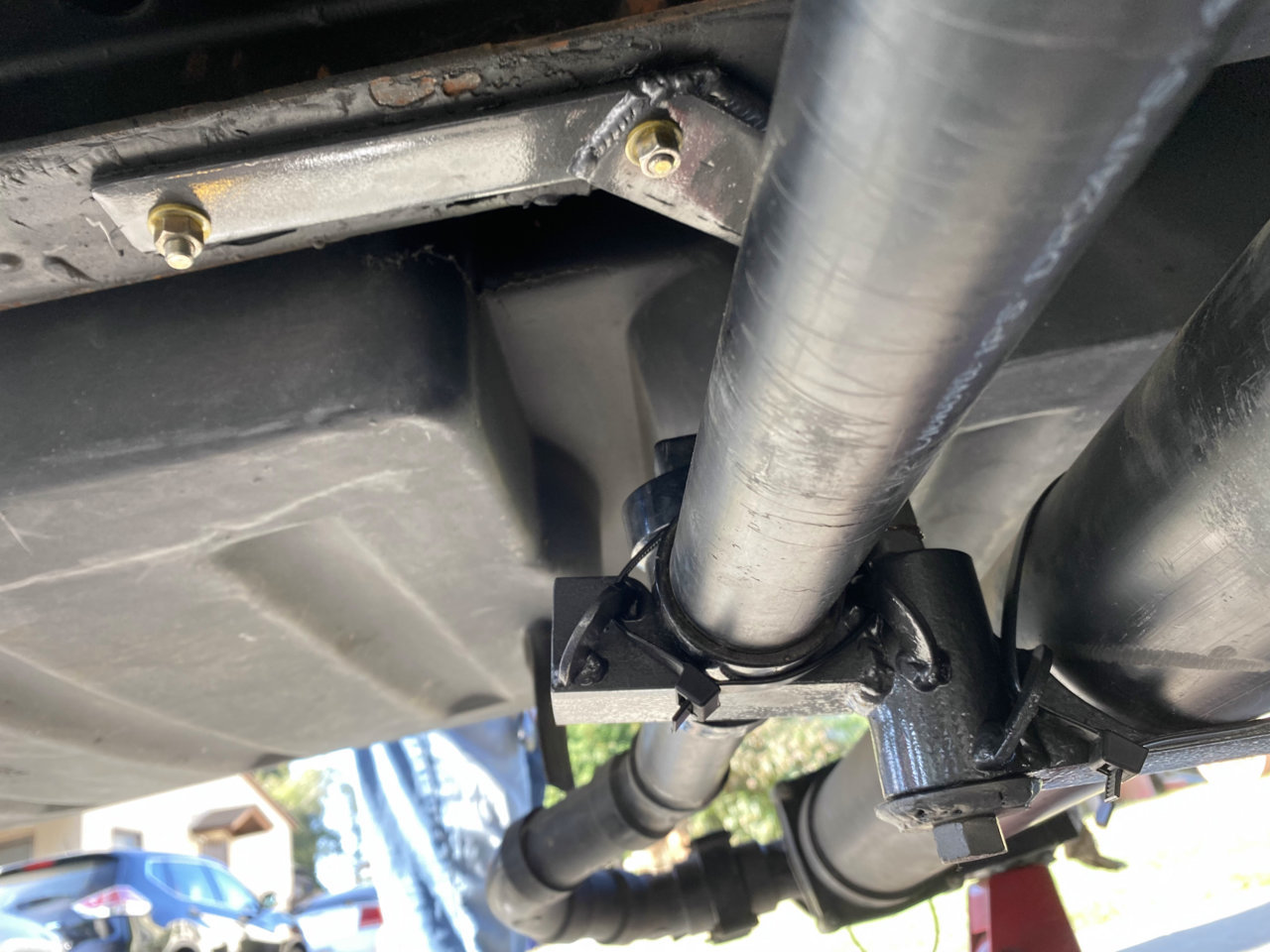

    A height adjustable cradle to help my old neighbor's RV black tank drain pipes be raised to get more clearance for ride height and lowered when it's time to drain and float a little to account for frame flexing

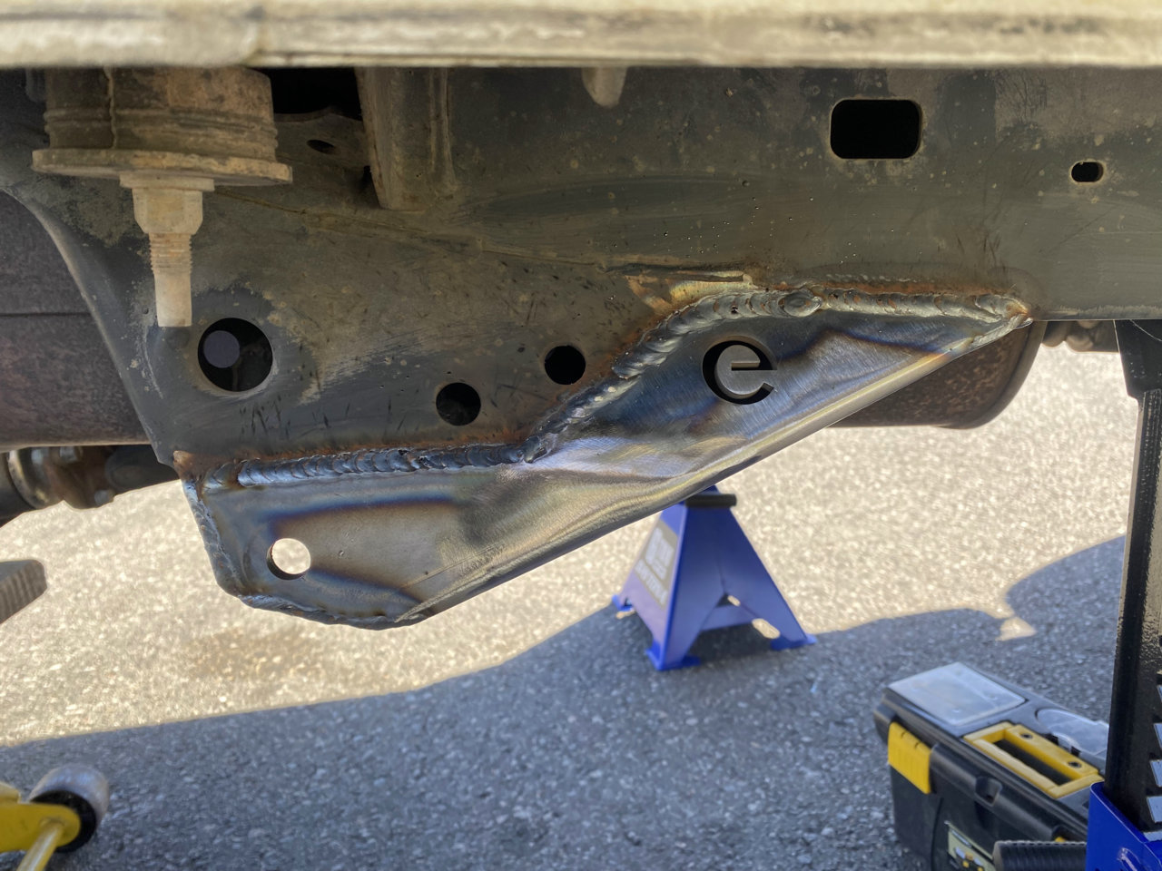

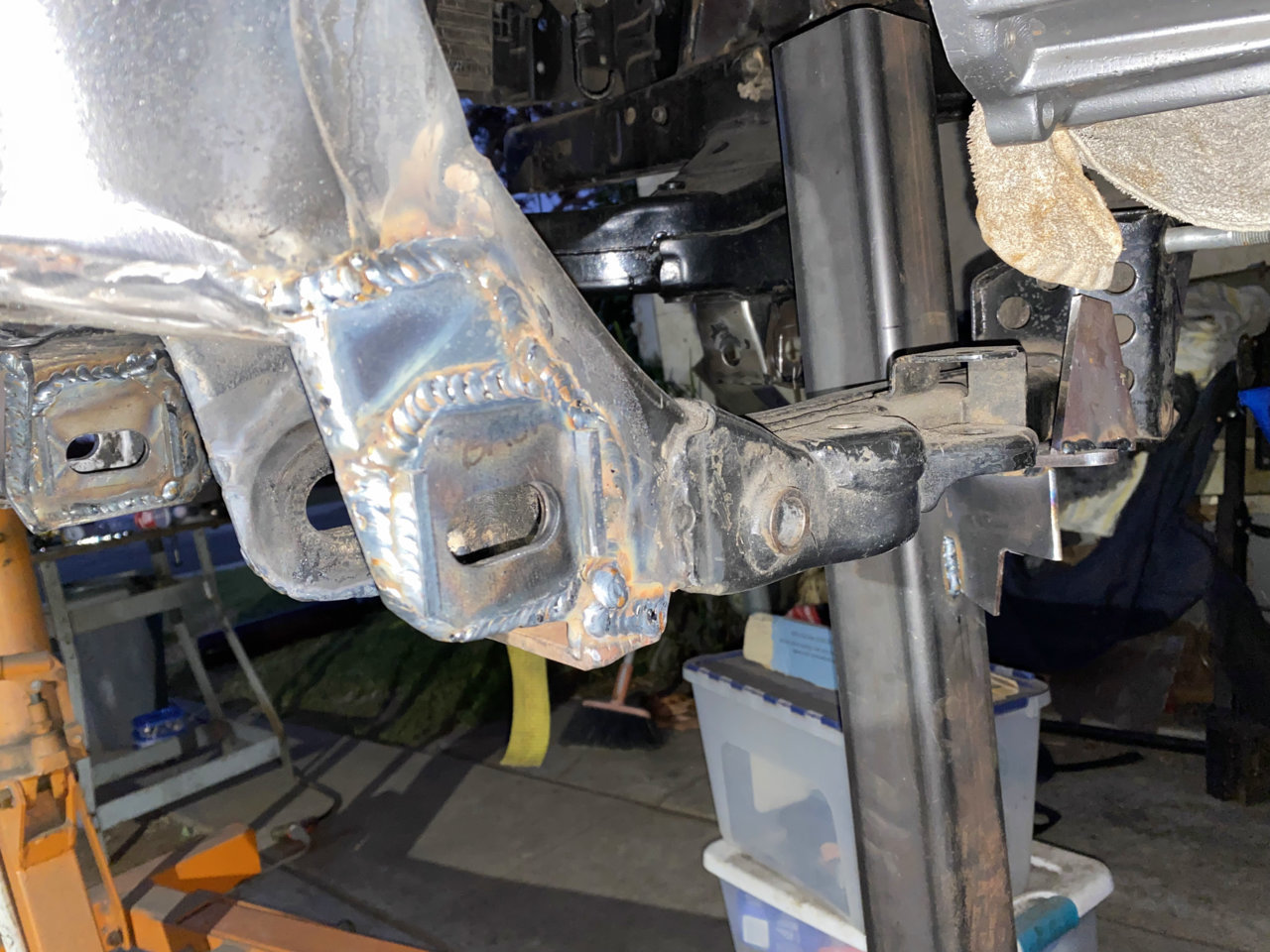

    Rear link gussets on my wife's t4r by eimkeith

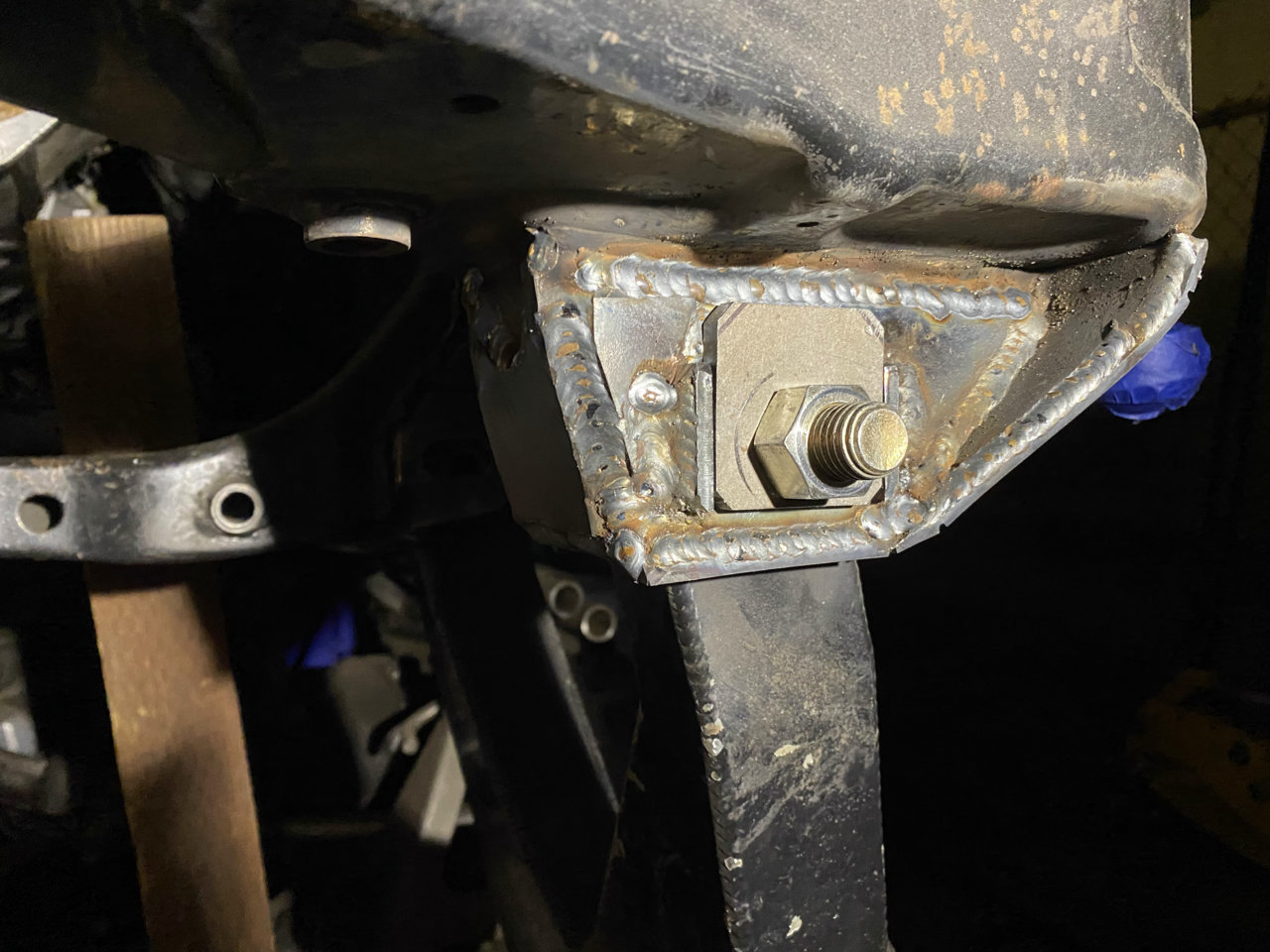

  5. Aug 22, 2023 at 1:54 AM
    Bivouac
    Bivouac Well-Known Member
    Sep 5, 2021
    #376253
    11,580
    Northern Lehigh Valley Pa
    2000 Tacoma 5 speed 3.4
    Remains to be seen I bought the tires and wheels the rest came along

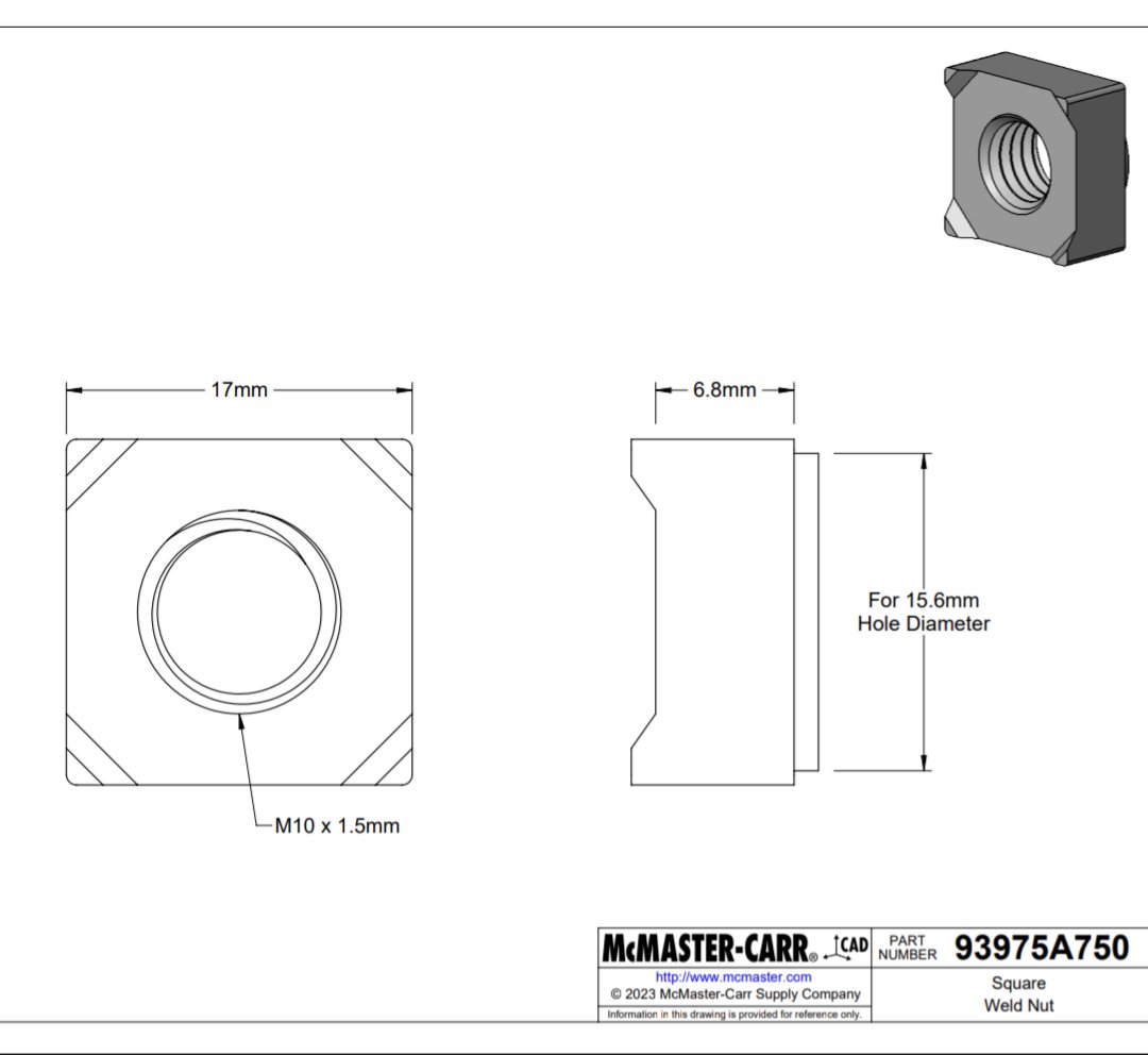

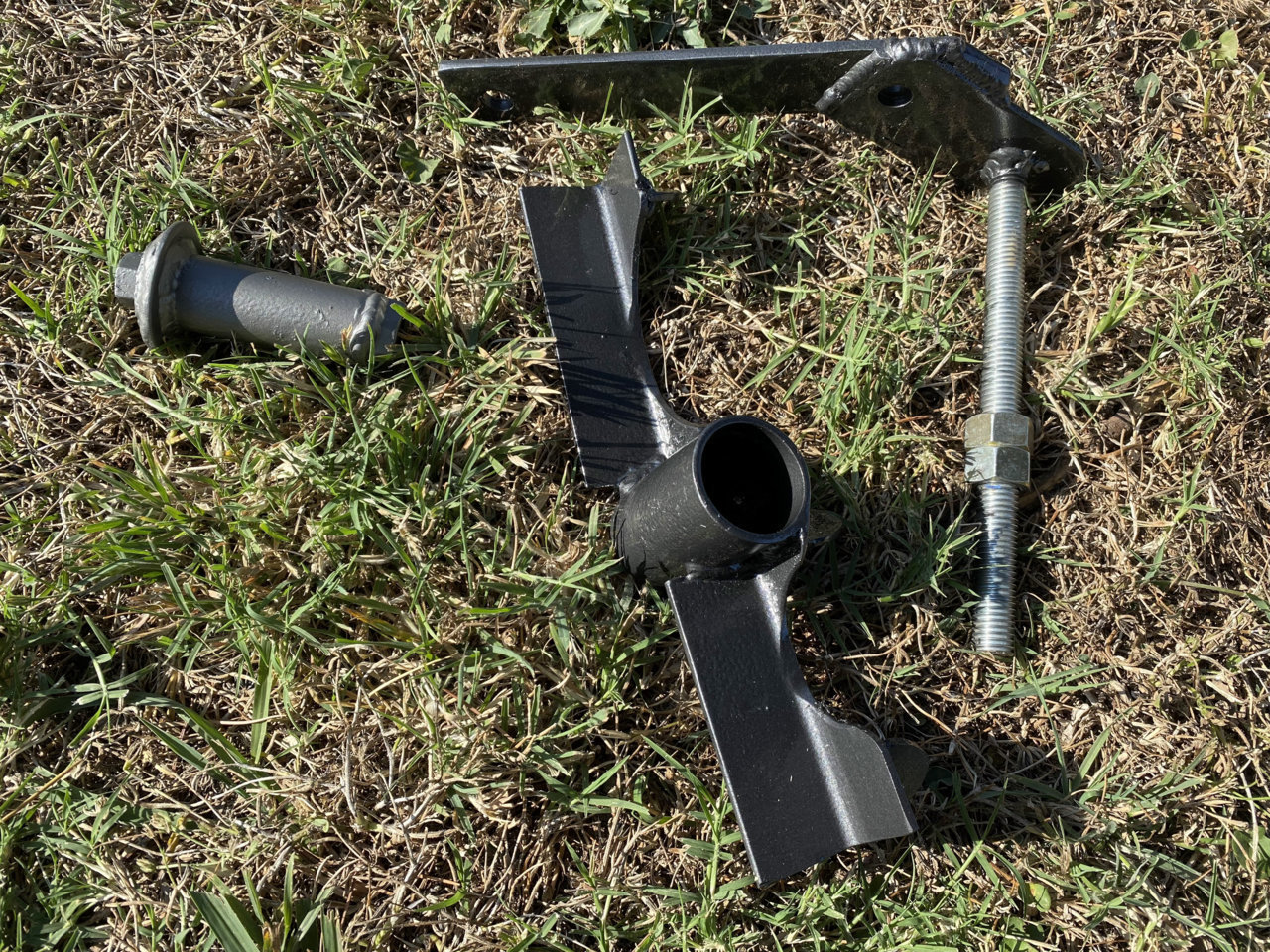

    Time flies I am not sure how long ago I stocked up on weld nuts it might be 10 years ago .
    Those raised corners are a stand off to allow you to better burn your weld in.
    I don`t see any reason this style will not work for your project.
    Taking a quick look I did not see the style weld nut I have on the shelf perhaps this is the new improved style .
    The ones I used when welded on ended up flush with the outer surface of the material .
    I will see if I can remember to take a picture of the ones I use.
    Tacman19 likes this.

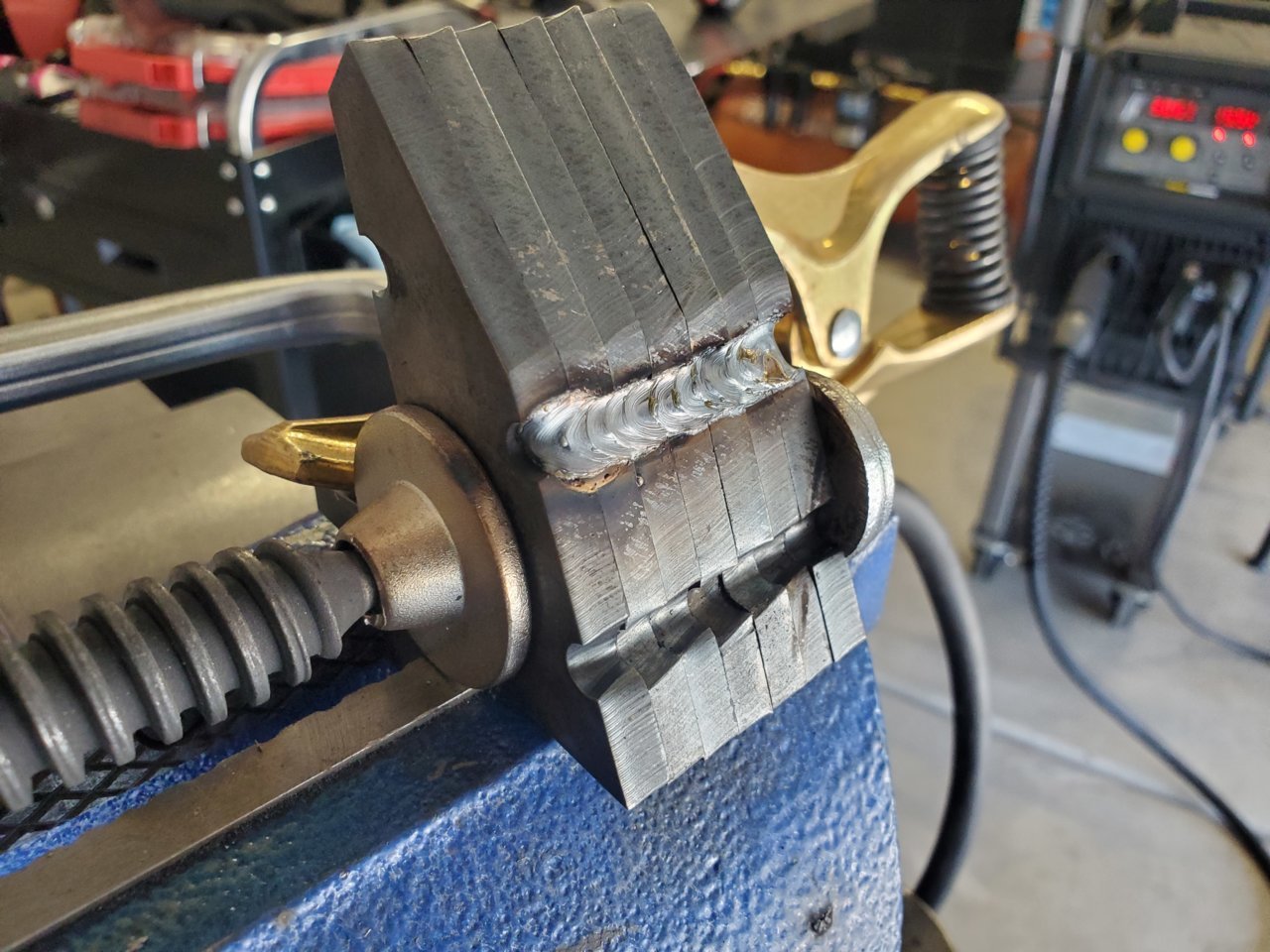

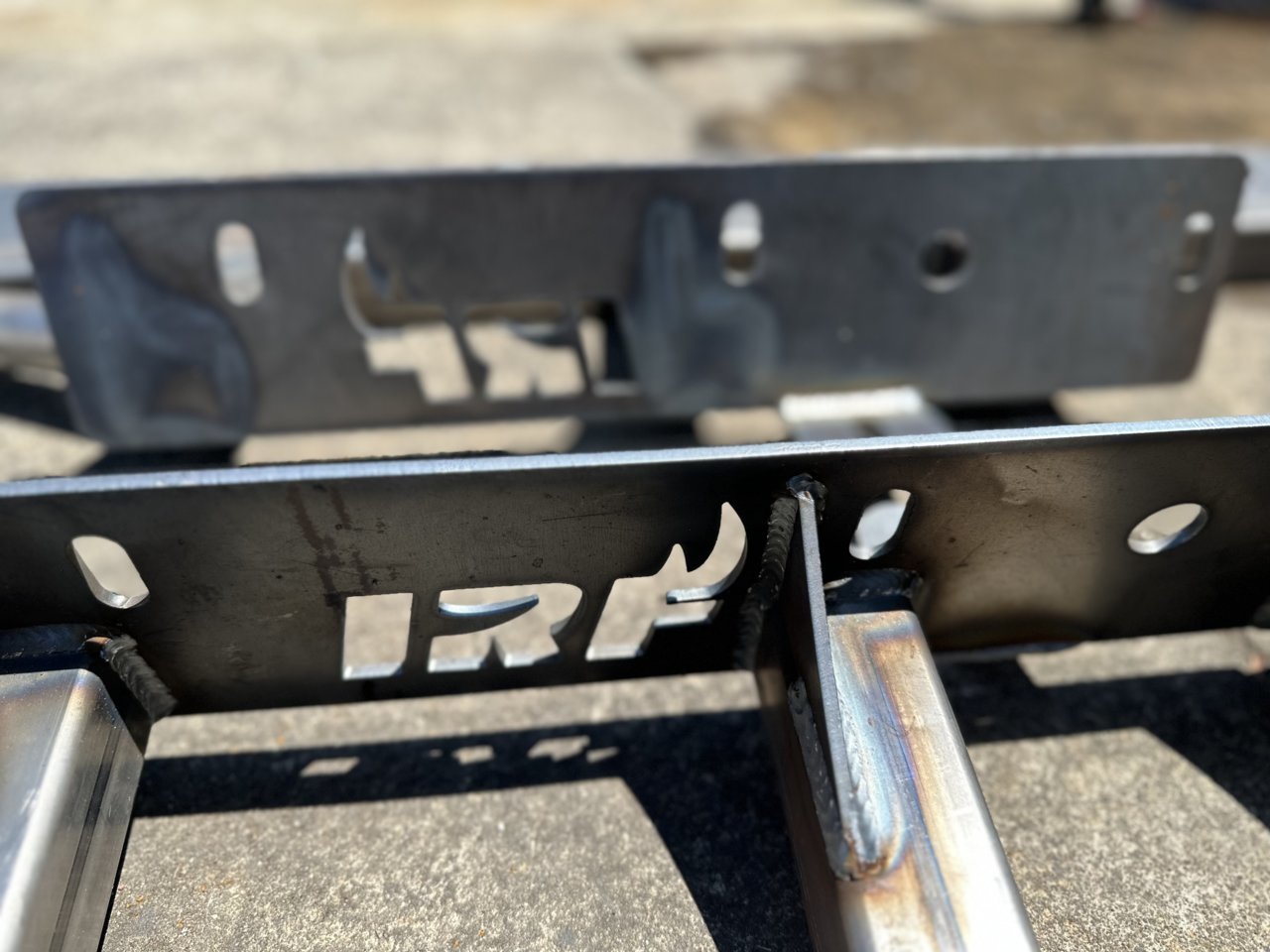

    @koditten
    Thank you again for the files
    For some reason, got beveling issues again but I just need to maybe square up my other tube as well as getting my table completely level as someone mentioned
    That and I still haven't cross braced my table :rofl:
    Nothing a belt sander or careful hand with an angle grinder can't take care of but I need to flatten and get all these parts flush with each other
    But really the huge help comes from the fact that these are closely the same size as Swag Offroads die set
    They really only support a 2" leg before the die interferes with said piece so unless I'm doing something small, the $165 wouldn't have been worth it
    Maybe this info will help anyone that considered looking at these dies
    Bivouac, Drainbung and koditten like this.

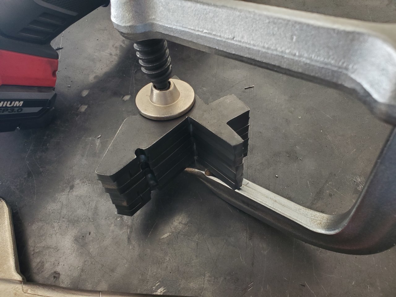

  9. Aug 22, 2023 at 3:38 PM
    Kwikvette
    Feb 27, 2019
    #284735
    81,614
    Fresno County
    4 run, 2 don't
    Example of my control arm mount and the die; really only useful for small stuff if you've only got a 20 ton press
  10. Aug 22, 2023 at 4:31 PM
    soggyBottom
    soggyBottom Well-Known Member
    Sep 19, 2018
    #266818
    1,993
  11. Aug 22, 2023 at 4:44 PM
    koditten
    koditten Well-Known Member
    Sep 8, 2013
    #112077
    19,765
    Kirk
    Central Michigan
    04 trd x-cab 4 x 4 3.4l
    Reserected from the dead.
    I'd say the torque#s will change with the size of weld nut.
    70s welding wire is specked to yield with 70,000 lbs of shear force.
    I think the threads will strip long before that.
    How many ugga, duggas do you need?
    Bivouac and Drainbung like this.

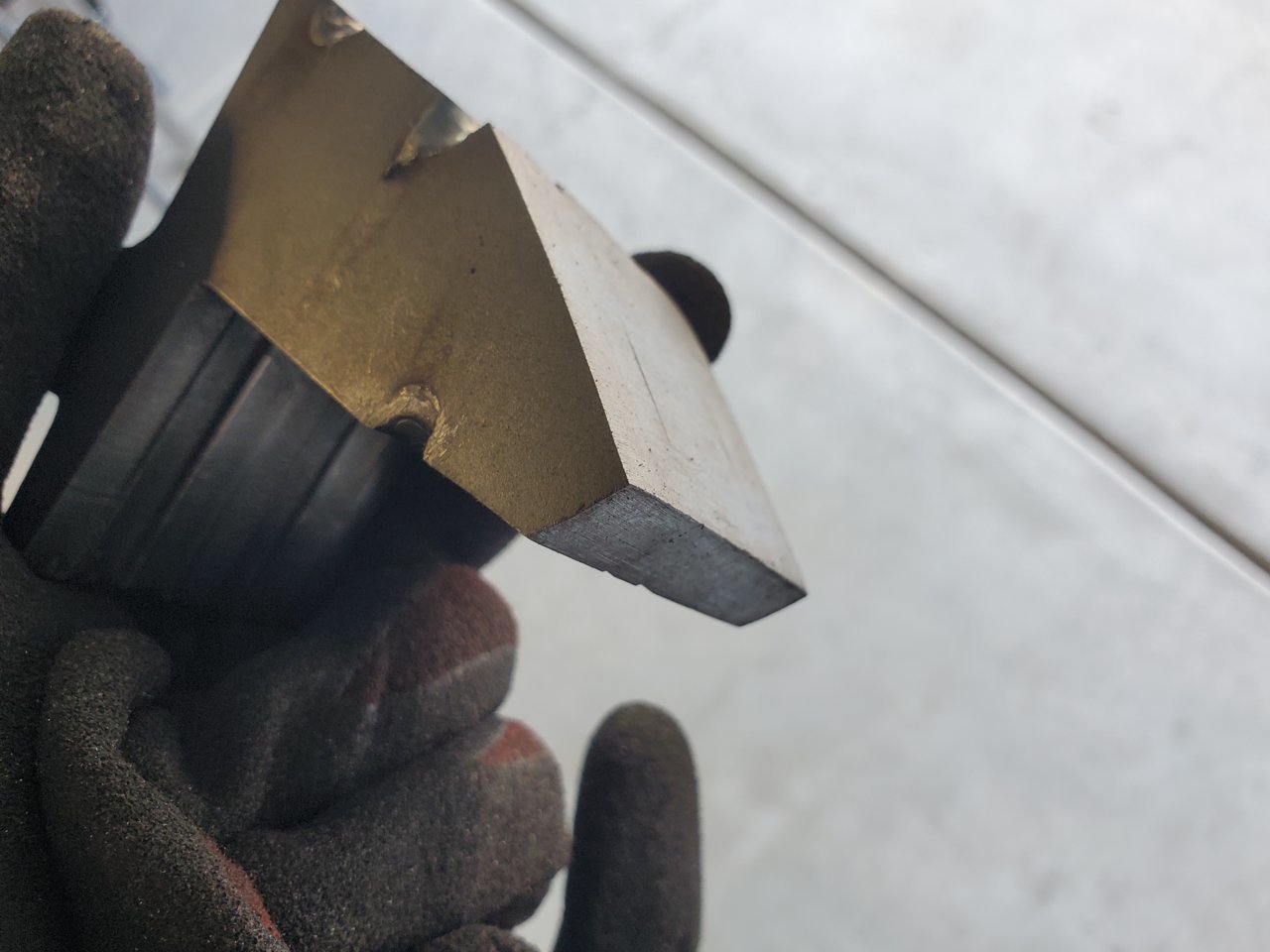

  12. Aug 22, 2023 at 5:21 PM
    Kwikvette
    Feb 27, 2019
    #284735
    81,614
    Fresno County
    4 run, 2 don't
    Clamped and welded
    Flattening out as much as possible with a flap disk
    Using a lighter grit belt sander to get a nice flat face
    Still have to finish where it mounts up top but so far I'm stoked
    soundman98, Bivouac, dk_crew and 2 others like this.
  13. Aug 22, 2023 at 7:41 PM
    Dalandser
    Dalandser ¡Me Gustan Las Tacos-mas!
    Feb 19, 2015
    #149090
    17,630
    Anthony
    Downey
    08 PreRunner Regular Cab / 98 4x4 Extra Cab
    Empty Wallet Mod
    I called about another weld in threaded insert with the same abmiguous description and I think it was equivalent to Grade 5. I wouldn't go over 5 and more likely around Grade 2 - when needing more clamping force, I've sanded down Grade 8 nuts and clamped with some vise grips for tacking. If you know anyone with a lathe, they can turn normal hex nuts into a weld nut really quickly and easily.
    Kwikvette likes this.

    I tighten them like any other nut of the same size after some time you get a feel.
    The nice thing if you mess up the threads simple to replace.
