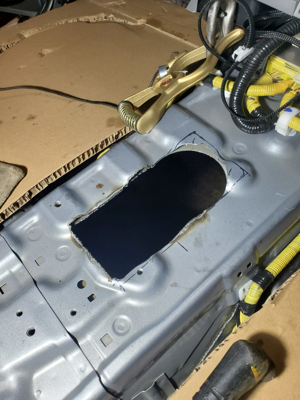

    Bodywork experts:
    I'm doing a manual tranny and manual transfer case swap on my 2nd gen DCLB. With that requires cutting a pretty big hole in the tranny tunnel of the body. I've been trying to use all-Toyota parts and trying to do slow, methodical, quality work up til this point. I'll be using an FJ Cruiser double stick inner shifter boot.
    As you can see, the issue is that the tranny tunnel on auto trucks has multiple layers right here and isn't flat so the shifter boot frame doesn't sit level and doesn't/won't seal as intended.
    I still need to do some clean up but with the various layers and spot welds in places, it's not easy to separate so the shifter boot frame still doesn't sit level. There are a couple spots I ended up plasma cutting some pinholes in to the lower panel and will need to spot weld those anyway.
    My question is: should I spot weld the seams and add some filler pieces so the shifter boot frame fits more level or just hit it with RTV/seam sealer and call it good? I'm trying to do a quality/professional looking job and want the shifter boot to seal as intended so wondering what y'all think? I'm not worried about the work/time frame involved so long as it's right but only am setup with MIG.

    My vote is for the seam sealer.
    As long as all raw metal edges are rust proofed/painted, I'd seal it up and move on.

    Because the stock shifter boots are long gone last manual swap I did I used two universal generic shifter boots.
    Ran a bead of silicone and screwed them down.

    I lucked out getting a new FJ Cruiser double boot from McGeorge (part number: 58280-35320). It was pricey and is usually marked discontinued so I really want to get this right.

    i would add filler pieces. seam sealer cracks over the long term. but honestly, it'd be mostly for the challenge of creating them.

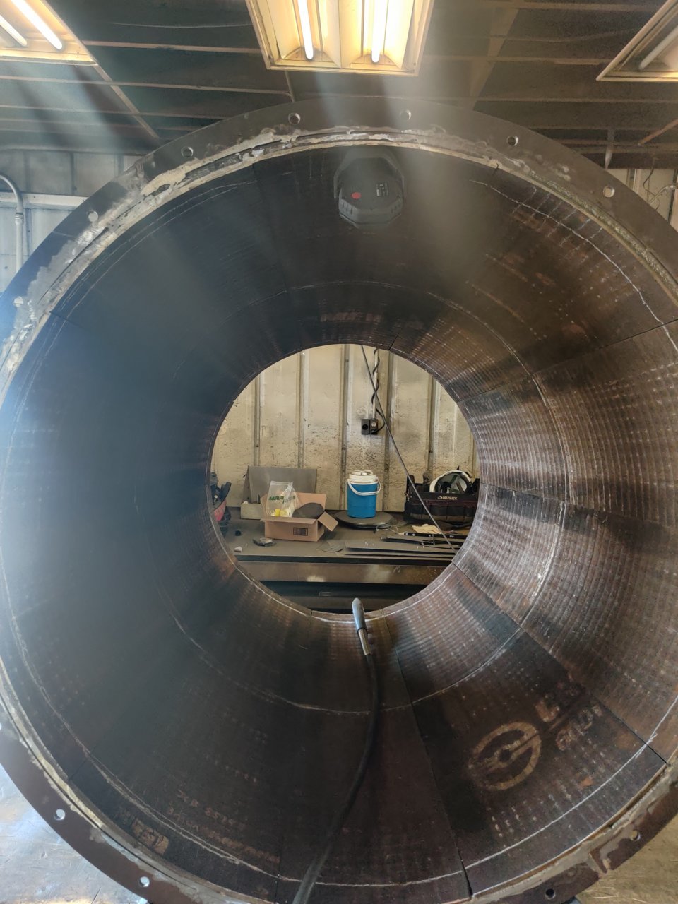

    Been working on fabricating some cyclone discharge chutes recently. Got to test out the Harbor Freight Icon Floodlight, this thing is amazing. The light output and beam spread is phenomenal. It's only on the second brightness setting in the photo. Also the hardface plate inside the chute is high in chromium and the layer beneath it is mild steel. Very impressive how it magnetized through it. 1/4" on 1/4" hardfaced plate for reference. IMG_20230825_124819.jpg IMG_20230825_124810.jpg
