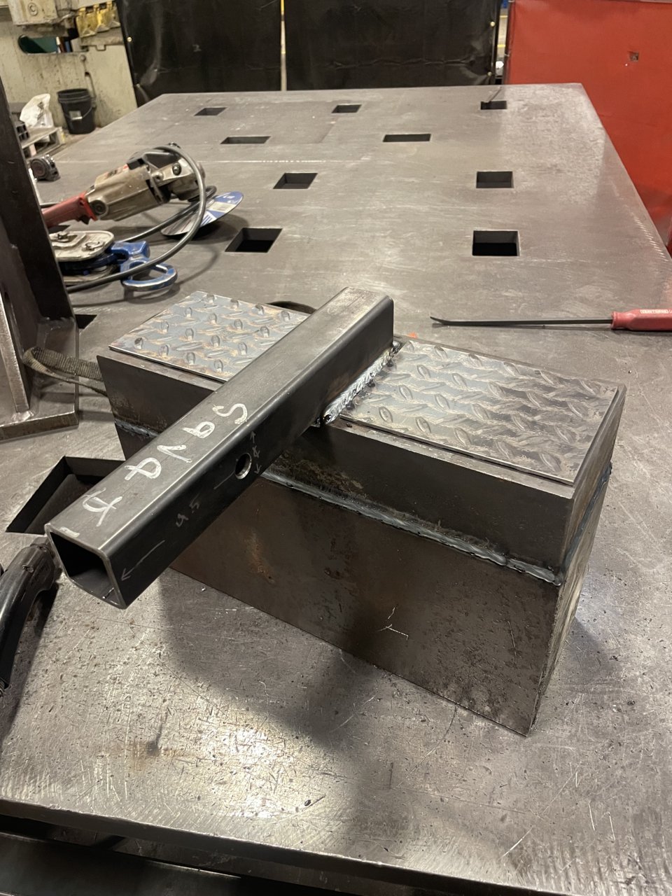

    Made myself a ballast weight for my Kubota at work the other day. Have to do projects for myself once in a while.

    What does it weigh? I've been considering making one myself, but coming up with the materials is an issue. I'm tired of using my brushhog it just to long, and I'd like the counterweight to be heavier.

    I never put it on the scale but calculated it out around 450lbs.
    I was in the same boat using my land plane as a counter. Just got old watching where the rear was swinging.

    Same here, I'm wanting something about 1000# for my tractor. I've been thinking about welding a 3pt hitch into a 55gal drum and filling it with concrete. As I don't think I can come up with enough steel for a box on the cheap.

    Did you guys fill your rear tires? I'm kicking around going that route. I had that done on my last Kubota and it helped quite a bit.

    Yep, I did that a few years ago. I went with the beet juice option and it added about 500#, which helps but not nearly enough to reach the full potential of the loader. I unloading a few pallets last week that weighed about 1300#. The finishing mower was already on the back of the tractor so I used it. It weighs about 500#, and that was almost not enough to unload the pallets. The back end was just barely making contact with the ground. Luckily I didn't have to go far with them. The brush hog weighs about 750# and I can lift around 1500# with it, but it sticks out so far it is a PITA. I would be tickled pink if had a 1000+# CW that was only 2-3 feet long on the back.
