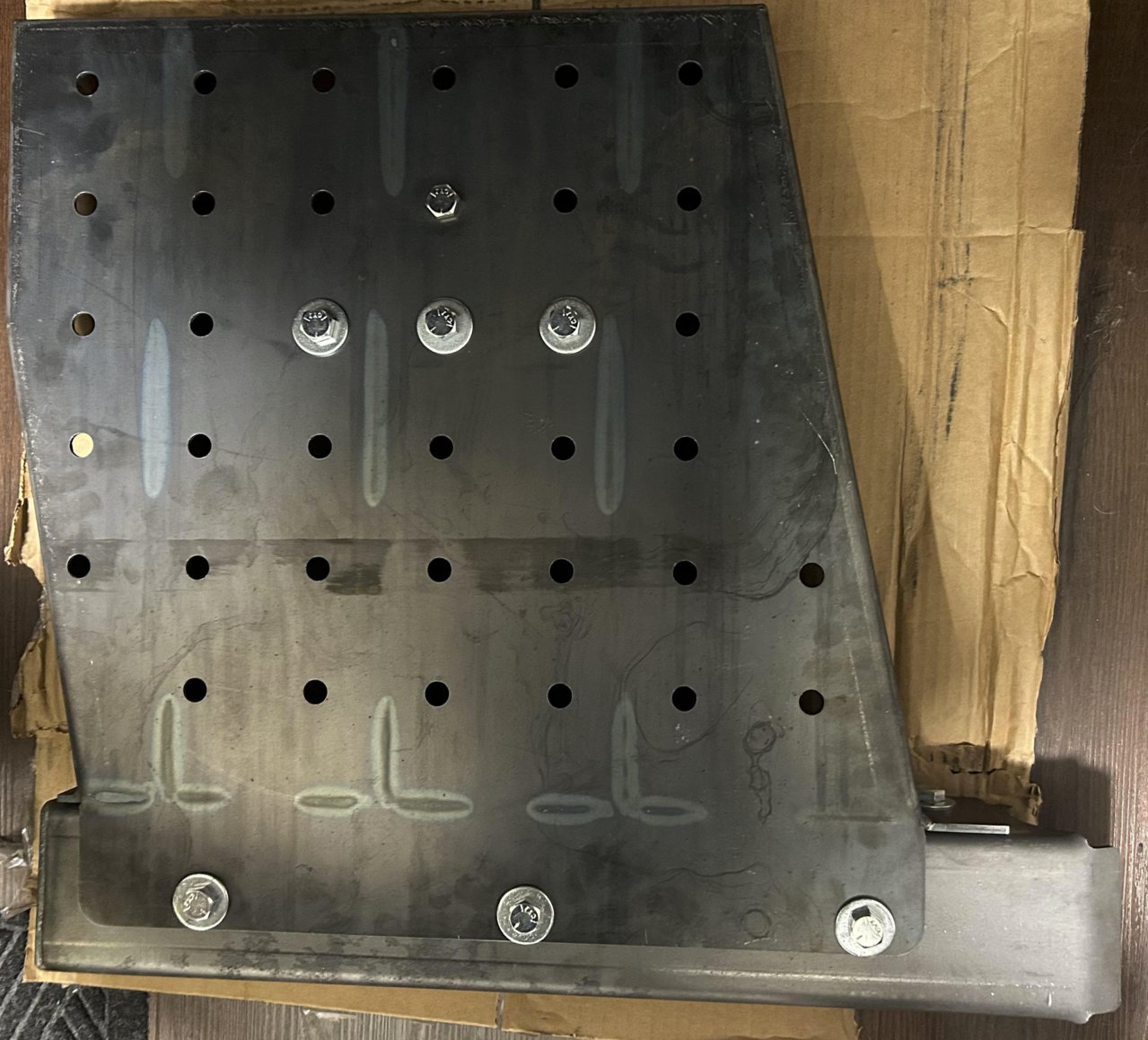

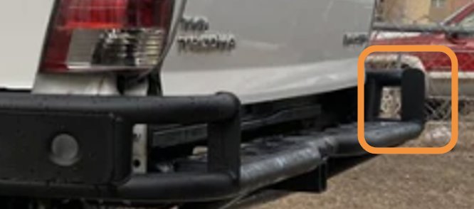

    how does one go about adding a swingout?
    I need to think this out before I powdercoat the seal...

    For a bumper?

    yessir ~1yo Phantom HC

    There's multiple companies that sell DIY kits or you can just piece it together yourself. A quick search of "DIY bumper swingout kit" on google will populate all those kits. I went down the rabbit hole when I was considering adding a swingout. Ended up not doing it. I just throw the spare in the bed lol.

    it is a kit

    Ah gotcha, did it come with a dual hinge or a spindle?

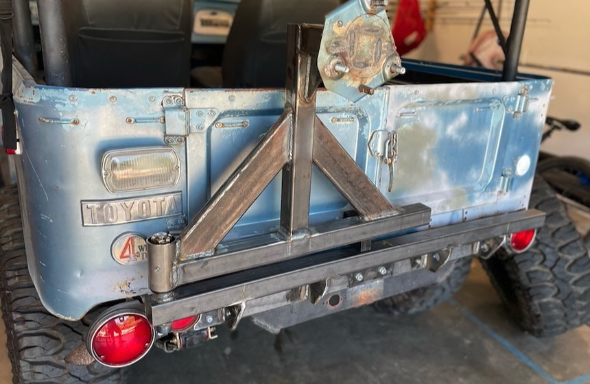

    Is that from warfab? If so just ask them (I have their tie rod sleeves -- cool product) -- I'm sure they provide a spindle wiht guidance on gusseting that mount where you'd weld to onto the side of that bumper for the panel to swing out.
    I made my own (for an FJ40) but you can see the bottom left of the pic is the spindle that gets welded to the main bumper. Then you can see the swing out mounted. That spindle is pretty common -

    There are so many different options pick one that will work the best for your use.
    When I was researching I found for my use it would be more trouble so the spare was mounted in the right front corner of the bed.

    it was picked a long time ago
    Then came in the mail
    I sleep in the bed sometimes
    On a wooden platform with with drawers foam bag blankets memory foam pillow in a shell with netted windows and a fan
    it is a half swingout
    One of if not the only one on the market with the new Rigd latch
    More regarding where the latch would go
    at this point looking at other designs I wonder if I should’ve gone with a local guy to make one out of bar/flat metal to hold a tire (the purpose of one of the gates)
    or leave that gate for a future left side if getting a second base tube and spindle
    because the main platform with holes is to be modular and bolt stuff to it. Almost like MOLLE.
    Which is fine (added weight) to bolt a bunch of different things
    But not really needed for the singular use of mounting a wheel
    to include nguyenworks
    Local
    Makes bumpers and swingouts
    Could probably make just swingout(s) for it and weld them on.
    pretty much wanted to start with just a tire holder to hold the tire
    Figure out the rest later in terms what’s ideal for the rest of it
    Ie table, left swingout re: all the different holding options of holding can(s), jack(s), etc
    Figured can’t go wrong with at least just one tire mount for now.
    yes. Single spindle.
    Hopefully it will stay on the right side leaving room on the left if ever adding a second to make it dual
    waiting on some more parts for it
    I guess when they come I’ll bring it by a local fabricator see what they recommend
    in terms of what to coat, when to coat it in terms of timing regarding actual welding, and what coating method to use (it came bare metal)

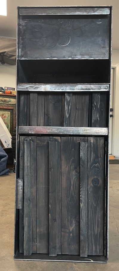

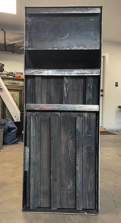

    Sharing pics from a fun welding project my 16yo and I cranked out over the last 2 weekends. Here is the finished product:

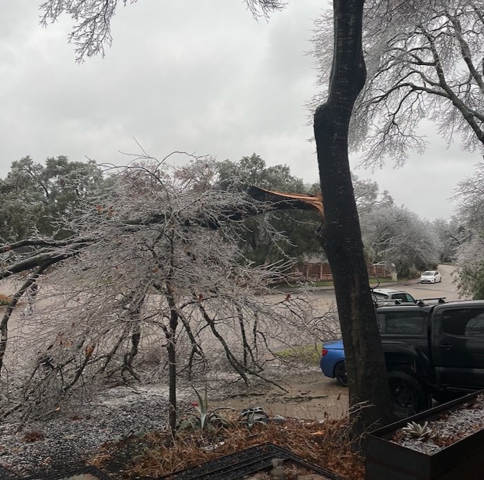

    We had a crazy ice storm back in February in Austin -- a bunch of Trees in our neighborhood had a 1/8" coating of ice covering the limbs --- you'd walk the streets and hear constant cracking of the branches suffering ... and a bunch of them eventually broke.
    With ours we lost our mailbox ... so that presented an opportunity to build another better mailbox. For a frame of reference our house is wrapped in cedar with a pattern as follows ... so we thought we'd link the mailbox to the house with the same cedar layout.
    we started with a 3/16" sheet, scrap angle and flat bar and the assortment of cutting and grinding tools ready to build a new mailbox.
    if you have kids I think you'll agree ... it's awesome to see them enjoying what you enjoy -- getting some good hood time in. Way over-welded but it's a great way to practice.
    It 100% looks handmade which was a goal ... and I still need to figure out a good locking mechanism for the box / bottom opening ... we're going to 'blue' it to match our front door, seal it and hopefully get it out front this weekend.
    Once we're done -- my son is going to create some flyers with pics and a quick story and pass 'em around nearby to see if anyone else wants some homemade boxes.
    And I may hit one of you guys up for a set of numbers -- I think 2605 cutouts from one of your tables with tabs putting them maybe 1/2" offset from the box up closer to the top would look great.

    Nice looking mail box!!
    Being your in Texas being sun burned is normal so getting burned from the arc you never notice.

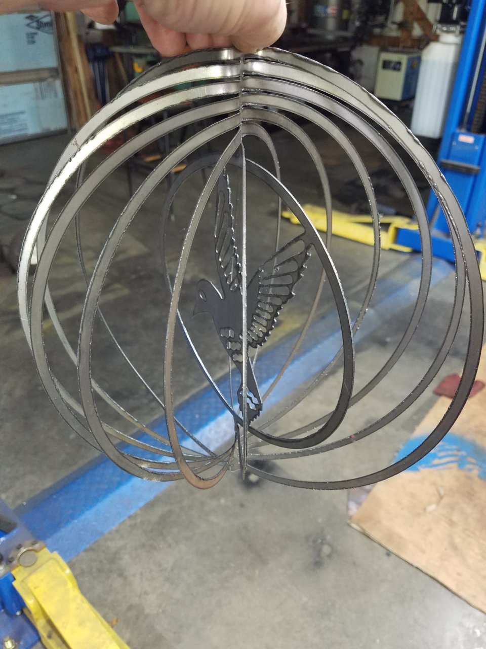

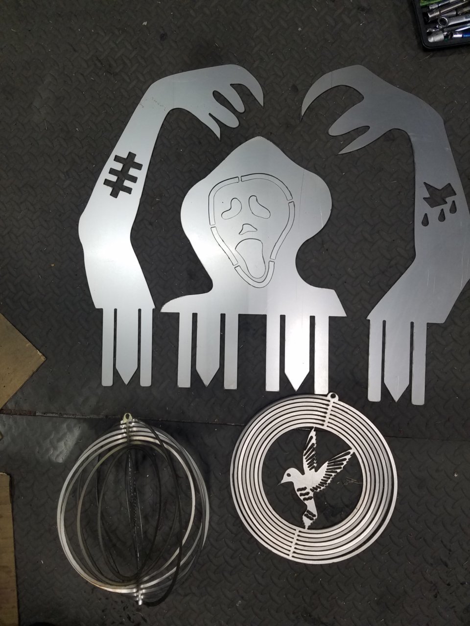

    I was in a cutting mood last night, so I got a jump on some Halloween yard art and 4 hummingbird spinners for a craft sale in late Sept.
    Ghoul is 18 gauge and the outer tabs at the bottom fold in opposite direction to provide support when it's stood up. The pointed leg is the spike to go into the ground.
    The spinners are 22 gauge, so they are light and easy to shape after painting. The one shown bent already was the proto to see if they'd spin so I bent before painting. You hang them off a fishing swivel. They seem to work best in light wind and get confused when windspeed is over about 10mph.
    Yuck, too much dross. Needed a bit more speed (up'd to 175ipm) and air psi. Subsequent ones were much better.
    Now I just have to get in a painting mood... hate the painting :annoyed:
