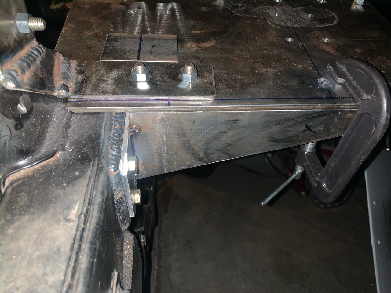

    I am 100% video "taught" plus I only weld occassionally a couple times a year (if I averaged it out throughout the years), but https://www.weldingtipsandtricks.com/mig-welding-basics.html helped me learn everything I need to know in order to make parts and things for my needs. Bob Moffat from Weld.com also is a good video "professor."
    As far as welders I started out with a Hobart Handler 140 that I got for a good deal used with a cart and a bottle. I liked how easy it was to dial in with only 5 clickable voltage settings - the higher two settings were great on anything up to and including 1/4" (although inside corners of thicker material usually won't get good penetration on a 110 machine). This was the last project I did before it died. I fixed a couple things like replacing the torch and the power cord during the time I was using it for about 5 years but I needed something reliable and bought a new one once I couldn't get it to work no matter what I tried.
    Now I have an Eastwood mig 180 that I think I got a year ago for about $500 shipped on a holiday day sale. From glancing at the PrimeWeld 180 the setup looks really similar to the Eastwood, but the digital readout on the PW addresses something I'm not stoked on about my machine's analog dial readout that has a lot of changes in a short span of the dial. But once it's dialed in it does well.

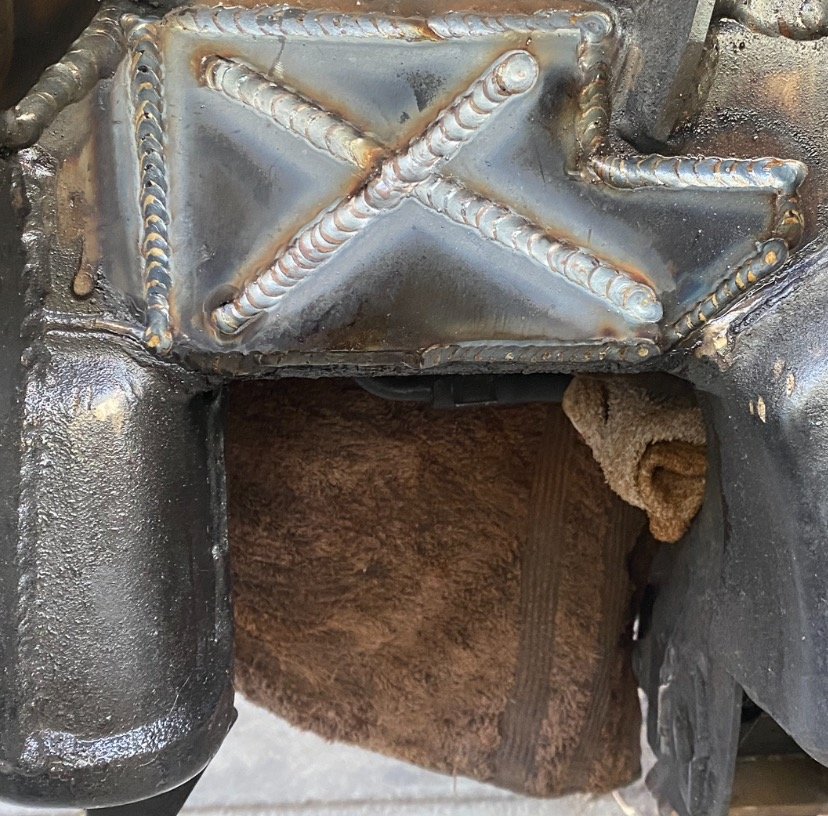

    Felt like the elven smiths of Rivendale bringing Aldurin back to its former glory for the rise of the true king of Gondor
    And welded and cleaned up all the cracks on this bad boy

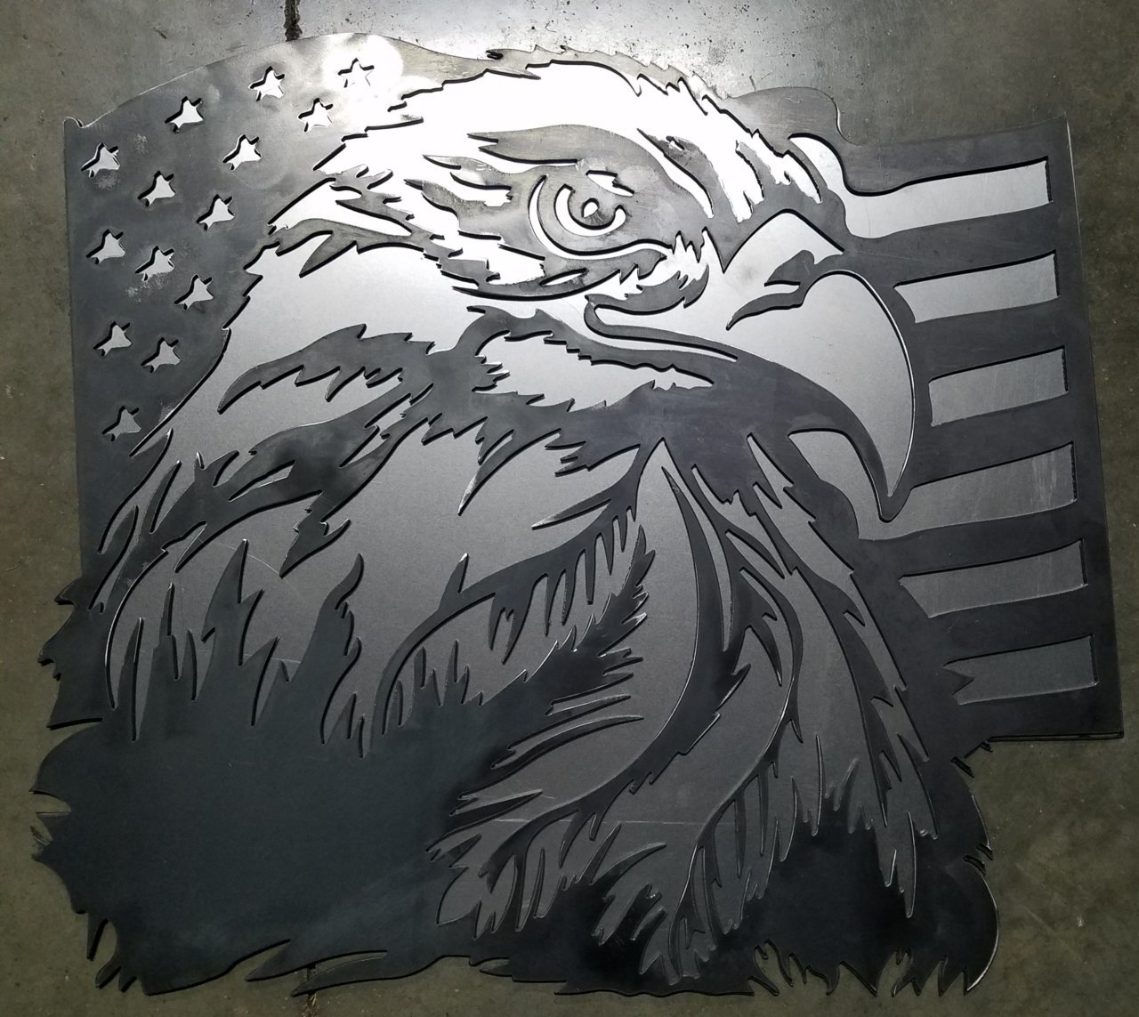

    I cut two of these today. Cut the signs from 16 and the back plates out of 24 gauge. I didn't draw the original, but I did make quite a few changes to open up some of the geometry to make sure I could cut it with 30amp tip. My cut height was a little off and I got some beveling, but not enough anybody except another plasma cutter would notice.
    Cutting 24 gauge for the first time. I have my speed up to 175inches per minute. Fastest I've cut to date. Worked fine.
    Now, for the paint :annoyed:
    It looks a little better from a distance actually.

    That came out super sharp

    It is a "DogCreekCustoms" file from Fireshare. Their files are always solid as downloaded. I only modified it because I reduced the scale and was worried I'd get some overlapping cuts. Several of the stars on the flag had to be redone. No big deal though.

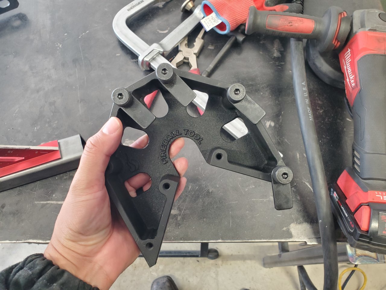

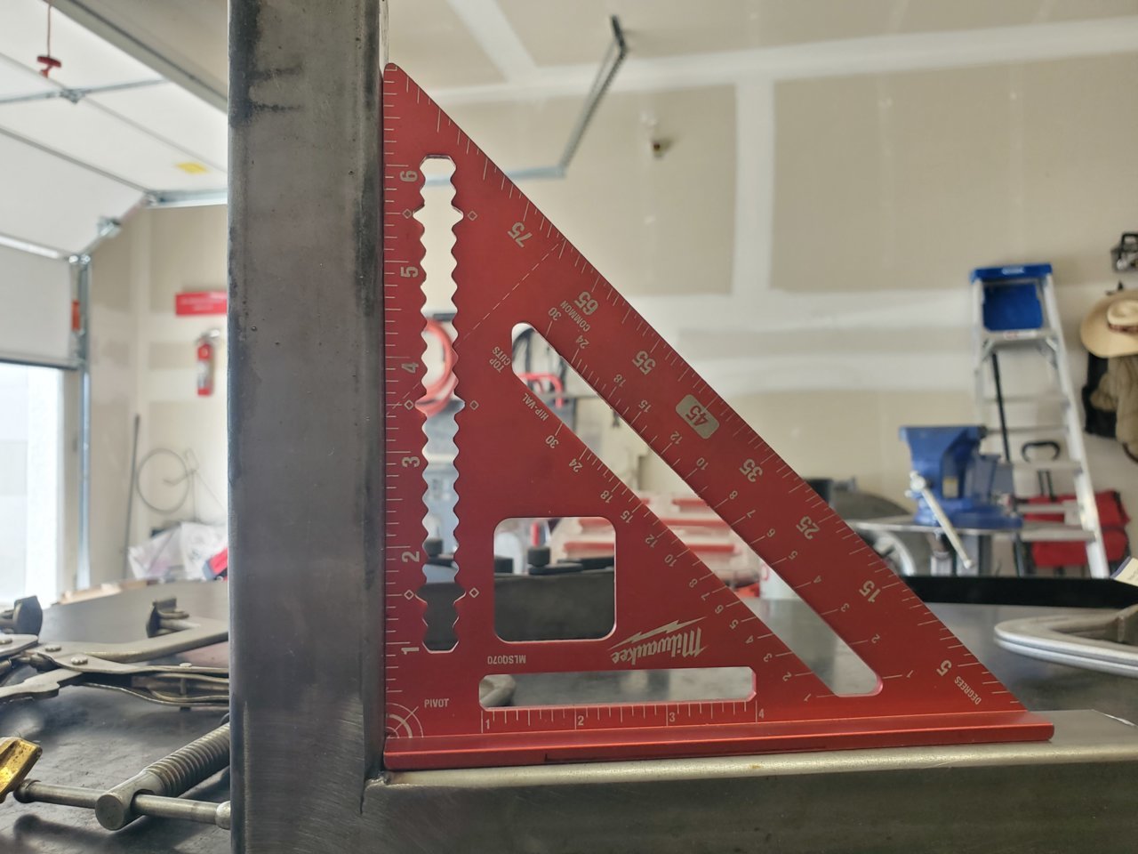

    Meant to buy one of these almost 2 years ago, until recently I saw a sale on them
    Will come in clutch for making table/frame setups and keeping things square

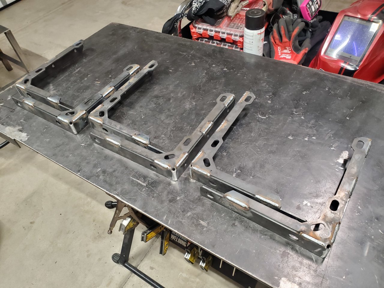

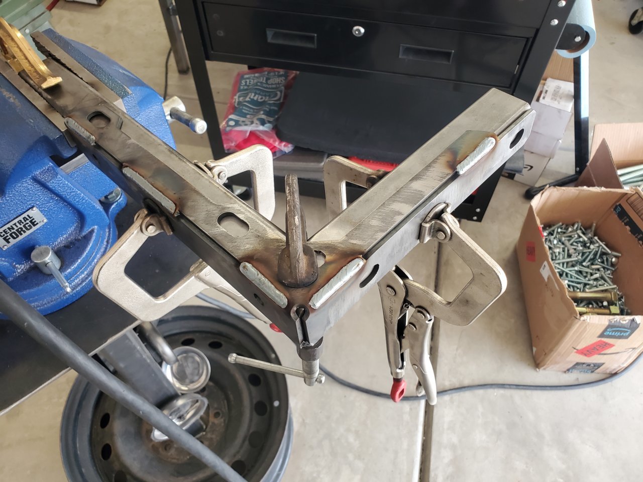

    Also since it wasn't 100 degrees today, I welded a few up
    Need to buy more steel cause I have 5 more orders to fulfill

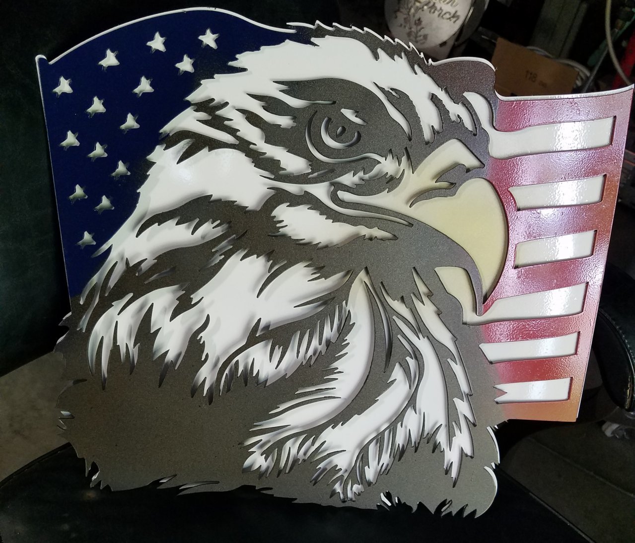

    That looks awesome! :thumbsup:

    Thanks. I threw a half a$$ paint job on it today. I need to go back and fix the front of the beak after it dries (wrong color), but the color really makes it pop.

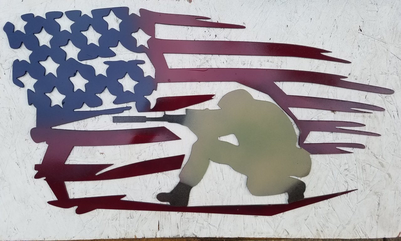

    Possible @Kwikvette favorites list :)
    FYI, this one cut great straight off of Fireshare. Just enter cut speed, pierce delay, and download. I cut 4 because I have a lot of 2A buddies. Got two of them painted up this evening.
    Vmax88, soundman98, KRAMERICA and 2 others like this.
  19. Sep 11, 2023 at 6:00 PM
    Kwikvette
    Feb 27, 2019
    #284735
    81,638
    Fresno County
    4 run, 2 don't
    Noo shit nice
    I see a lot of the cool signs are all meant for 4' x 3' or larger :(

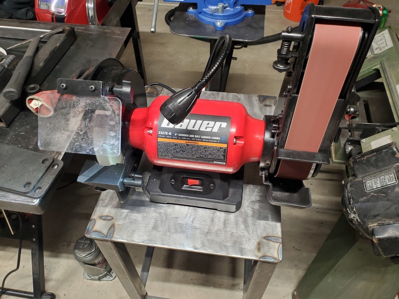

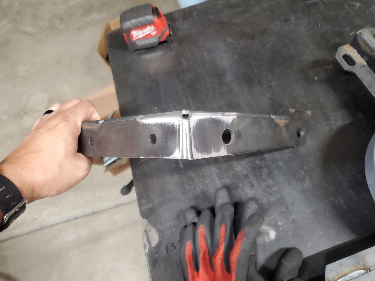

    Got myself a little belt sander, it's really strong too which cleans up the bulk of the welds on these stiffeners
    Funny that the table is finally being put to use again versus being a catch-all; used scrap 1/4" solid steel for the table top and really only used it twice for my saw
    Still requires a little clean-up which is now having me considering a change in the design
    Going to call Swag Offroad and figure out if I should get a different die set or just their adjustable bottom to fully bend my stiffeners to alleviate using relief cuts
