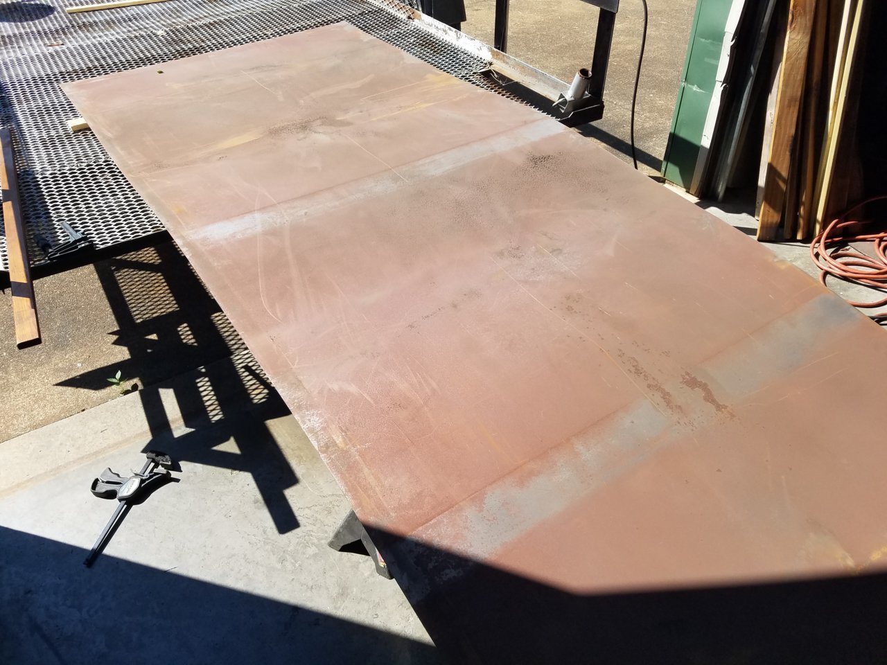

    I bought some 4' x 10' sheets of 16, 18, and 22 gauge today. Got to the bottom of the stack and found this little gem.
    Good news is the opposite side was rust free. The warehouse guys must have flipped it while loading. Still going to mean some flap disk work every time I use it. It's the 22 gauge and will be backer plate for signs, so I can use the rusted side for the true back side of the sign, but I'll still feel obligated to clean it off.

    I'd say, after you cut it down to size just give a vinegar bath so you don't have to spend so much time cleaning it yourself

    Some pay for that look

    Good idea. I have some of the 36% stuff. I can mix up some bath water. As you guys said, I may keep a few sqft for some aged look sign.

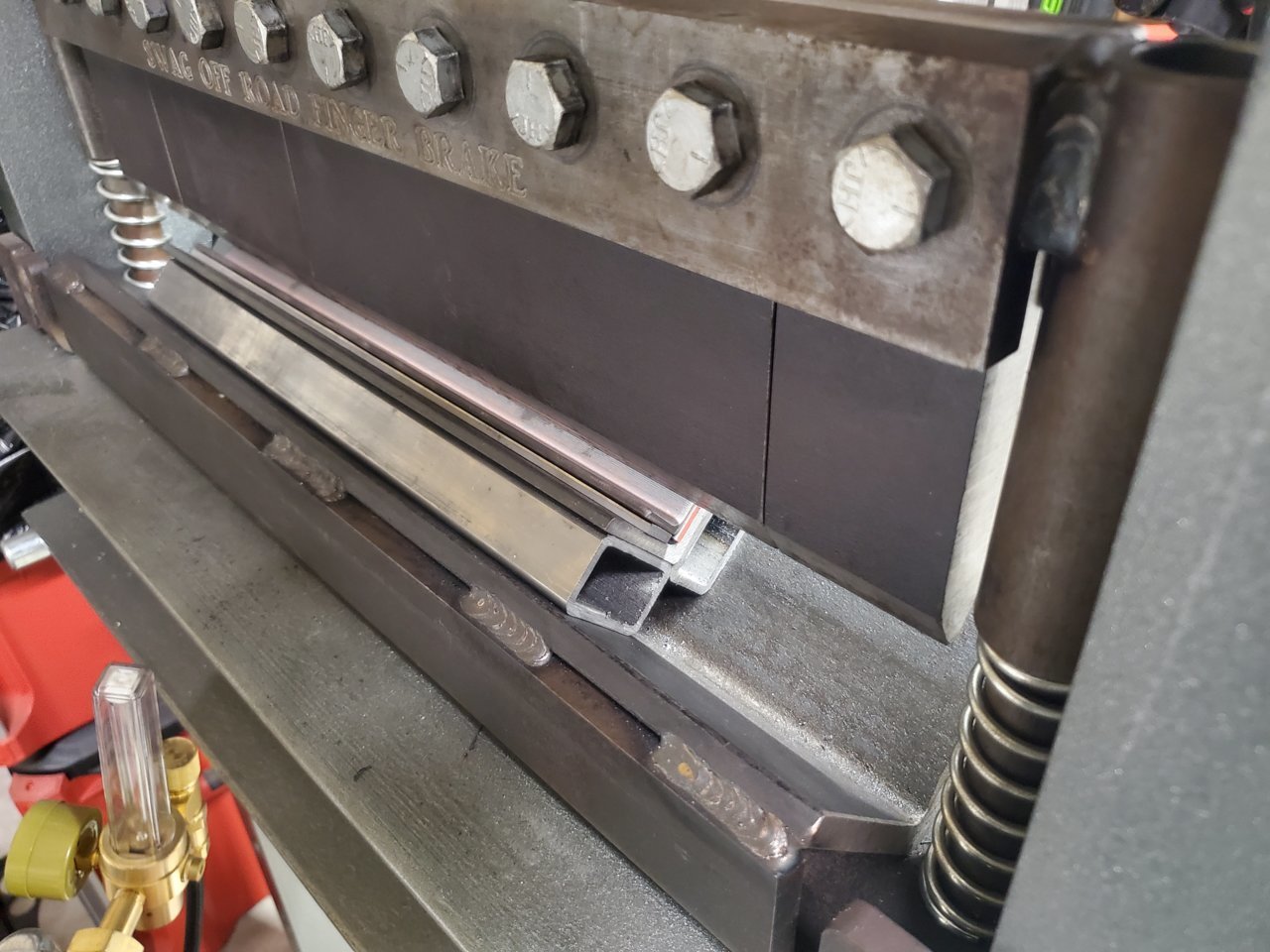

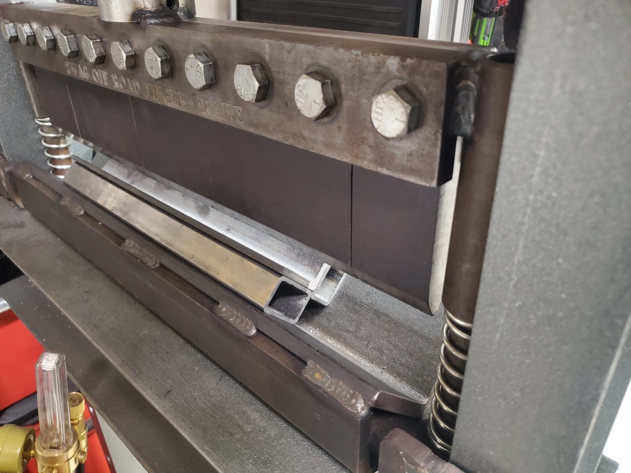

    I forget who owns the finger brake kit here, but it'd work for any 3" bottom die
    While I wait for my 1.5" x 1.5" angle iron to arrive, here's a mock-up of the smaller bottom die I'm making for my setup
    This will cover mostly what I need, however if I ever needed to bend thin stuff with a tighter radius I have this drop in as well
    Parts will get welded of course but this would be a much nicer and simpler setup than taking a bunch of angle iron stepped down in .5" increments and after grinding off the sharp bottoms on each one

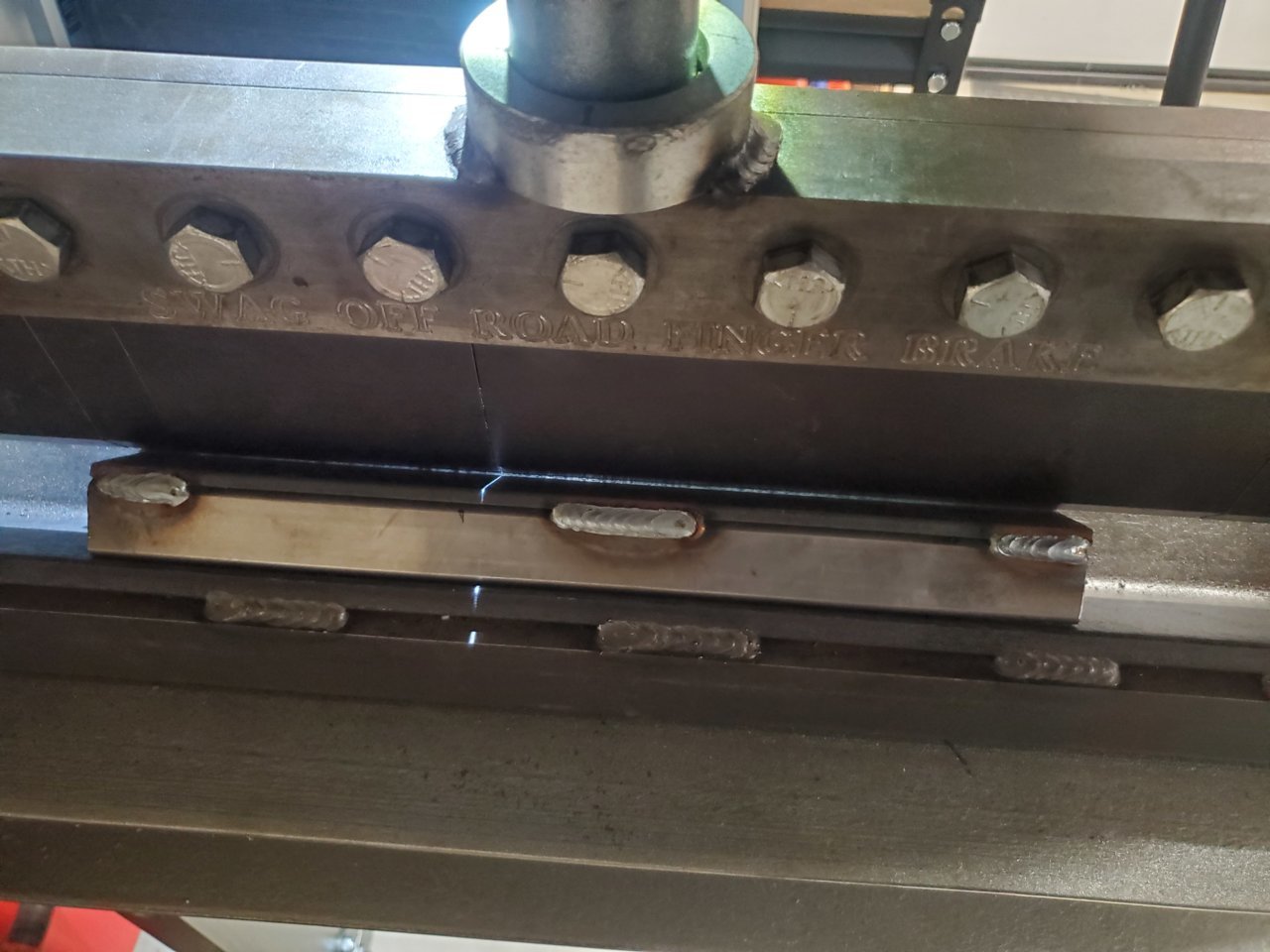

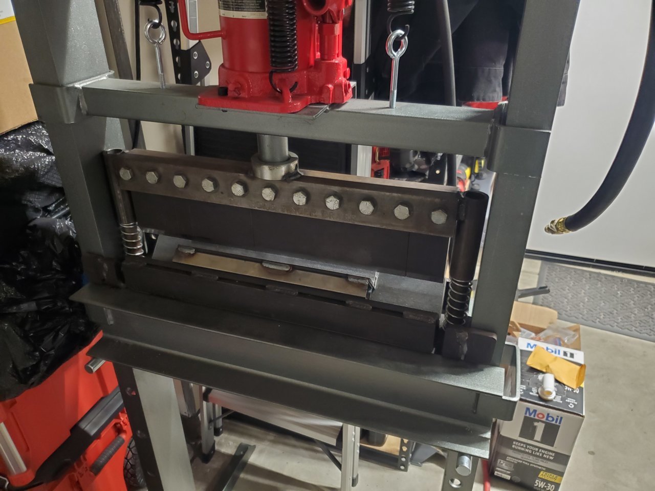

    Got this bitch centered damn near perfect against the die as you can see by the light; the small break is actually the finger die itself
    Hoping to spend a good amount of time tomorrow in chasing my firing issue on the table so I can cut shit and try out the new bottom die
    Of course I'll have to drop the bottom stack down a notch
