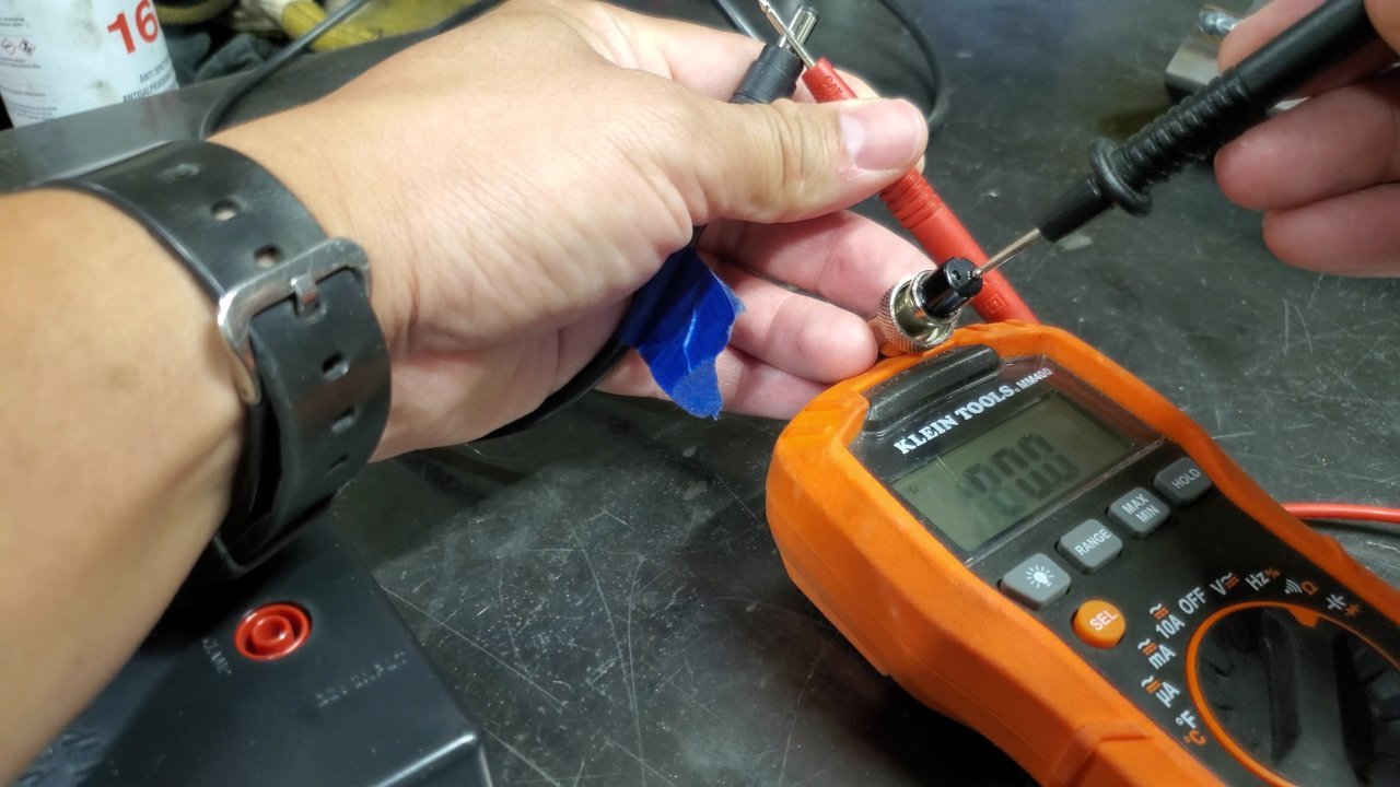

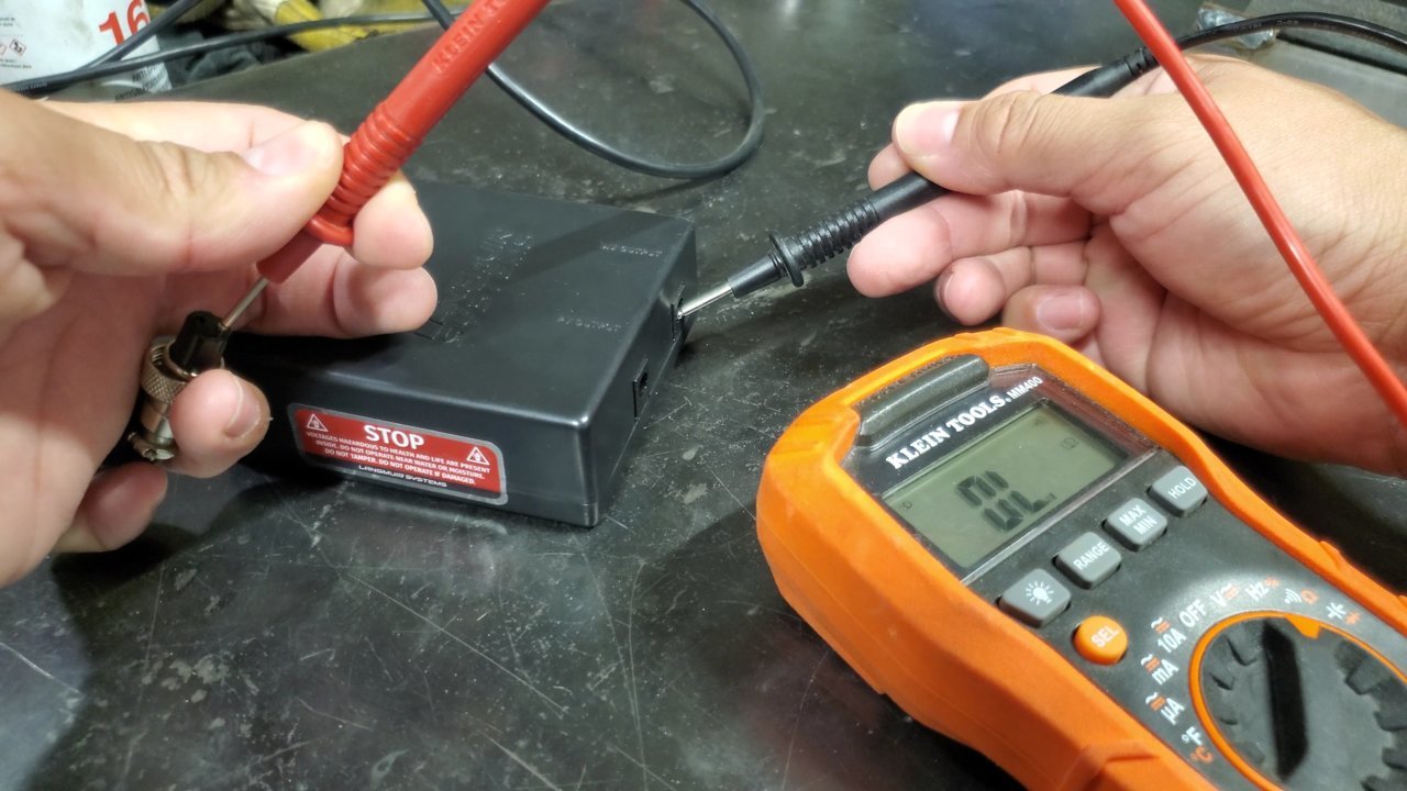

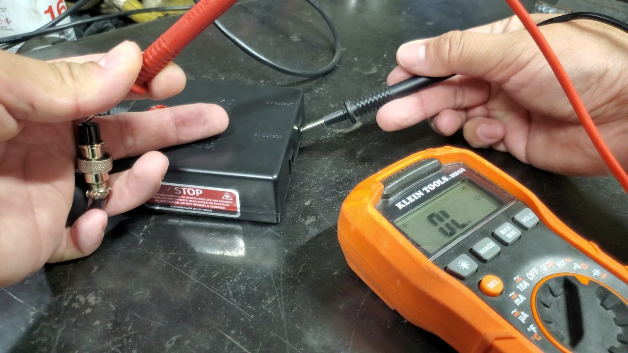

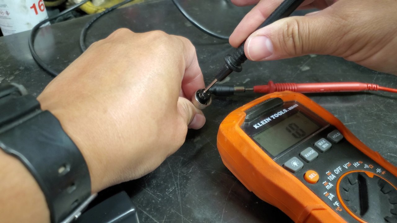

    On another note, someone with a functional VIM module confirmed it is a closed circuit
    That means my VIM module is fried
    No continuity through DIV in out
    Was simpler only having to probe one side of the module as I used pins 1 and 2 on the cable socket end to probe through the other side
    And yes, that was checked for continuity as it works well and is the factory supplied cable

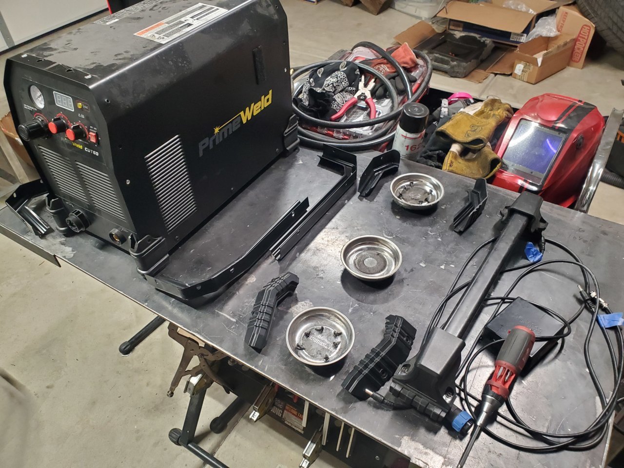

    Stripped the "guards" off the PrimeWeld and will open her up tomorrow in preparation for tapping into RAW voltage
    My VIM module still needs replacing but I'm hoping to get it up and running the second replacement parts make it their way here

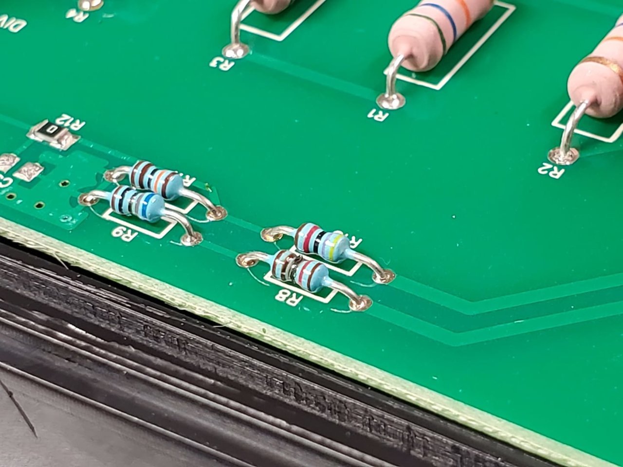

    The little culprit

    Oh easily
    But I don't know what color that middle band is
    That and I'm under warranty so, waiting to hear back on the new one I'll get sent
    Will see the band color, order a new resistor of the same value, repair old module, and set aside as a backup
