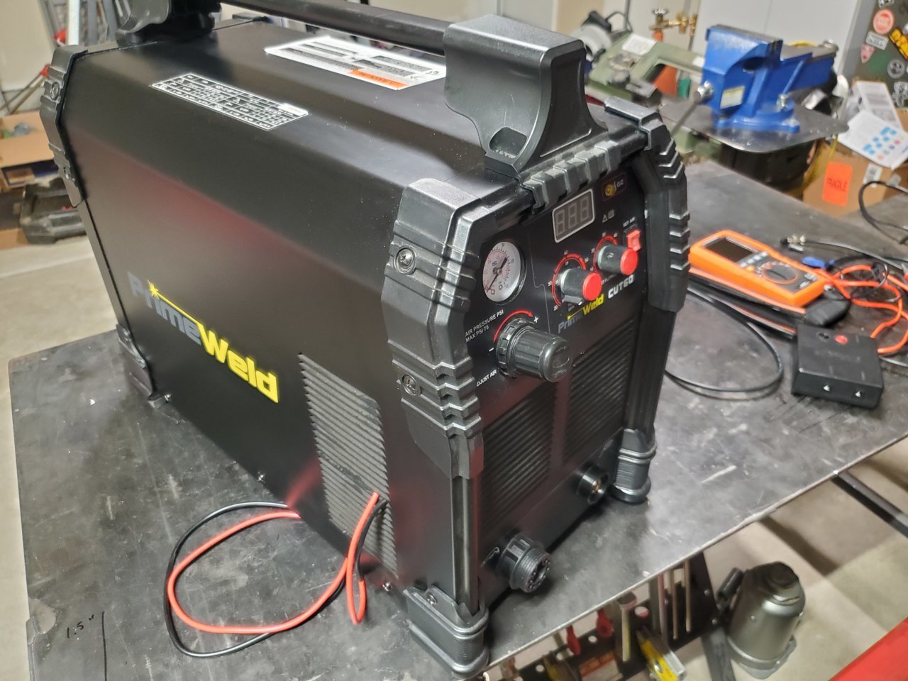

    No need, nothing is wrong with the plasma cutter itself
    It was the VIM box I posted earlier; it receives power from the plasma cutter and communicates with the control box on the cnc table for torch height control reasons
    I'm wiring it up as we speak since I found my CAT III plugs

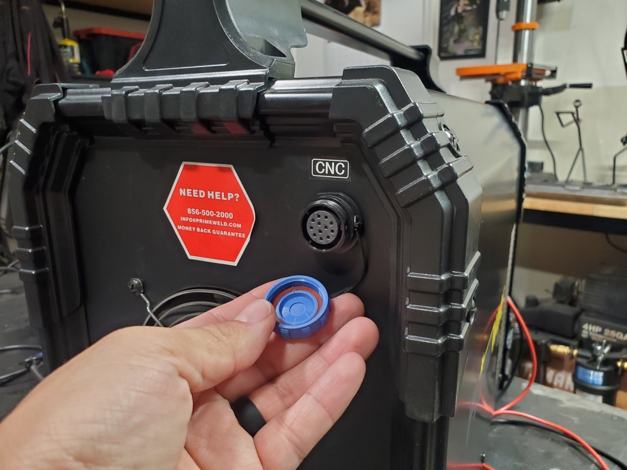

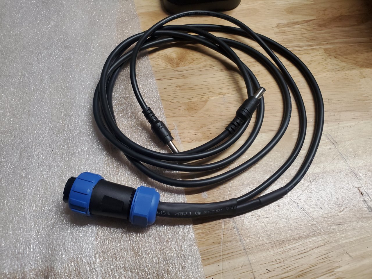

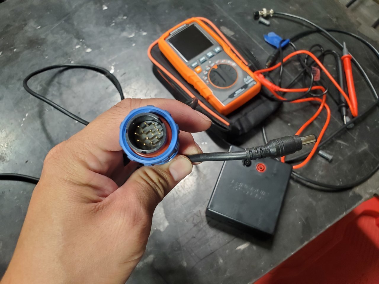

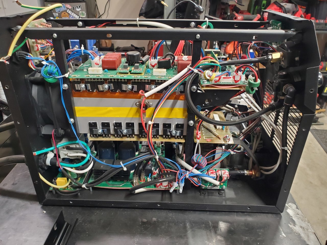

    This is an "alternative" method...or shall I say "preferred" method for tapping for a signal to control torch height
    The method I was using is divided voltage 50:1 with the use of pins 4 and 6 via CPC port in the back
    Pins 1 and 2 are used for torch on and off
    I chose that route as the plasma cutter is supplied with a plug in which you solder your own wires; I wanted a "professional installation"
    Having solder experience, I made a nice clean cable to utilize the divided voltage output not to mention the torch on off switch
    Here's an old picture of last year when I first put the cable together

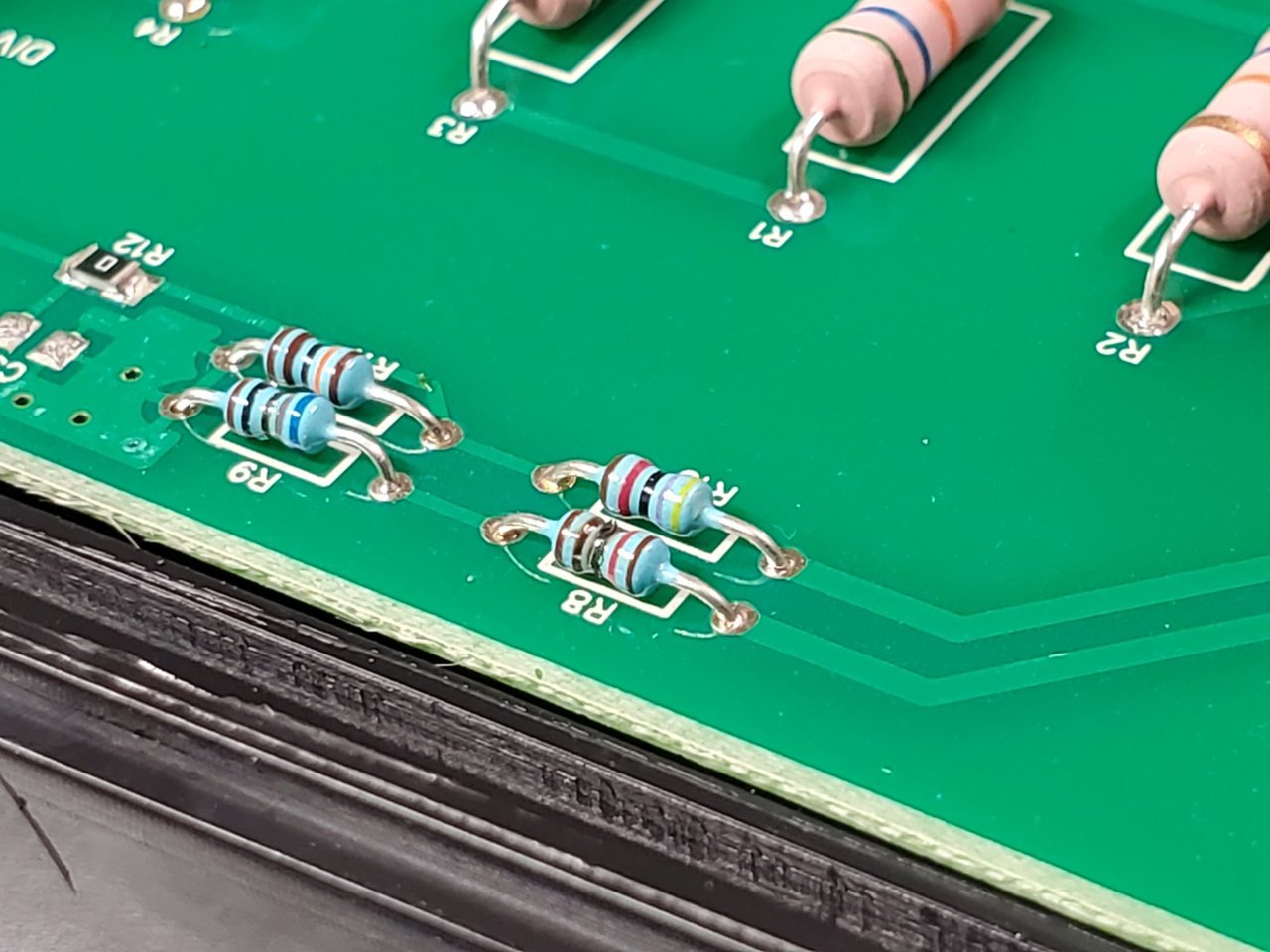

    Anyway now I'm raw so I will be utilizing the other part of the VIM module in hopes that it doesn't burn out again
    If I were to guess, I'd say there was a voltage spike and that caused the resistor to burn out
    Also if you look closely at R9, there's a cold solder joint as there's an opening there on the left leg

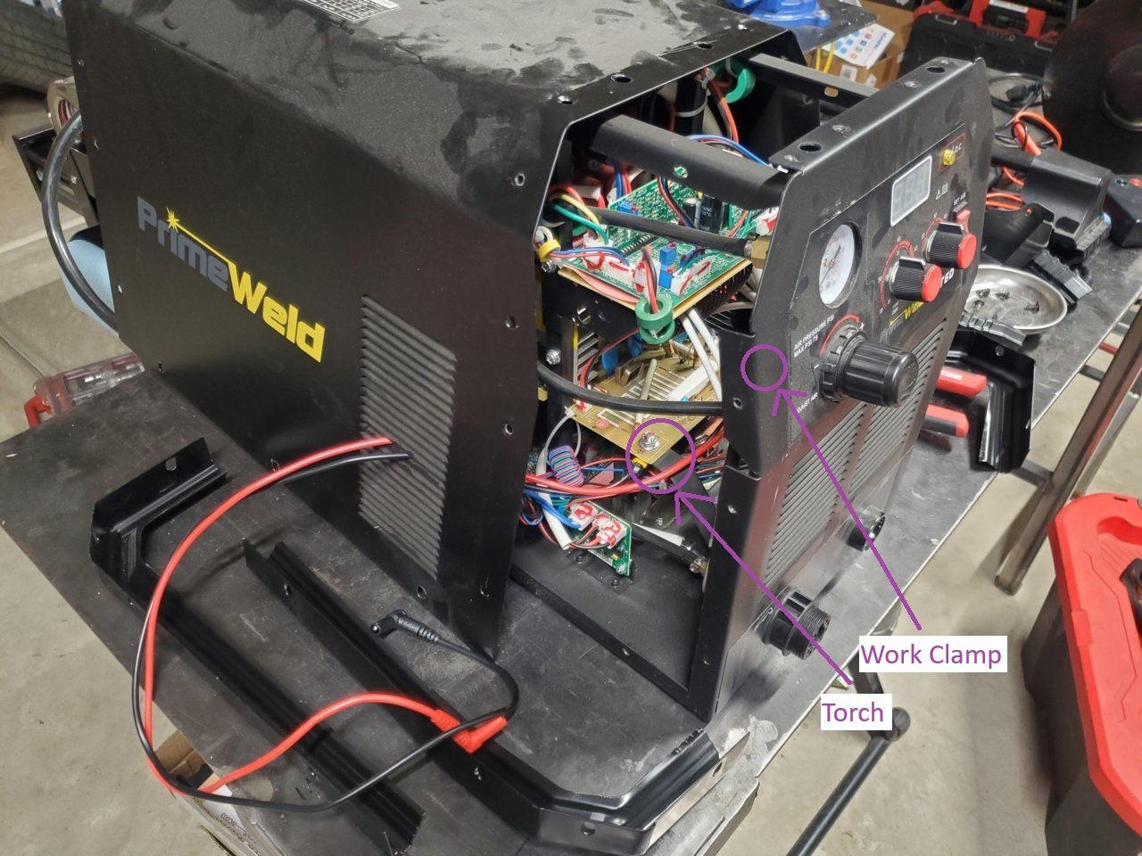

    Yes, the leads will remain poking through the side as you have to manually tap into your plasma cutter for voltage
    Here I circled the areas (one is hidden behind the front bezel) depicting where in the board I tapped
    The new VIM box will be taped to the side of the panel with double sided tape and the leads will plug in there
    The CPC plug in the back will be used only for torch on and off
    Other plasma cutters aren't even CNC-friendly and you have to tap in for torch on and off as well as voltage
    Drainbung and Bivouac[QUOTED] like this.
