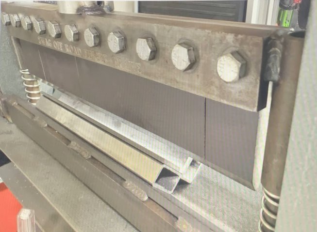

    @Kwikvette Did you try out this bottom die setup? I have some heavy wall 1" square tube that I think I might give this a try with.

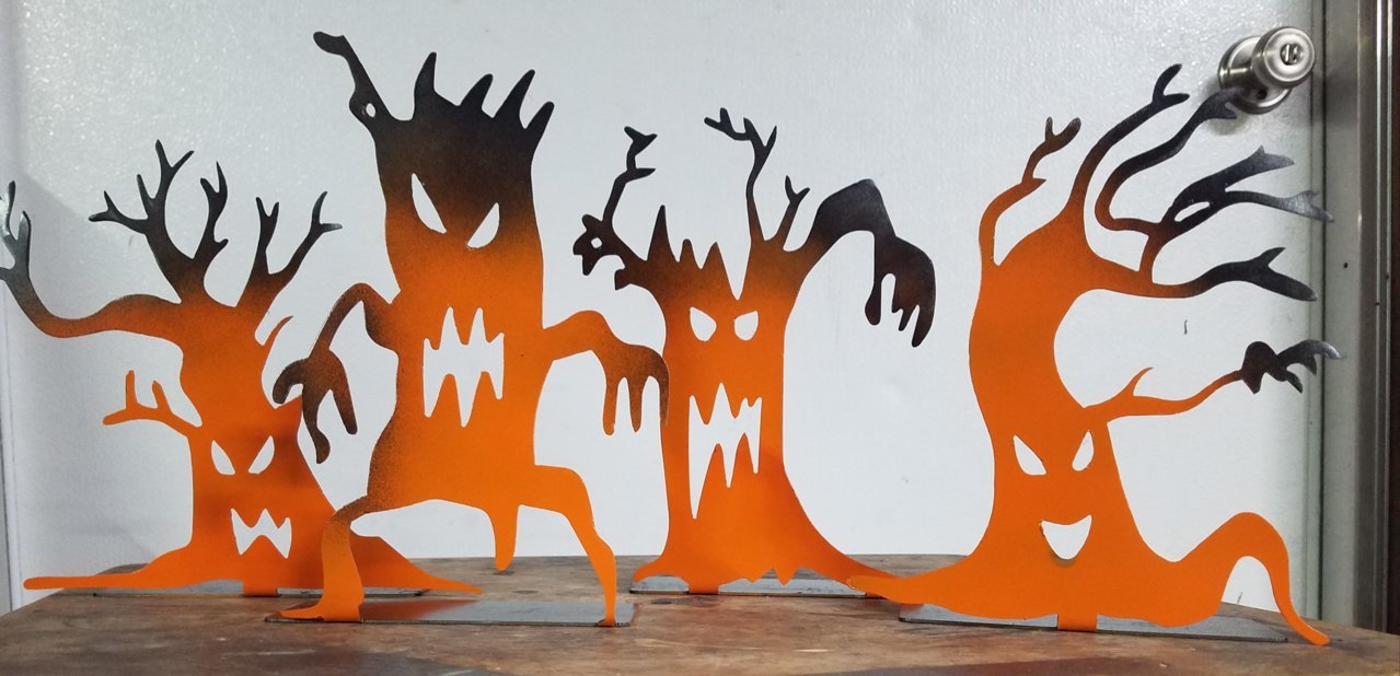

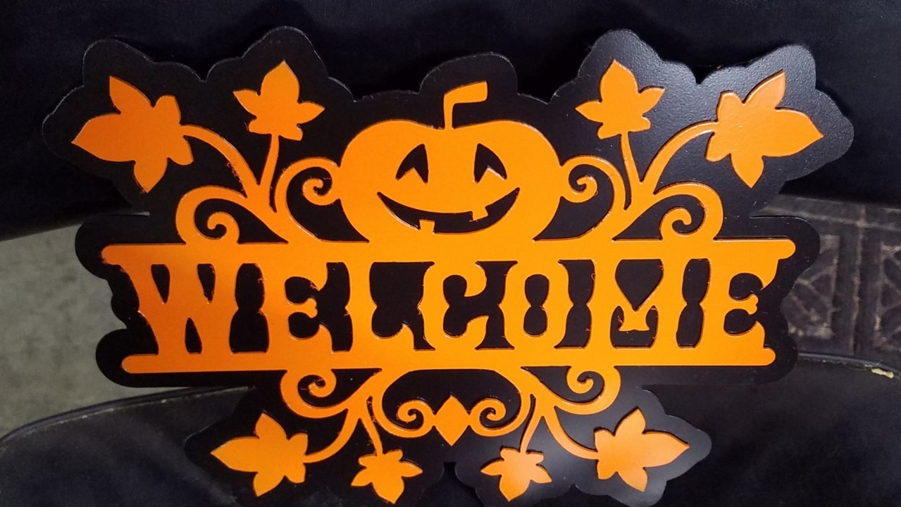

    Made a few Halloween decorations last few evenings:
    18 gauge, 28 amps, 3400 mm/min, 1.1mm cut height, IHS Springback 0.0, pierce 0.6secs
    backside is orange limbs over black trunks.

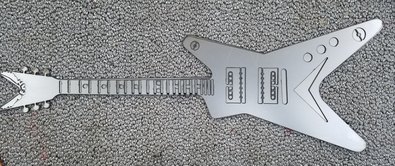

    Accidentally hit post before I added this one. Warehouse guy where I buy my steel has a Dean MLX guitar tat on his arm. I was asking him about it and he asked if I could make him a sign of one. The neck still sucks but he'll be fine with it since its a freebie.
    I got about 2 hrs of CAD time in on this so he better be "finding" me some scrap steel in the future.

    Nice job, saw those pieces and downloaded a few. Especially the ghosts to cut out of the large squares left over from yesterday's work

    Oh man old post already
    Scroll back 3 pages, you'll see I used it
    It did create a tighter radius than the stock block, but I require air bending versus bottom bending/coining
    Drainbung and wilcam47 like this.
  16. Sep 20, 2023 at 7:18 AM
    TacoTuesday603
    TacoTuesday603 I welded it helded
    May 3, 2021
    #364592
    3,417
    Jack
    New Hampshire
    2011 OR DCFB
    Fox and Locked suspension 63's Skinny 33's
    Whoops, didnt see you used that setup. I thought that change was getting rid of the relief cuts only.
  17. Sep 20, 2023 at 7:21 AM
    Kwikvette
    Feb 27, 2019
    #284735
    81,892
    Fresno County
    4 run, 2 don't
    Yes, the tighter radius block was intended to do such a thing
    After more reading and research, I need a v block with appropriately 20-30mm of an opening at a 65 degree angle more or less
    This will support the walls and prevent warpage as another factor comes into play with these parts, flange to feature
    I have holes that are too close to the bend line that will cause the issues I'm having

    Dude that's so badass
    I actually gave my business cards to the three different people that have all hooked me up with steel, letting them know I'd be happy to offer something for them if they felt a need (and I'd share some pics on my phone to give them ideas)
    What you made is really awesome
