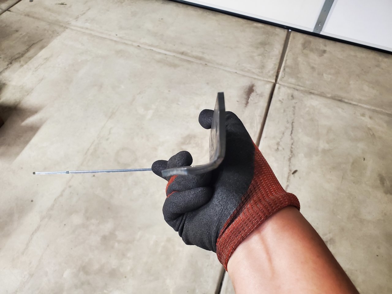

    Stiffies still at 90 degrees all the way around?

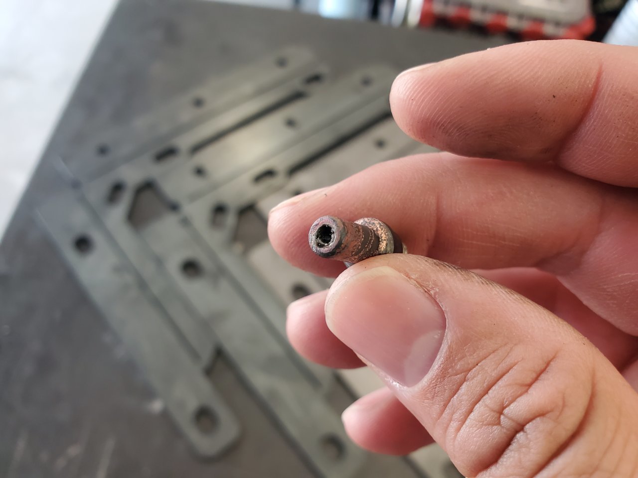

    Looks like the Hafnium core blew out. See how round the opening looks? Thats the perimeter of the insert.
    Did you see any copper looking stain or splatter on any of your cuts? I've had several times when the core blew out and there was a brief issue with cutting but then unbelievably the program would continue and make pretty clean cuts. The copper like splatter was the tip off I had an electrode failure.
    I would have said that overheating the electrode caused it, but there is minimal discoloration on that one. If dross clogs the tip opening, even briefly, the electrode can rapidly overheat and the hafnium core may be ejected. Inadequate air pressure for the amperage might also cause it to overheat. This has happened to me even with the better-quality electrodes I've bought. Actually, both time it was some of the better electrodes I had and not my cheaper Amazon or Primeweld ones.

    Oh yeah, this was just neglectfully...neglected :rofl:
    I didn't care to replace it when I wired for raw voltage.
    But nope, no copper splatter anywhere so it's possible it just blew out onto the metal/water as I run a +30 post flow to keep the torch cooled after every cut. I've never had it go this bad before as I normally just swap them out at about 400 pierces.
    Might sound a bit preemptive but I factor that into the parts I sell by adding an extra dollar or two per order. And an electrode and nozzle can last me multiple orders on top of my own personal parts.
    What good quality set are you using? I have just always used the PrimeWeld variety.

  6. Sep 24, 2023 at 6:48 AM
    Wsidr1
    Wsidr1 Well-Known Member
    Jul 11, 2018
    #259004
    3,079
    Indiana
    2 x 95.5 Ext 2.7L & 3.4L A/T 4x4
    I'm buying from George's Plasma on Ebay. He says his supplies are not China sourced. I can tell they are better quality just by the appearance, the threading on the electrodes goes into the torch so much smoother, electrodes last longer, the cups last longer and appear more well made... He just has good stuff.
    I still buy and use things off Primeweld. But if its a significant piece with mod-long run and many pierces, I swap out for my "good stuff" just to be safe.
    BTW, I notified him when the second blew out and told him I was just letting him know in case he got a bad batch (not asking for refund) and he sent me a free bag. He posed the theory of tip clogging causing overheating because my electrode was discolored. He answers tons of questions on LS Forum. Goes by mechanic416.

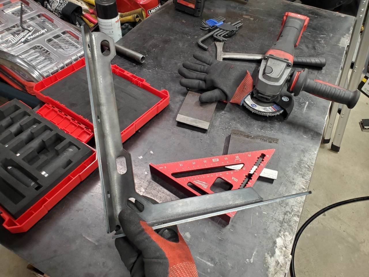

    @KRAMERICA
    Were the bends on the pieces still square?
    And do you think they'll work on a 2nd Gen?

  11. Sep 24, 2023 at 7:43 PM
    KRAMERICA
    KRAMERICA Old Man Mike
    Mar 22, 2015
    #151504
    3,882
    Middle Tenn
    '18 F250 Super Duty
    A couple of rear window decals...
    Yep, perfectly square. They arrived in good shape.:thumbsup:

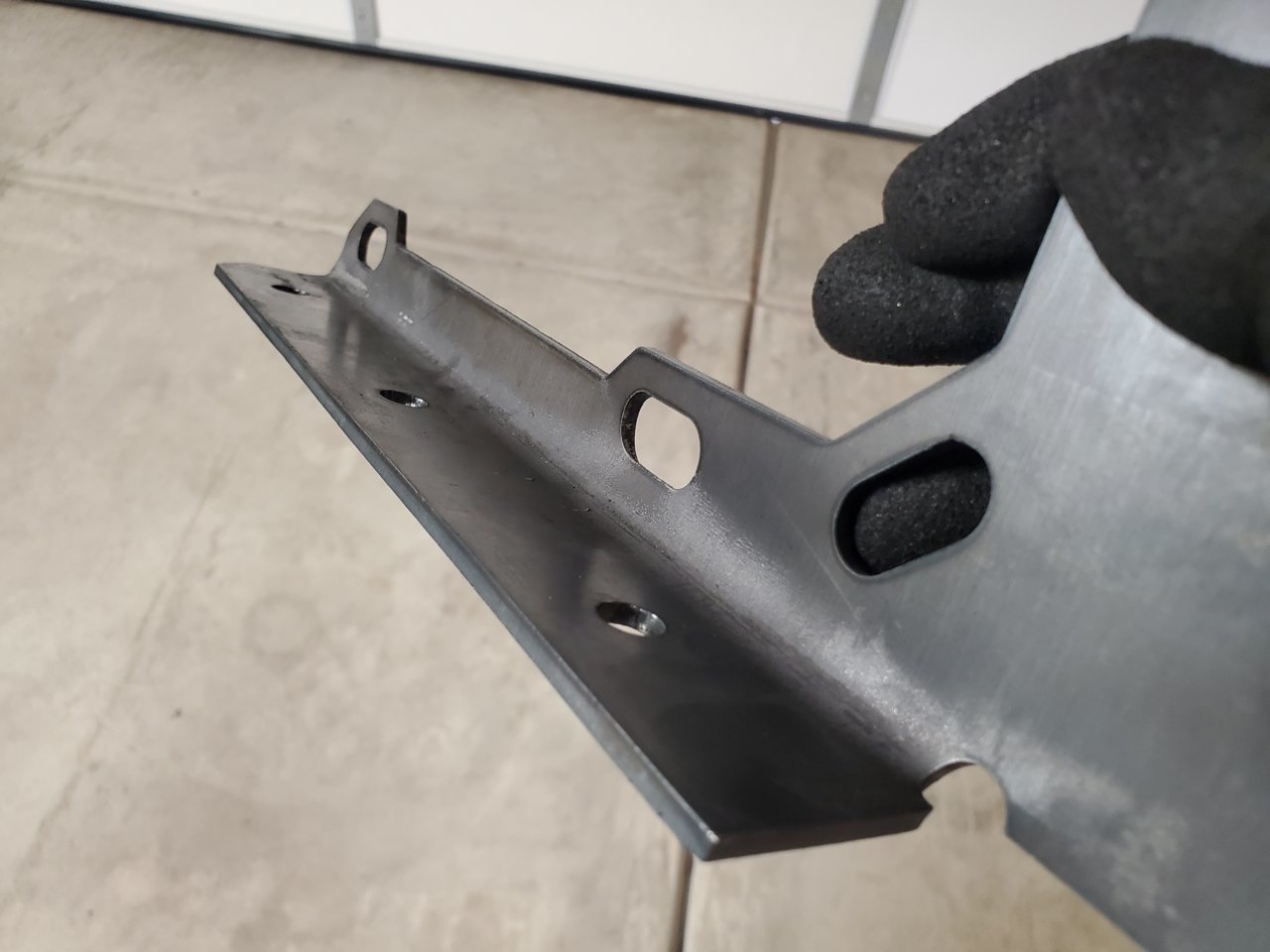

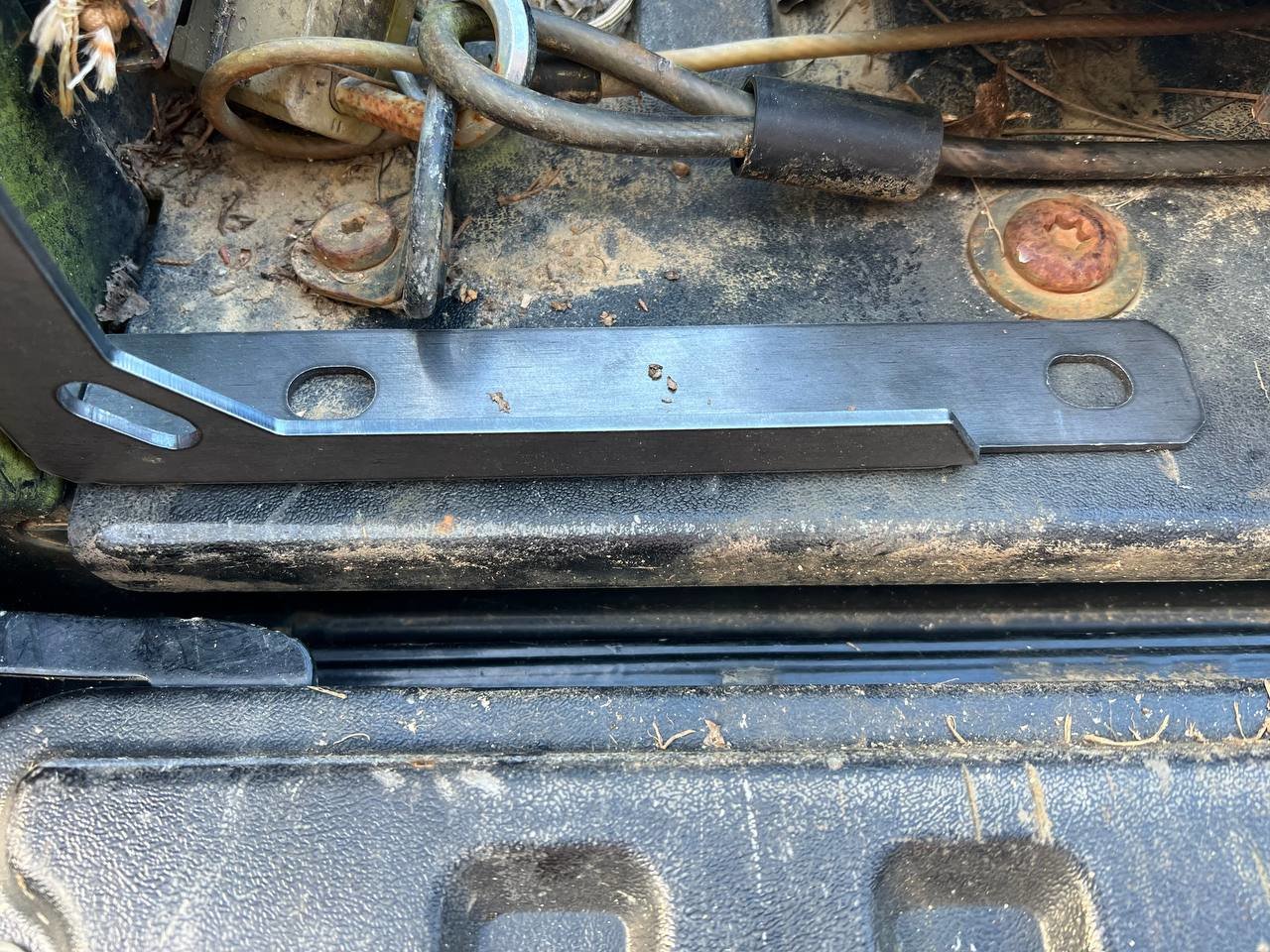

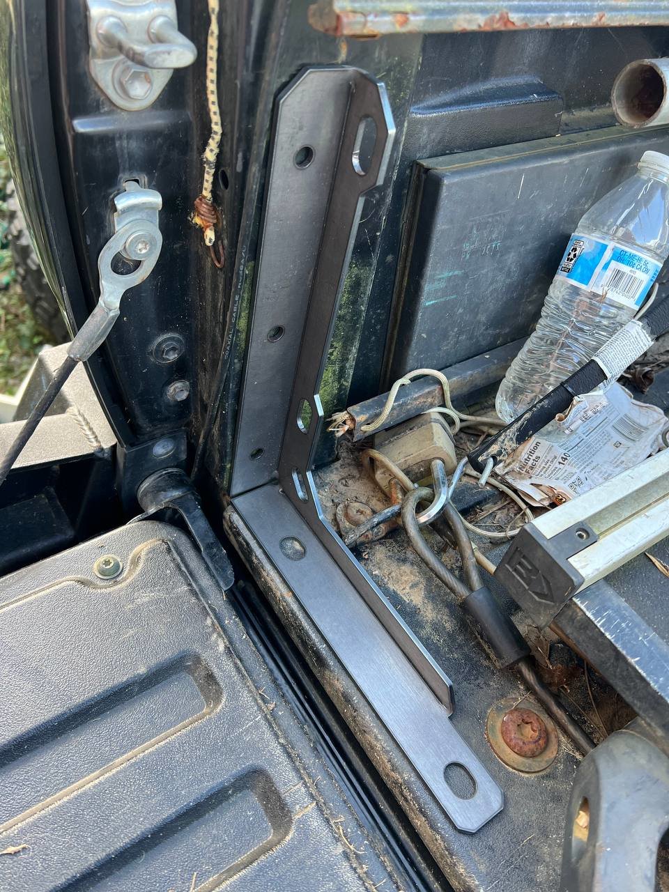

    I'm not sure when I'll get them welded up:welder:, but I'd say the holes line up great for the 2nd Gen. I'm not sure which way they should face, what do y'all think?
    photo_1_2023-09-24_21-28-58.jpg photo_2_2023-09-24_21-28-58.jpg photo_3_2023-09-24_21-28-58.jpg
    Drainbung and Kwikvette[QUOTED] like this.
  12. Sep 24, 2023 at 7:48 PM
    Kwikvette
    Feb 27, 2019
    #284735
    81,120
    Fresno County
    4 run, 2 don't
    Damn, still perfect!
    I'd run them as shown in picture #2 that way there's room to hook anything to when needed for the tie downs
    Unless you won't use them, then use it as shown in picture #3
