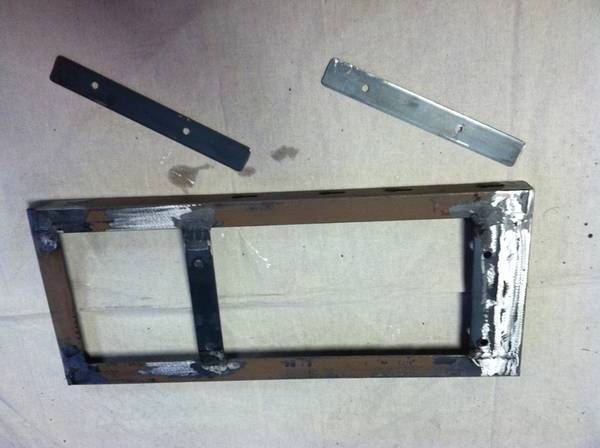

    I've posted in here before when I was looking for a welder and the help was greatly appreciated.
    I've done only minor projects with it so far, but I believe I'm actually getting better.
    I made this mount for a toolbox in the bed of my truck and figured I'd share it here as this is where I got my start.
    I won't show my welds as they, while improving, aren't great ... they hold though!
    This is the frame of my mount. Old bed frame = free steel.
    I added the webbing in the middle to accommodate bolt locations.
    Finished.
    I wouldn't normally double post, but I have a detailed write-up here:
    http://www.tacomaworld.com/forum/2nd-gen-tacomas/315731-fabricated-toolbox-mount.html#post8193377

    Show your welds and I bet youll start getting better. No one here will bash your welds. We will how ever tell you how to make them better. Such as adjust the heat input wire speed and travel speed.
